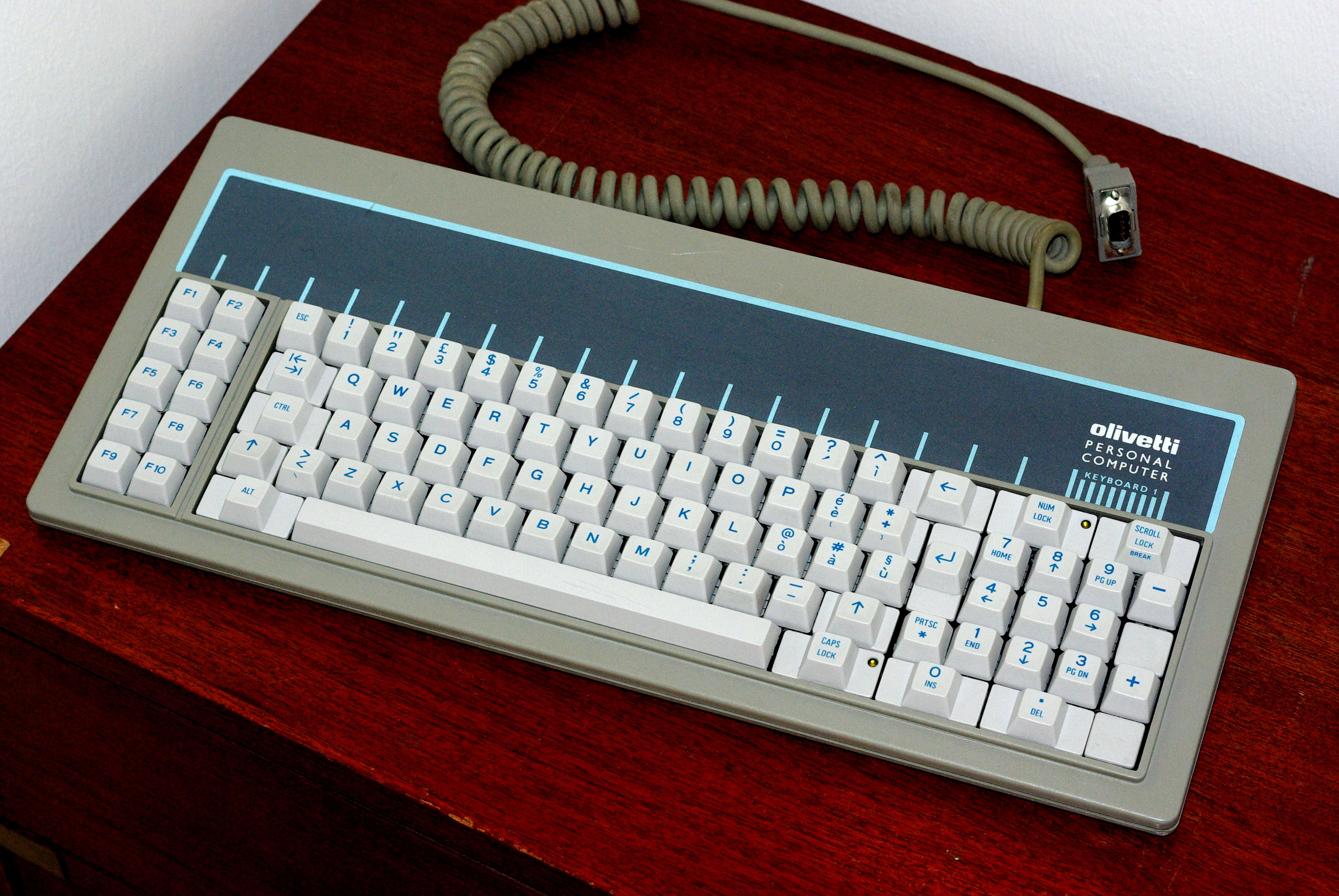

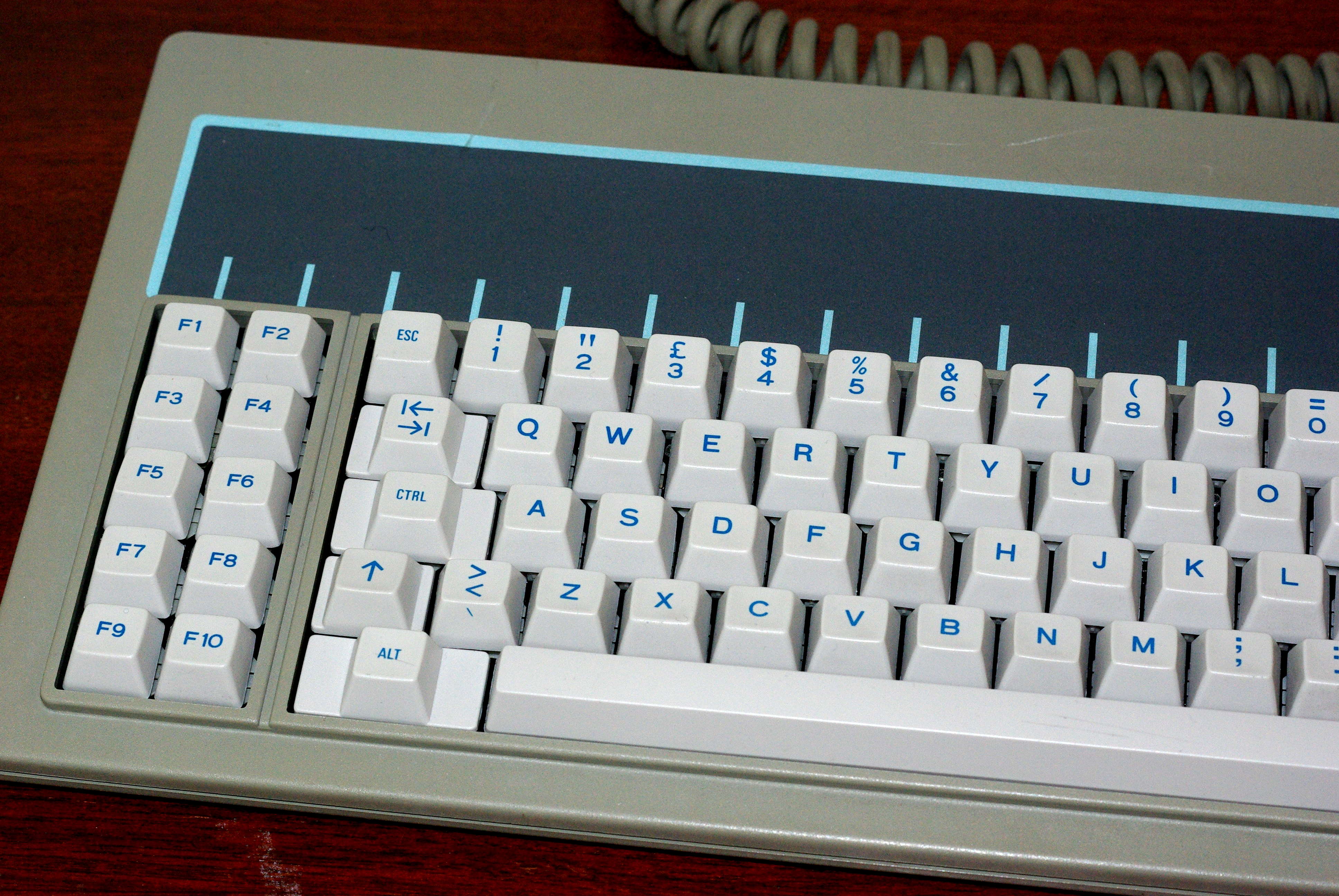

This keyboard was shipped with the Olivetti Personal Computer M24 introduced in 1983. Later revisions of the M24 came with a different keyboard. As you can see the layout is very similair to the Model F IBM 5150 Personal Computer.

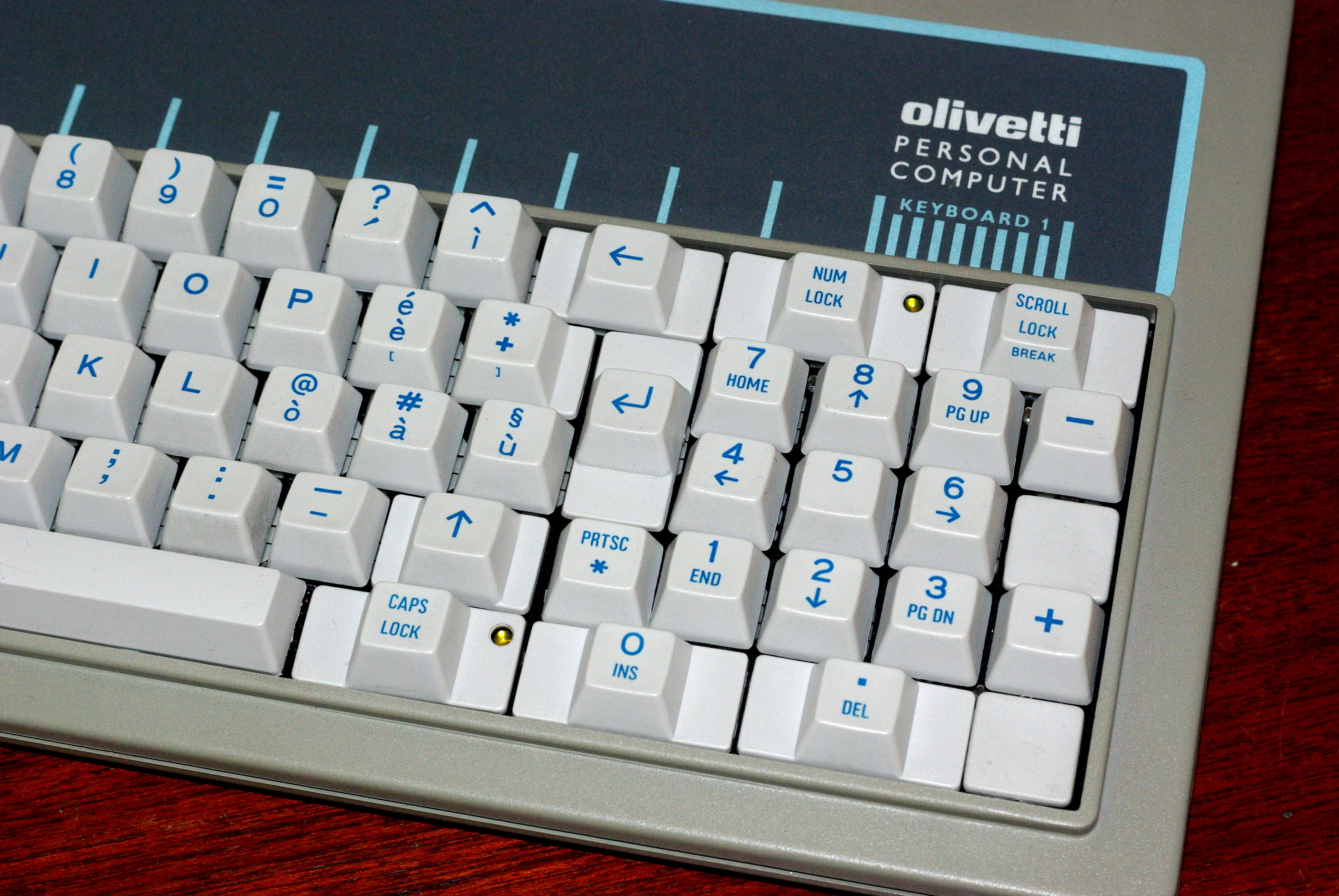

I really like that light blue almost turquoise printing on these keycaps. Like the Model F XT this keyboard has a lot of stepped keycaps with LED cutouts in this case.

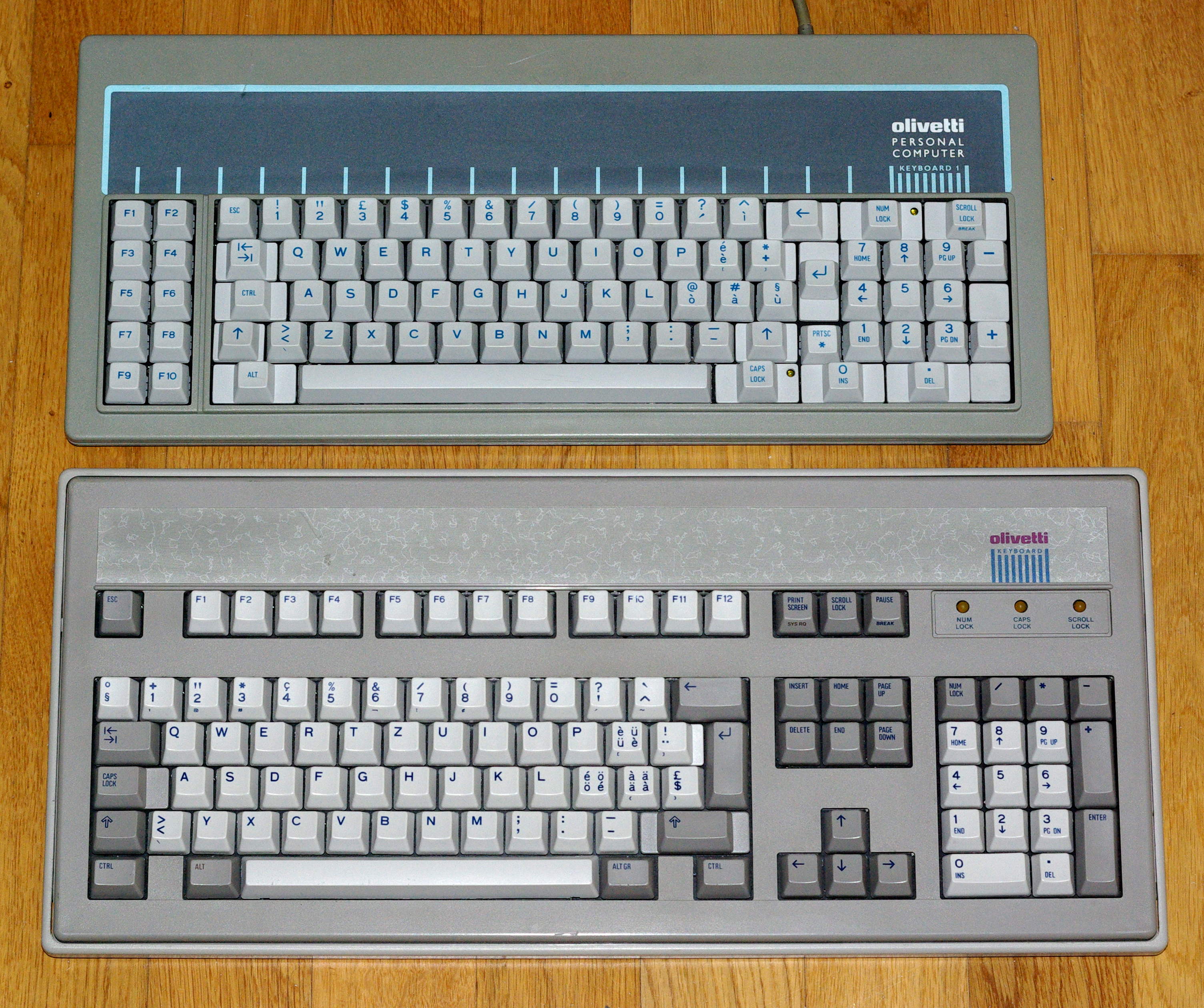

Next to the ANK 25-102 the ANK 2463 is slightly more compact just like an XT keyboard usually.

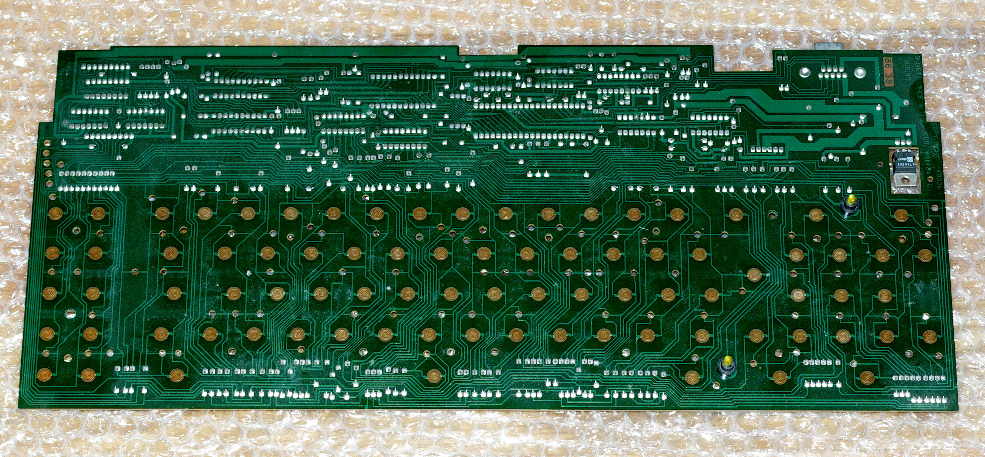

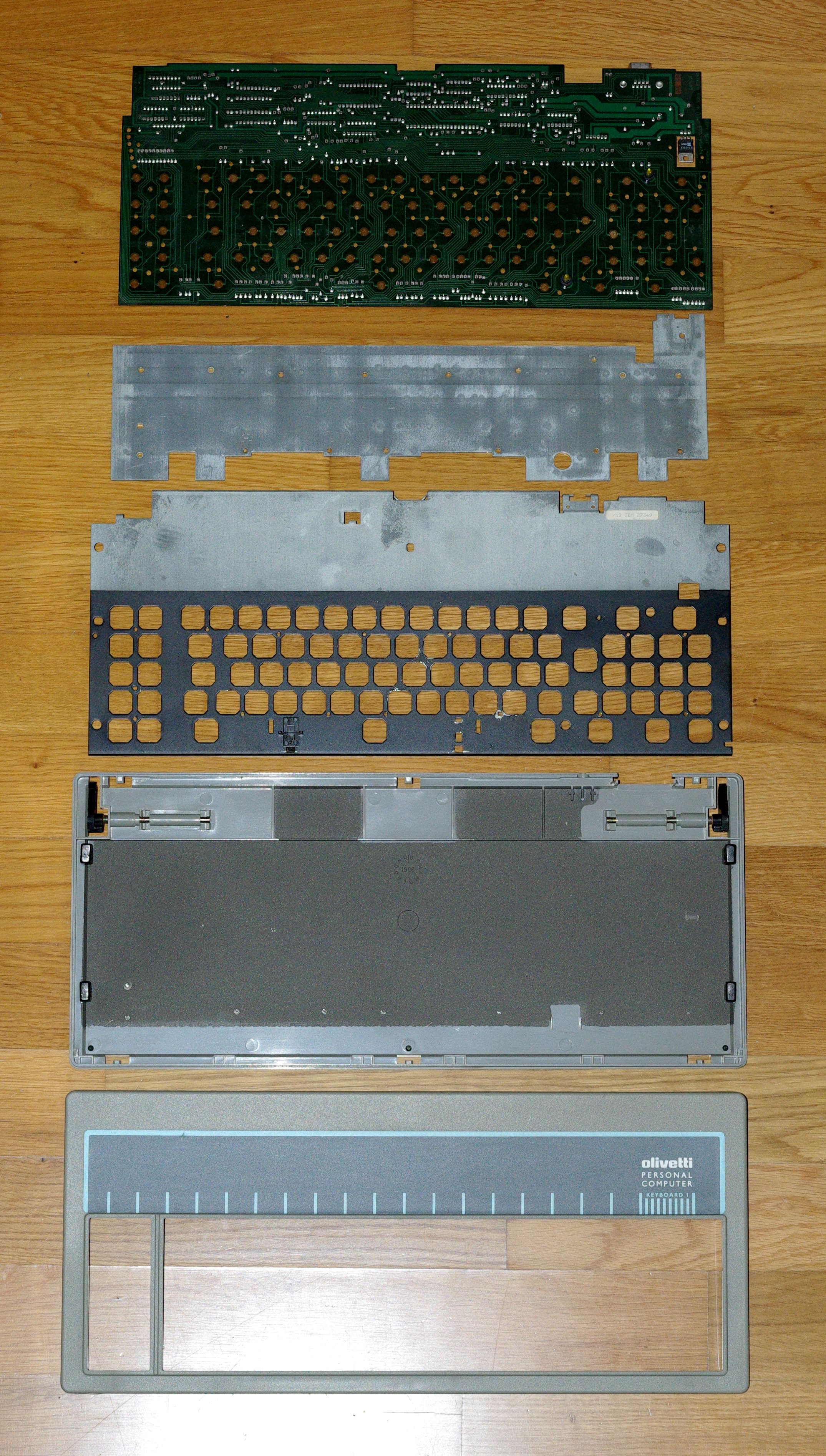

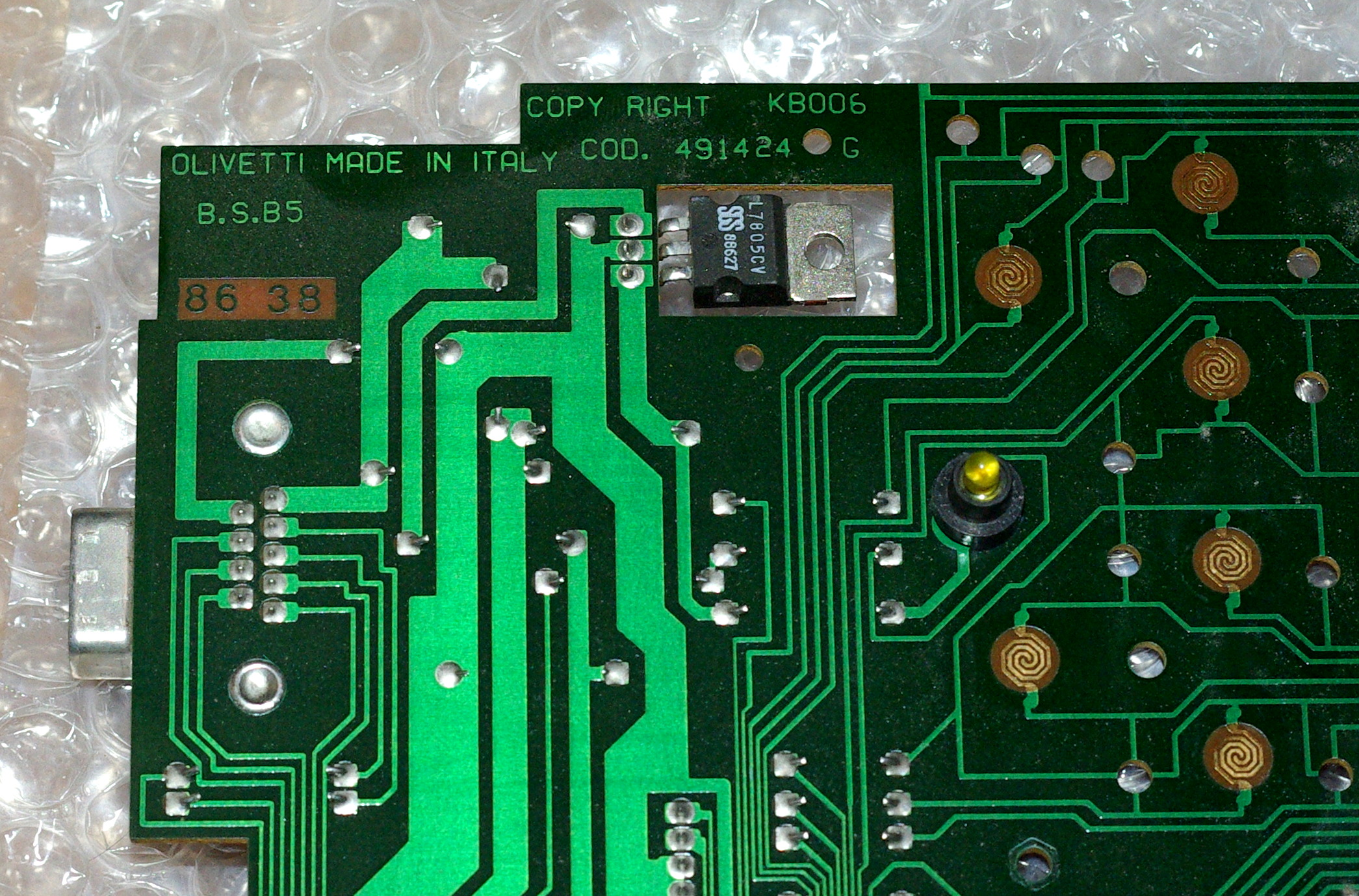

This keyboard consists of five parts; Top and bottom case, metal plate with switch housings, PCB and a smaller metal plate covering only the area for the plastic standoffs.

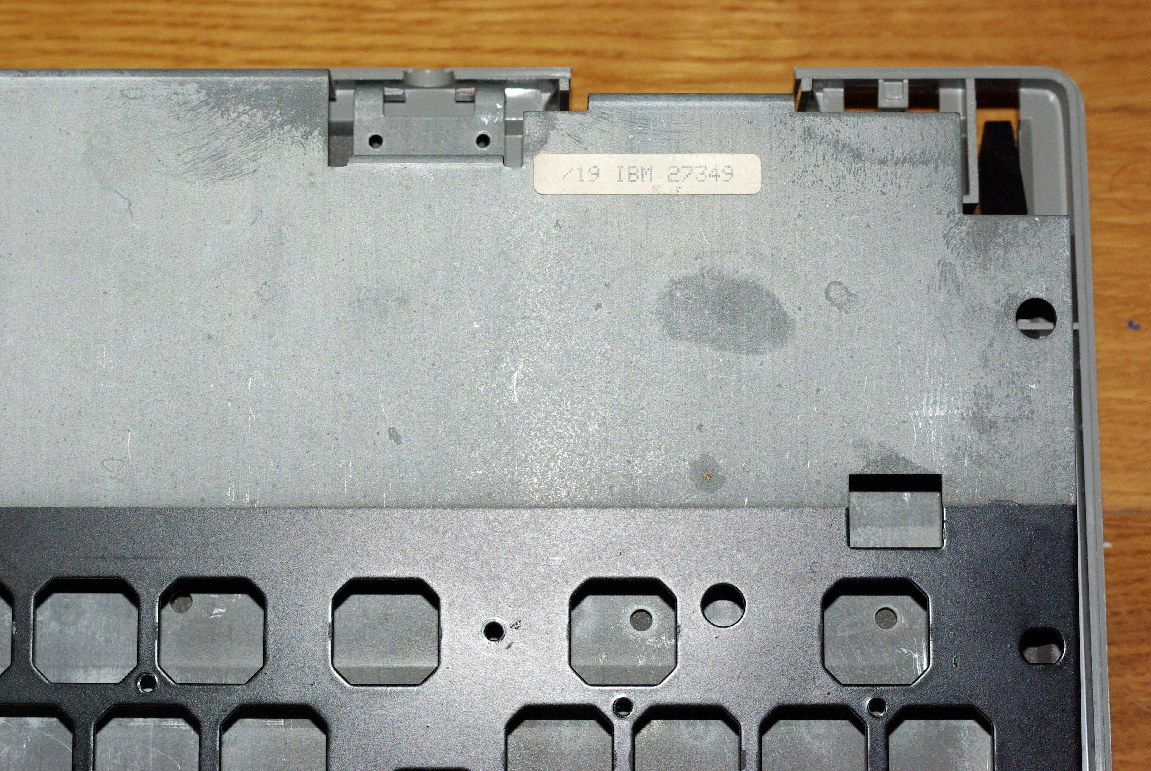

Note it reads " /19 IBM 27349" on a small sticker on the metal plate.

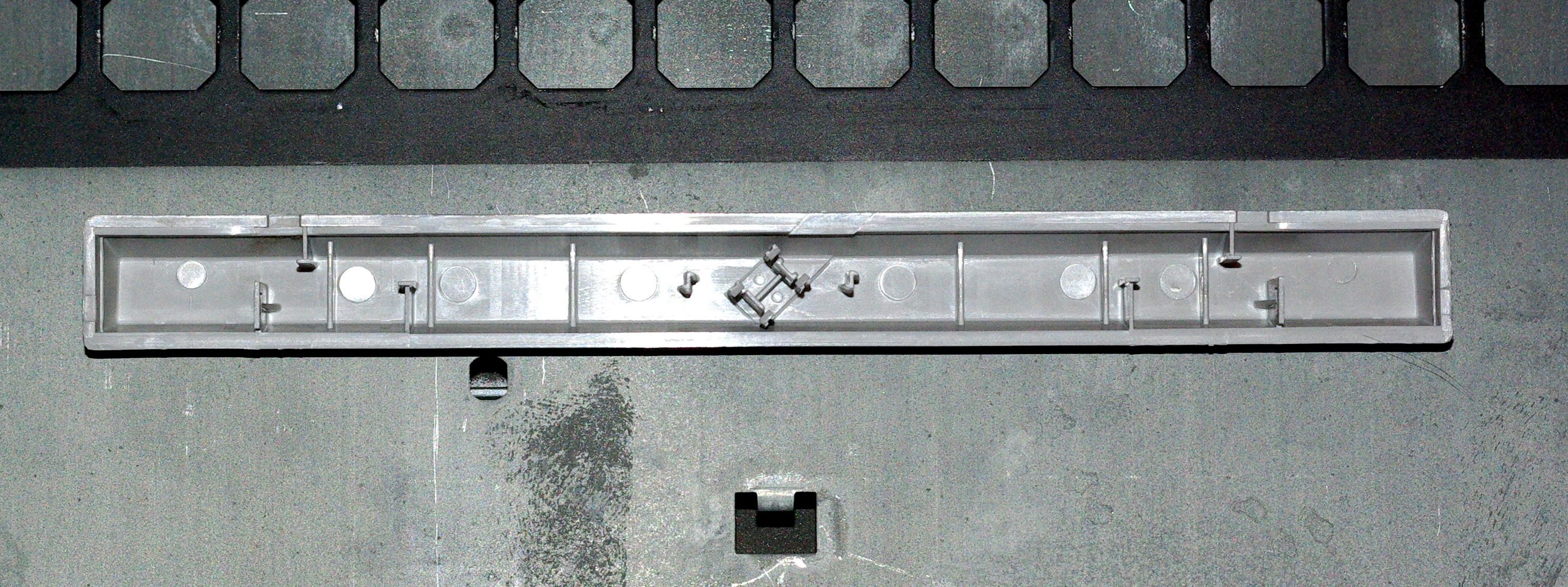

The spacebar is massive at 10 units stabilized by a bar and two additional springs.

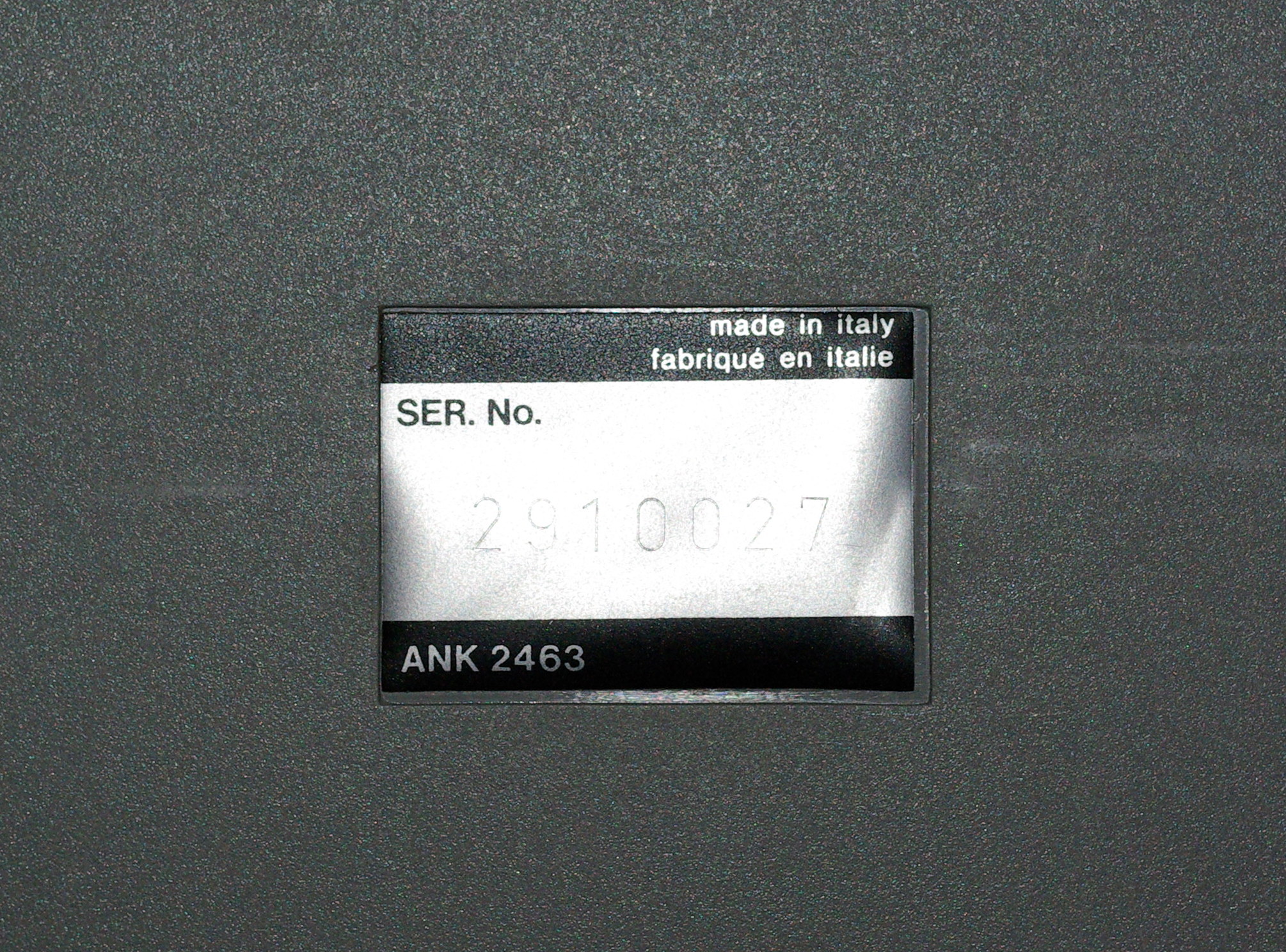

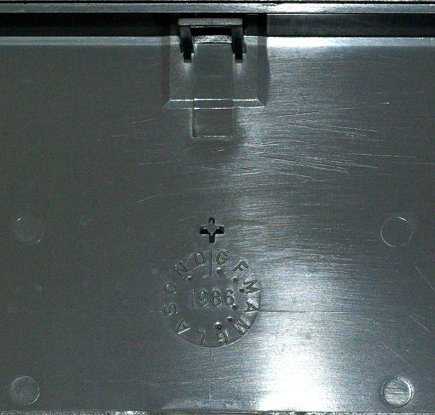

This keyboard is from 1986, according to wikipedia the M24 was discontinued in 1987.

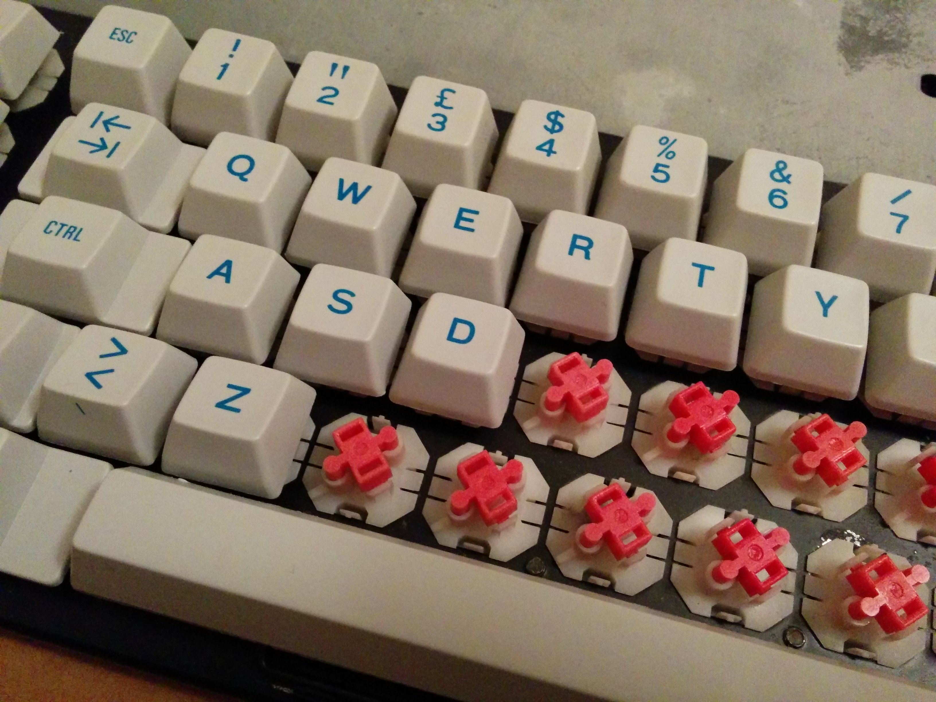

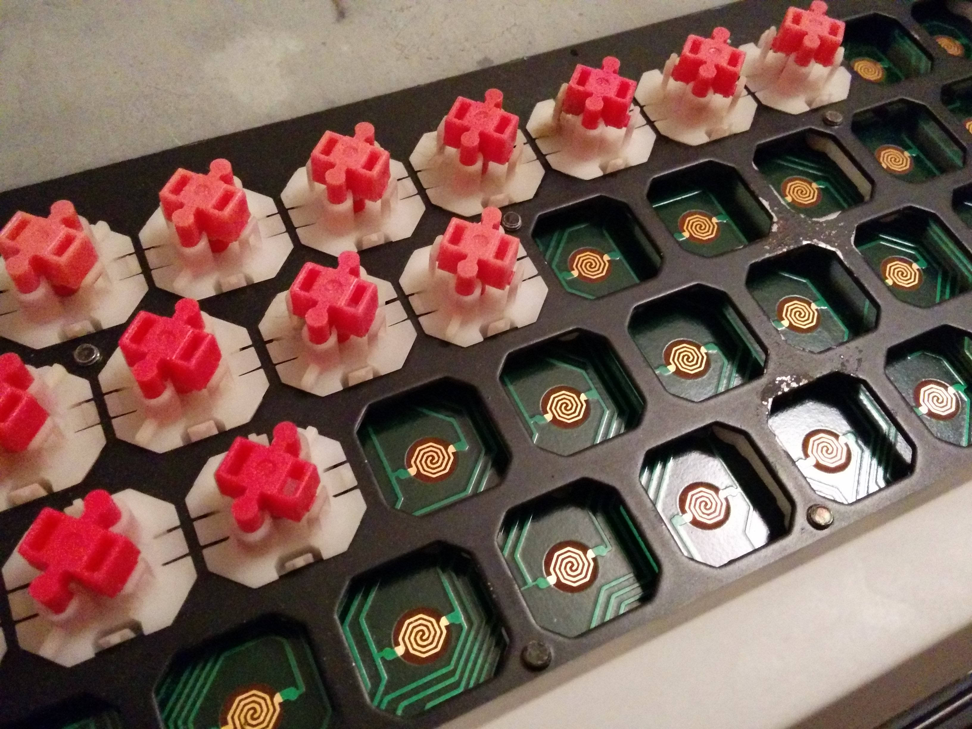

This keyboard uses the plate mounted tactile Olivetti dome with slider switch, the switch is a discrete unit that is held in the coutouts on the plate by a tiny snap-in mechanism. Very servicable like Nixdorf magnetic switches.

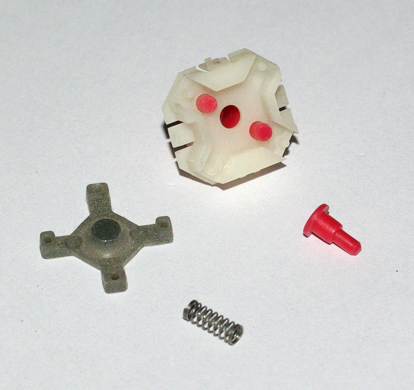

The switch consists of housing, slider, spring, insert and rubber mat that fits over the bottom part of the switch housing.
AT&T and Xerox also used this switch in some of their keyboards. I'm not sure if the color of the slider has any meaning, I have only seen white ones and these red ones. Some of the sliders on this keyboard have a paler lighter almost pink color, but all the switches feel the same. You can read more about the Olivetti dome with slider switch here:

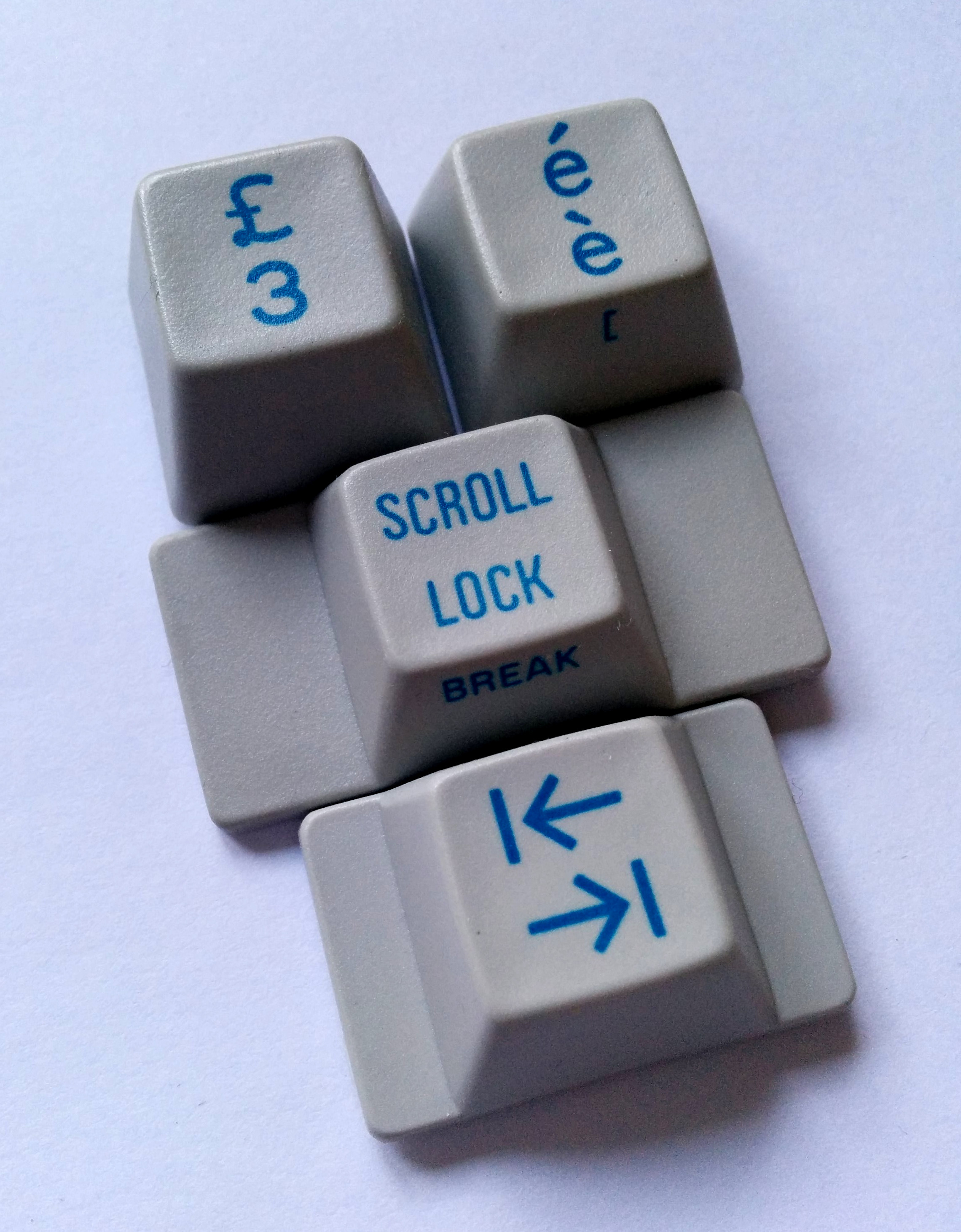

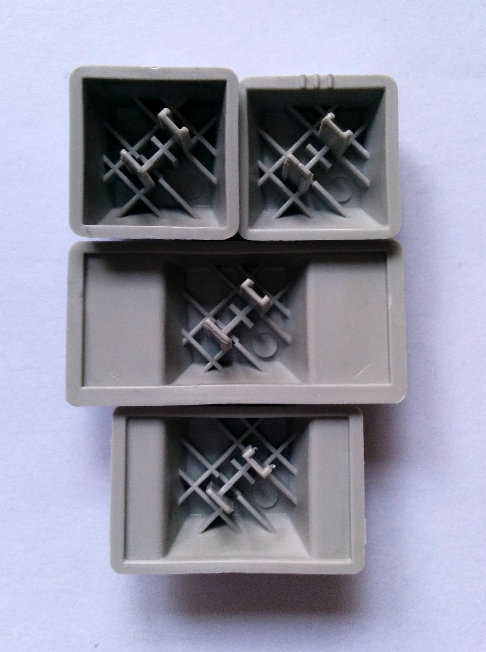

The color of the printing is one of my favorite ever:

I suppose the white balance is off in the key caps close up pictures, they have a blue tint, while the keyboard one looks beige, or with white towards green or yellow. I wonder what is the actual color of the key caps, they look great. I am typing on XT ANSI vintage Cherry keys that came from a keyboard with MX switches that had a similar layout, but in ANSI style.
22 Dec 2016, 21:05
ideus wrote: I suppose the white balance is off in the key caps close up pictures, they have a blue tint, while the keyboard one looks beige, or with white towards green or yellow. I wonder what is the actual color of the key caps, they look great. I am typing on XT ANSI vintage Cherry keys that came from a keyboard with MX switches that had a similar layout, but in ANSI style.
Very good observation! I shot the closeup of the pulled keycaps with my phone and the actual keyboard shots with my DSLR, if you ask me both color balances are off. In real life the keycaps are a very light grey with the printing even more vivid blue / turquoise than on the picutes. Sorry about that.

Oh no worries. I just want to understand the colors in these nice key caps. There is an upcoming GB for an Olivetti set that I should reconsider joining.

They look fantastic but I was so disappointed with the feel of these switches -- particularly the binding effect when not hitting them square on point. What do you think of them, seebart?
24 Dec 2016, 10:23
002 wrote: They look fantastic but I was so disappointed with the feel of these switches -- particularly the binding effect when not hitting them square on point. What do you think of them, seebart?
Yes that pretty much sums it up, I cleaned the individual parts of one switch completely, no difference really. It's the design of the mechanism itself IMO. If you hit the switch dead on it's OK really but still somewhat "dull". That's why this keyboard is not really worth any effort towards conversion . It's all looks, although the follow up model is even more impressive if you ask me, I'll add mine to our wiki tonight.

While they do look cool with their coloured Alt and Ctrl keys, they are doubleshot ABS and actually yellowed quite a bit and they seem quite brittle and chalky, so I think the example you have is better for the keycaps in general -- being dyesub and all.

Yes the keycaps on mine are real nice, no yellowing whatsoever. The switch is interesting from a technical point of view but the feel is quite undesirable. As so often with these oldies it's an elaborate construction that fails in practical terms. My ANK 25-102 feels snappy smooth compared to this.
