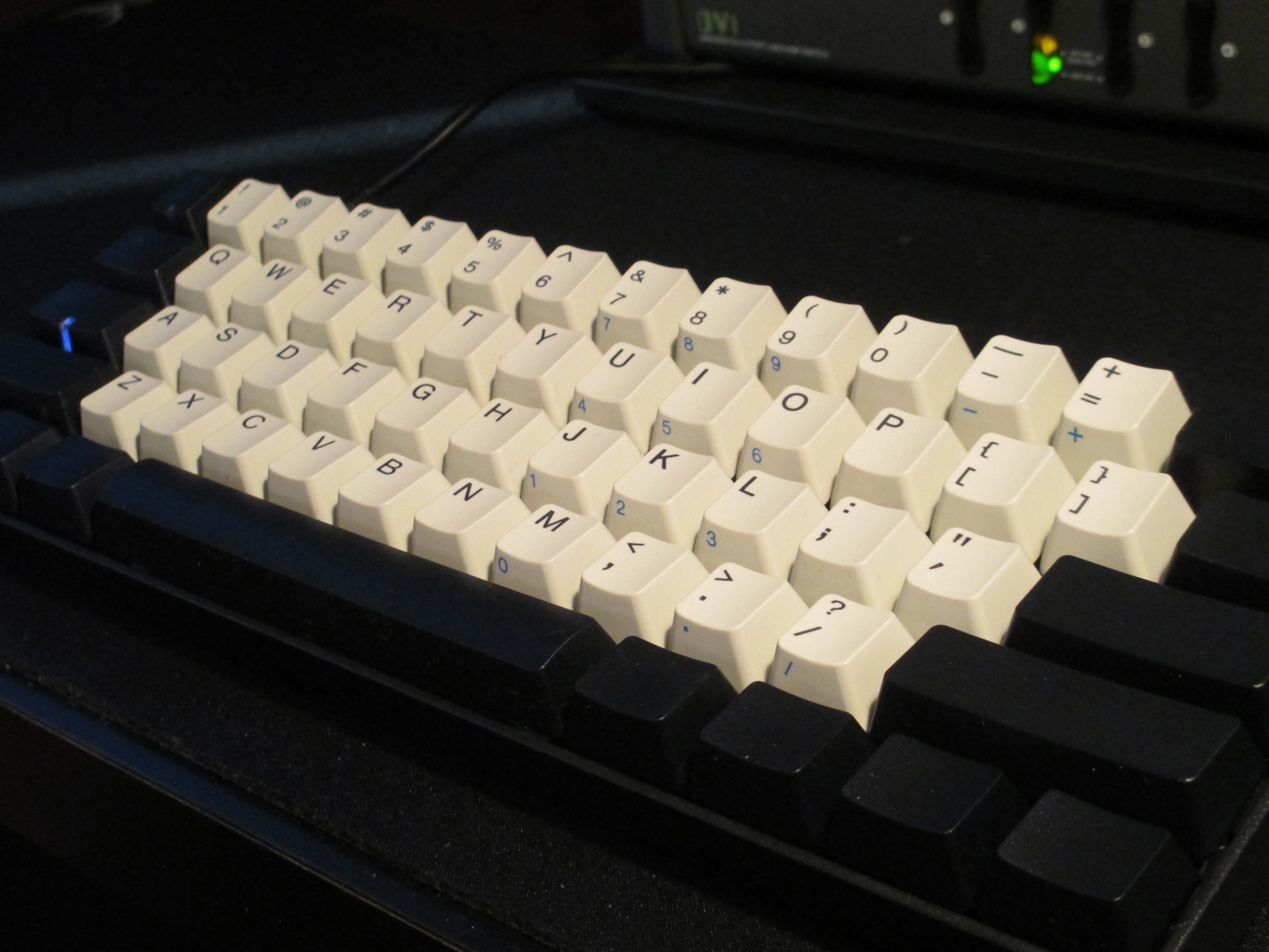

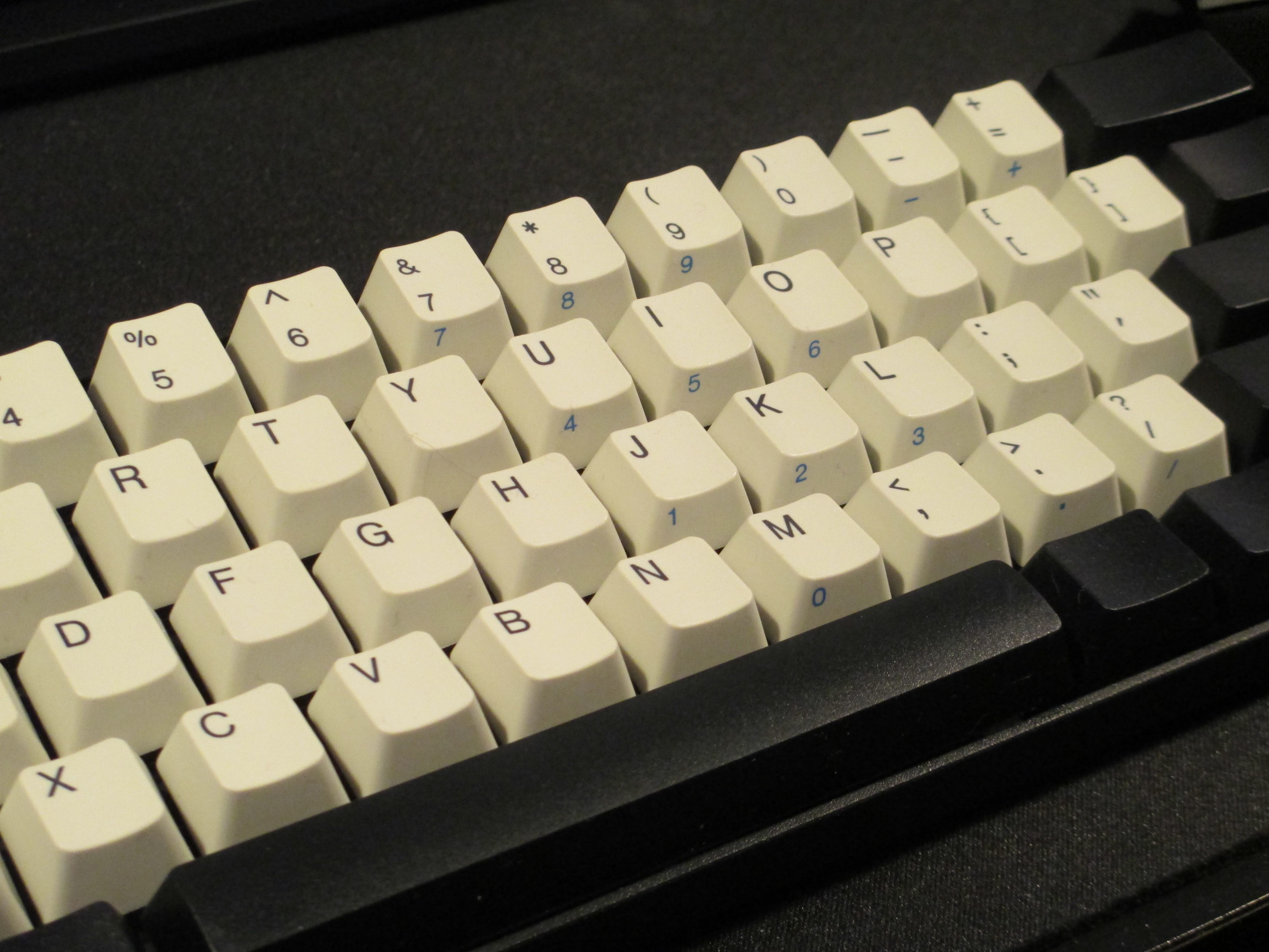

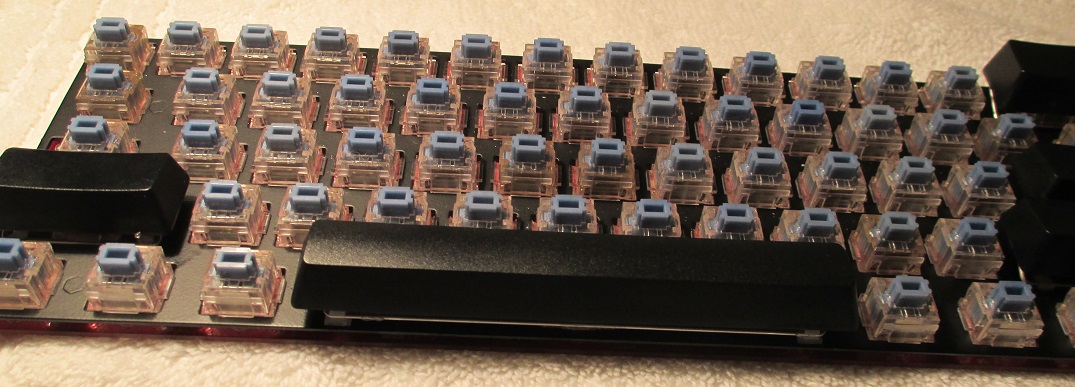

Here is my latest Matias hybrid -- Matias Click housing with slider, spring, and click leaf from Blue Alps. I'm provisionally calling it the "MatiaBlue" switch.
Here is a KBP V60 with the hybrid switch:
The spacebar has a slider from a Matias Quiet switch.

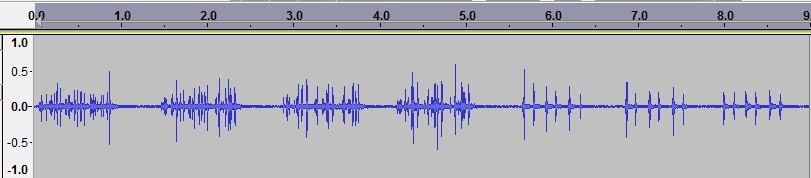

Here is an audio waveform of a KBP V60 with standard Matias Click switches:

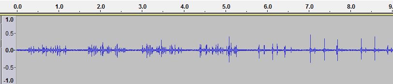

And a waveform of a KBP V60 with the hybrid MatiaBlue switches:
And here is a video showing the two keyboards along with audio clips recorded under the same exact conditions.
The keystrokes are: -09 poi lkj .,m Backpace x 3 Return x 3 Space x 3

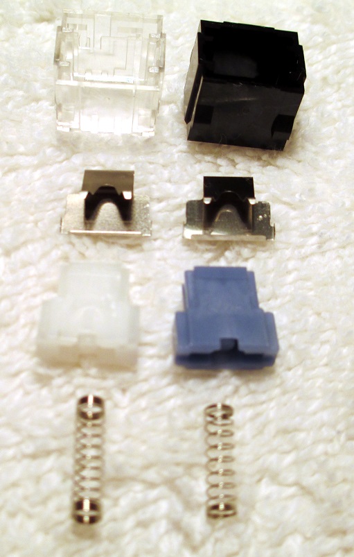

A bit hard to hear the action of the switch over the bottoming out, unfortunately (though that *is* real-life-conditions). But the MatiaBlues seem much deeper. How do they feel? Is there a difference in using the blue vs Click sliders alone, outside of the leaf variation? If possible, could you post a photo showing the blue, click and a SKCM White slider side-by-side, if you have them, to show the differences?
I'd be very interested if there is actually a difference between them, and if they *themselves* make for a difference in sound and keyfeel.

Yes, I have a heavy hand on the keyboard. I tend to bottom out every keystroke. However, after using the hybrid-switch keyboard for a while, I seem to have developed a lighter touch, perhaps as an adaptation to the lighter feel of the switches.
There certainly are many variables to consider with Alps and Matias switches!

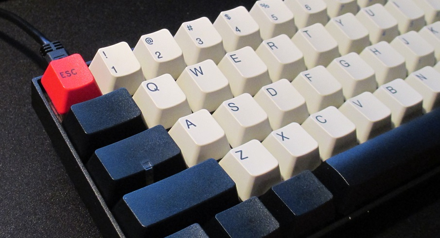

The IBM keycaps are beautiful. It also turns out that the red Esc keycaps from SP look fine on the V60 with the IBM and Matias caps. The difference in profile is not really noticeable, at least to me.
I will see if I can round up some of the components and post side-by-side photos. Keep in mind, however, that even if some of the corresponding parts of Matias and Blue Alps switches appear to be the same, they could still differ in composition.
BTW, I am thinking of a new name for the Matias / Blue Alps hybrid switch: "Matiblu" (inspired by "Malibu").
Hypersphere
08 Nov 2016, 18:38
Here is a potato pic of the top housing, click leaf, slider, and return spring from a Matias Click (left) and Blue Alps (right) shown side by side. The reflectance is off -- the springs and click leaves should look silver-colored rather than gold-colored, and there is a speck of dust on the Blue slider.
From my own visual inspection of the actual components, the click leaves appear to have the same dimensions. Likewise, the sliders have the same dimensions, but the Matias Click slider has cutouts on both sides, whereas the Blue slider has a cutout on only one side -- the side facing the switchplate. The return spring in the Matias is also longer than the return spring in the Blue Alps. The main differences are in the housings and especially (not shown here) in the switchplate mechanisms. It is the switchplate that got simplfied in the simplified Alps and Matias switches.
So, the Matiblu hybrid is different from an unmodified Matias Click switch, but it is also different from a Blue Alps switch. The Matiblu is quieter and lighter than a Matias Click switch and has less wobble, but it is not a Blue Alps switch.

Hypersphere wrote: It also turns out that the red Esc keycaps from SP look fine on the V60 with the IBM and Matias caps. The difference in profile is not really noticeable, at least to me.
I did the same thing on my V60 mini. I added a red/white ESC key from SP to my Tai Hao Dolch keyset and it looks fine. It's a little odd if you examine it closely though; the bottom of the keycap doesn't extend as far down as the Dolch keys and the top rests just a touch higher than the Dolch keys. But overall it works fine and isn't noticeable when typing or only casually looking at it.
Hypersphere
08 Nov 2016, 18:53
@zslane: I didn't think you ever looked casually at anything! ;)
In any event, it's nice to know that we can each make use of our SP red Esc keycaps!
zslane
08 Nov 2016, 18:59
Looking casually is the only way I can stand to look at cylindrical keycaps. ;)

UPDATE: The more I use the V60 with the Matiblu hybrids, the more I like it. At first, the switches seemed too light, but after adjusting to a lighter touch, I appreciate the feel and the quieter sound compared to the Matias Click switches.
I suspect that just about the same effect could be achieved with a white Alps/Matias hybrid (slider, spring, and click leaf from White Alps) in the housing of Matias Click).
