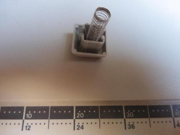

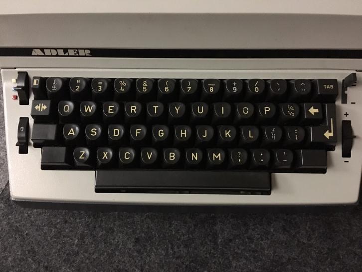

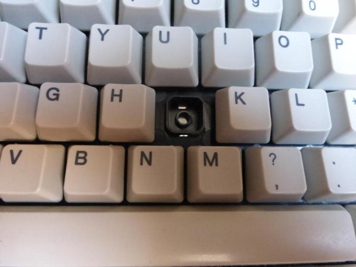

Could you help me identify the switches used on some typewriters(they're not mine yet, I can buy them for 5-15 euros a piece). The first two picture are from an Olivetti Praxis 20, and the last two are from a Nakajima AX60. I asked the seller to take some pictures for me.

That looks like ordinary rubber dome and spring over membrane. Some old Brother printers came with dome and foil switches, and some Smith-Coronas came with the especially vile S-C leaf spring over membrane switches.

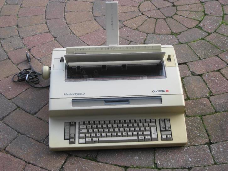

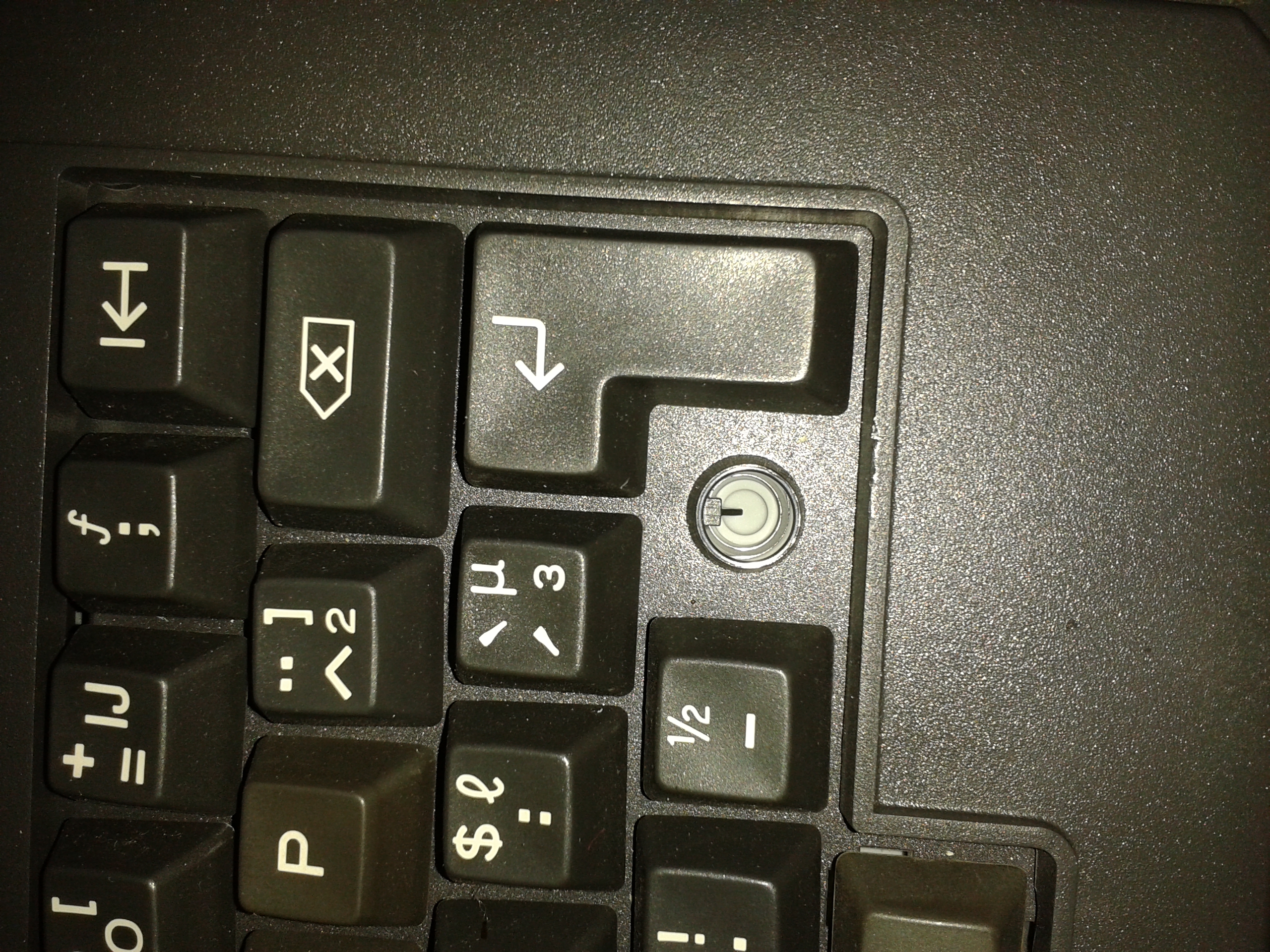

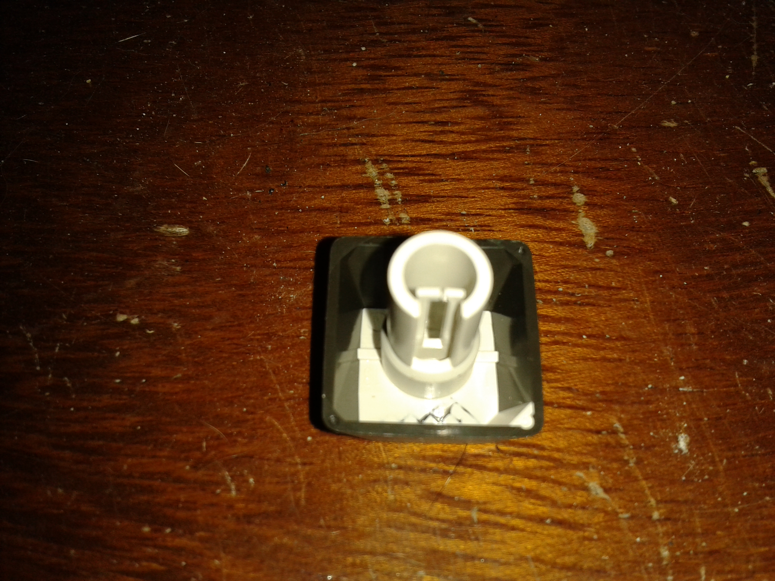

Thanks for the help! Do you happen too know anything about the Triumph Adler(The gabriele 5000 and gabriele 100) or the Olympia as well?
Here's some pics:
Triumph Adler Gabriele 5000
Olympia Mastertype D

We have a triumph adler wiki.

The Olympia most probably has these switches: wiki/Marquardt_Two_Fingers_Typewriter_switch
I have a very similar board here.
