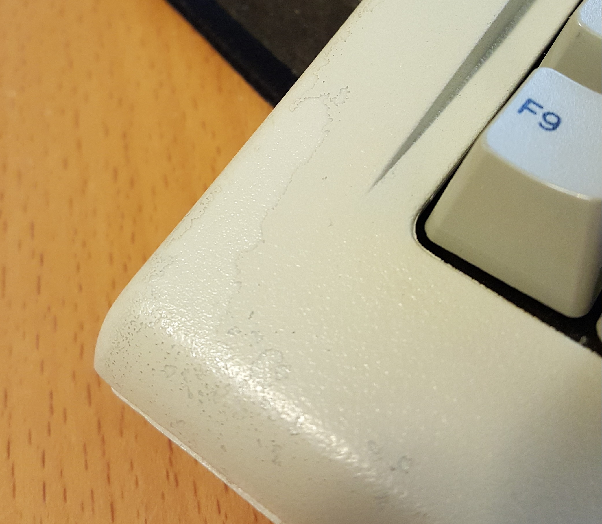

Hey guys, I'm sorry to necro this aging thread, but I was looking for this exact topic and didn't really want to open a new thread for it. The paint is worn off of the bottom left corner of my F AT, and I just learned today that it is in fact paint - I originally thought that the plastic in the corner was just so worn by friction that it had become smooth/shiny. Anyways...the lighter colored surface underneath still has a nice texture and I don't mind the color at all - couldn't I just scrape/remove the rest of the paint with thinner or alcohol to make the keyboard uniform again? I mean, the keyboard sits in my basement apt, doesn't get any sunlight and hardly ever moves from the desk - is the paint really doing anything to protect it at this point? I'm only worried that the surface under the paint isn't a uniform color, or that the paint will be very hard to remove in some places and leave me with a patchy looking top cover. Thoughts?

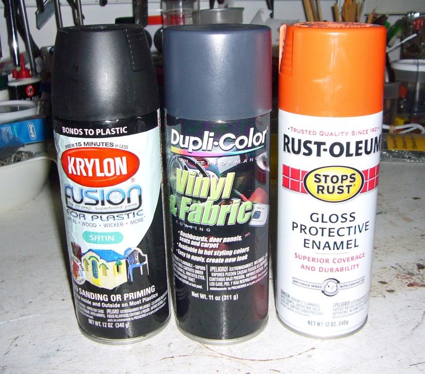

In the construction world paint is considered as "film-forming", while stain is considered as "penetrating" but that is not entirely germane here. I would be hesitant to remove the outer layer - you might do better to simply prime it and paint it.
My results using "Dupli-Color Vinyl and Fabric Coating" (available in the US at auto supply stores) has worked very well for me but it is thin and does not fill in gaps with much thickness of its own.
Engicoder
21 Mar 2017, 23:42
I think PC/XT keyboard has a texture coating of some sort. The dust from sanding it is more reminiscent of a sprayed on paint like coating than anything plastic. The inner plastic is smooth with no texture. The early models have grey plastic cases under the textured coating which does not seem to glossy.
I agree that restoring this texture, especially on a small section would be quite difficult. It would be much better, as you say, to use a paint with very thin build up. I like the high quality art sprays like Molotow. They have great nozzles that emit a very fine mist that allows great control over layer thickness.

Thanks for the responses guys! But check it out, I'm not too concerned about restoring the texture because as this picture shows, the texture underneath this 'coating' is the same. It literally looks like this slightly darker beige paint/latex film was applied over the lighter plastic, and it's the lighter colored plastic underneath that provide the texture. So my question is - because I can literally scrape this stuff off with a fingernail, as I've tested on this corner, couldn't I just scrape the rest off carefully and expect to end up with a still-textured keyboard of this color and texture?
Cattus_D
23 Mar 2017, 08:27
Harshmallow wrote: Thanks for the responses guys! But check it out, I'm not too concerned about restoring the texture because as this picture shows, the texture underneath this 'coating' is the same. It literally looks like this slightly darker beige paint/latex film was applied over the lighter plastic, and it's the lighter colored plastic underneath that provide the texture. So my question is - because I can literally scrape this stuff off with a fingernail, as I've tested on this corner, couldn't I just scrape the rest off carefully and expect to end up with a still-textured keyboard of this color and texture?
Interesting question. Are you sure it's the plastic that's providing the texture and not another layer of paint underneath the yellowish one?
I haven't tried restoring the paint of my Model F XT yet, but am contemplating using a thin layer of acrylic paint.
Harshmallow
23 Mar 2017, 16:30
It would seem quite strange to have a second layer of paint/coating - I'm almost positive that is the base plastic layer. I suppose I could scratch a tiny spot to make sure, but it looks and feels just like plastic - I don't see why the plastic cover couldn't provide the texture for this board instead of the paint layer. This is also the most modern F board, so maybe the plastic is different?
