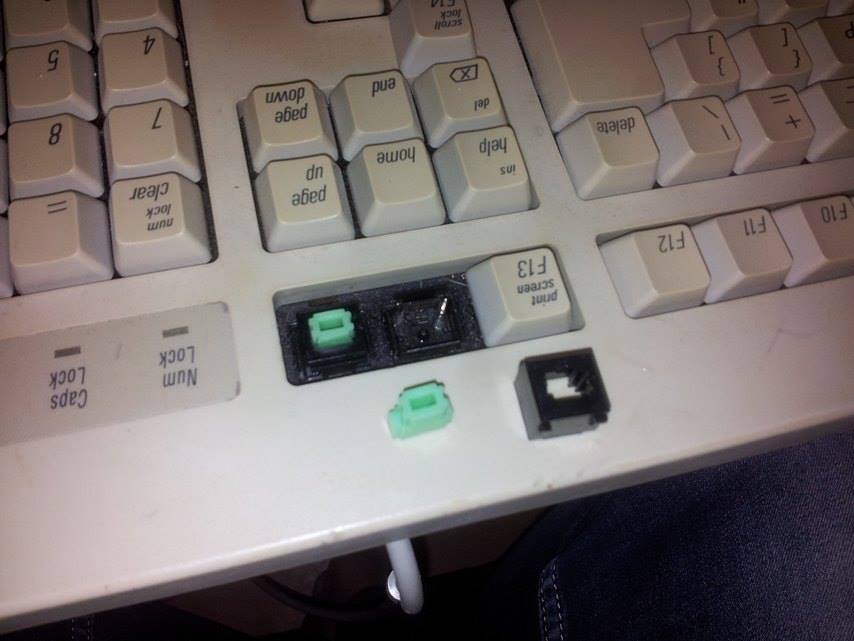

I recived this Mac keyboard with my PMacintosh 7500.
And it contains non-clicky, tactile Alps colnes (Are they actually clones, or an other alps-mount brand, like Omron?)
The prev. owner told me that the keys were sticky, so he lubricated them. Yupp, the keyboard was on the top of the computer, and the Mac was swimming in WD-40. Yuck! How could anyone lubricate switches this badly?

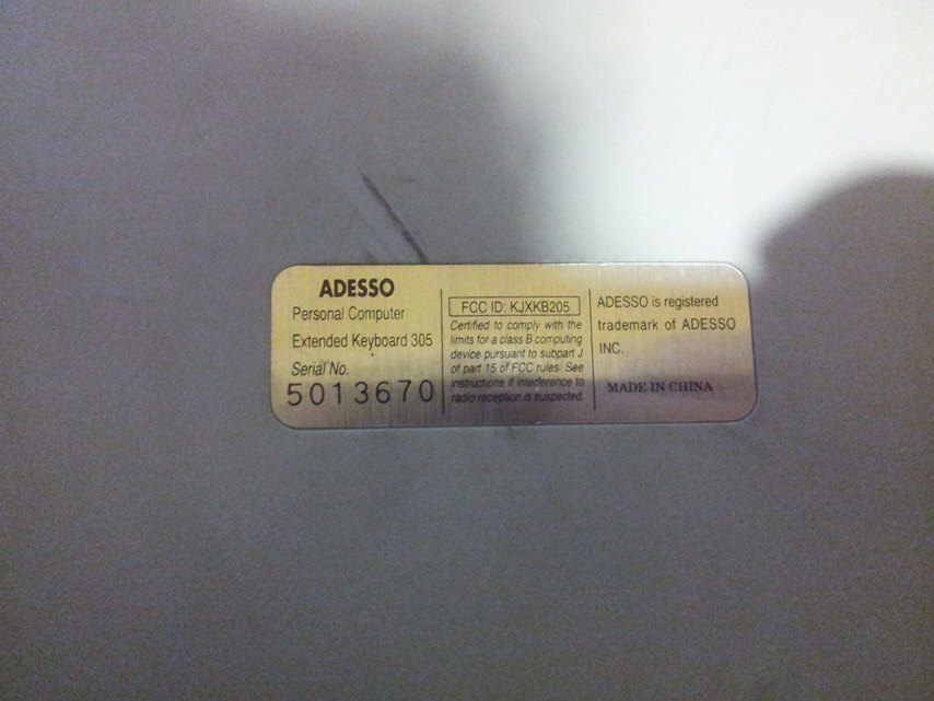

The keyboard is called Adesso. Are theese switches common?
EDIT: I'm going to try to make a better picture. What you can't see, are the contact leaves.

Sad. No chance to see which clone it is. It always a big question about which swithes on FCCID KJXKB205 keyboard.

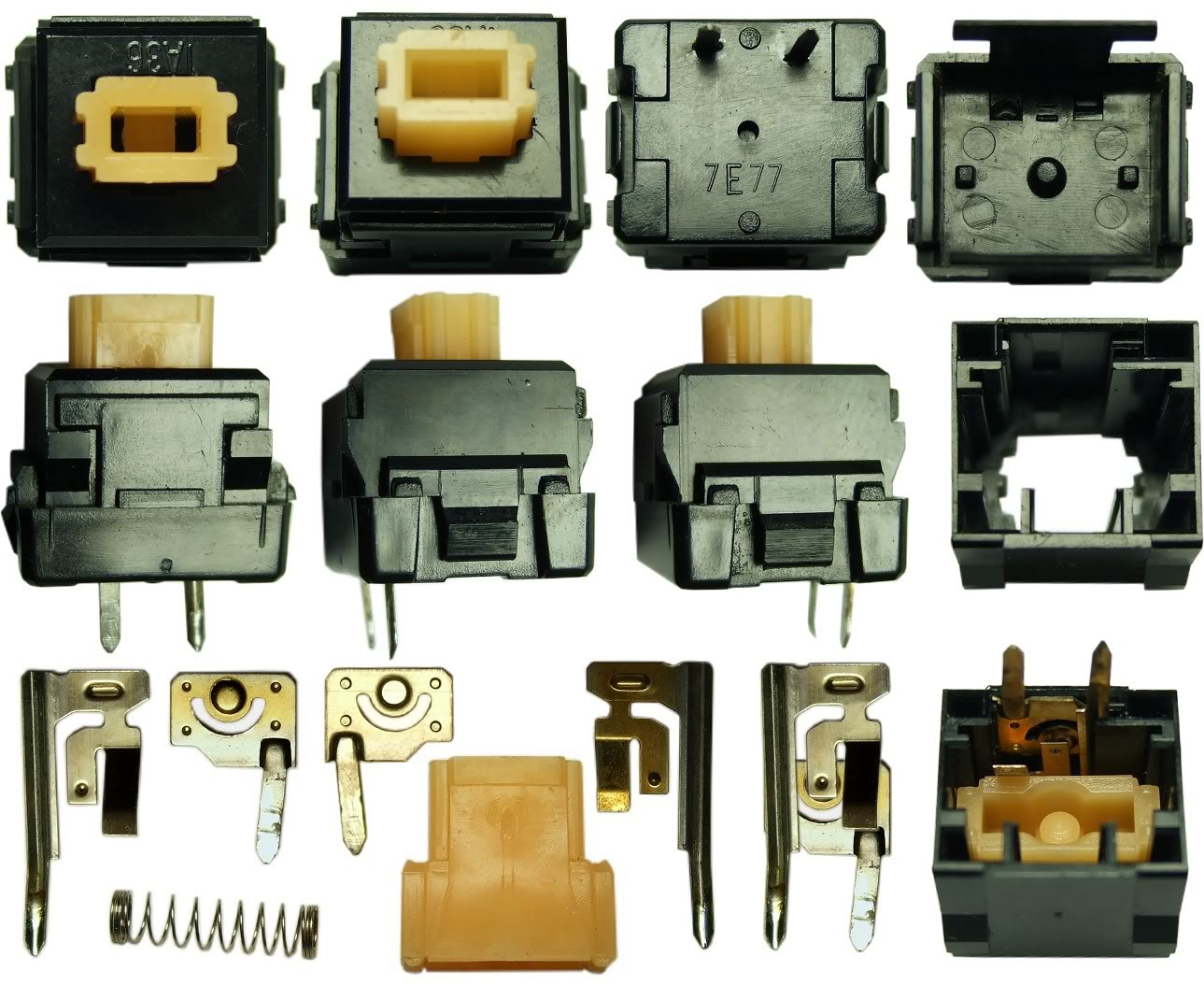

EDIT: The inside looks like simplified alps as far as I can tell. The leaf spring is bent in, giving a verry good tactile feedback.

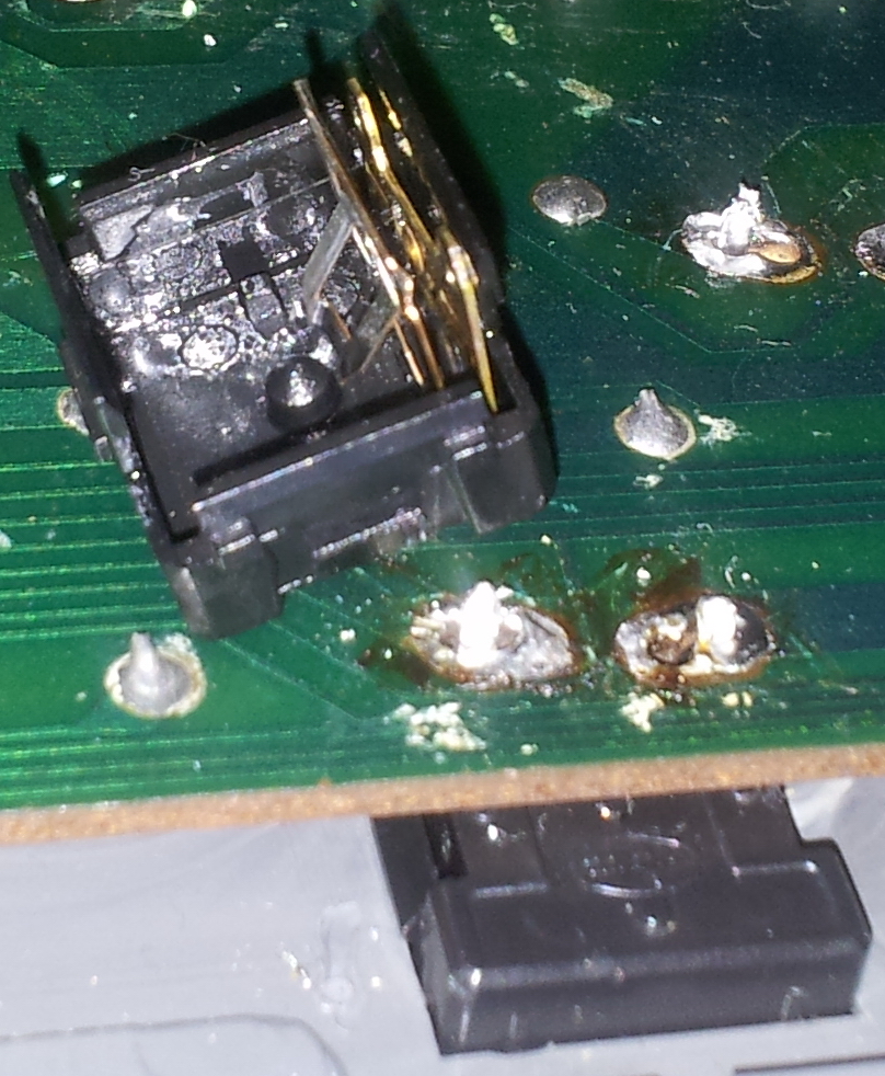

Weeeeeelllll, I ran into some problems. While desoldering the switches, I dropped it, and the pcb cracked on a few points, just flakes. Can be fix'd... There is no interesting stuff on the bottom on the switches either.
EDIT: Random numbers: 2Exx
XX=19, 20, 13, usw.
The return key is a linear yellow switch, with this: 3E31. It's also heavyer.

Will have to check it, but linear only was under the big-ass return key.
terrycherry
05 Sep 2016, 18:58
Is the green switch under the space bar?
Is it something special under the Caps lock?
Can't wait to see your photos if it is possible 8-) .
Lynx_Carpathica
05 Sep 2016, 20:06
There is No tactile leaf, but there is tactile feedback on those switches.

Thanks you so much. It's a very very rare Himake switch. I never seen the alps clone with Himake logo on the switch base because Himake sold the manufacture of switch to Hua-Jie quickly.
Your Himake green and yellow one almost have the same internal with alps.tw Type OA2 but without click leaf and branding.
It's linear not tactile. I think you felt it was tactile because the spring was not stand on the middle tip of the internal of base shell. Try to take out the spring, clean the switch shell and assemble them correctly.

Your keyboard is the re-sold product of Ortek Mac-105 keyboard. There's something special under the Caps lock.

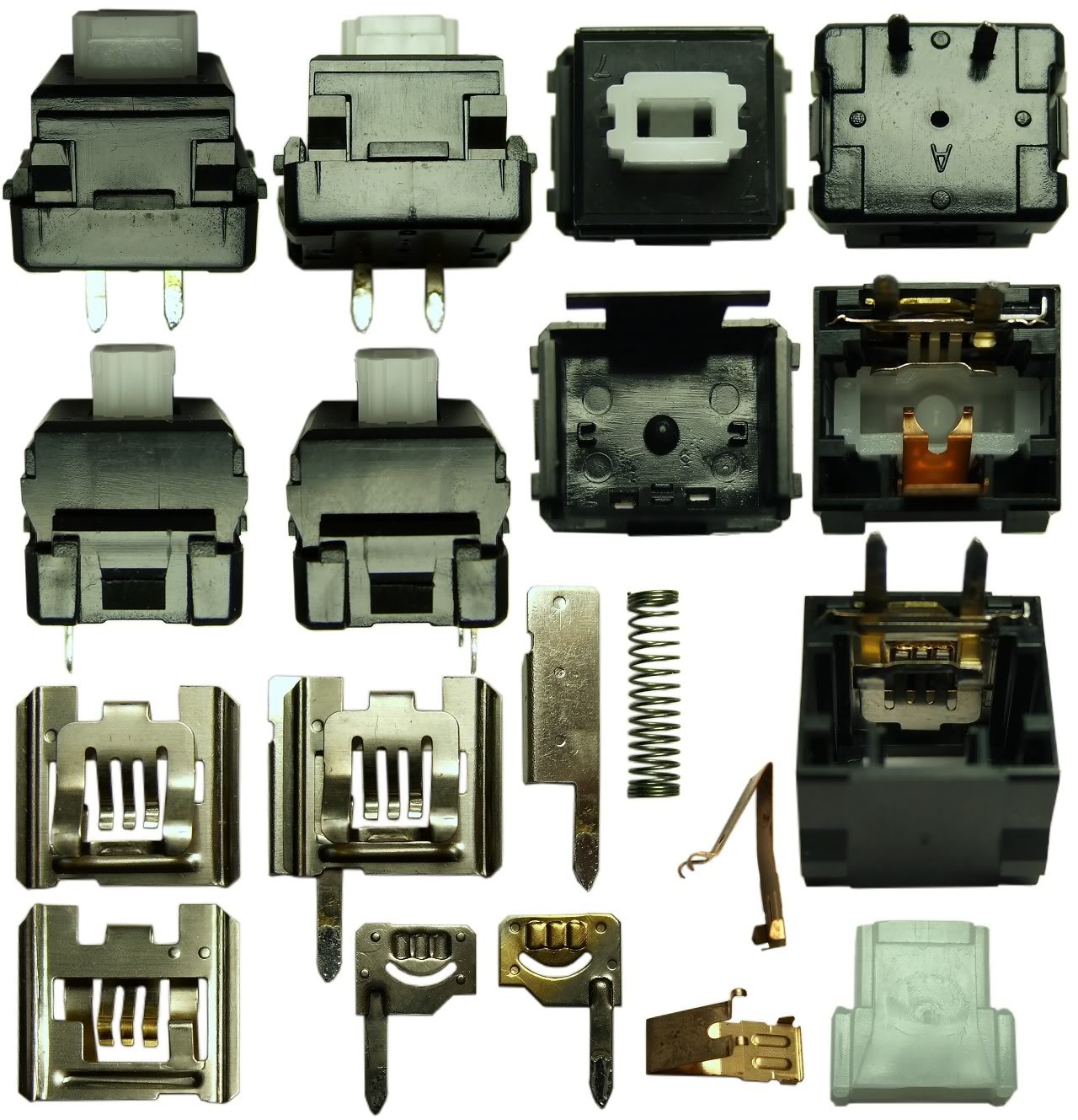

There they are...
https://1drv.ms/f/s!AlXE1_Pee0XpwiO69G-38i6BzReN
I've cleaned the switch, but it still has a very decent tactile feedback. It's very round, and feels very good.

Interesting, I never saw those pictures. It's a different design again: the stationary contact has two raised contact points instead of the usual one. It may be a better-made version of [wiki]alps.tw Type OA4[/wiki] (where they didn't get two fully distinct contact points).
I don't see any reason for one design to be tactile when the other is not — it makes me curious whether it's just a fluke that it turned out that way, or whether there really is something special.
What's the year on this keyboard? I can't read all the writing on the chip. OA4 seems to be a transition design, and your keyboard seems to likewise be transitional.
