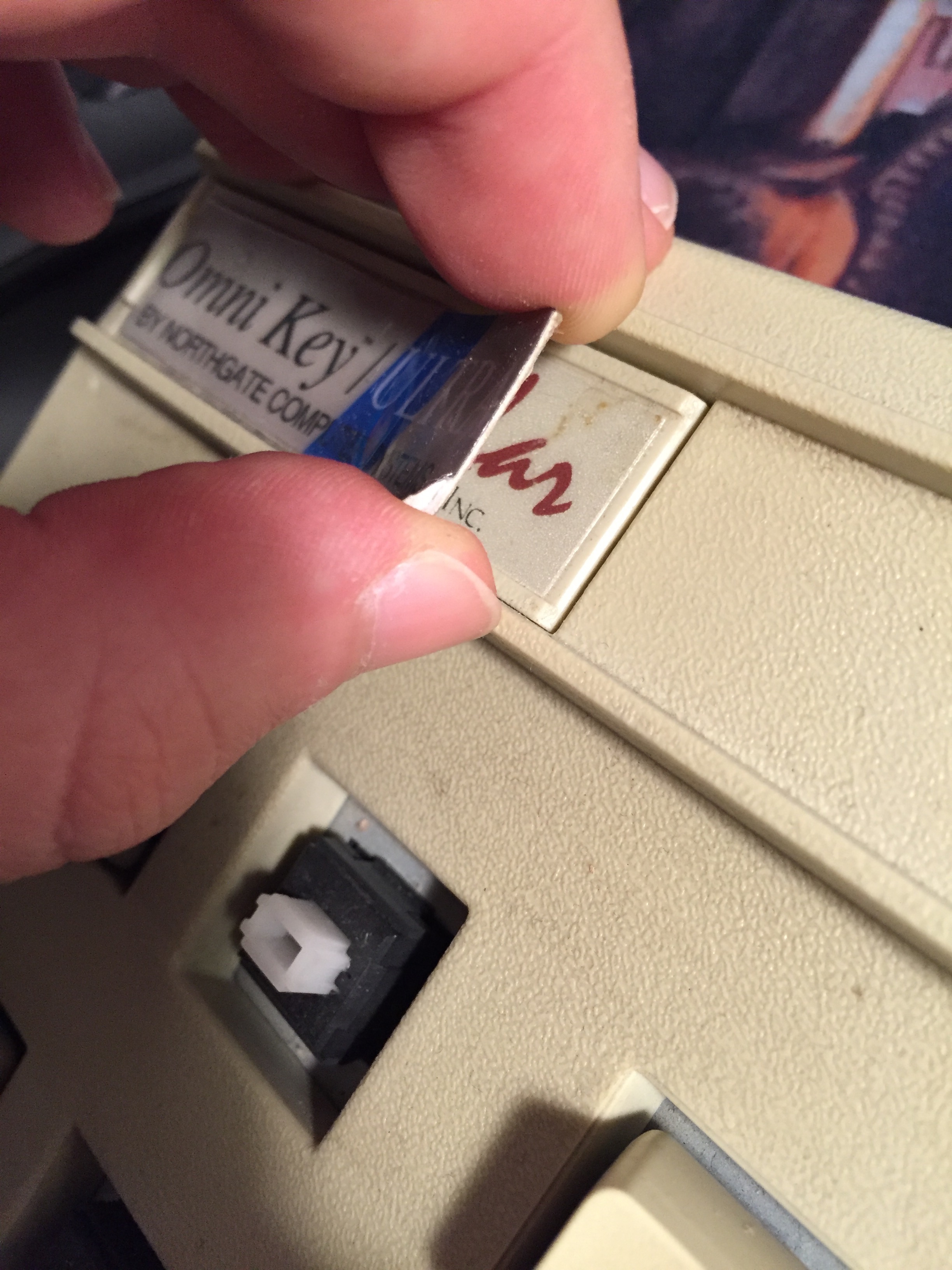

- There is (what looks like) a velcro pad above the numeric block that looks like it's glued down. I wondered what the best way is to remove it without affecting the (presumably ABS) keyboard case. I was thinking 70% isopropyl alcohol. Thoughts?

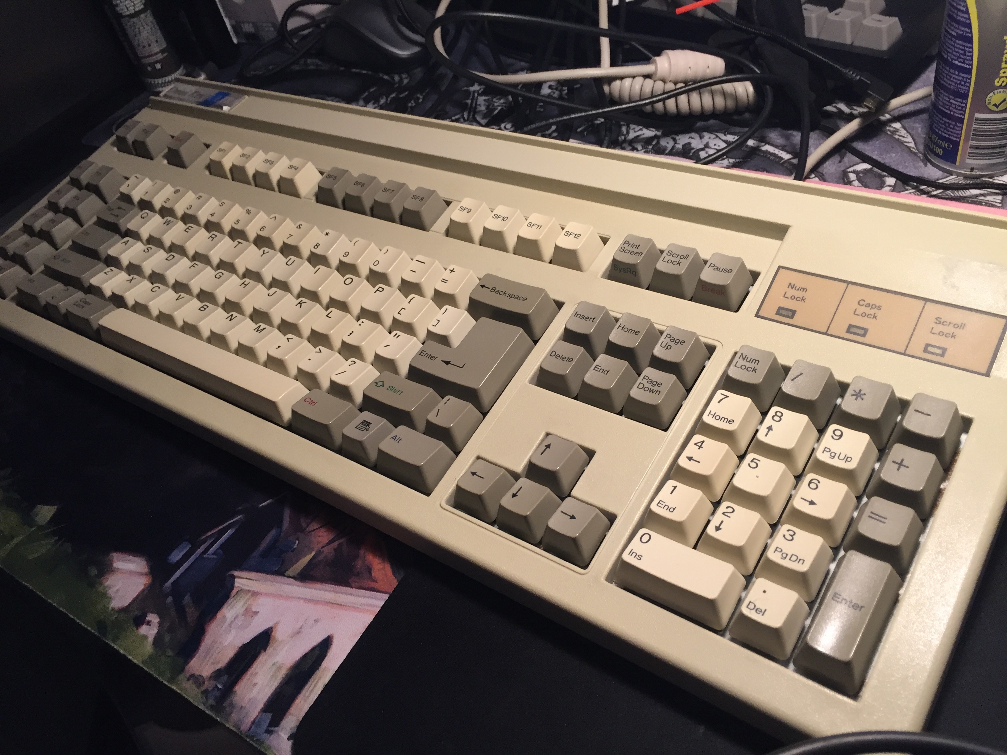

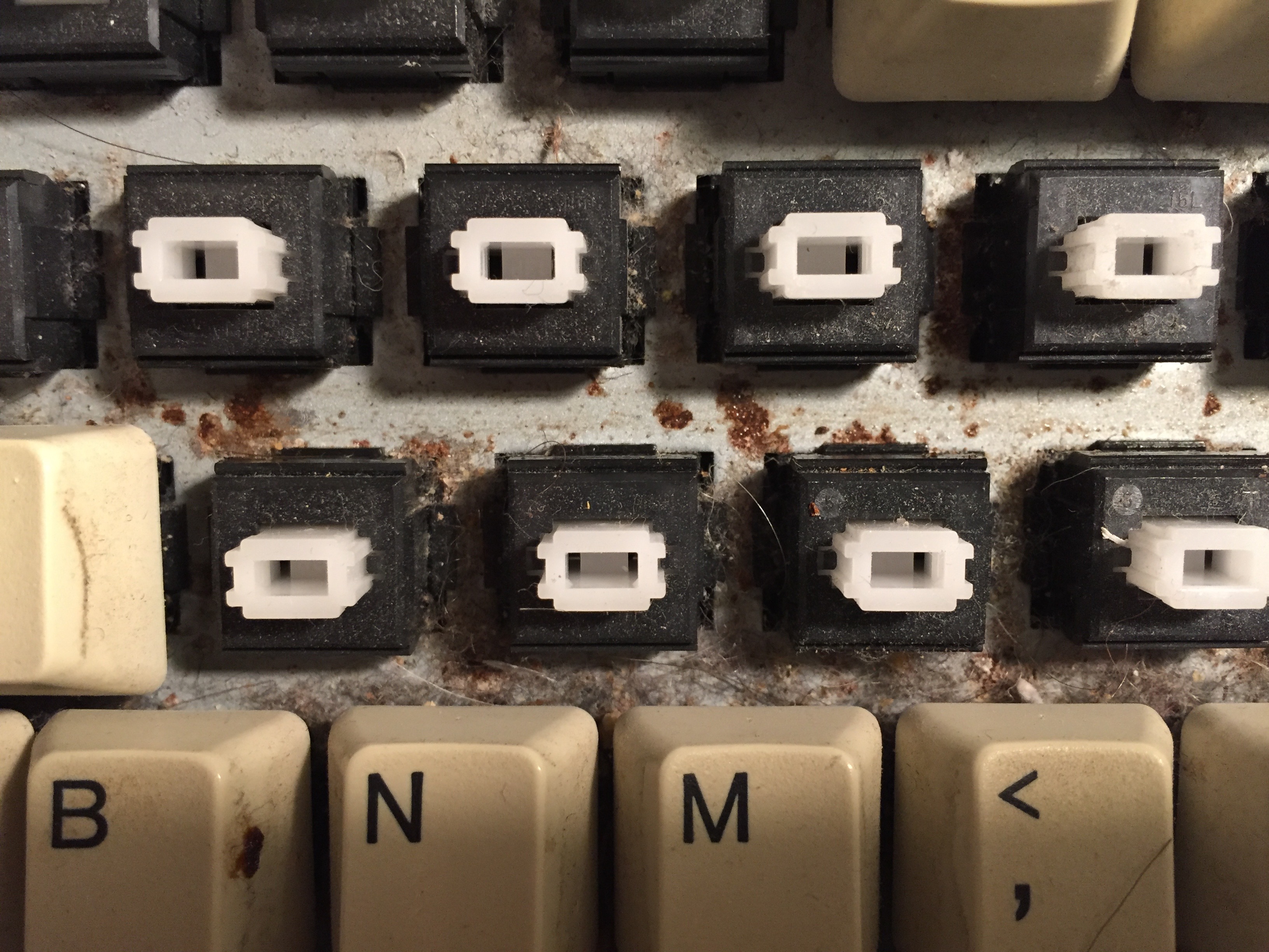

- What do you think about the condition? I know this is ridiculously vague... I hope it's not had too much use. The keys look pretty non-shiny.

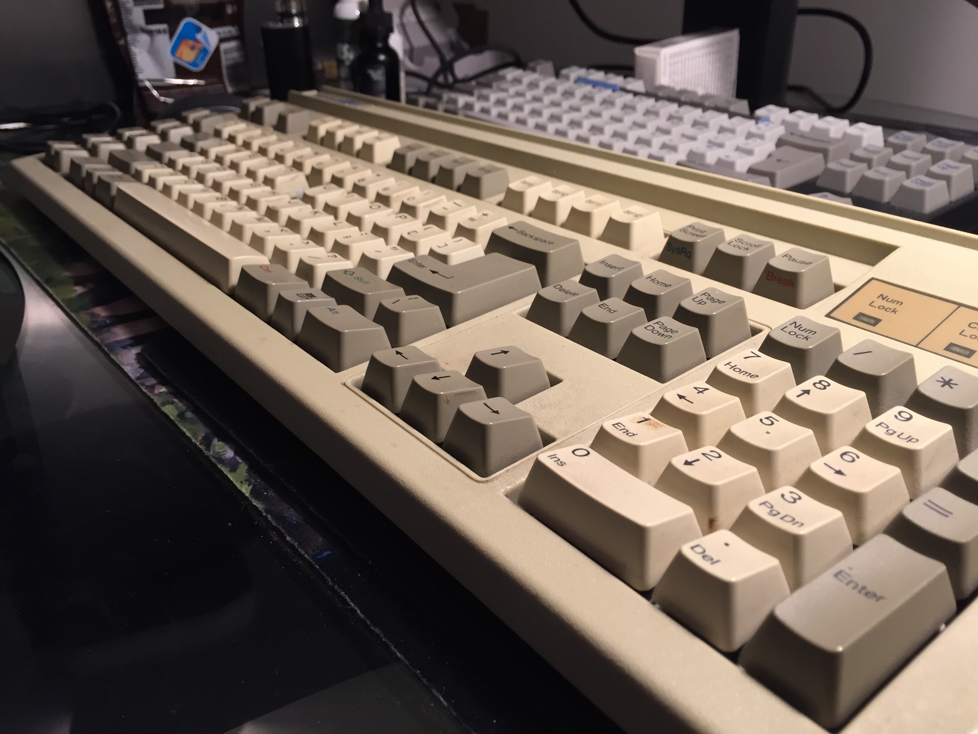

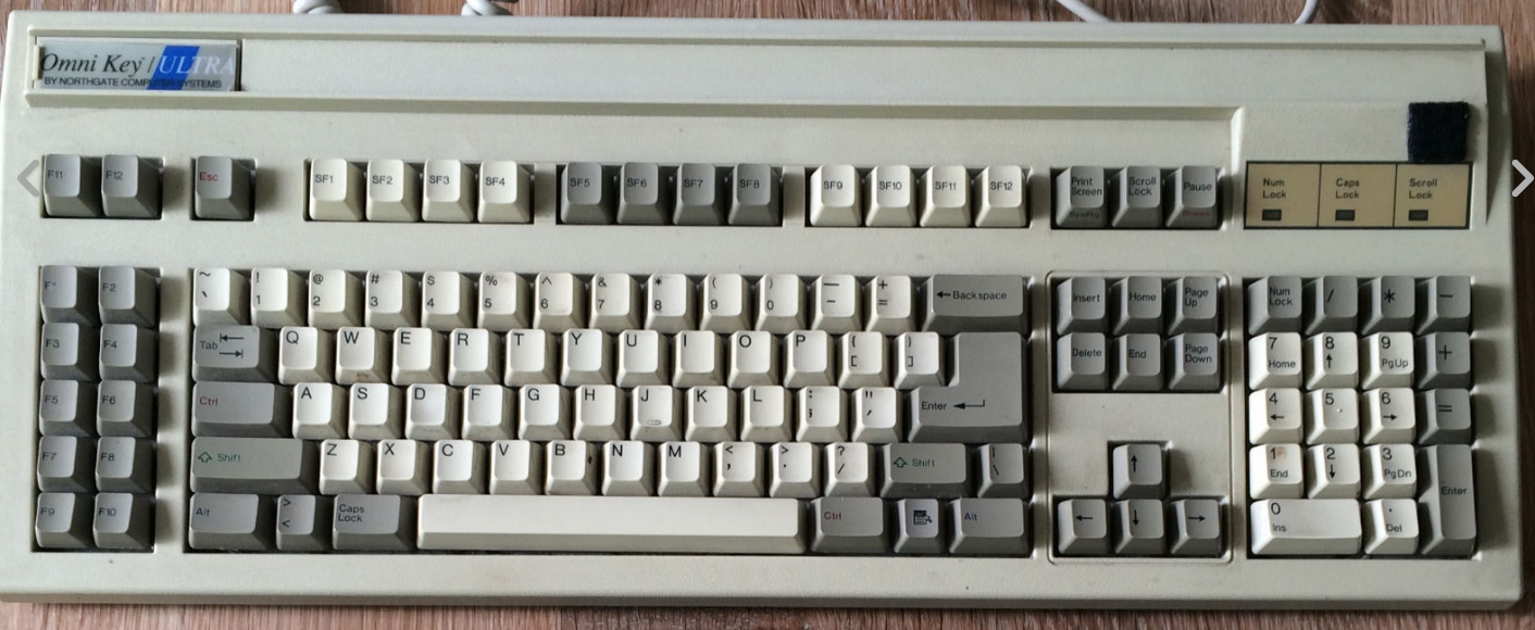

Just picked up an Omnikey Ultra. Few Q's: glue, interface and colour

With only this picture available it's hard to tell anything
1. if it's glued down with the standard adhesive, i'd say rip it off and use an eraser, isopropyl isn't necessarily the best glue removal tool
2. and 3. has information on the wiki wiki/Northgate_OmniKey_101
4. it's hard to tell from the picture, I'd say well used, note the smudges of dirt you can see on the numpad 1, side of B and @ and lighter smudges all over the numrow

1) The best way to remove sticky residues is with apolar solvents.lancre wrote: This was on Ebay for quite a bit of money, I let the seller relist a few times and then messaged them with an offer. I picked it up for quite a reasonable price. It's arriving next week.
- I watched Chyros and his keyboard review on YouTube (as well as every other review he's done) but I don't think he mentioned the interface. Is it a 5-pin DIM? Do I need an active converter or a passive one? Or is it PS2?
- The block with the lock lights is a yellowy-brown colour. I've seen some like this, whereas most have a grey background. Is this to do with yellowing or is it particular to some models?
2) I did mention it actually, you can set the protocol to a variety of things using the DIP switch and yes, it's PS/2 compatible
3) I think it looks slightly different from the sticker on mine, could be yellowing or not, dunno.
4) Hard to say without a cap-off picture mate xD .

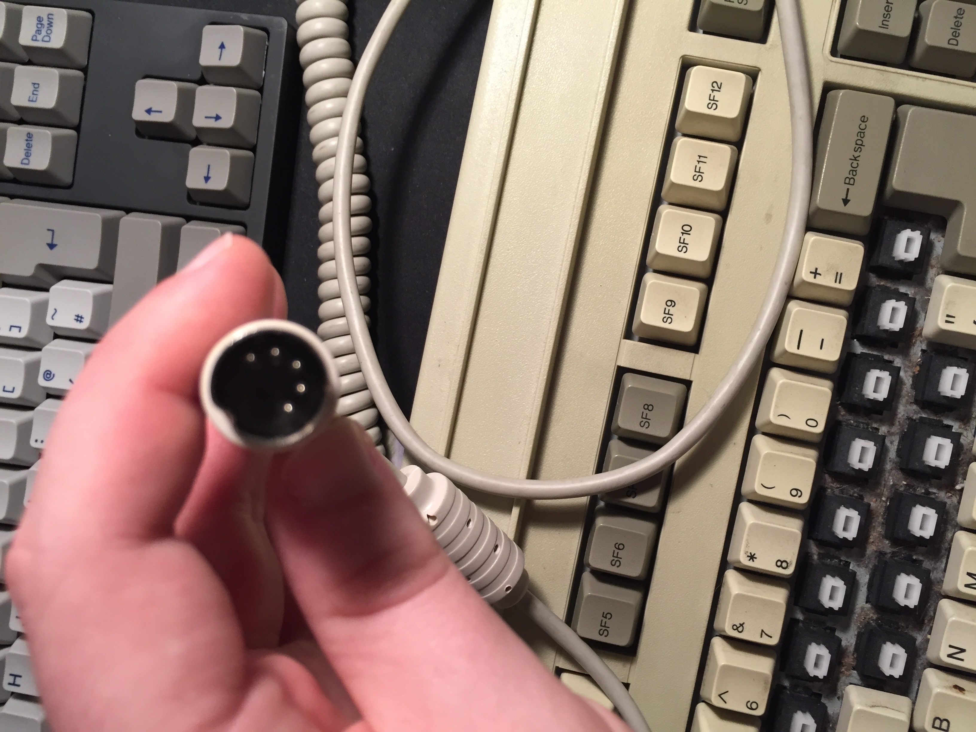

Oh and you can just use a male the male PS/2 cable for this keyboard or do what i have done and lob the end of an old coiled PS2 cable and connect a male connector on it

The cable on my Omnikey 101 is mini-DIN6 male to DIN5 (AT) male. From there I use an AT to PS/2 adapter and Blue Cube to the USB hub connected to the computer. However, a straight ps/2 to ps/2 cable should work. I'm considering installing a Teensy and replacing the mini-DIN6 connector with some flavor of flush-mount USB.

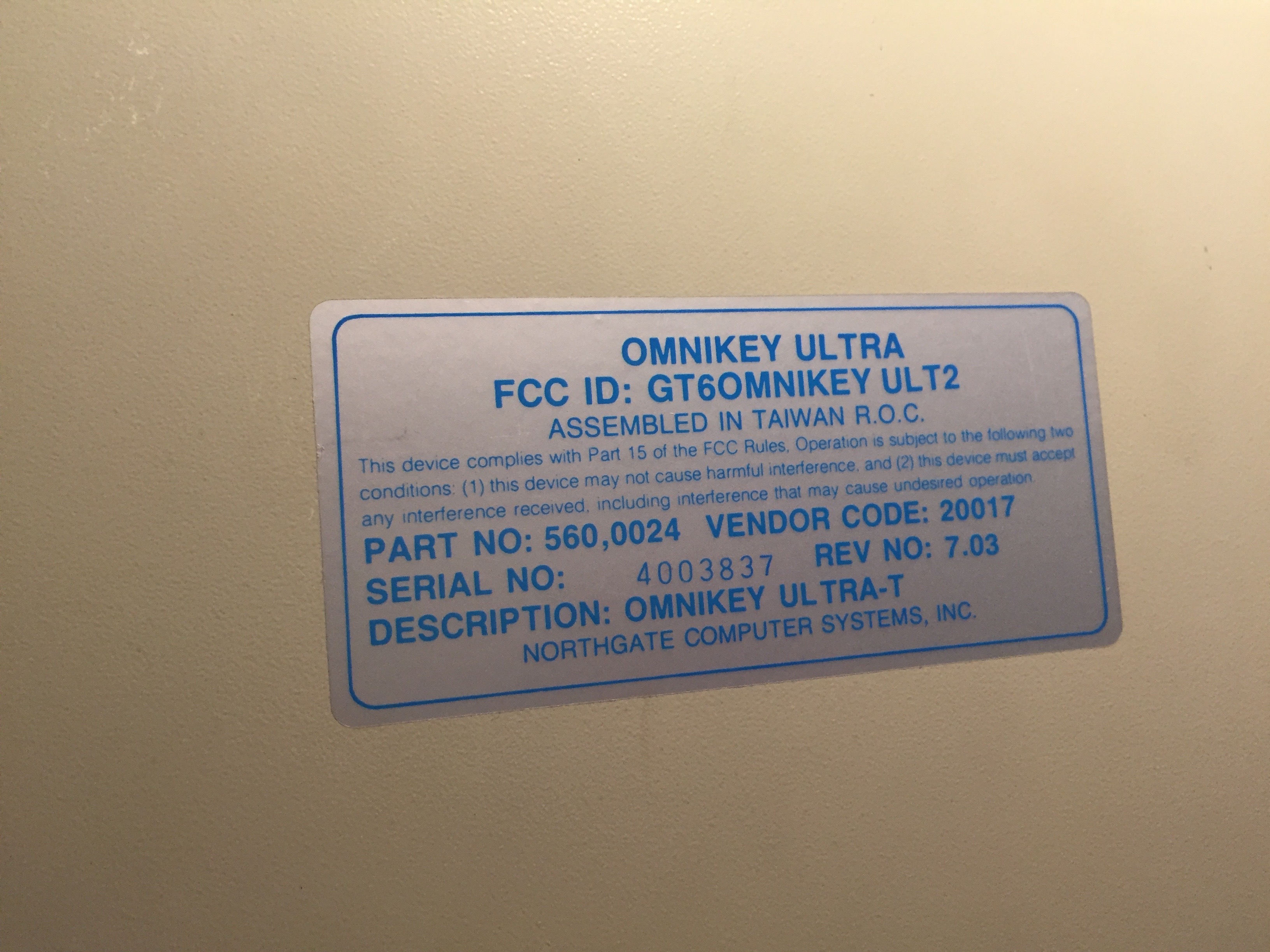

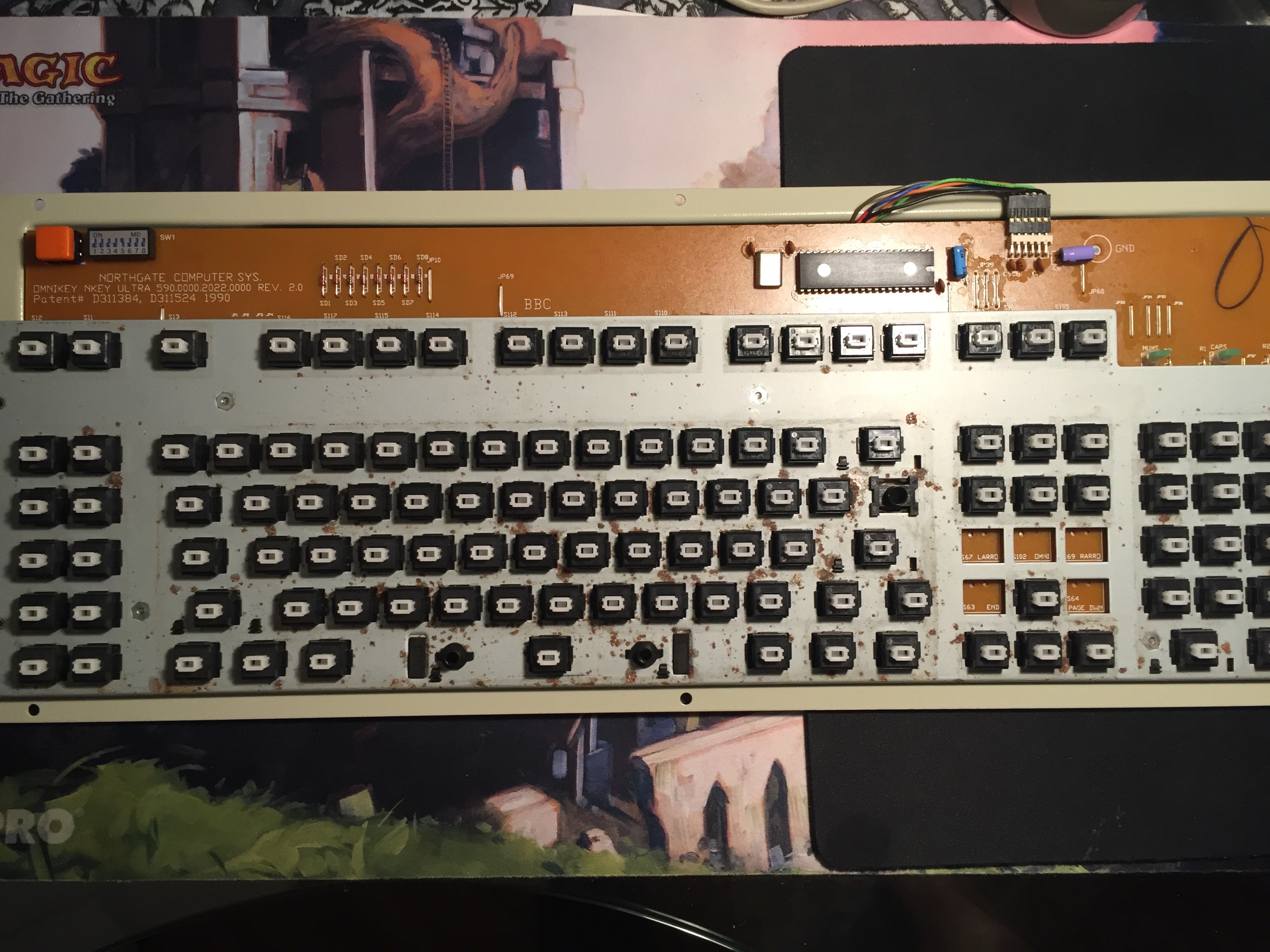

Ok! Just picked this up from the Post Office. It has a 5 pin connector as you can see:
The keyboard is quite dirty overall. There is a lot of dust and hair in the switches and on the mounting plate. Here is the board overall:

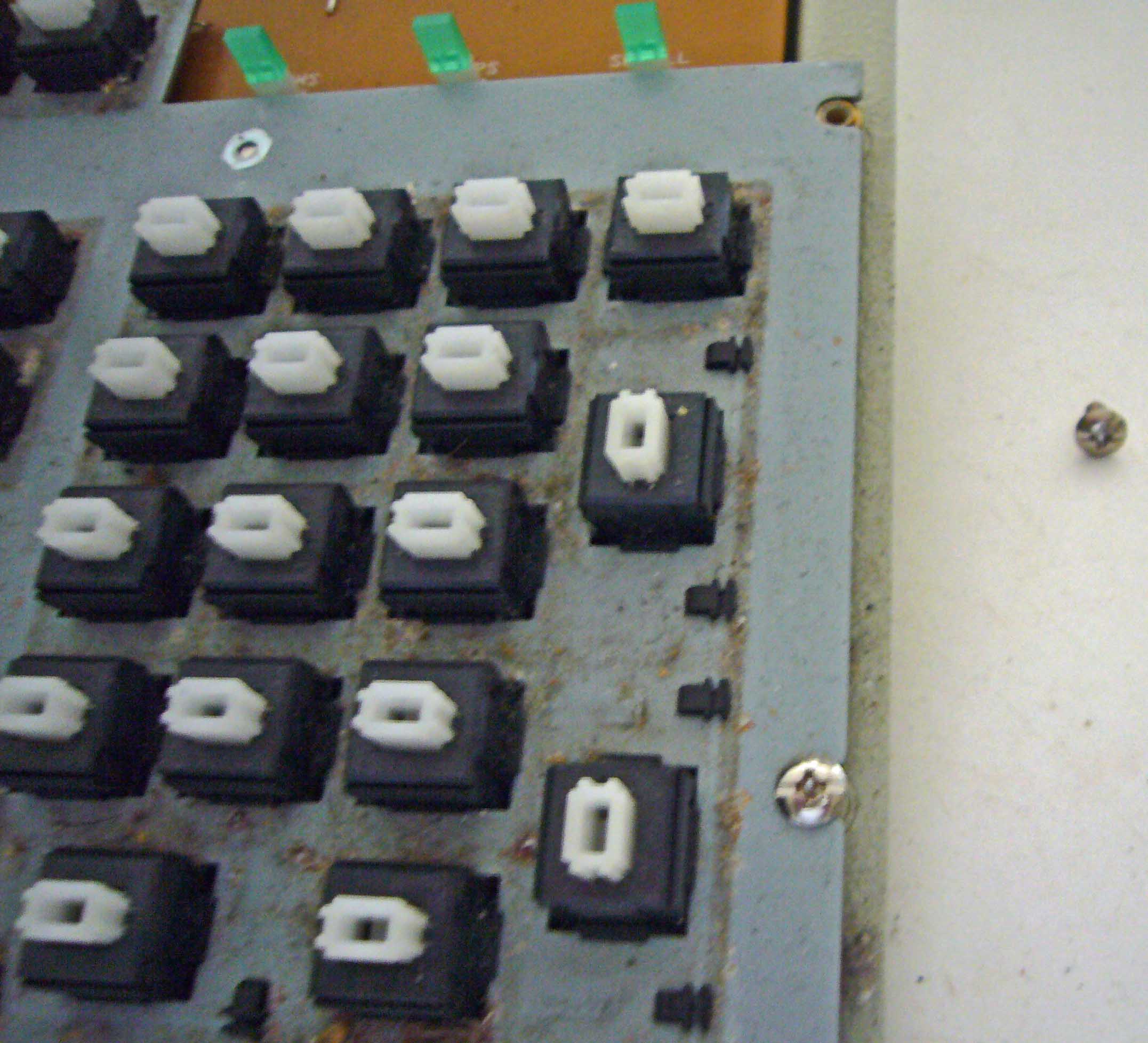

There is also some rust on the mounting plate as you can tell:
What is weird is the Omnikey Ultra badge is stuck over another badge.

- Remove the switches, warm water and washing-up liquid, 2 to 3 hours. Any tips on removing the stabilised keys? They don't want to budge
- Remove the case, bath, warm water and washing-up liquid, 2 to 3 hours
- Clean the plate and test the switches. Ease and adjust switches that have lost their clickiness
- Depending on the level of rust: de-solder switches, sand down, prime and spray mounting plate, re-solder switches

Looks like your Northgate Omnikey Ultra might actually be an Avant Stellar keyboard.

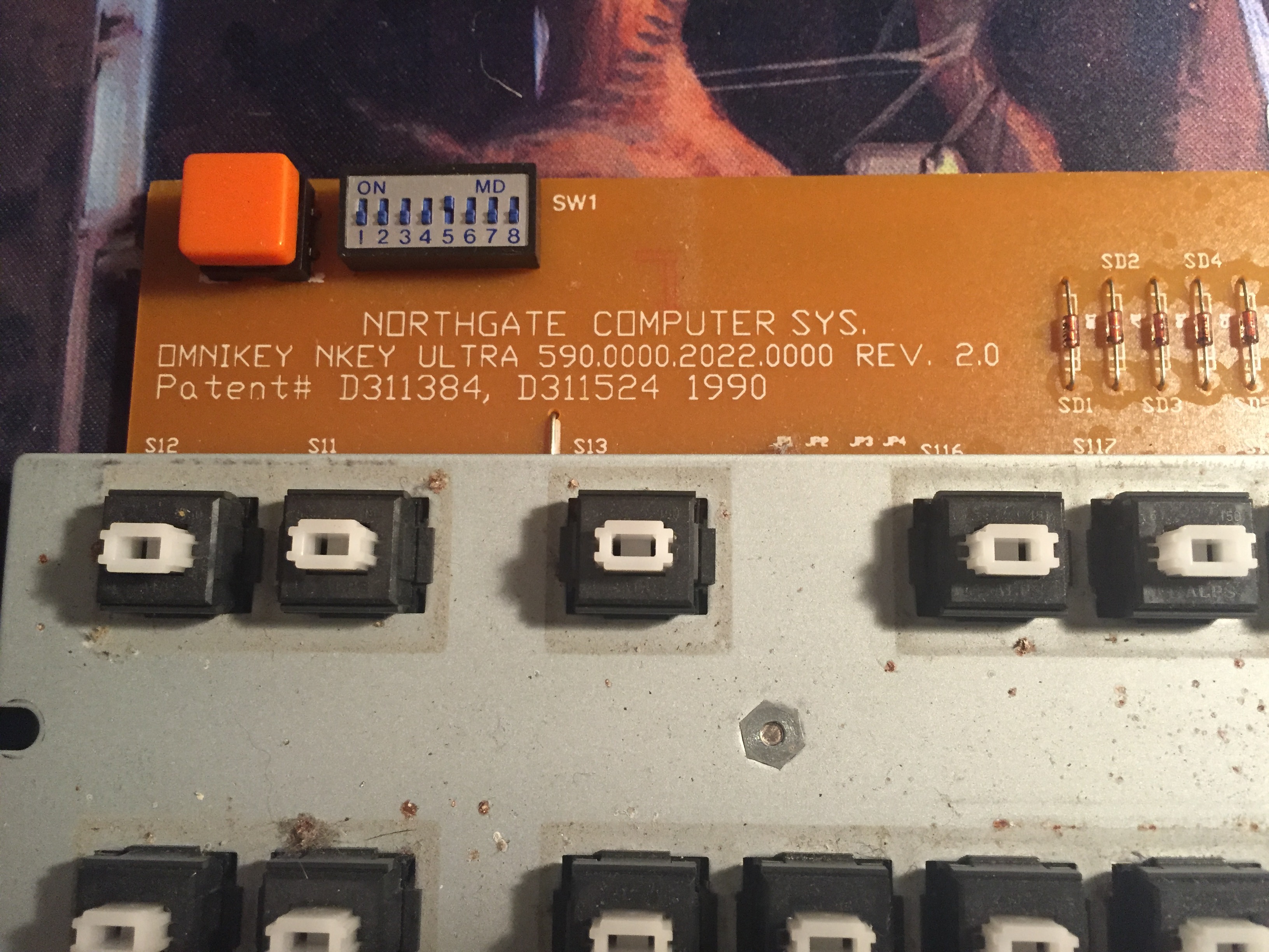

Well, here's the PCB and the model sticker.

One explanation: the Avant Stellar removable plate might be from a different board. No idea how it got a Northgate sticker above it though.

@lancre: If you Google Northgate keyboards and/or Avant Stellar, you will find numerous articles about the demise of Northgate and how their line of keyboards was continued under the Avanti brand by Creative Vision Technologies, which has apparently also gone out of business.
Your board does appear to be a Northgate Omnikey Ultra. The trap door to the DIP switch array might have been replaced by one from an Avant Stellar and the Northgate logo applied on top of the Avani label. The hinges of these little doors are somewhat fragile and perhaps the original got broken.

Is that because they soldered the screw-heads on the back of the PCB? It's annoying if I can't remove it. Eventually I was hoping to remove the whole thing and sand / prime the mounting plate, desolder all the switches and replace them with new-old stock or maybe some Matias switches.

Yes, quite annoying and pointless. I have tried to remove it but quickly gave up. The work-around is easy enough:
Assuming that the switches and plastic hold-down tabs have been removed, gently sand off whatever rust is there. Vacuum and blow thoroughly all over and throughout as best you can. Then I wipe the plate as clean as possible with alcohol or whatever, and slide strips of paper between the plate and PCB to completely mask it. Then I can spray paint the plate and replace the plastic tabs (I do it as soon as the paint is "dry to the touch" so that it cures around the tabs and helps to "glue" them in place). If this is your first Alps refurb, you may not have spare tabs, so be careful. They are relatively easy to remove and replace but you (or at least I) might generally ruin a few getting the hang of it. If you were in the US I would mail you a few, but somebody over there might do it for postage.

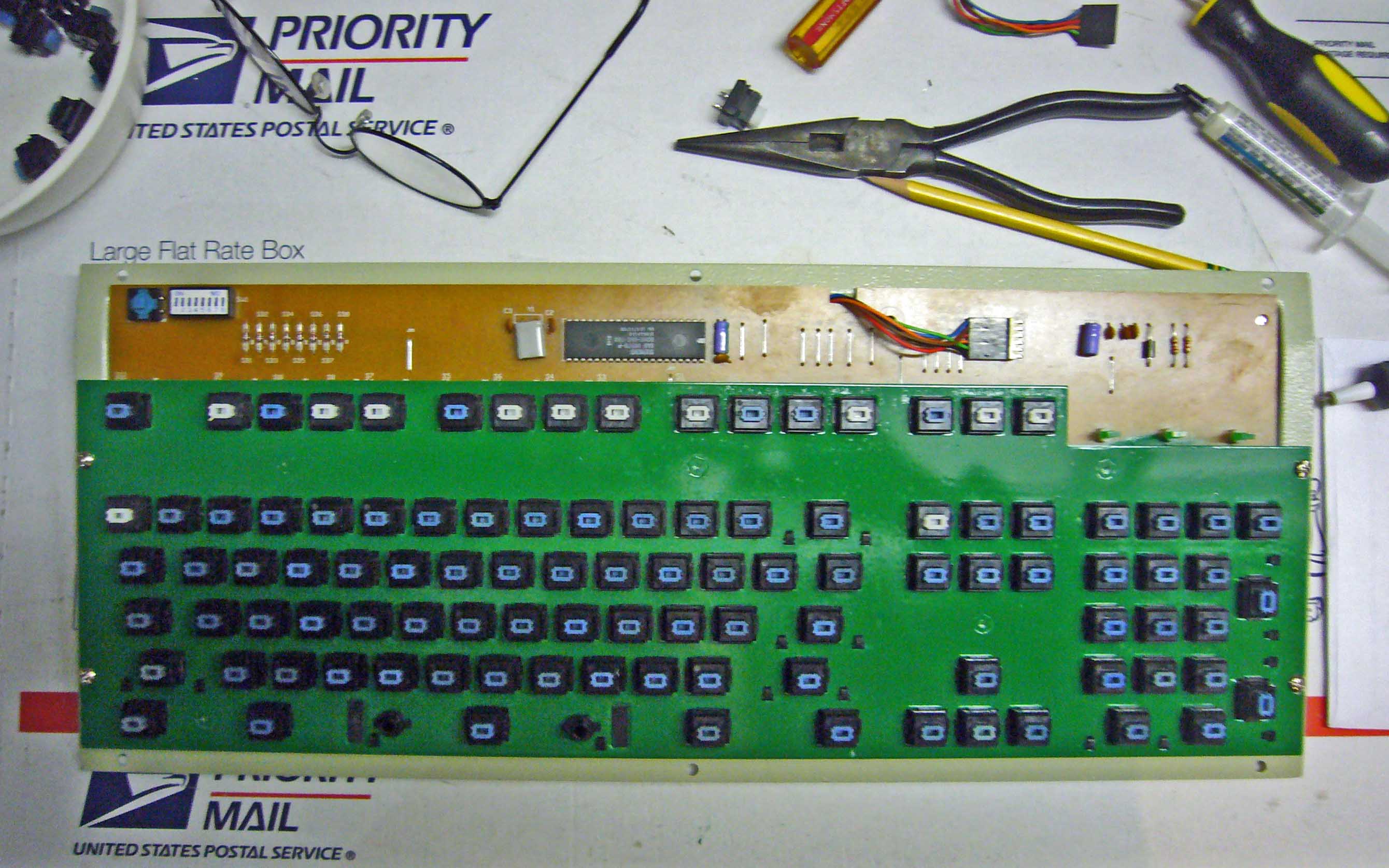

- Northgate-Omnikey-as-bought.jpg (227.93 KiB) Viewed 10084 times
- Northgate-open-01.jpg (321 KiB) Viewed 10084 times

The plastic stabiliser retaining tabs you mean? Yup they look pretty fragile. A few pinged off when I was pulling the keycaps. They re-seated fine. That's a good tip, to let the paint kind of mould to them when it's still a bit pliable. Good job with your board - is that an old Omnikey with blue alps or did you swap those in from another board? EDIT - oh wait, I just noticed the difference in the before and after pictures
I cleaned the plate as best I could.
Now it looks quite good and it makes a very nice thocky clicky bassy kind of noise. Very pleasant.
The unfortunate thing is that the modifier keys bind quite severely on off-centre presses, and some of the alphabetic caps and the space bar are shiny to the point of annoyance. Combined with the inconsistent feel of the switches, it's... well, it could be better.
