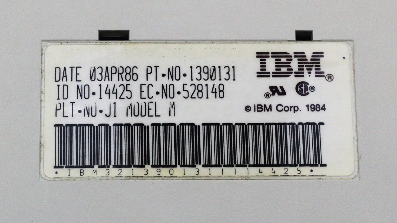

HAL
01 Aug 2016, 20:56
The U.S. made Model M keyboards produced until June 1986 have the nicest birth certificates:
Birth certificate on the back side of an US made 1390131
