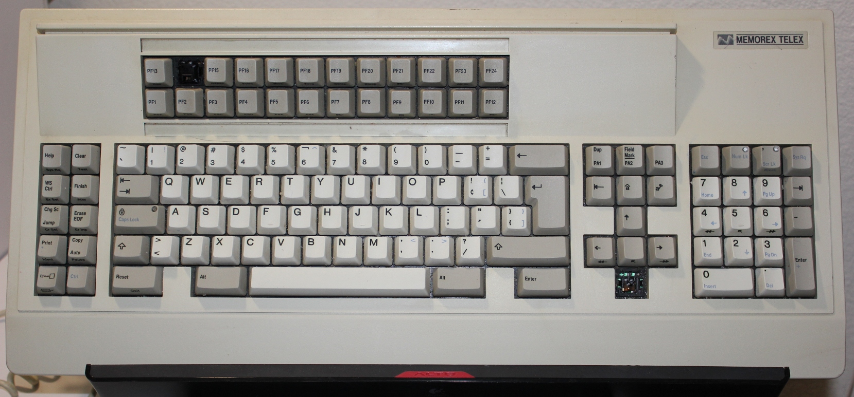

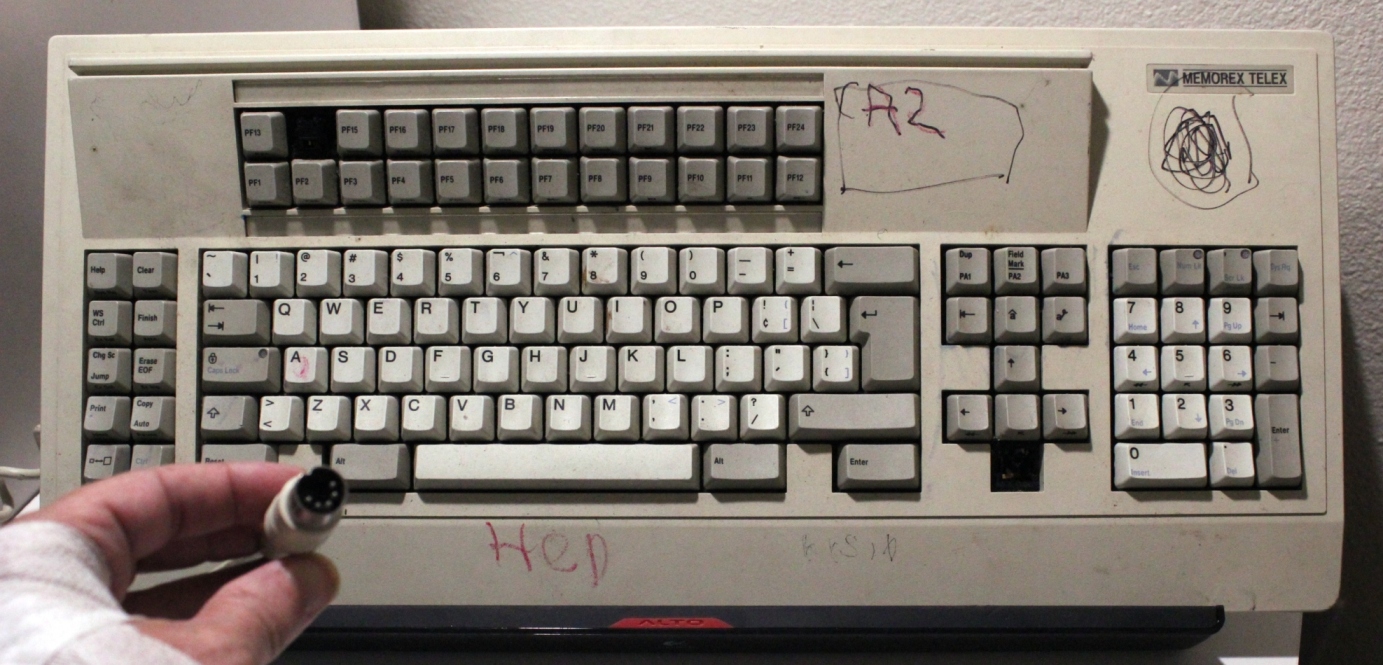

If you get in really dirty keyboards like I do, I can recommend "Magic Erasers". No additional chemicals are needed; just dampen them and use a little elbow grease. They are not expensive; about $2 for 6 sponges at Wal-Mart or the dollar store. The brand does not seem to matter much. These are the results I get:
MemTel HiTek.JPG (470.73 KiB) Viewed 2490 times
Before Cleaning
After cleaning

I can confirm that a Magic Eraser works great. It's my method to clean very dirty keyboards. :)
[ XMIT ]
24 Jul 2016, 17:09
These are also known as melamine foam pads. They are a mild abrasive and, yes, do work very well.
Some markings (most notably from a grease pencil) are best removed with the pad dry.
With excessive use the pad can scratch and damage what it is cleaning so be careful. It usually works well on Model M keyboards casings.

Got pencil eraser and Isopropyl alcohol on your list?
The latter is a real life saver agains sharpie marks and glue residue from sticker legends. Doesn't melt ABS.
snuci
Vintage computer guy
24 Jul 2016, 21:14
I avoid using Magic Erasers unless done so very lightly. Anything beyond that and I use something else because they will change any texturing that may be on plastic or change the finish because they are a mild abrasive but are more abrasive as yo apply pressure. For marker or pen and even paint that may be applied for inventory purposes, I use brake fluid. For glue residue or stickers, I use "Goo Gone".
