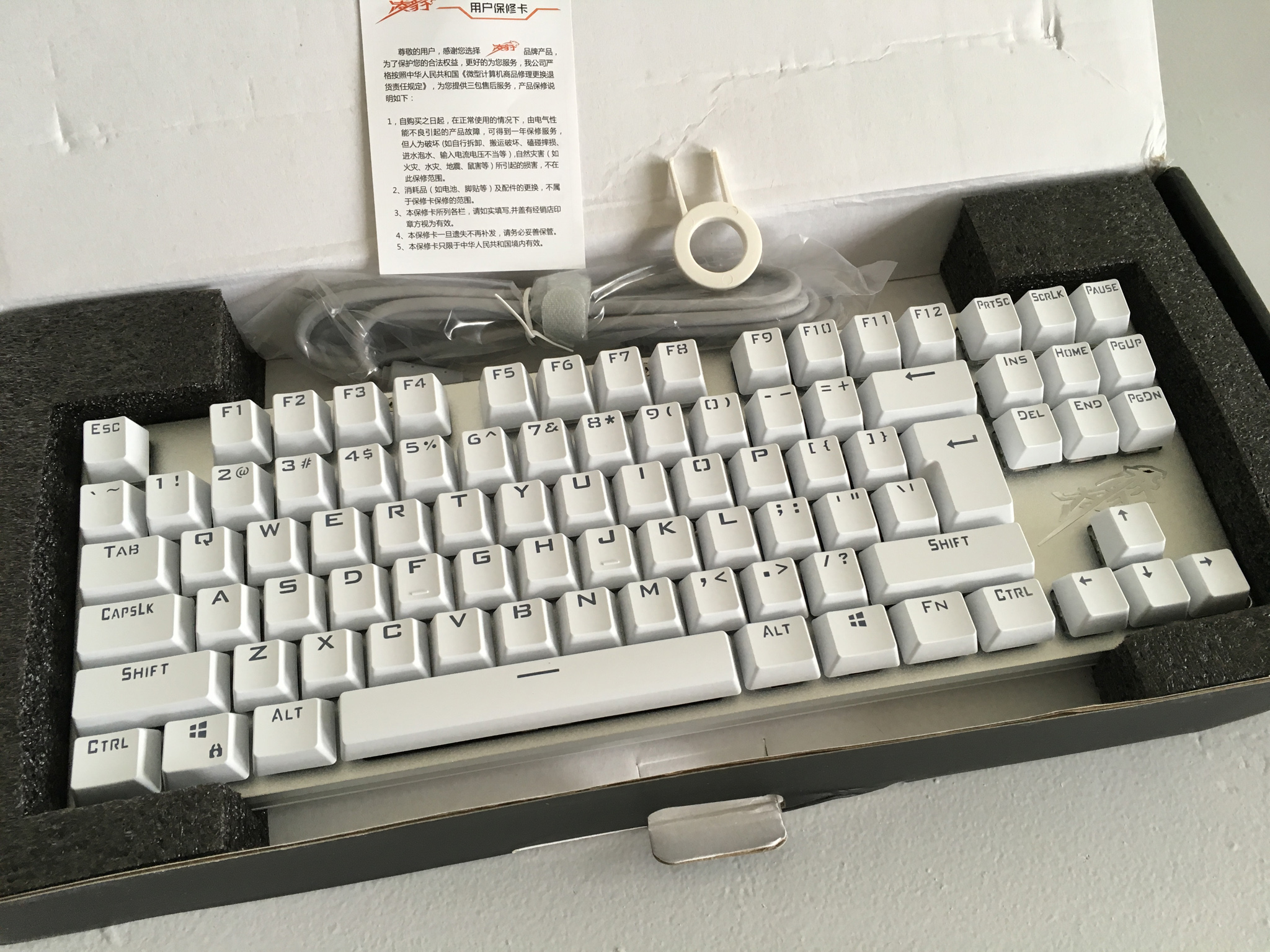

A bit more fancy box inside with decent printing:
box in a box
box in a box
First look at the board it self (especially the keycaps...)

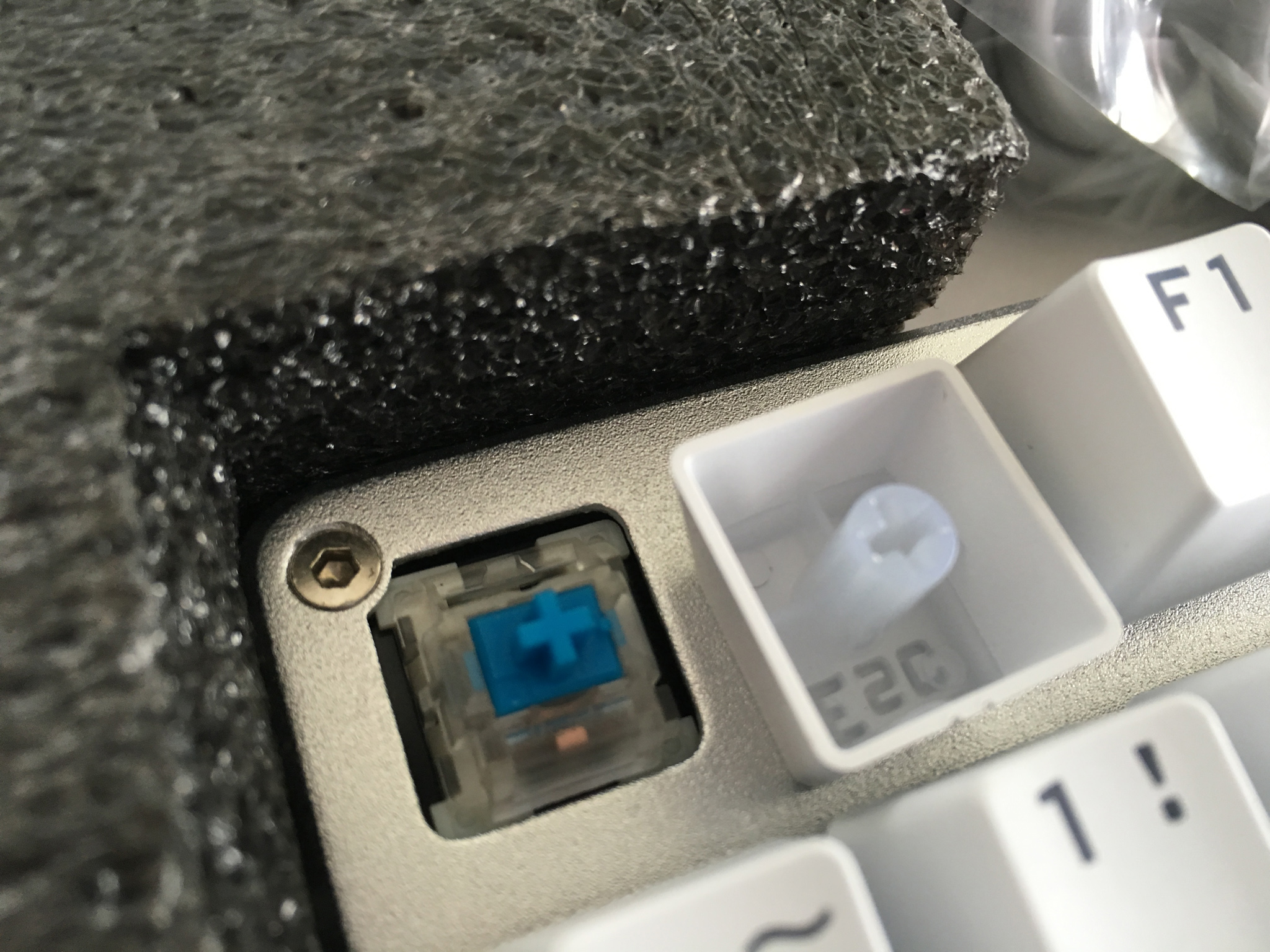

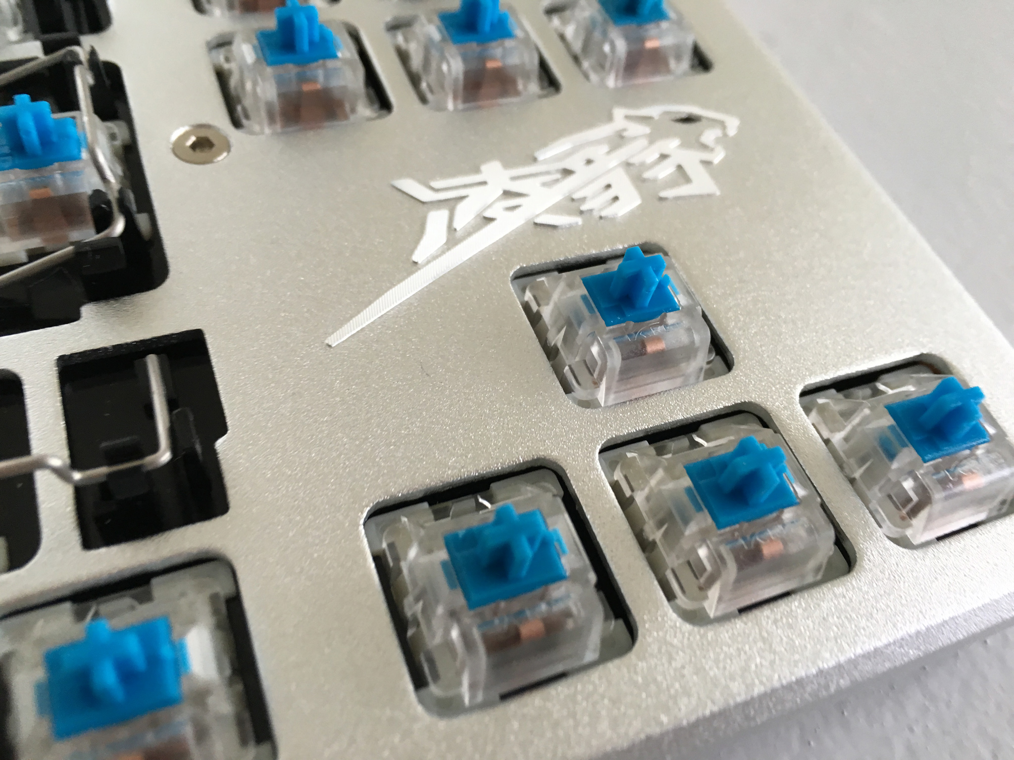

Some kind of a clone (marked with K RGD ?)
Switch
Switch

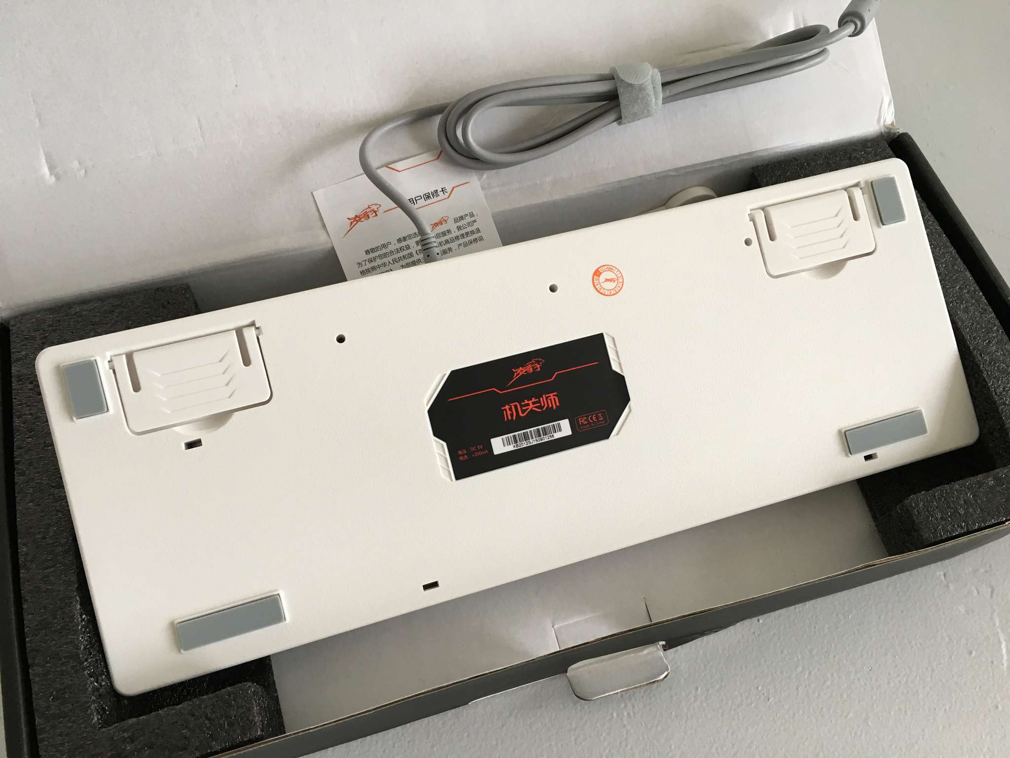

The backside:
Back
Back

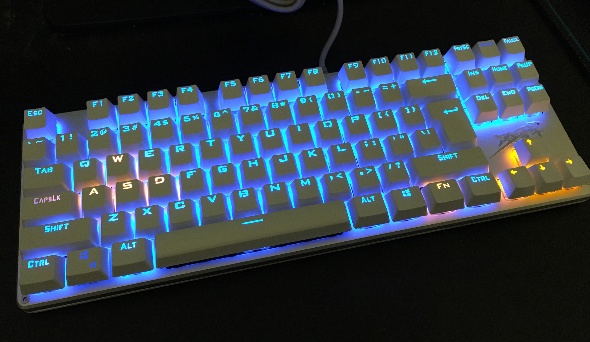

Single led for the lighting - it has 2 modes:
Light
Light
The eye is a hole, which has potential to light up - but led place on pcb is not populated - so its just a hole for the eye:

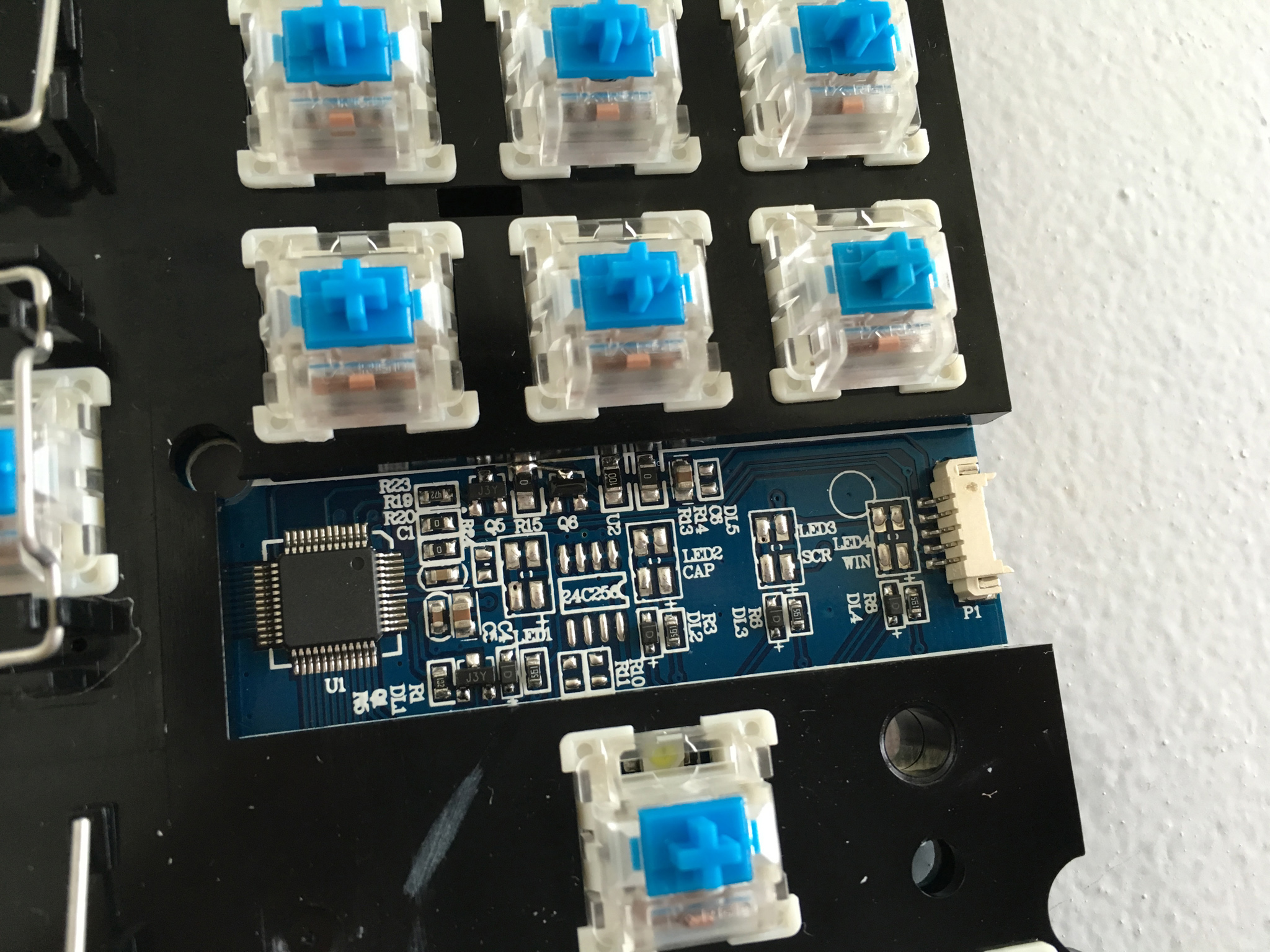

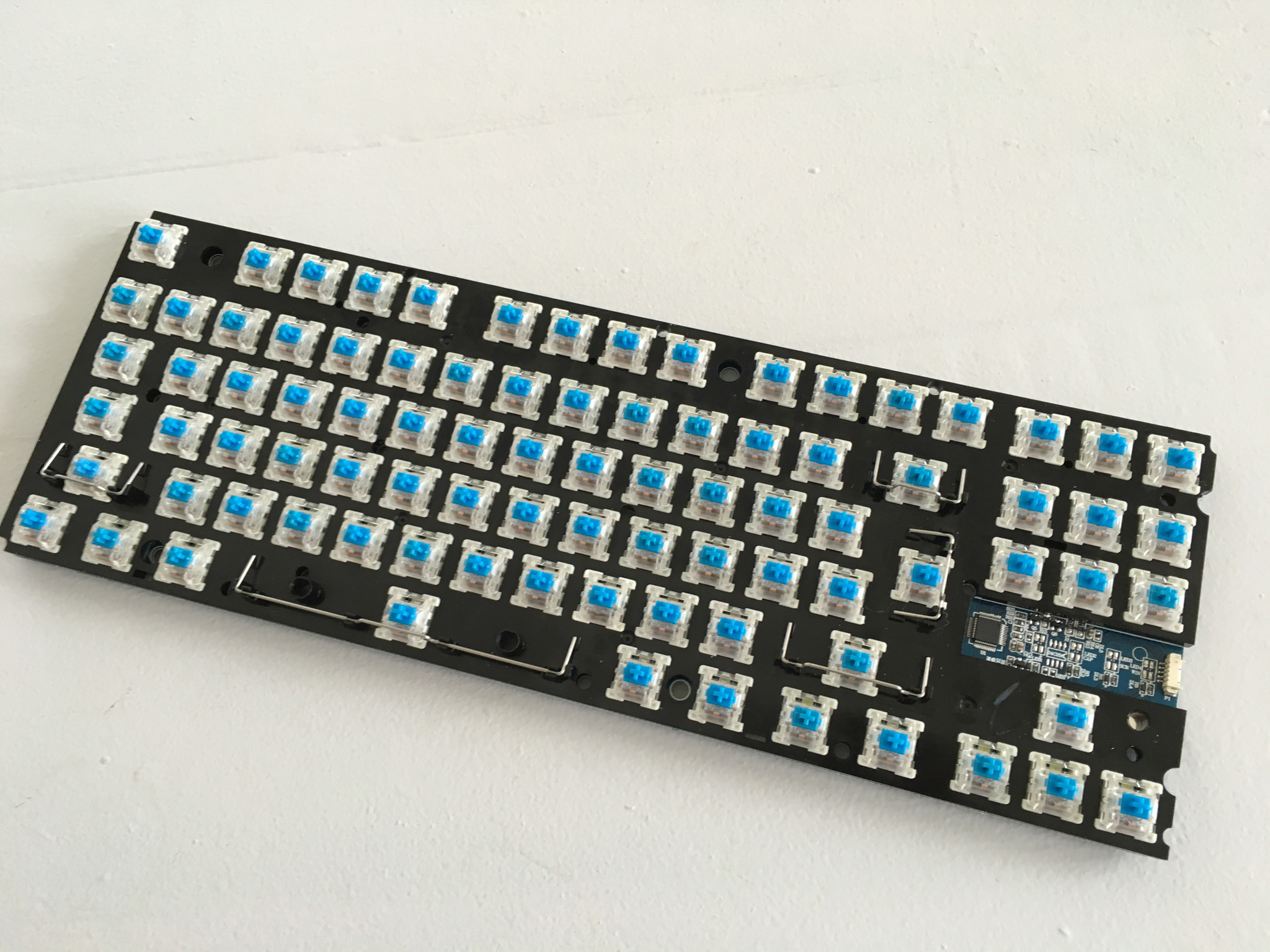

This is the most interesting part - from what I could find out this is a atmel chip (or a copy of one). There is no markings on the chip it self:
controller
controller
backside
backside

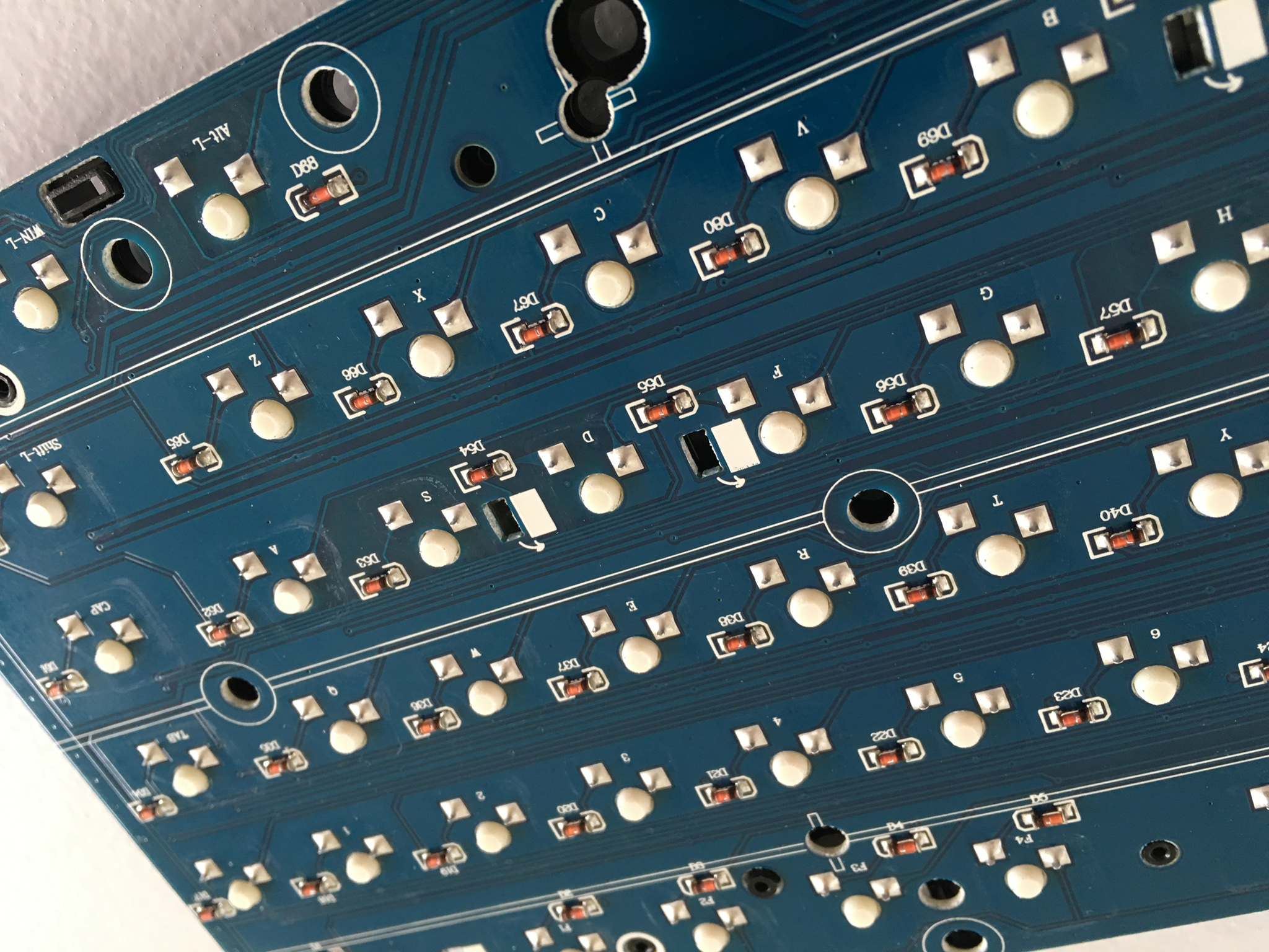

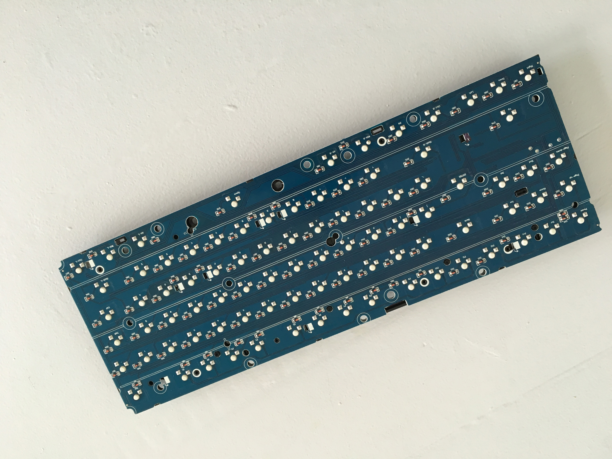

closeup backside
closeup backside

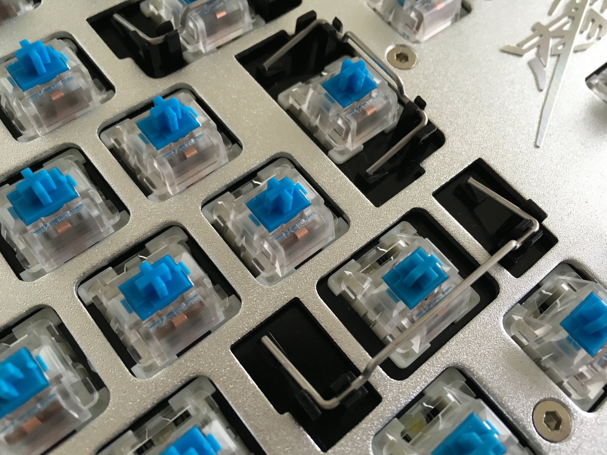

It has kinda strange layout - it has a ISO enter but dont have the usual extra key near the left shift - so only usable in a ANSI layout (being partially ISO by design...)
Also keycaps has extra long stems so even regular cherry mx keycaps do fit - they are hitting the frame and sitting quite loose the the switch. So its impossible to switch for better keycaps without removing top cover or creating a new one.
All in all typing on this keyboard is louder then on IBM Model M. Switches them self feel "ok" - but the combination of the build quality, plastic for the inside frame and just the combination of it all makes for an insane loud keyboard. Typing isnt great, switches do wobble and do have some play - but on part with what Razer keyboards deliver. Switches are not consistent and one was a bit sticky.
PCB and soldering are of decent quality. Aluminum frame is stamped and is quite thin. However keyboard is surprisingly stiff and stable. Lighting is quite even. Cable even not braided is of a good quality. Has about 10 key rollover.
