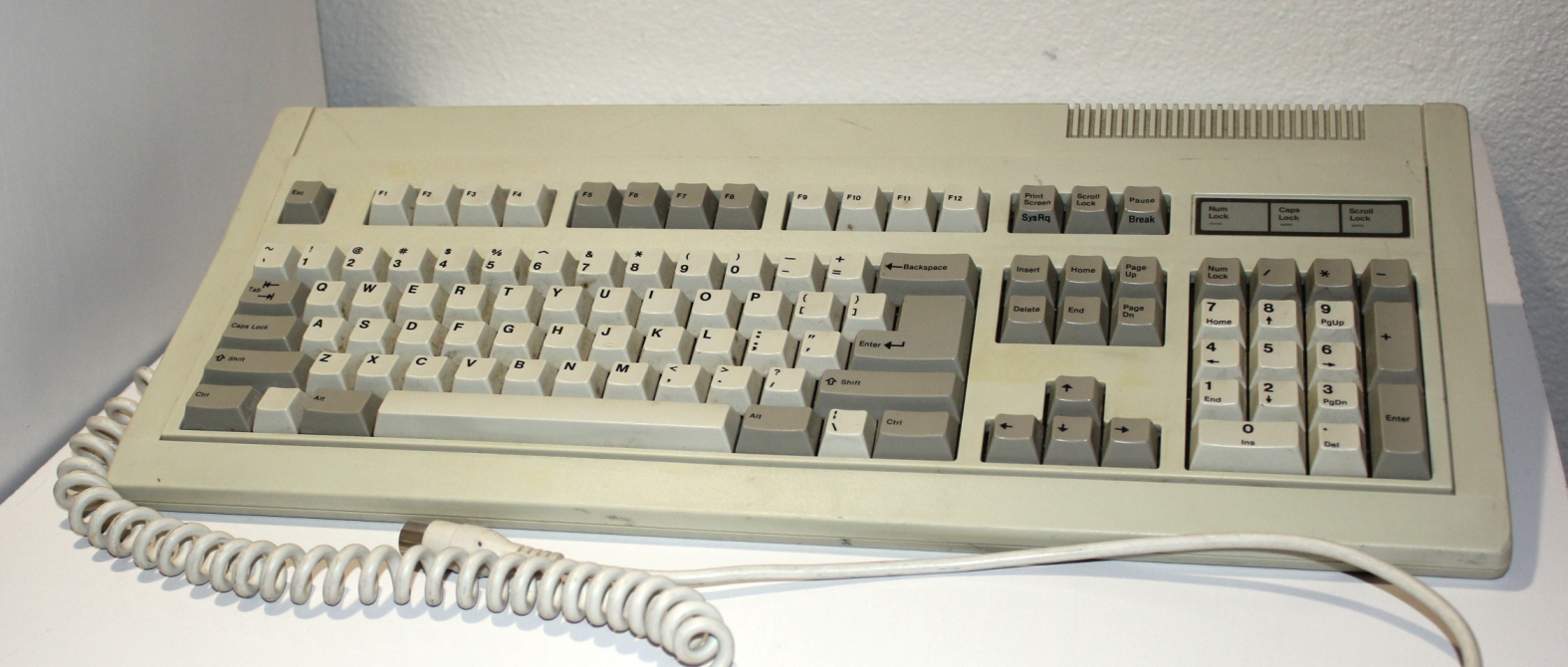

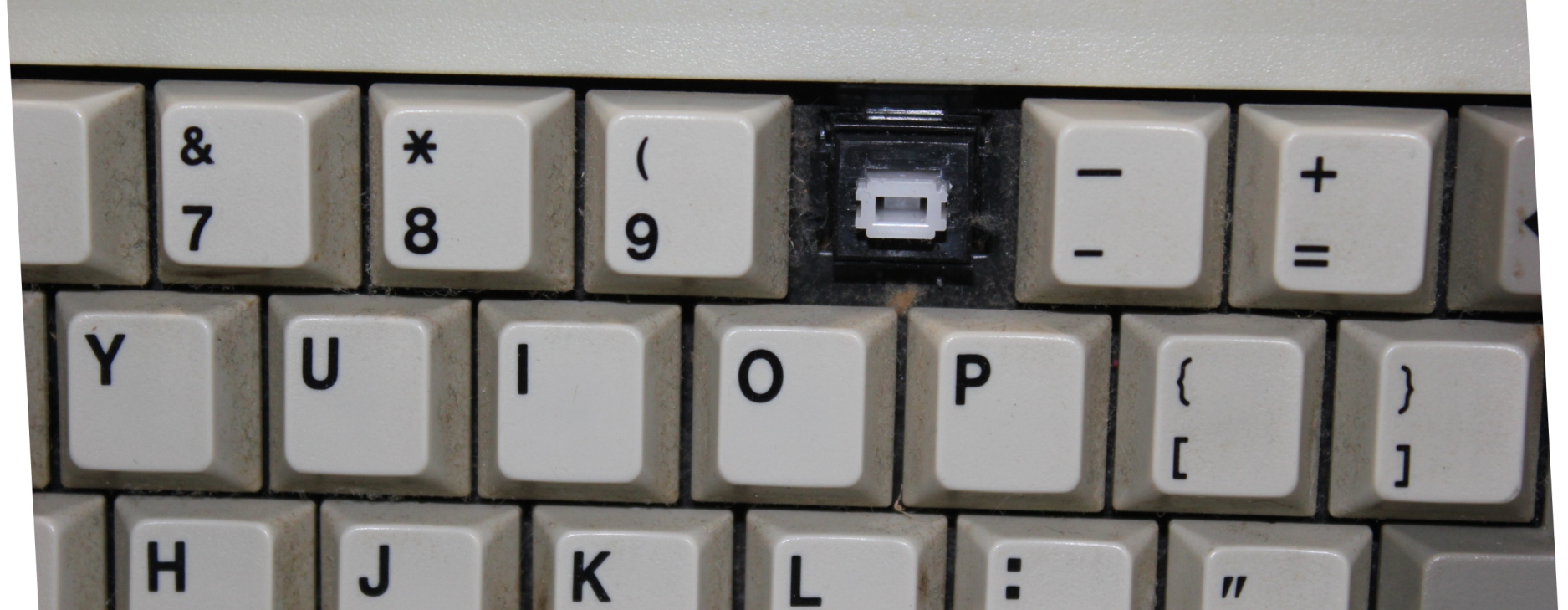

elecplus
24 Jun 2016, 00:04
seebart wrote: You'll find some sooner or later. If I had to describe them Montereys are like the more "refined / finer" clicky SKCM switch. Forget why or who named them "Monterey switch"?
wiki/SMK_Alps_mount
You say you want a Monterey K104? Very clicky!
24 Jun 2016, 00:06
I got one thanks. emdude might like one is my guess. The K104 came with Alps also though.
wiki/Monterey_K104

elecplus
24 Jun 2016, 00:17
seebart wrote: I got one thanks. emdude might like one is my guess. The K104 came with Alps also though.
wiki/Monterey_K104
emdude
Model M Apologist
24 Jun 2016, 00:24
Yeah, that's an Alps SKCM White, thanks for the photo! :)
