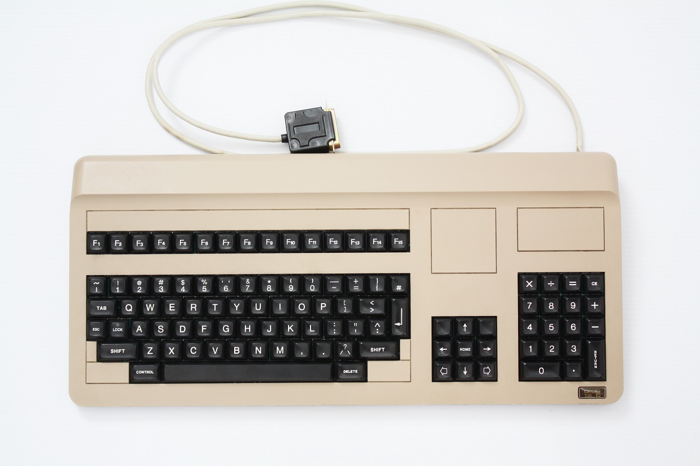

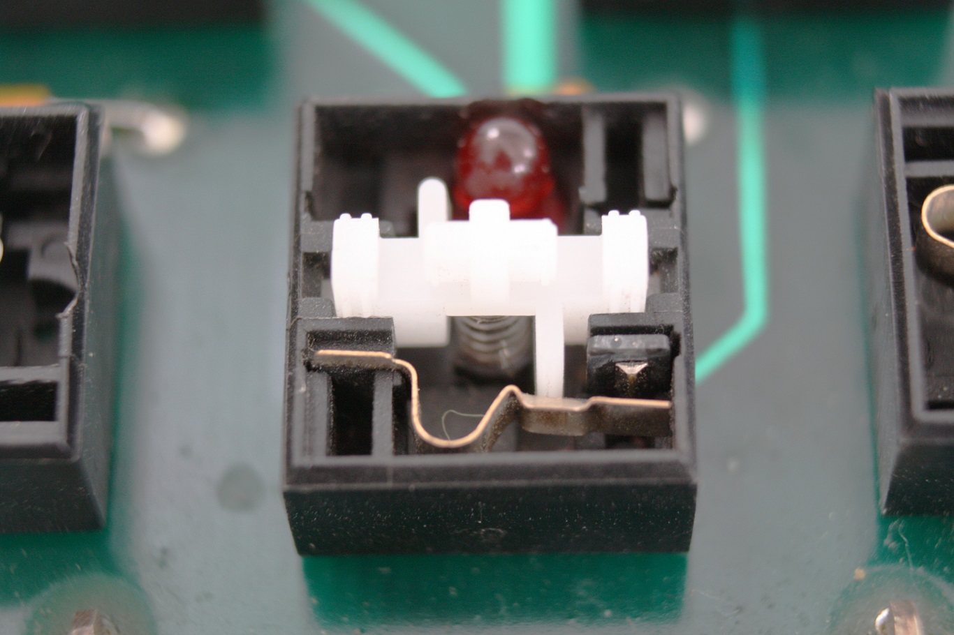

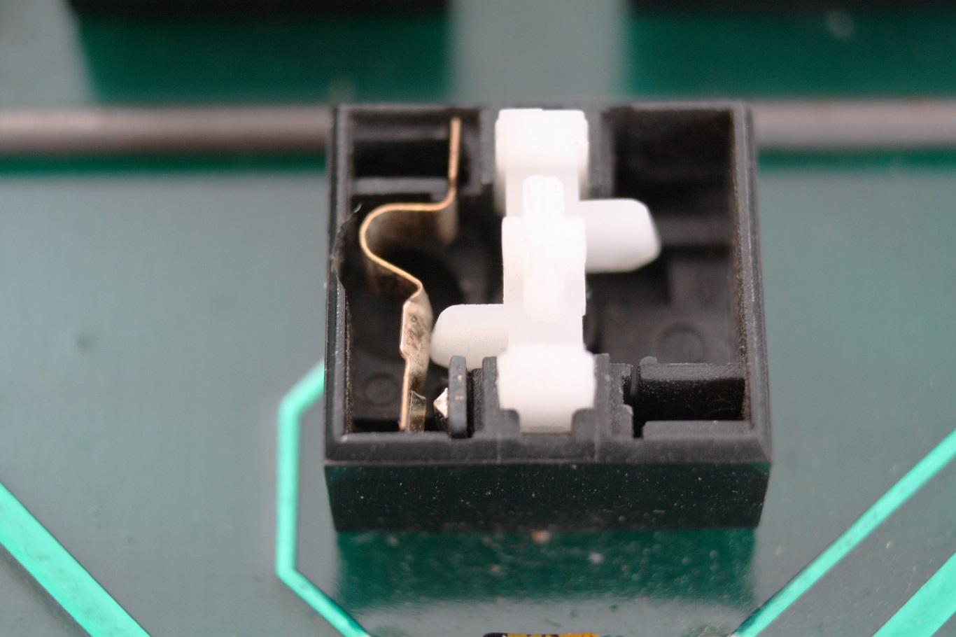

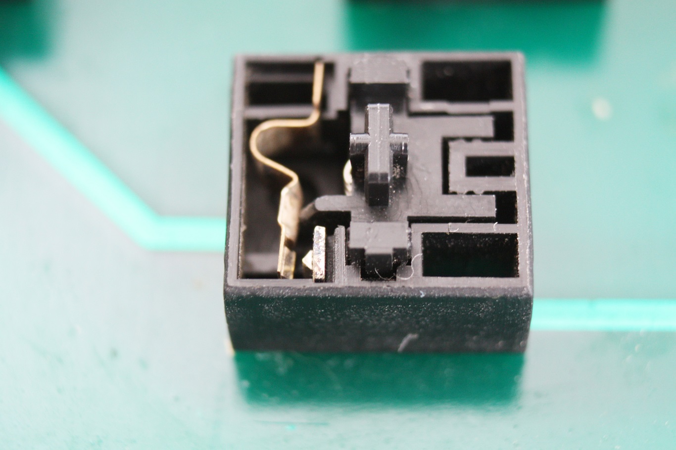

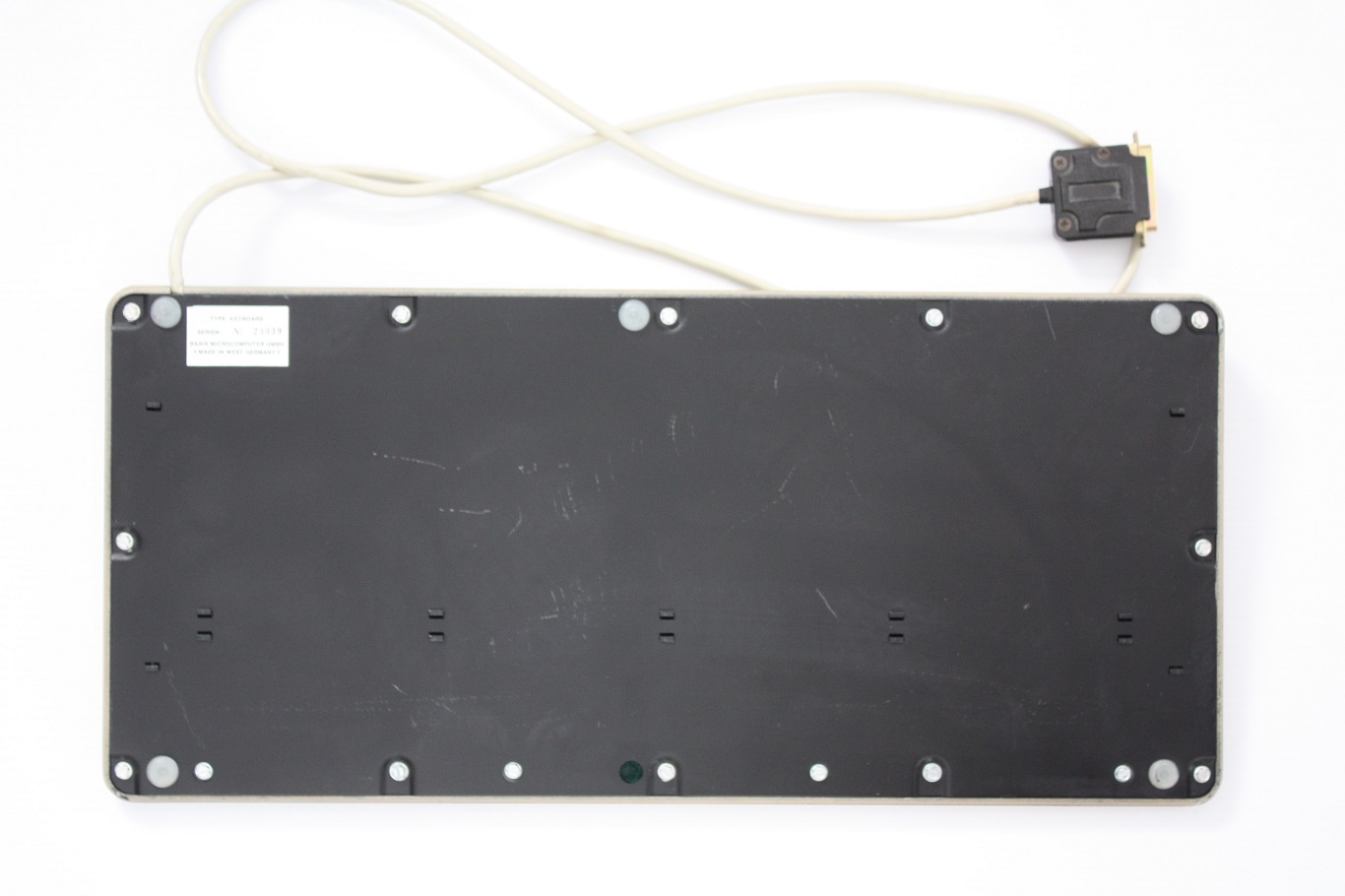

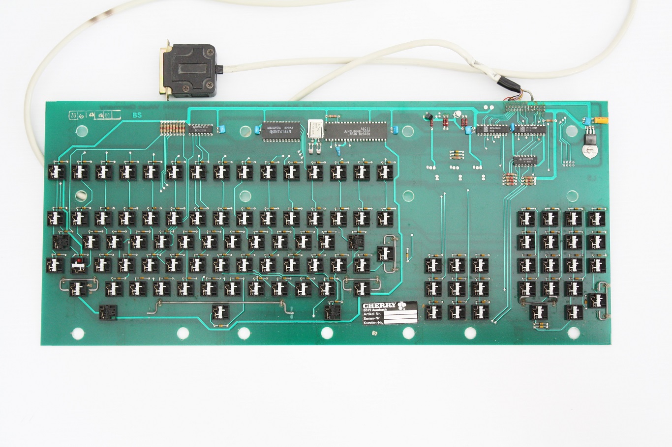

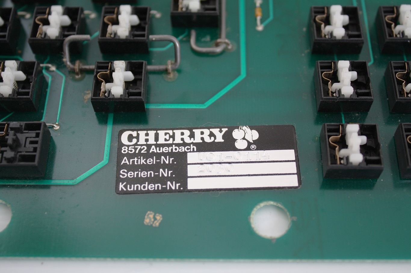

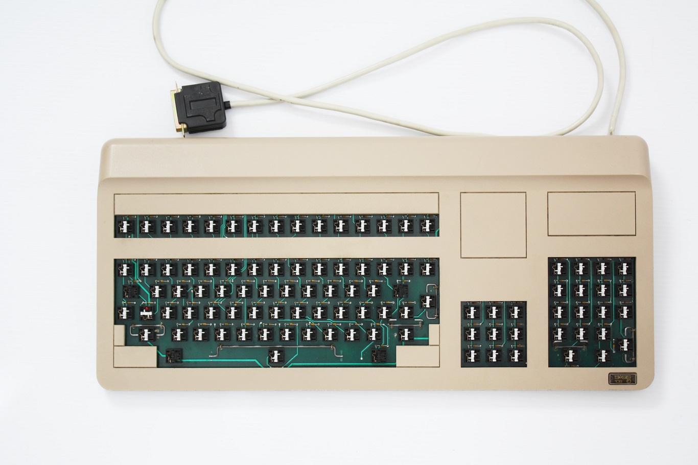

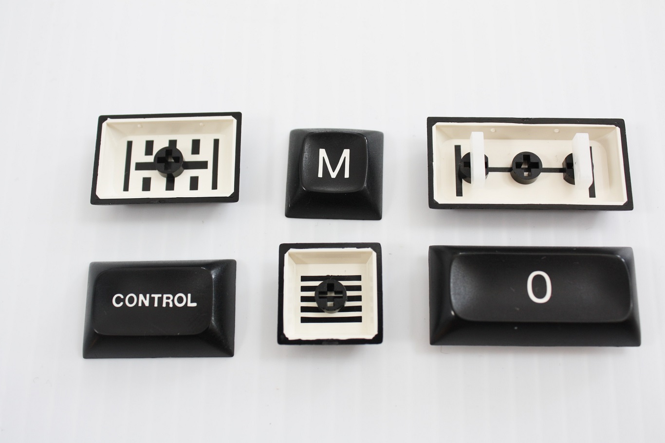

Here's an interesting keyboard some of you from Europe may know. The Basis 108 was an Apple clone from West Germany that ran CP/M and had both a 6502 CPU (for Apple) and a Z80 CPU (for CP/M). It is a beast of a machine with solid cast aluminum case but it came with a Cherry-made keyboard with uncovered M8 low profile switches. This keyboard has three varieties of M8 switches including the normal white variety used for 1u keys, a black switch used for over 1u switches and an LED switch for Caps Lock.
It's a sweet looking keyboard and the switches work very well. Here are some pics:
Basis 108 - keyboard
Basis 108 - keyboard.JPG (219.69 KiB) Viewed 7636 times
Basis 108 - keyboard bottom

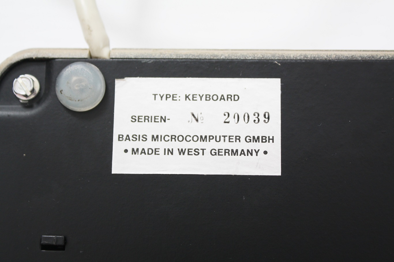

Basis 108 - keyboard bottom.JPG (178.53 KiB) Viewed 7636 times
Basis 108 - bottom label
Basis 108 - bottom label.JPG (223.92 KiB) Viewed 7636 times
Basis 108 - key caps removed
Basis 108 - key caps removed.JPG (251.88 KiB) Viewed 7636 times
Basis 108 - front keyboard pcb
Basis 108 - front keyboard pcb.JPG (367.35 KiB) Viewed 7636 times
Basis 108 - front Cherry label
Basis 108 - front Cherry label.JPG (282.63 KiB) Viewed 7636 times

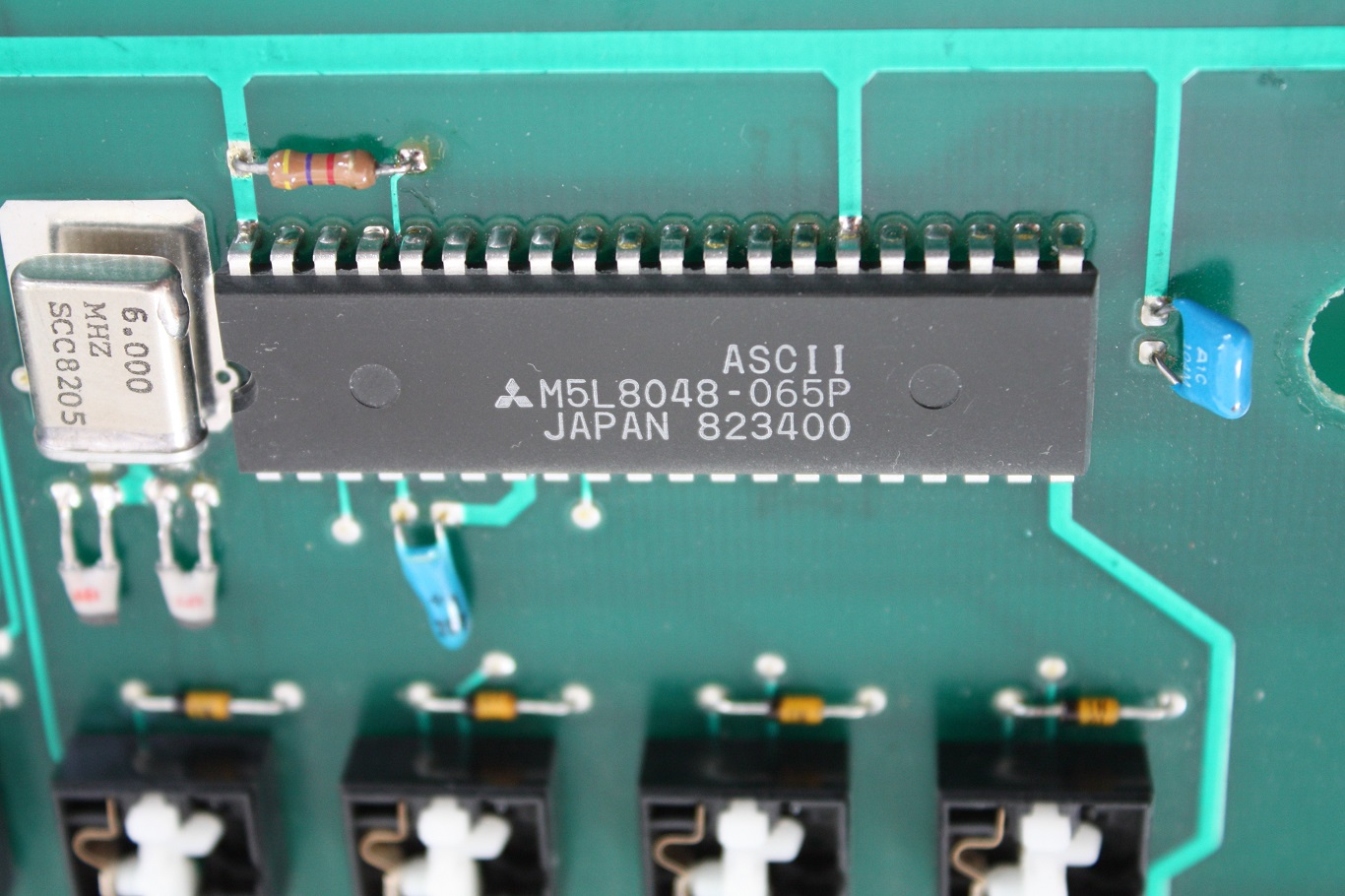

Basis 108 - keyboard controller week 34 1982
Basis 108 - keyboard controller week 34 1982.JPG (327.22 KiB) Viewed 7636 times

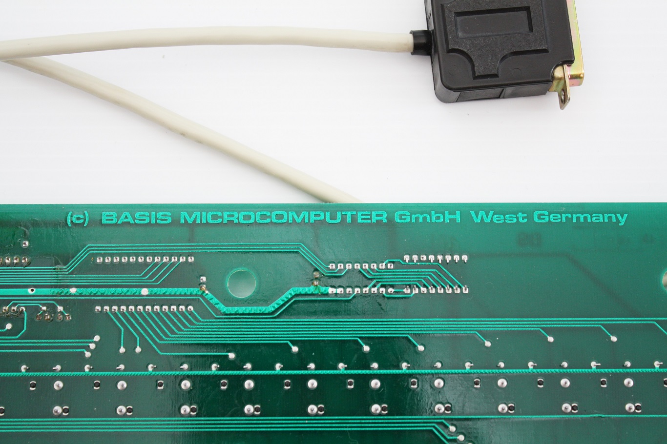

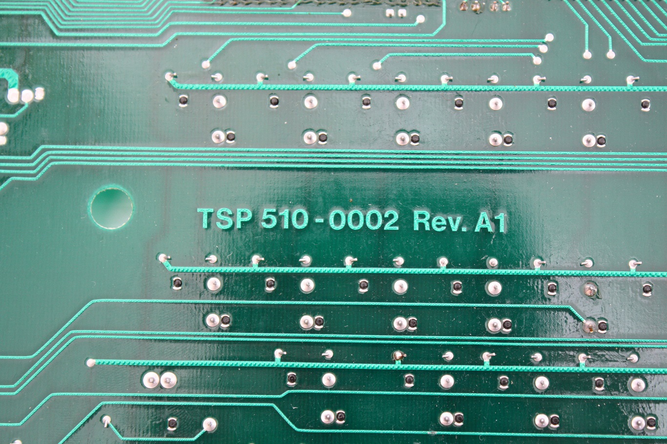

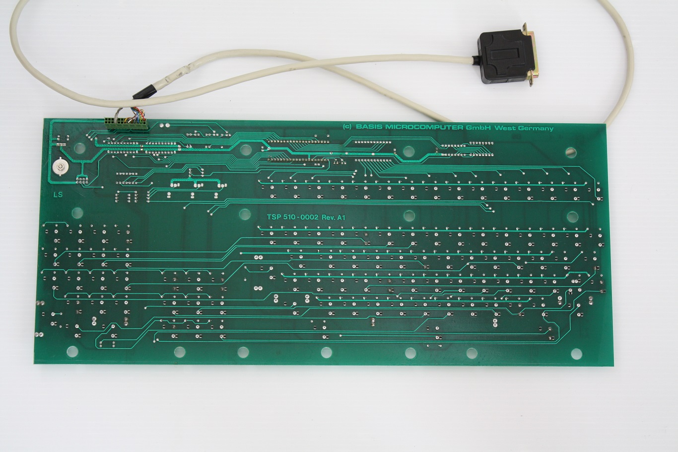

Basis 108 - rear keyboard pcb
Basis 108 - rear keyboard pcb.JPG (323.95 KiB) Viewed 7636 times
Basis 108 - rear pcb markings 1
Basis 108 - rear pcb markings 1.JPG (338.54 KiB) Viewed 7636 times
Basis 108 - rear markings 2
Basis 108 - rear markings 2.JPG (500.56 KiB) Viewed 7636 times
Basis 108 - white 1u key switch
Basis 108 - white 1u key switch.JPG (249.54 KiB) Viewed 7636 times
Basis 108 - black 1+u key switch
Basis 108 - black 1+u key switch.JPG (248.34 KiB) Viewed 7636 times
Basis 108 - key switch with LED
Basis 108 - key switch with LED.JPG (272.88 KiB) Viewed 7636 times
Basis 108 - double shot key caps
Basis 108 - double shot key caps.JPG (181.69 KiB) Viewed 7636 times

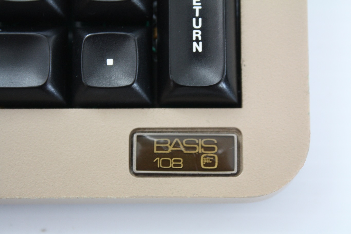

Basis 108 - keyboard logo
Basis 108 - keyboard logo.JPG (216.53 KiB) Viewed 7636 times

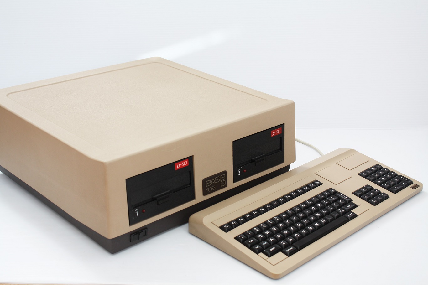

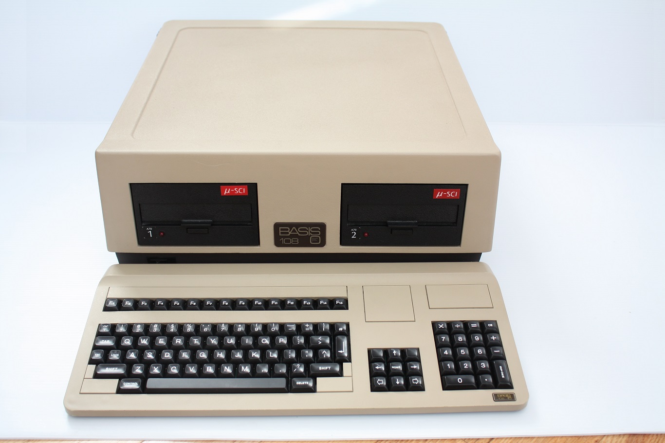

Last pics:
Basis 108 - full computer
Basis 108 - full computer.JPG (221.11 KiB) Viewed 7631 times
Basis 108 - computer profile
Basis 108 - computer profile.JPG (215.51 KiB) Viewed 7631 times
terrycherry
08 Jun 2016, 18:47
Excellent! First to see the LED variant and the black.
Thanks again for the quality photo^^
