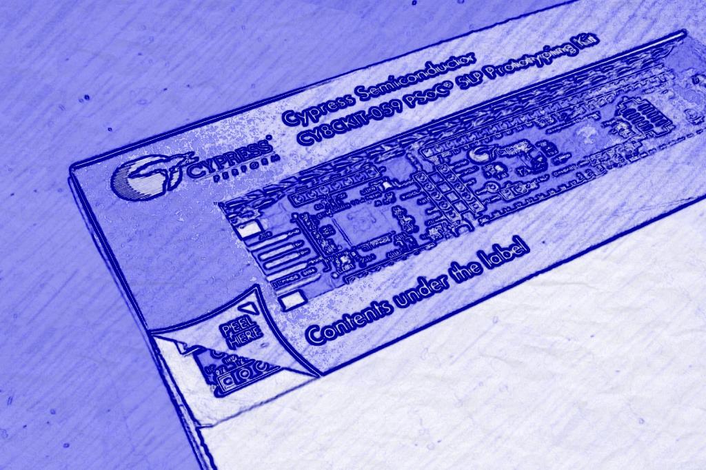

What prototype kit did you use?

@Halvar the kit I'm using is http://www.cypress.com/CY8CKIT-059. Any psoc kit w/SAR, USB and enough GPIOs should do, I now think.

I also got this today from local store.
I already got my pants off. Hope to get your code and instruction before I catch bad cold! :D
