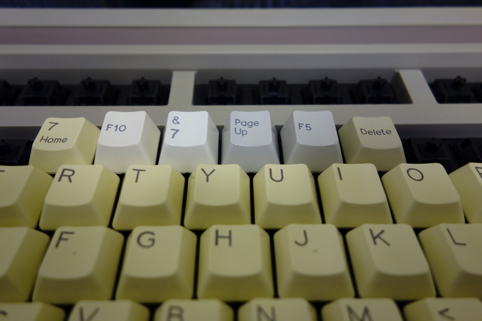

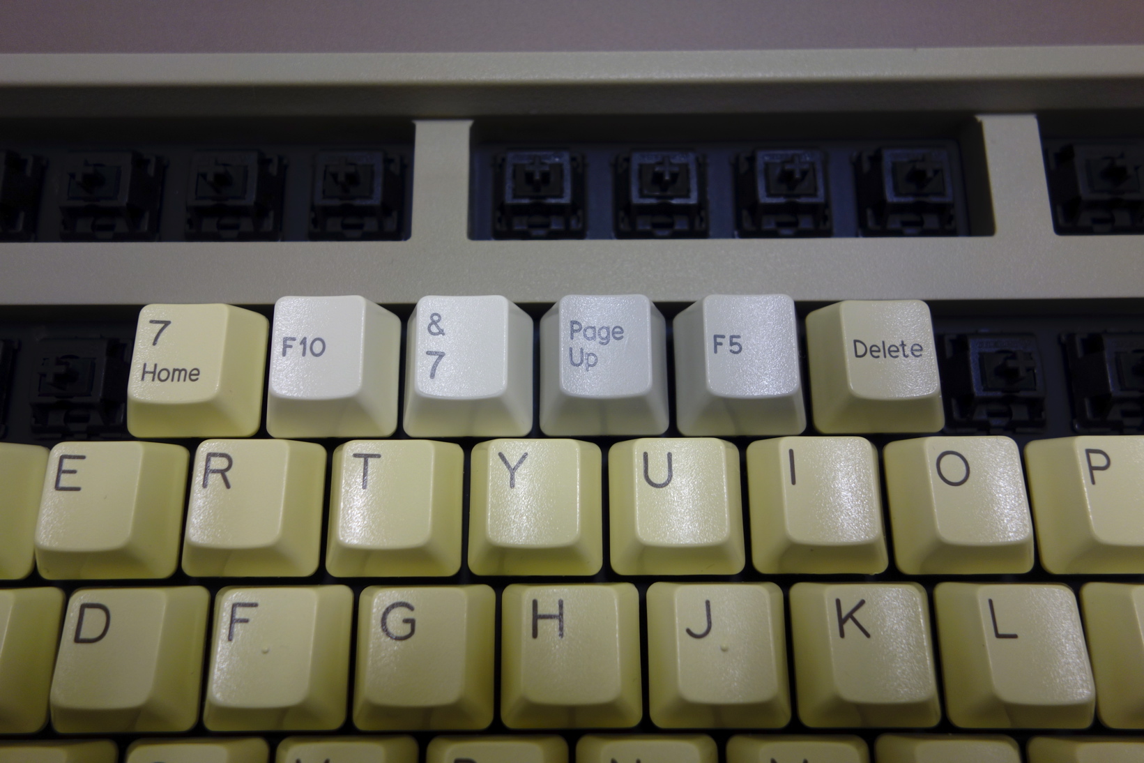

Here are my initial results done on rather uniformly yellowed WYSE keycaps. The keys on the right are grey, and those on the left are white. The center two are oxiclean ONLY (Page Up and &7), the two on either side of those (F5 and F10) are 3% hydrogen peroxide and a teaspoon of oxiclean, and the ones on the outside edge of the top row are untreated (7home and Delete). The treated ones were exposed to the same UV light for the same time period of about 18 hours stirring every hour or two:

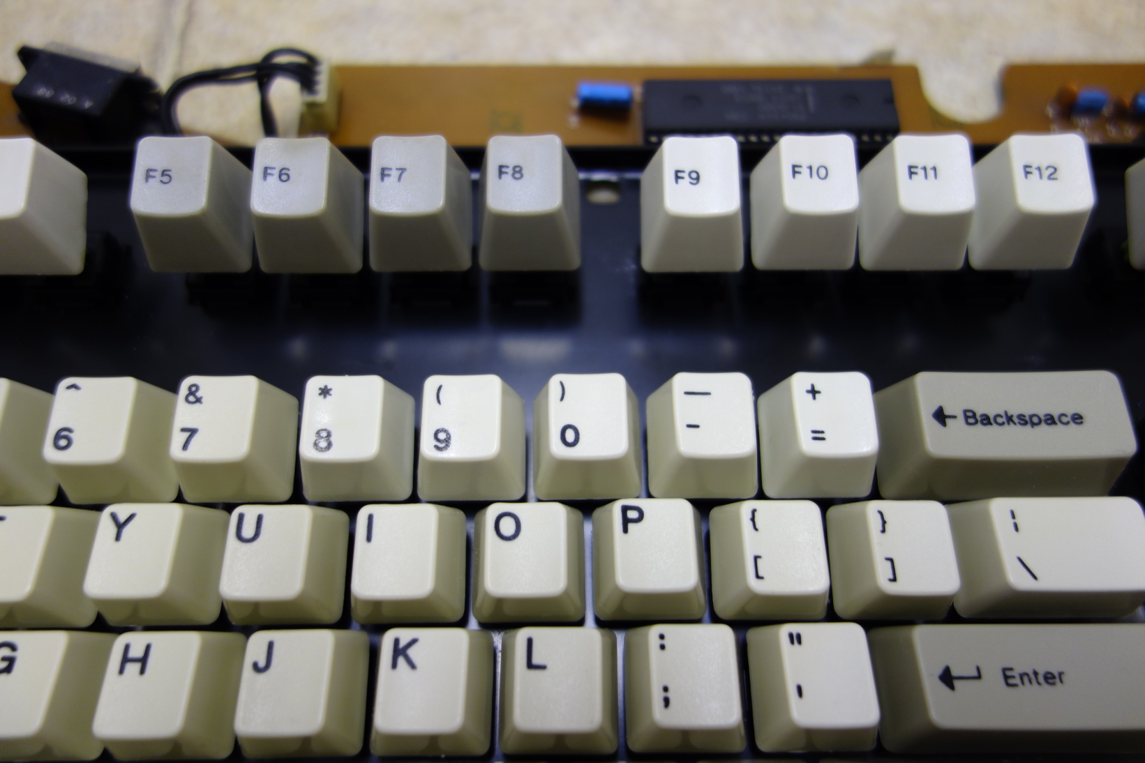

It doesn't seem to hurt pad printing at all. Tried it on my blue Alps IBM Clone (just the keys so far) and this is the result:
The yellowed ones were all pad printed (so 8,9, = and the F row) the rest were PBT and I didn’t need to retr0brite those :)
