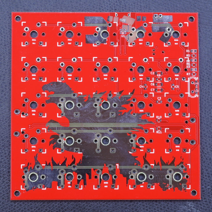

Nice project :) I didn't know that it's possible to make transparent PCBs until now. What material is it?

that's not transparent, he's just got no mask on it, the picture is in the tinning of the board. mirrorish.
Ordinary FR4 pcb does let a lot of light through when there's no copper on either side though.

Daniel wrote: Nice project :) I didn't know that it's possible to make transparent PCBs until now. What material is it?
Ha -- After looking again at the picture I can see how you would think that. nickw has the right of it though, this is FR4 with red soldermask and HASL finish.
nickw wrote: Ordinary FR4 pcb does let a lot of light through when there's no copper on either side though.
The area near the usb connector on top has no top/bottom fills, and the 2nd Gojira glyph removes the soldermask as well there, so that gives an idea of what the base FR4 looks like from pcbway.

Daniel wrote: I didn't know that it's possible to make transparent PCBs until now. What material is it?
So thanks for that -- you got me wondering too if transparent was possible. It seems that there a couple of boardhouses that do transparent soldermask. All the cheap and cheerfull boardhouses do not seem to support it though.

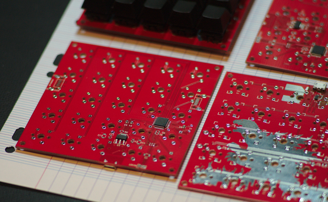

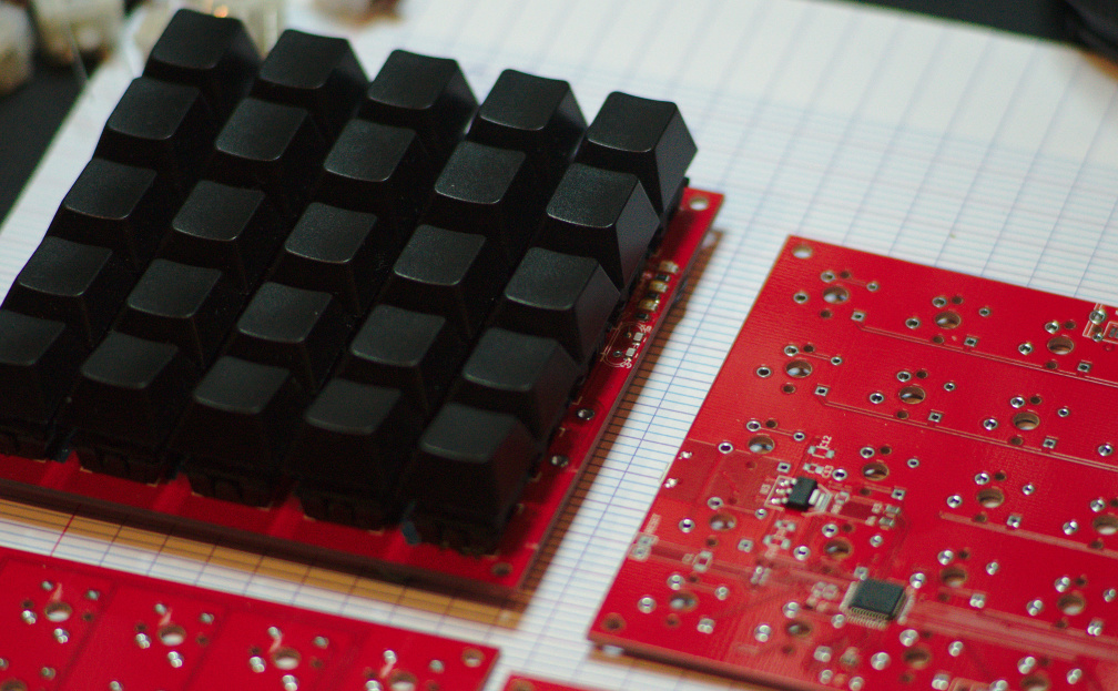

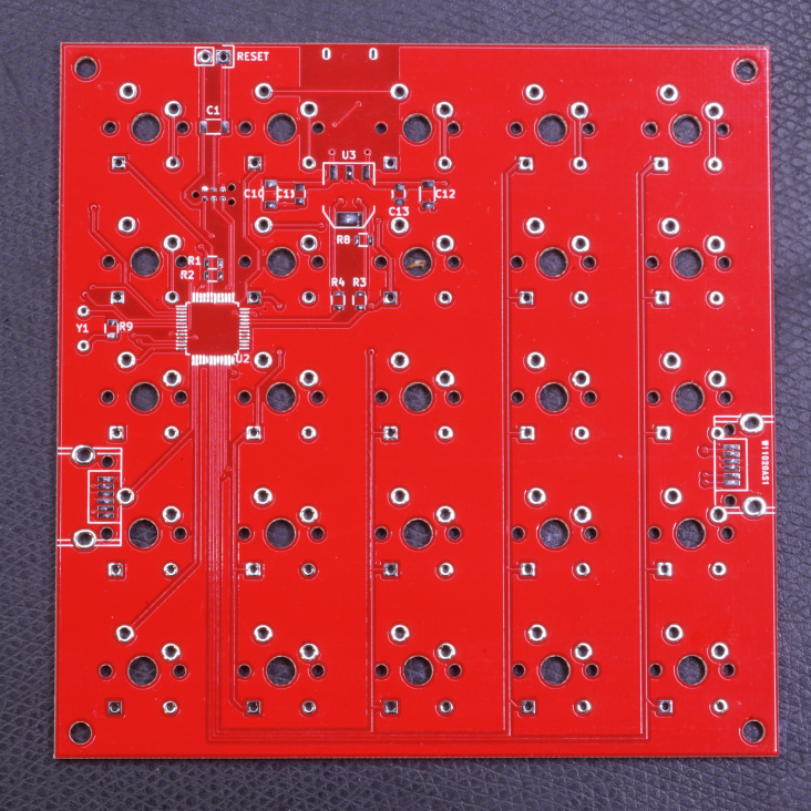

Sure. Backside of the board:
Quick shots of the stuff on my bench now. I've started using one as an extra keyboard, so I need a new set of two for my board-to-board experiments. That is the purpose of the two footprints on the back to the sides.These have been wired up for I2C, and although I foobarred the firewire footprint, it will fit with some budgery.
