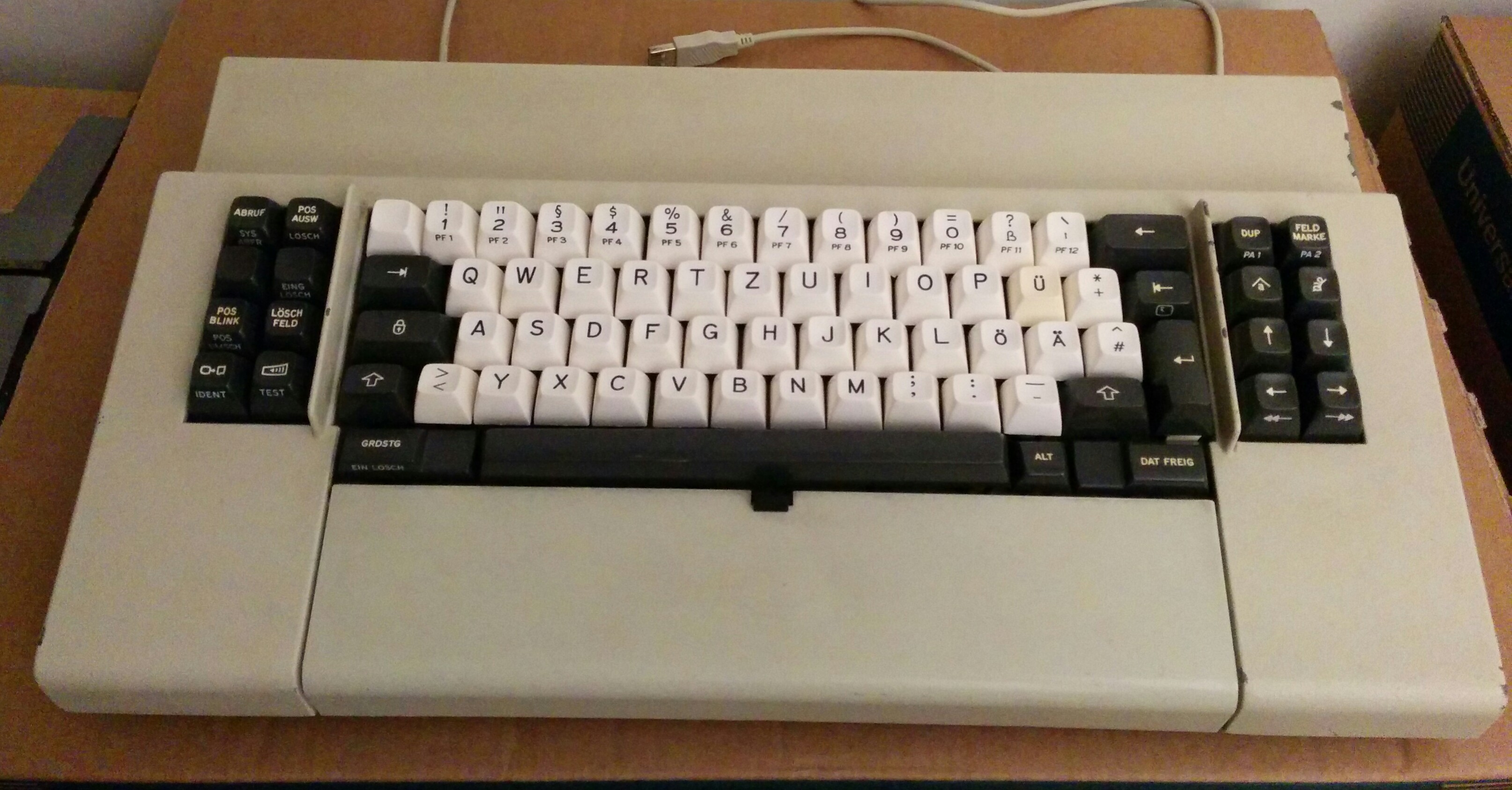

IT IS ALIVE!!!!!!!!!!!!!!!!!!!!!!!!!!!!
Just finished the software configuration and I'm typing on it right now!!
I'll snap some more pics and post soon enough!
BTW what's the attached image limit per post?
