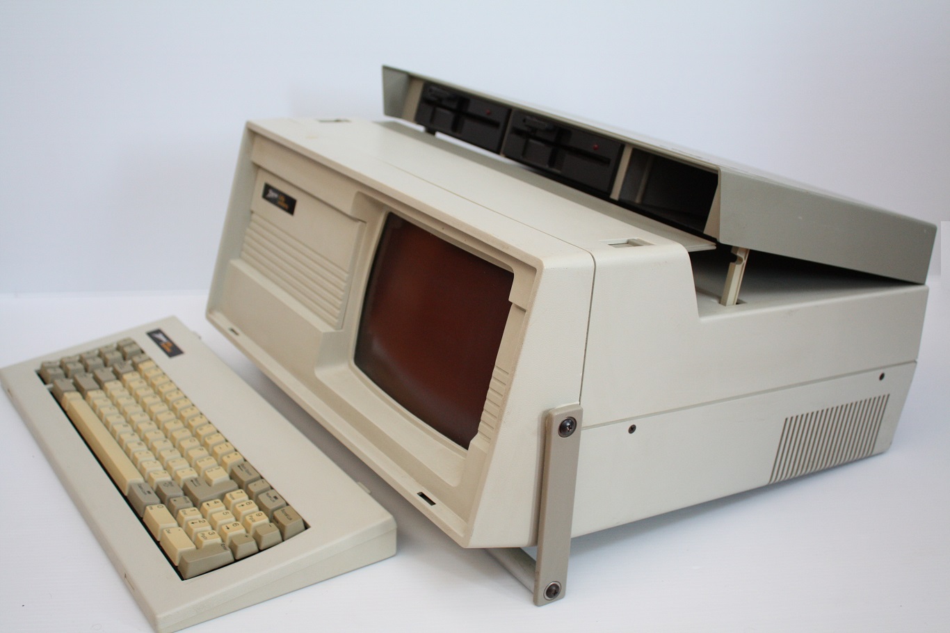

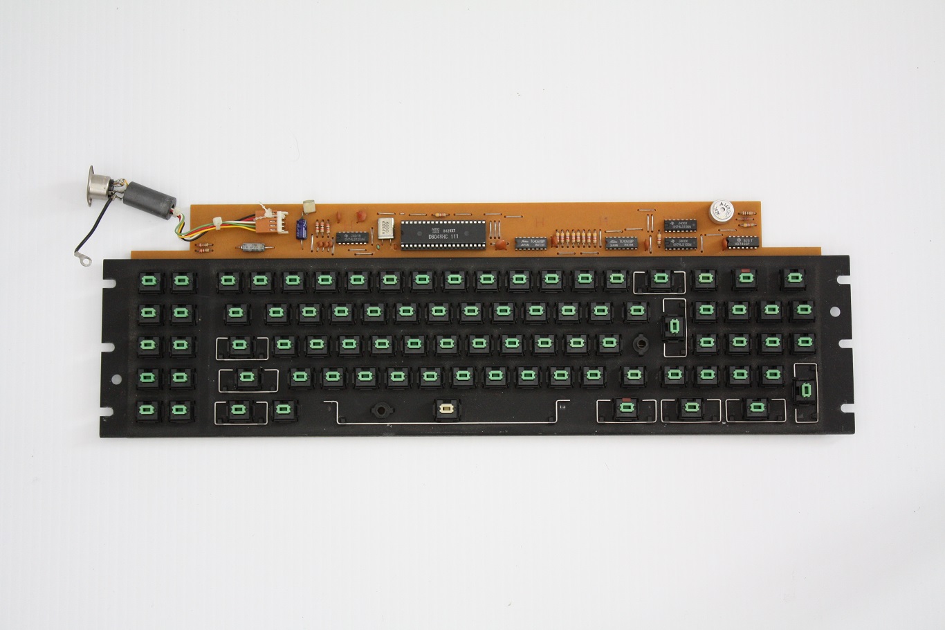

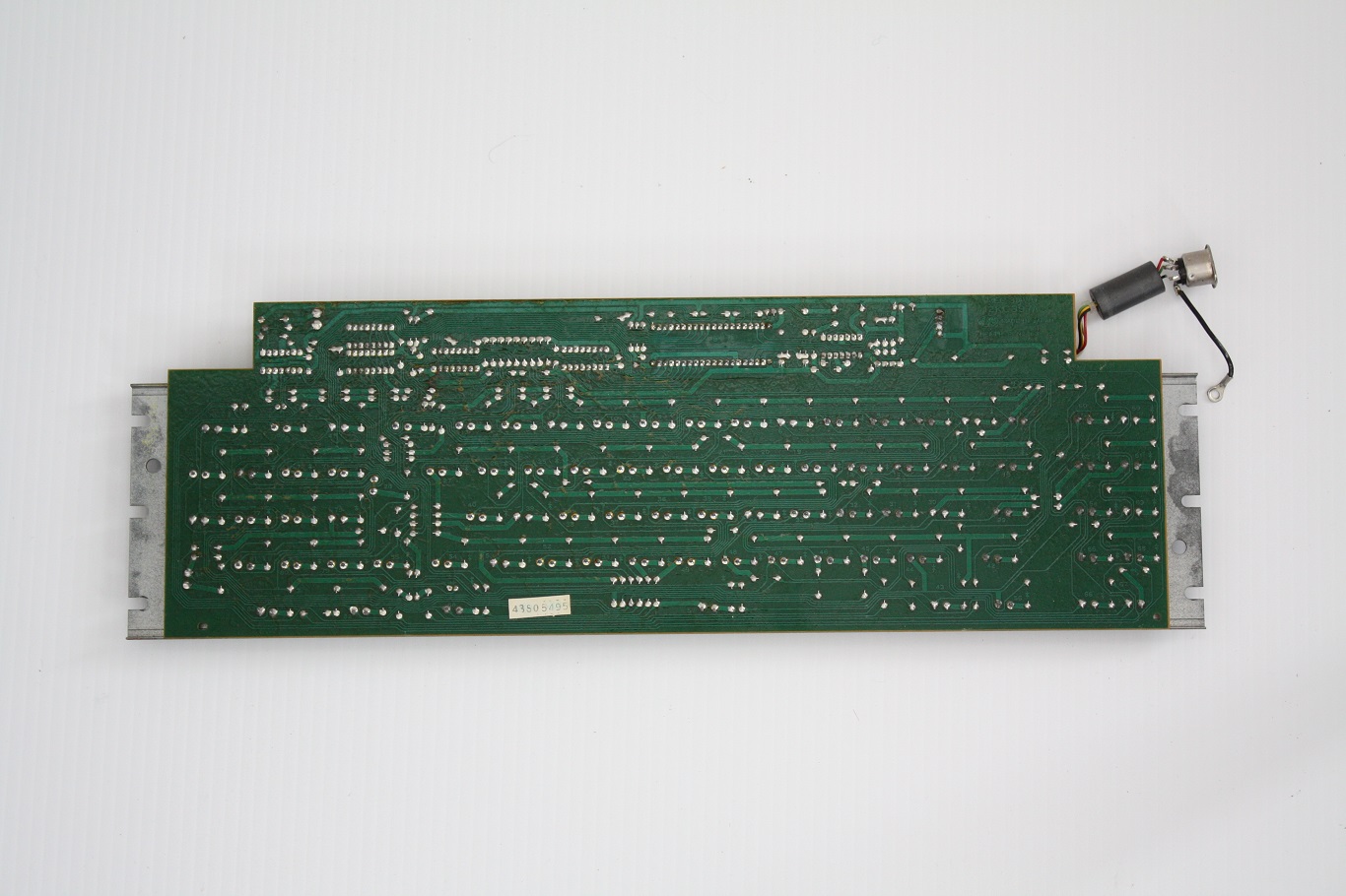

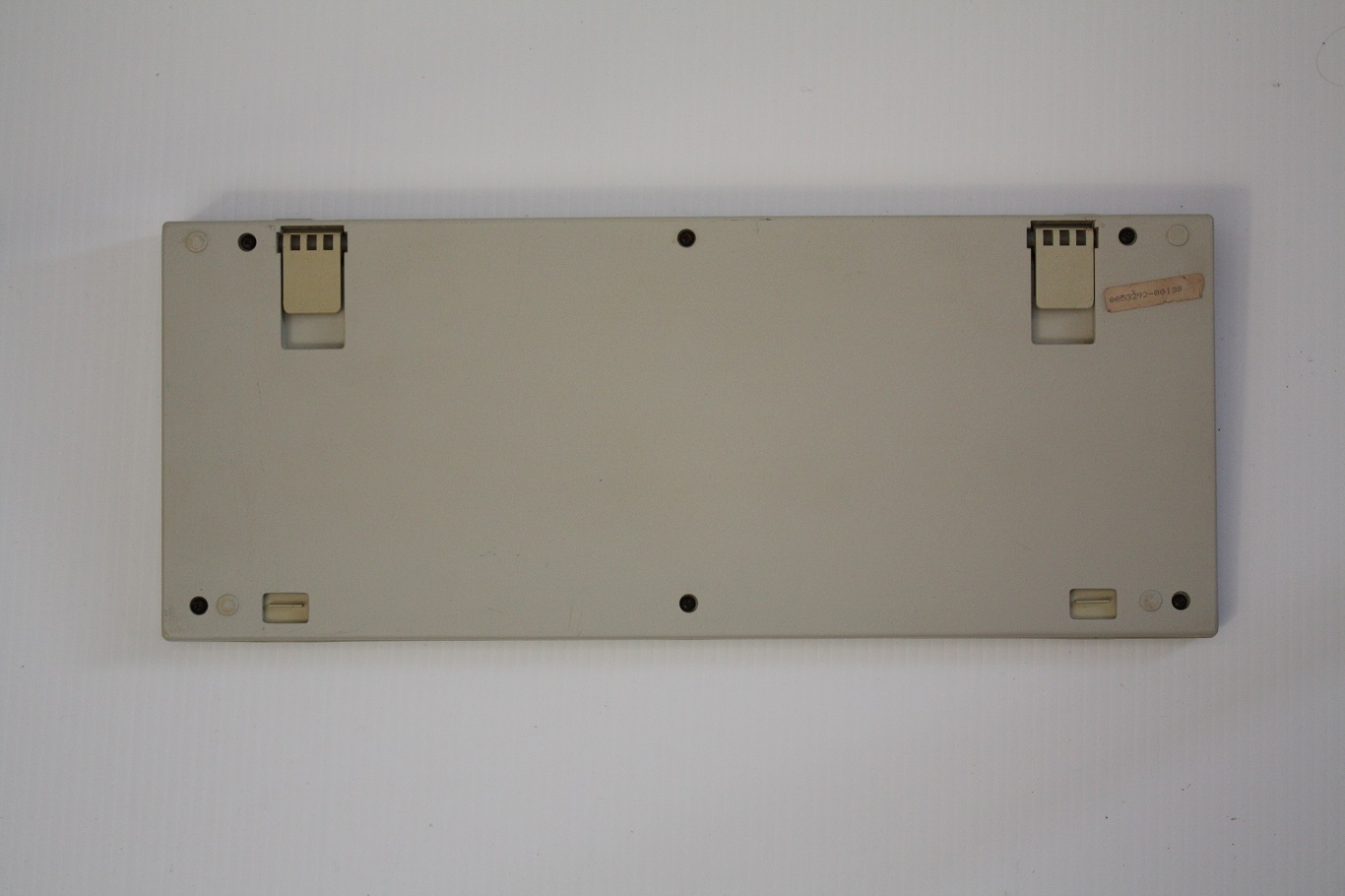

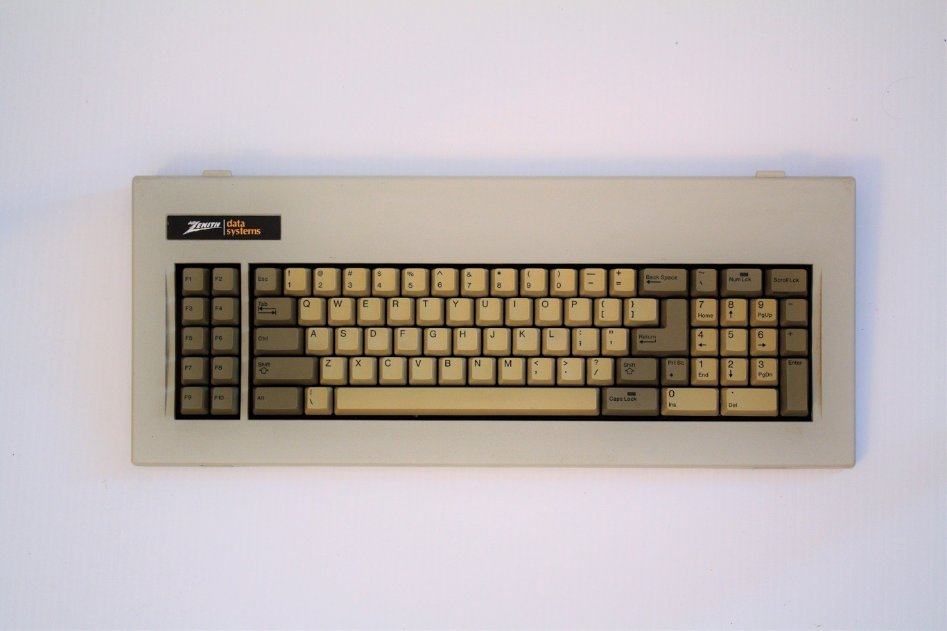

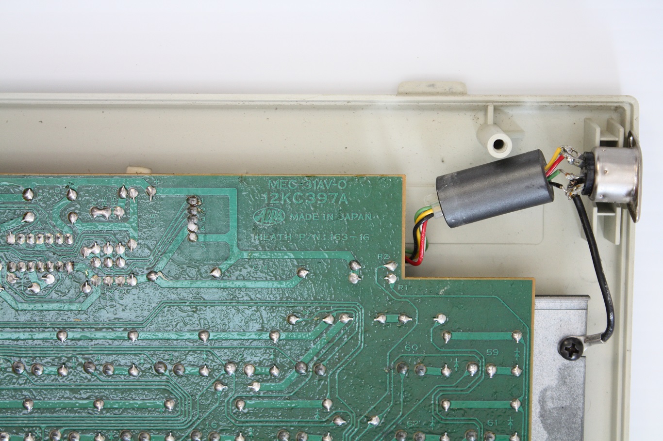

I hesitate to post this but I was cleaning the keyboard and thought I'd take some pictures while the keyboard was apart.
We have here the Zenith ZFA-161-416 that is a portable XT class computer. With a removable keyboard (I don't have the keyboard cable), it had a distinctive pop-up dual floppy mechanism. The keyboard that was included is a variation of the Zenith XT keyboards with a different case so that it could attach to the portable case for transport. This keyboard is from 1984 so it's fairly early. As you can plainly see, the key caps are ABS, unfortunately but the key switches are SKCL green Alps.
Question: Does anyone who has a similar Zenith XT keyboard know if I can use a coiled 5 pin DIN keyboard extender cable as a replacement for the original keyboard cable?
Here are some pics:
Zenith ZFA keyboard - keyboard top
Zenith ZFA keyboard - keyboard top.jpg (247.6 KiB) Viewed 21176 times

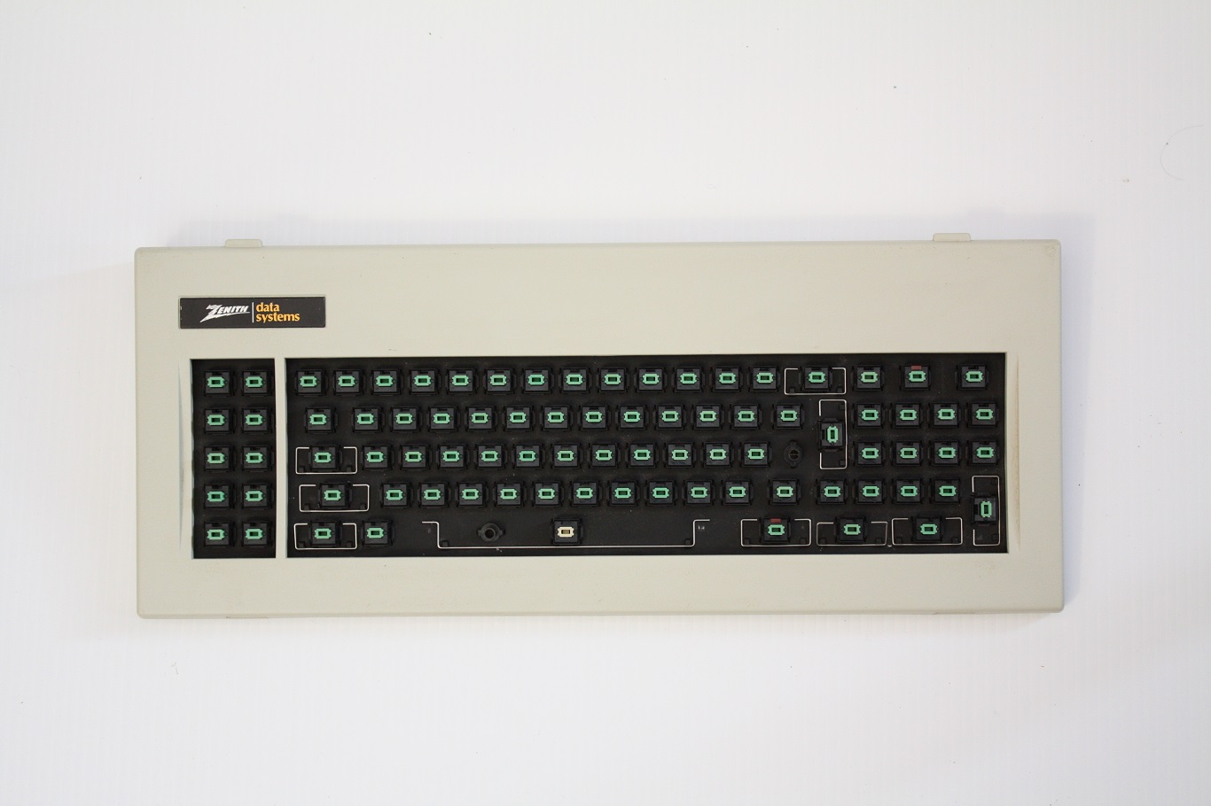

Zenith ZFA keyboard - keyboard top no key caps
Zenith ZFA keyboard - keyboard top no key caps.jpg (186.37 KiB) Viewed 21176 times
Zenith ZFA keyboard - keyboard mechanism top
Zenith ZFA keyboard - keyboard mechanism top.jpg (219.43 KiB) Viewed 21176 times
Zenith ZFA keyboard - keyboard mechanism bottom
Zenith ZFA keyboard - keyboard mechanism bottom.jpg (271.18 KiB) Viewed 21176 times
Zenith ZFA keyboard - Alps and Heath (Zenith) identification
Zenith ZFA keyboard - Alps and Heath (Zenith) identification.jpg (420.79 KiB) Viewed 21176 times

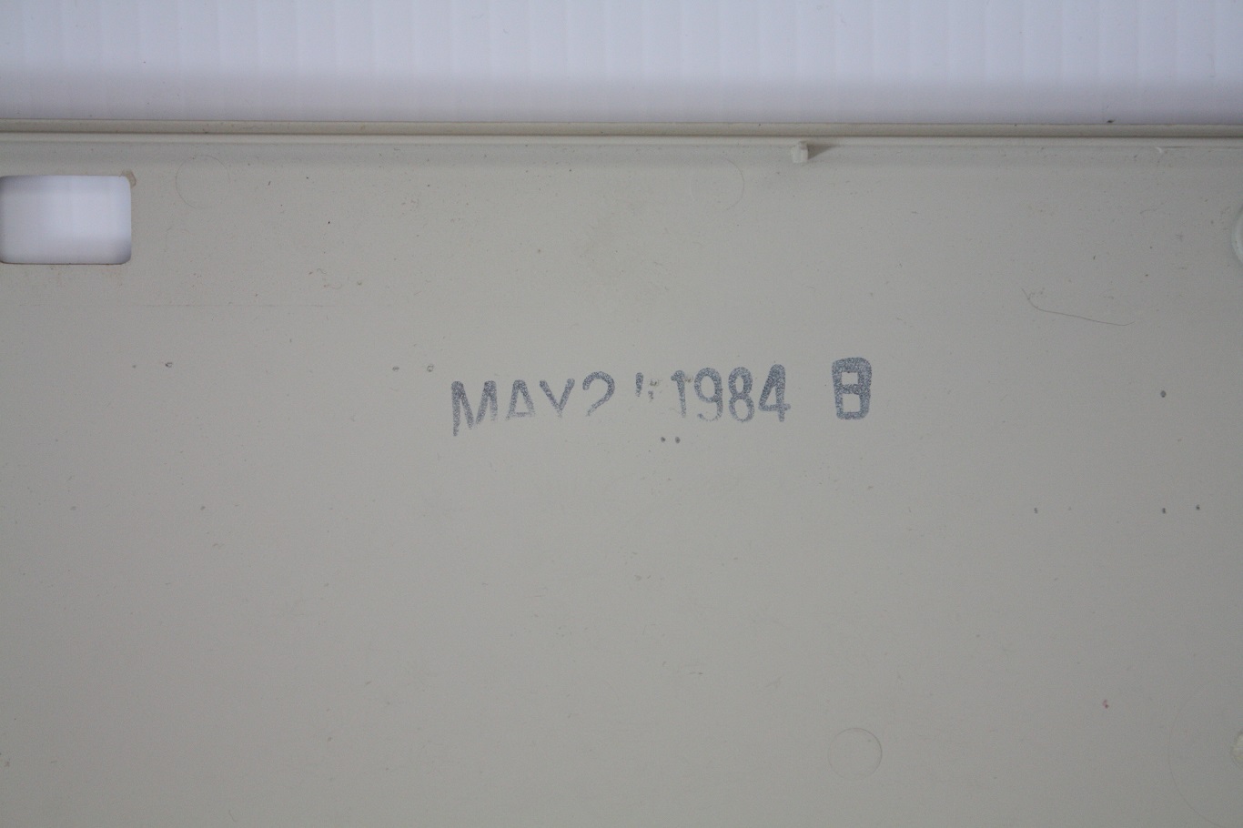

Zenith ZFA keyboard - case date stamp.jpg (196.91 KiB) Viewed 21176 times
Zenith ZFA keyboard - portable computer
Zenith ZFA keyboard - portable computer.jpg (215.9 KiB) Viewed 21176 times

Very nice pictures, and a nice board! These old Zenith boards have something IMO. Surprised it's made in Japan - I guess it was actually made by Alps themselves then! It's also one of the older ones I've seen, interesting how it already had ABS caps by that time. I can see the subtle differences in the case and the feet. Never heard of this model before, looks like the Zenith catalog was bigger than I thought!

SKCL Cream or SKCL Grey. They're spacebar switches for old Zeniths.

It's rare to see your keyboard's front & back case are differ to other Heathkit/Zenith Z-150 84key keyboard!(which made in 1984 both)
As I know white logo Zenith Z-150 keyboard are XT and AT compatible.(black logo is XT)
http://deskthority.net/wiki/Zenith_Data ... y_Keyboard
And what color is your switch under the space bar? It's quite unusual.

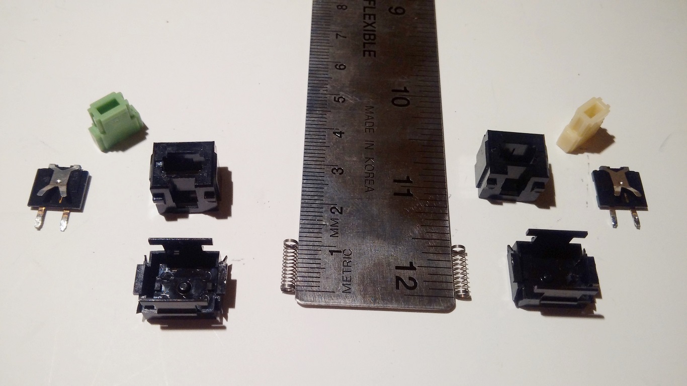

20 Jan 2016, 02:07

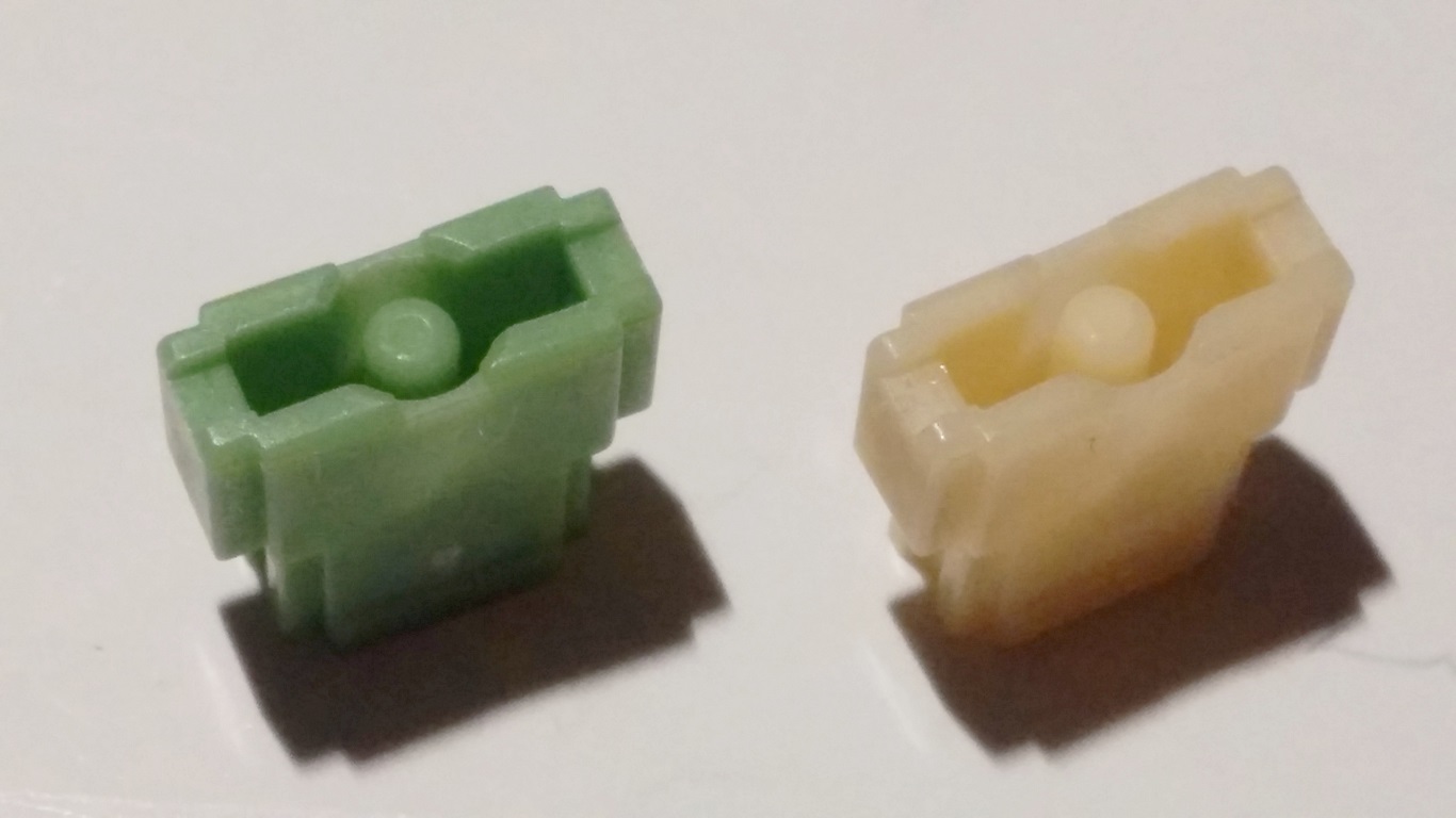

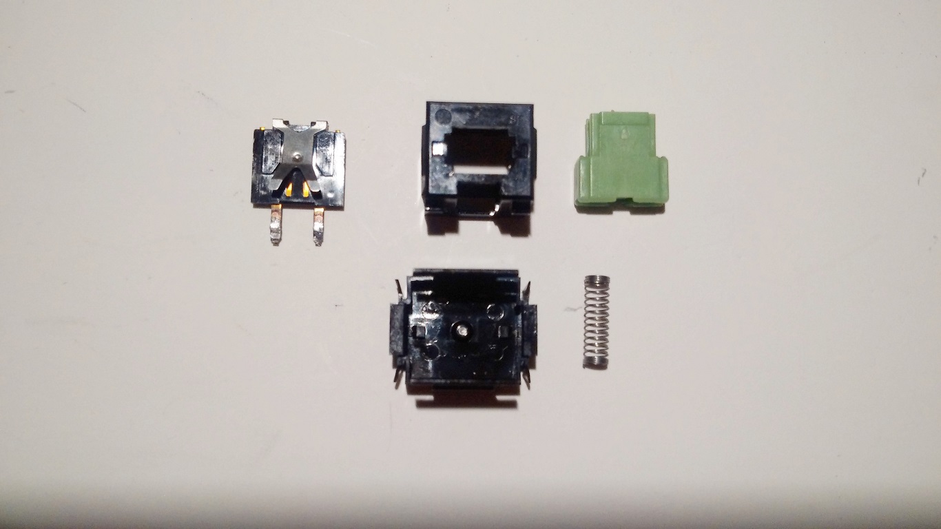

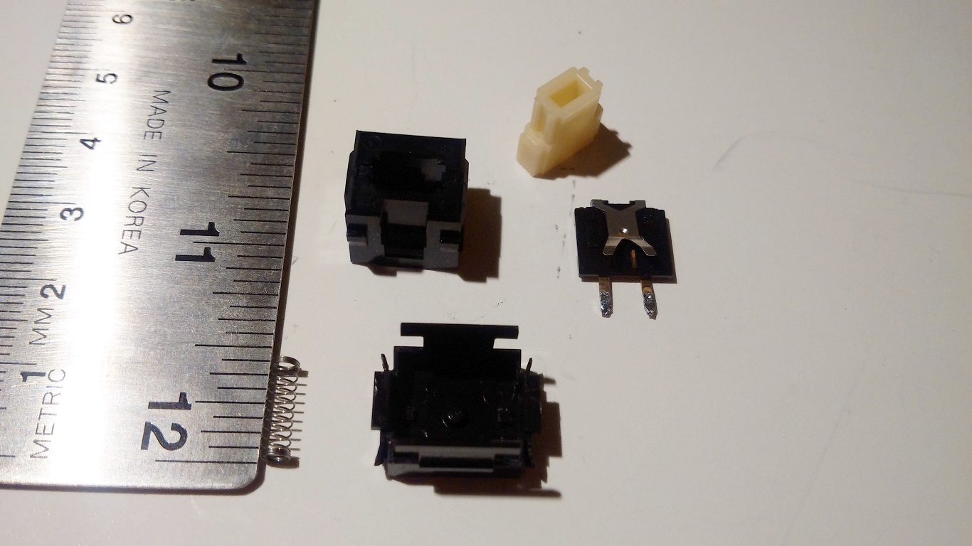

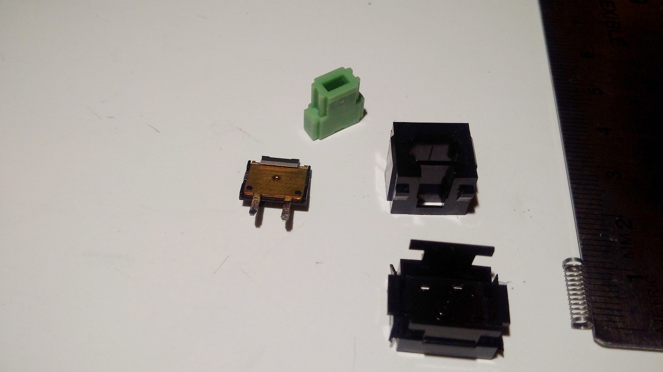

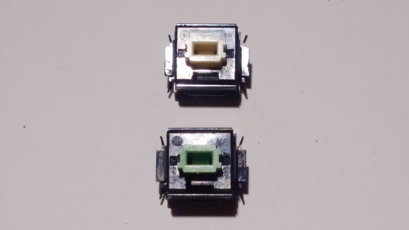

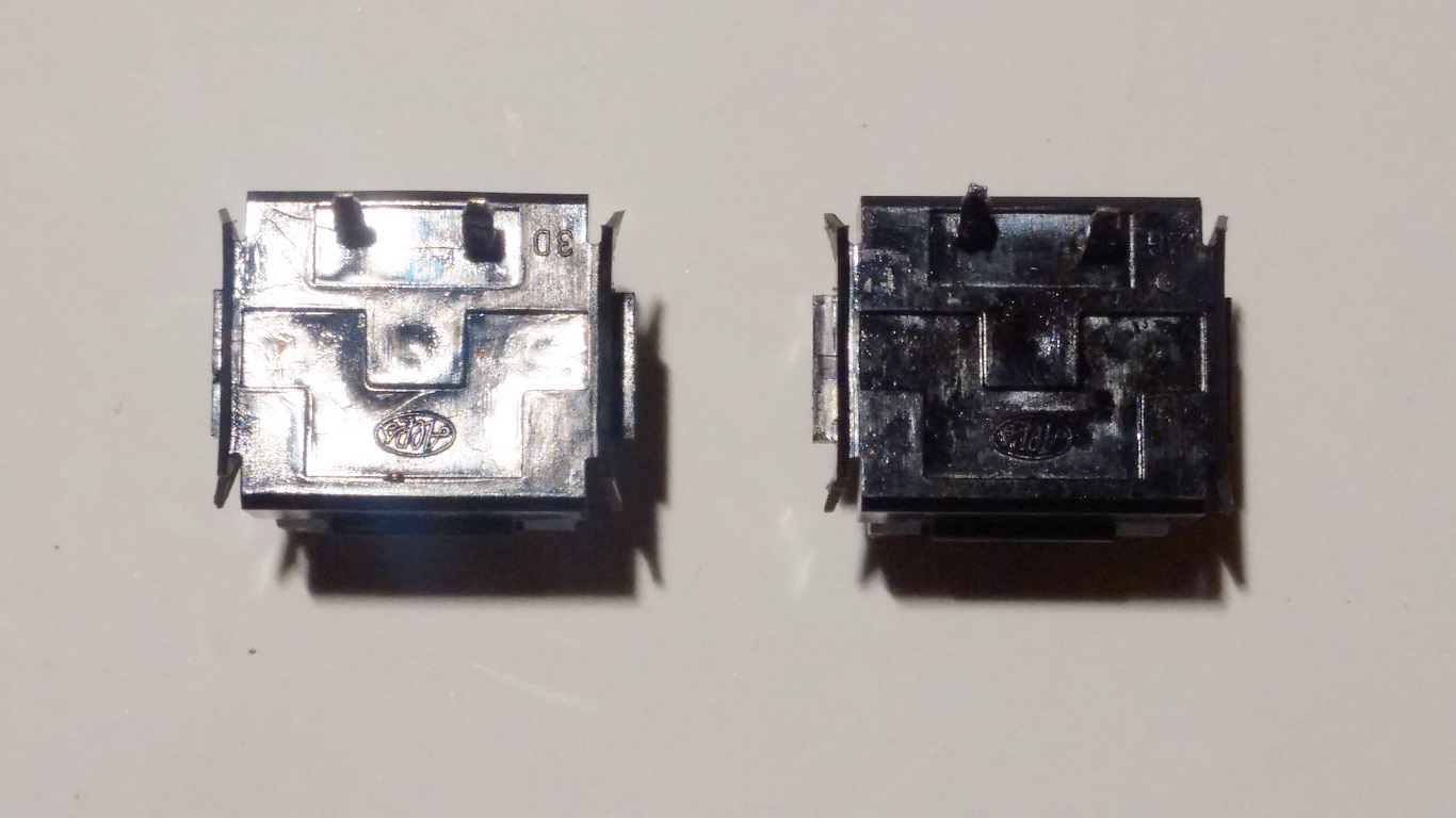

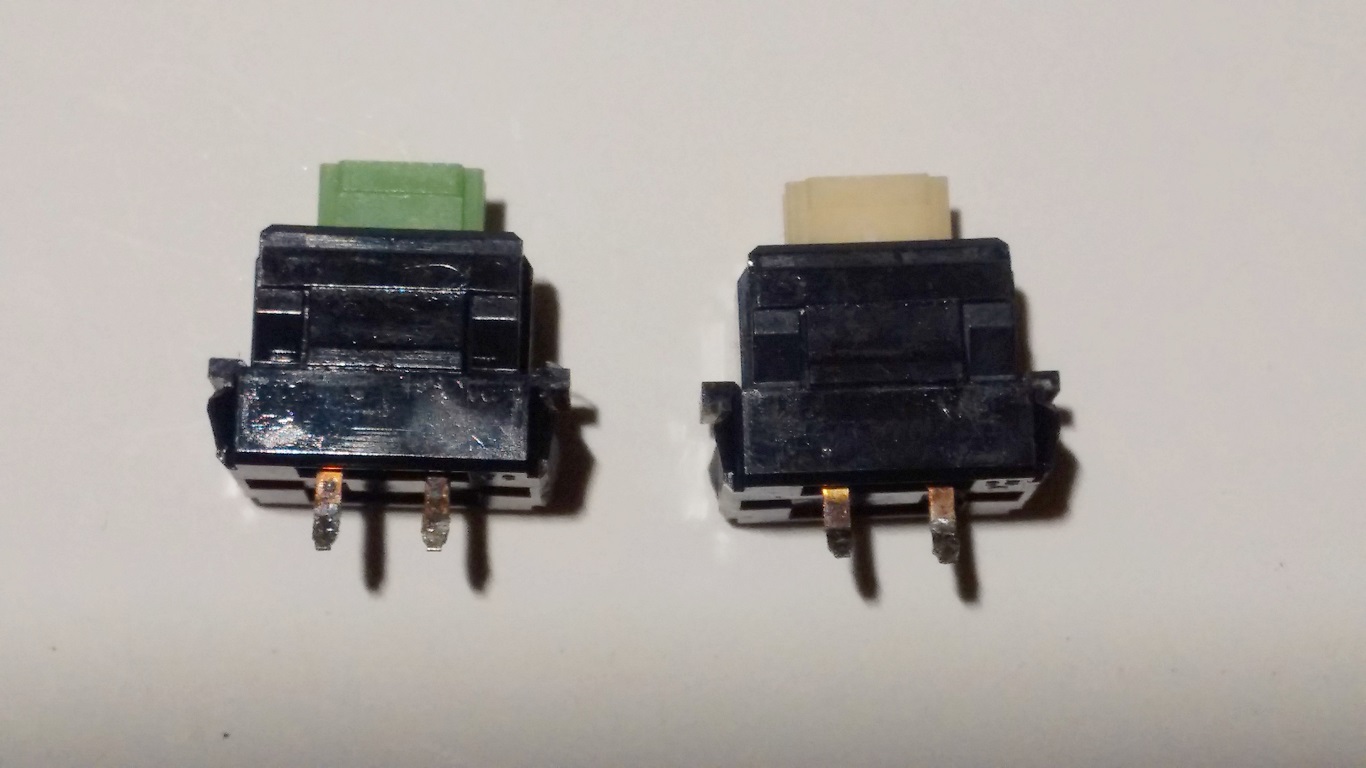

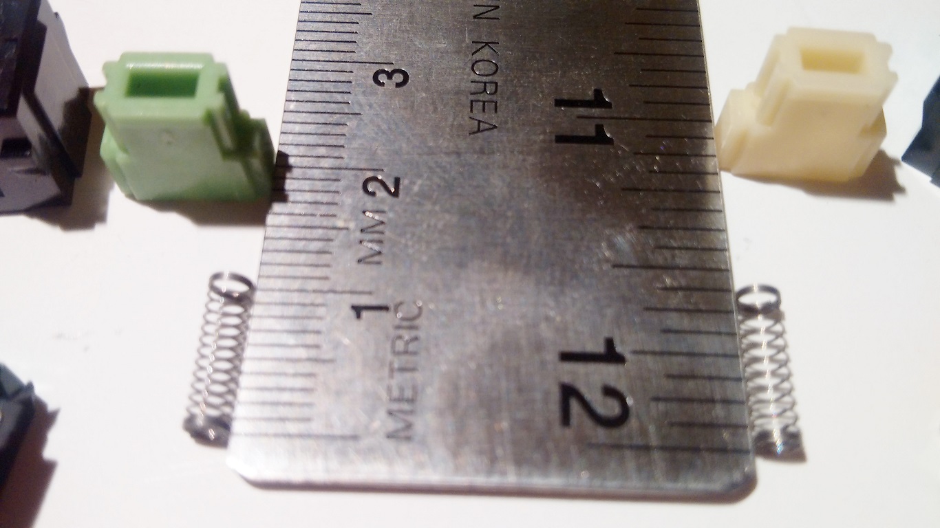

Here are some pics of the key switches dismantled. The only difference between the green and cream key switches appears to be the stem colour, naturally, and the internal spring windings.
Here are some pics:
Zenith ZFA keyboard -key switches top
Zenith ZFA keyboard -key switches top.jpg (233.29 KiB) Viewed 20892 times
Zenith ZFA keyboard -key switches side
Zenith ZFA keyboard -key switches side.jpg (237.08 KiB) Viewed 20892 times
Zenith ZFA keyboard -key switches bottom
Zenith ZFA keyboard -key switches bottom.jpg (274.33 KiB) Viewed 20892 times
Zenith ZFA keyboard - green Alps key switch
Zenith ZFA keyboard - green Alps key switch.jpg (228.38 KiB) Viewed 20892 times
Zenith ZFA keyboard - green Alps key switch angled
Zenith ZFA keyboard - green Alps key switch angled.jpg (230.46 KiB) Viewed 20892 times
Zenith ZFA keyboard - cream Alps key switch
Zenith ZFA keyboard - cream Alps key switch.jpg (299.81 KiB) Viewed 20892 times
Zenith ZFA keyboard - both Alps key switches
Zenith ZFA keyboard - both Alps key switches.jpg (281.99 KiB) Viewed 20892 times
Zenith ZFA keyboard - both internal springs
Zenith ZFA keyboard - both internal springs.jpg (292.43 KiB) Viewed 20892 times
20 Jan 2016, 10:10
Oh wow, this would mean SKCL Cream was one of the very first Alps CM switches Oo . Is the slider reversible like the one on SKCL Green, too? If so, I suspect they were developed side-by-side. Very interesting.
snuci
Vintage computer guy
20 Jan 2016, 23:34
This should answer that question.
It's funny but when you look at these, they almost look like they are made of "jade" and "bone" respectively.

21 Jan 2016, 00:29
It's hard to judge from that picture, actually Oo . Is it asymmetric like the later sliders or is it completely the same on both sides?
snuci
21 Jan 2016, 00:37
Sorry, completely the same on both sides. They are both symmetrical.
21 Jan 2016, 01:08
Cool, thanks! Definitely SKCL Cream were extremely early then.

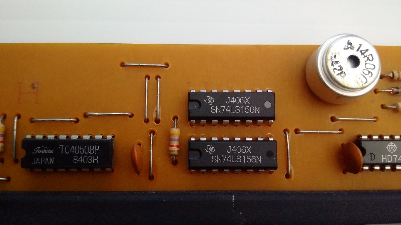

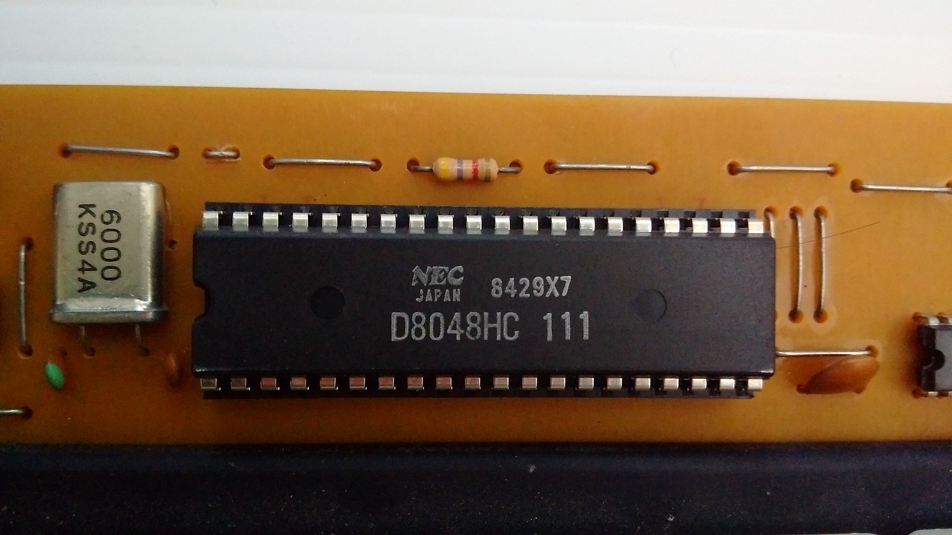

Just posting the last couple of pics of the components on the PCB board to date the actual board.
Zenith ZFA keyboard - 8048 controller
Zenith ZFA keyboard - 8048 controller.jpg (299.88 KiB) Viewed 20759 times
Zenith ZFA keyboard - PCB components
Zenith ZFA keyboard - PCB components.jpg (302.11 KiB) Viewed 20759 times
