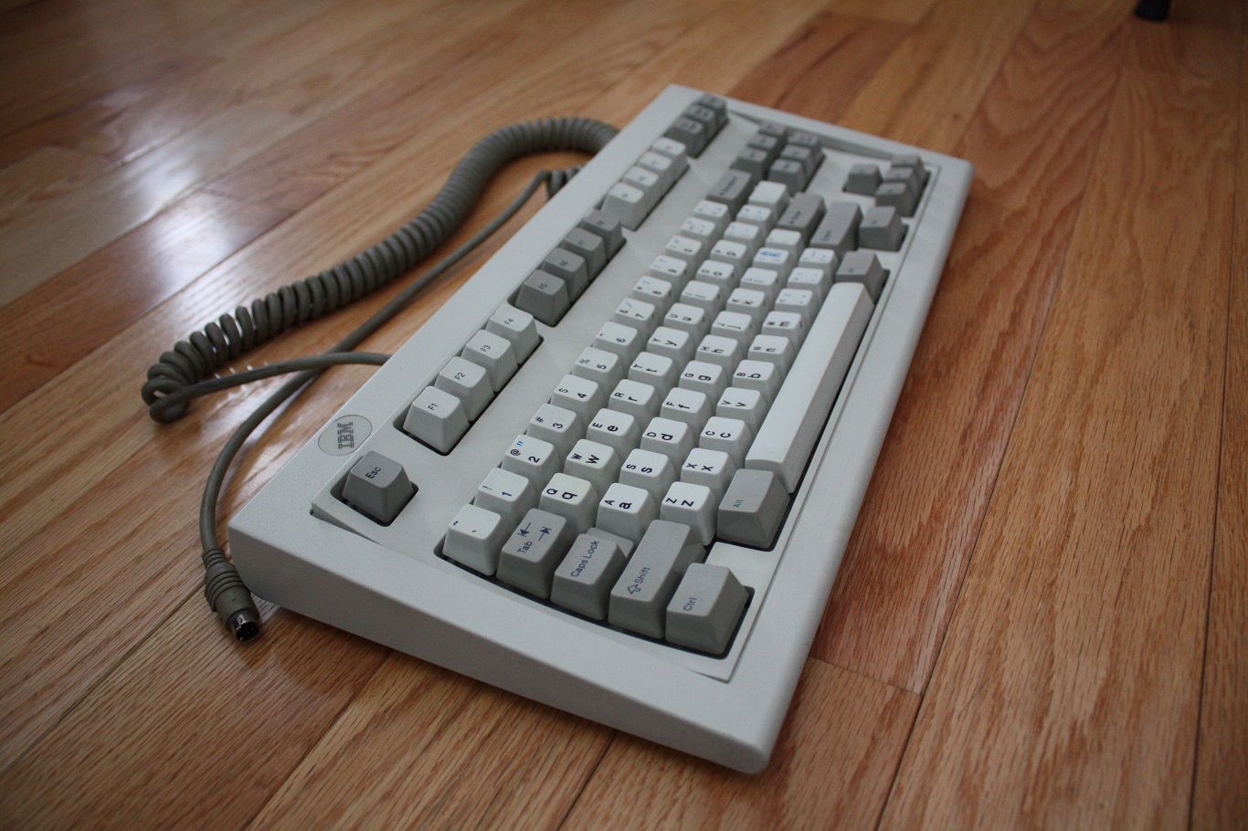

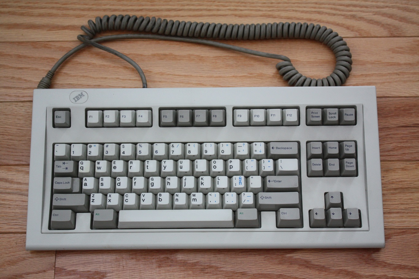

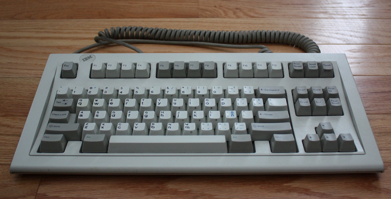

Well, here are some pics of the key caps on an IBM Model M SSK keyboard. Looks pretty cool:
IBM Model M SSK with Upper/Lower case key caps
IBM Model M SSK Upper Lower.JPG (371.89 KiB) Viewed 10816 times
IBM Model M SSK Upper Lower - side.JPG (283.79 KiB) Viewed 10816 times

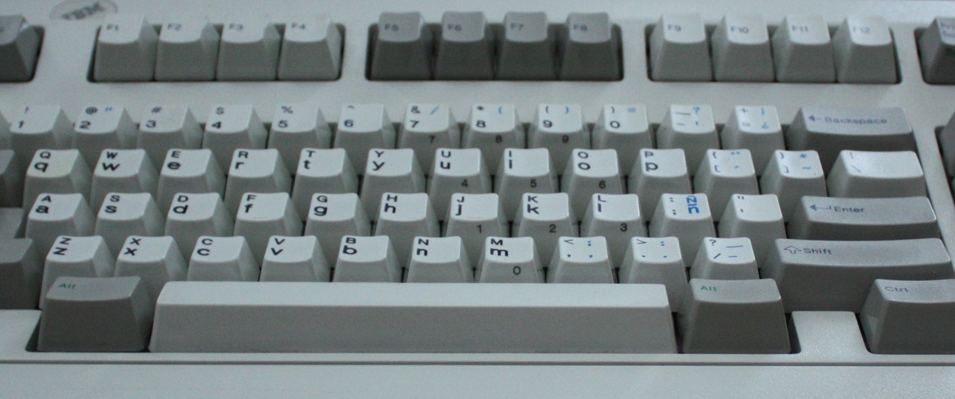

Close Up
Close Up
IBM Model M SSK Upper Lower - side 2.JPG (222.21 KiB) Viewed 10816 times

Redmaus
Gotta start somewhere
31 Dec 2015, 17:20
That is quite a find. I have never seen caps like those.
Nice job. I'm jelly. 8-)

Interesting set. If you find another one, send them to me. :mrgreen:
jerue
02 Jan 2016, 19:16
Those look fantastic on the SSK.
And I thought my Displaywrite caps were something special... :lol:
02 Jan 2016, 19:43
Interesting. Not quite my style, but looking at those SSK shots is making me nostalgic for mine. I only brought my HHKB out here to America with me! <sniff>

maxmalkav
dye hard
03 Jan 2016, 09:42
Indeed is an attempt to map ISO Spanish layout on ANSI with a couple of omissions (°, ç, <> and one weird point only used to write Catalonian)
pcaro
03 Jan 2016, 14:13
The best keycaps I never saw! It fill my main keyboard usage. English for programing or forums and spanish for writting (with a shortcut for language change)

13 Aug 2017, 15:30
I've just found this thread (after a mention on keyboards-f2/list-of-all-known-ssk-keyc ... 17185.html), and this is the information that I can offer:
1) The blue legends clearly correspond to the "Spanish (Latin America)" layout (distinct from the "Spanish (Spain)" layout).
2) The set seems to be incomplete — it should also contain the following keys:
- A «~ `» key with "° |" (degree, pipe) printed in blue.
- A «6» key with an "&" (ampersand) printed in blue.
- A «" '» key with "[ {" printed in blue.
- A 1.5U «| \» with "] }" printed in blue.
It's not clear whether this set ever included these keys or not. The mystery deepens when taking into account a couple extra oddities:
- The «Q» key could have had the @ sign front-printed in blue (as the ES(LA) layout assigns said sign to AltGr-Q).
- The «} ]» key adds "* ~" in blue, but... in the ES(LA) layout, that key has the + (plus) sign in the unshifted state, and the ~ (tilde) sign available through AltGr.
snuci
Vintage computer guy
13 Aug 2017, 16:48
Thanks for the reply. It's definitely an odd set and all searches on the IBM part number return nothing. I'm still also not clear on why they made it but it is pretty cool.
13 Aug 2017, 16:52
snuci wrote: I'm still also not clear on why they made it but it is pretty cool.
I would venture to guess that this was for the benefit of people in Latin American countries where ANSI keyboards were common.
13 Aug 2017, 16:55
... come to think of it, this implies that SSKs would have sold well enough, at least in some countries, to justify the production of this alternative keycap set (and what about other languages??).
