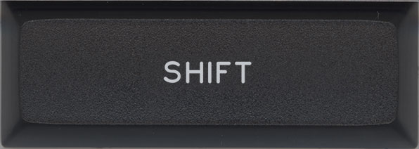

First up is a scan of my Dolch DSA 2.75u shift key:
Dolch DSA 2.75u shift key (original scan)

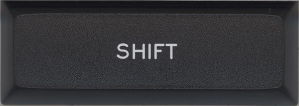

Next is the same keycap scan, but with my digital version of the legend with the same F T ligature:
Digital legend with original glyph separation (gs = 1)
Here is the digital legend where the glyph separation between the F and T is uniform with the separation between all the other letters in the legend:
Digital legend with uniform glyph separation

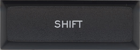

Here, the glyph separation is 75% of the original glyph separation:
Digital legend with 75% glyph separation (gs = 0.75)
Here the glyph separation is 50% of the original:
Digital legend with 50% glyph separation (gs = 0.5)
Here the glyph separation is 25% of the original:
Digital legend with 25% glyph separation (gs = 0.25)
And last, no glyph separation at all:
Digital legend with no glyph separation (gs = 0)

Well, in this case kerning is impossible, what we need is F and T almost touching each other.
zslane can you do one with 25% separation? 50% still seems too far away.
07 Sep 2015, 01:01
Try zero separation. A true ligature!
07 Sep 2015, 01:11
This looks pretty good to me.
I'm afraid Melissa will tell you that this is not possible, because the gap is too close, but then there is such a little island in the messed up ¥ key, that I don't believe there is such limitation.
:roll:

I've updated the original post with 25% and 0% separation.
chzel
07 Sep 2015, 01:23
In my eyes the 25% is the best, but I miiight be biased :)

50% looks good. Where's the poll? :)
07 Sep 2015, 03:15
25% is the best looking. But I'd like to see what happens to it once it's passed through SP!

zslane
08 Sep 2015, 02:51
So here are some measurements to give context to the spacing/gap discussion. They are all approximations accurate to about 0.001" at best.
  • The space between the F and the T in SP's current shift key legends is ~0.027"
  • The space between each of the other letters S-H-I-F averages ~0.023"
  • The space between the F and the T in my 75% sample is ~0.020"
  • The space between the F and the T in my 50% sample is ~0.014"
  • The space between the F and the T in my 25% sample is ~0.007"
Today I received a PDF from Melissa describing their requirements for custom double-shot molding. That document says:
On any 2-shot legend, there needs to be a minimum space of 0.020" to 0.035" between characters and lines...
That makes the 75% spacing the narrowest spacing we should expect to have any hope of success with. And with their margin of error, an F-T gap of 0.020" in my vector file could still end up being closer to 0.025" when it comes out of the mold, and yield no noticeable improvement at all. I could instead send them the version with 50% spacing (0.014") and hope that it actually comes out closer to 0.018" or 0.020", but I'm not so sure that throwing money at the 25% version would be productive use of funds.
Thoughts?
