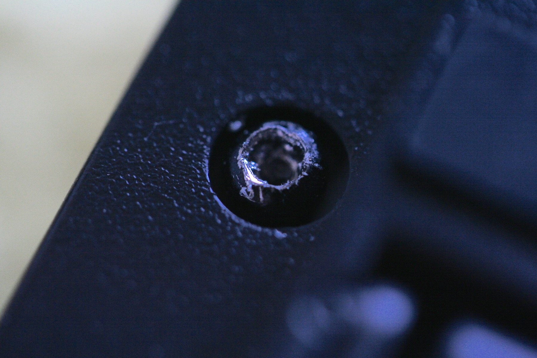

Much to my frustration, instead of simple Philips head, Cherry opted to use funny little 6 pointed screws on the "engineering sample" MX Board 6.0 that I have here for review. More than a dozen of them in fact…
Rummaging around through my tools, I couldn't find anything right. I've got six point screwdriver heads, but all much too big. Using a couple of flat headed screwdrivers of approximately the right size, I managed to get all the buggers out besides one. Uh oh!
Yeah, the macro lens does not lie. This wee bastard's well and truly mauled.
Anyone got tips for how to convince this one to come out? I can peek inside the keyboard with it still in place, but it really needs removed to get real access. Gah!

The "funny little 6 pointed screws" are called Torx, much better than a regular Philipps or hex bolt! You could carefully drill the screw out with a slightly smaller bit than the screws diameter.
07 Aug 2015, 20:33
Torx are great... unless you want to take them out and don't have the right drivers around!
07 Aug 2015, 20:35
See if you have a small flat screwdriver that will fit that torx diagonally. Just make sure not to maul it more. :O

I've got Torx. But they're all too big. My smallest is T10. These bastards look like T6 or something, so small!

Your best bet is a screw extractor. It's a little spiral headed bit that gouges into the screw and allows you to unscrew it long after you've destroyed the head.

Got any small Allens? They might get enough grip in there. Or get (buy or borrow you cheapskate!) a properly sized Torx. Torx screws are good at surviving this kind of abuse.

If the torx was bigger I'd say drill in the center but that's unpractical at that size as you may damage the keyboard.

The first tools I tried (before mauling) were my smallest Allen keys. None gripped. They picked a daft size.
I'll try to rustle up a crazy little Torx driver. No idea I'd caused that much distortion until I whipped out the macro. This was gentle stuff, um, honest.

jbondeson wrote: Your best bet is a screw extractor. It's a little spiral headed bit that gouges into the screw and allows you to unscrew it long after you've destroyed the head.
+1 for this, I have to imagine they put torx on to prevent exactly what you were doing Mu. Do you know of any other boards that come with torx?

I usually use a rubber band and a flat head on those buggers but yours may be too small for that
08 Aug 2015, 21:49
Thanks for the suggestions folks. I like the rubber band idea, I'll try that and then get progressively more brutal. Uh, I mean, um, persuasive. My brother suggests cutting a notch across the screw head and using a large flat screwdriver, but he overestimates the access space I have.

Muirium wrote: Thanks for the suggestions folks. I like the rubber band idea, I'll try that and then get progressively more brutal. Uh, I mean, um, persuasive. My brother suggests cutting a notch across the screw head and using a large flat screwdriver, but he overestimates the access space I have.
I've done that with a tiny little dremel, if you have access to something like that, your brother may be right.

I would second a screw extractor. I bought a set and it has been completely worth it.

Maybe. How good are they on small screws in confined spaces?

They are a little tricky to use. For the drill end, you can use a power tool, but when you switch to the extractor end, I would do it by hand and go slowly. You will read a lot of bad reviews from people who try to use the extractor with a drill.

One end is a drill that shapes the hole in to a cone. The other end has a reverse spiral cutting edge. Since the spiral is reverse as you turn in the direction that loosens the screw the cutting edge digs into the screw tighter and tighter, allowing you to loosen and remove the screw.
