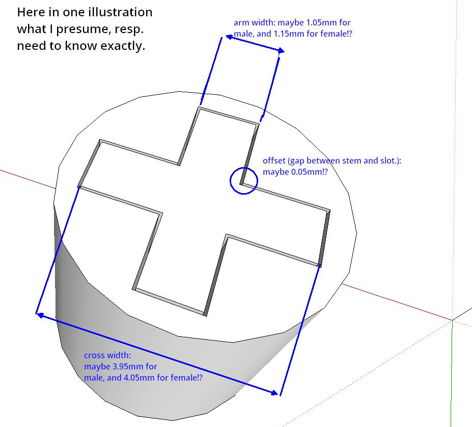

Hi guys! Can someone help me with information please. I need the exact measurements of the Cherry MX mount. Here is what I need:
stem (male) cross, arm width: ... (1mm?)
slot (female) cross, arm width: ... (1.1mm?)
stem (male) cross, width: ... (4mm?)
slot (female) cross, width: ... (4.1mm?)
stem (male) cross height: ... (~5mm?)
What I read in the Wiki is not entirely clear, for example:
Cherry's MX keycap specifications give the keycap slot dimensions as a cross 4.1+0.05 mm wide, with arms 1.17±0.02 mm wide[1] (this would make them 1.465 mm long). There are no known specifications for the switch stem. Signature Plastics gives the dimensions (presumably of the keycap) as a cross 0.159ʺ (4.04 mm) wide, with arms 0.047ʺ (1.19 mm) wide.
What is correct? I need exact specification, so that the male cross fits the female cross perfectly, and doesn't sit too tight or too loose.

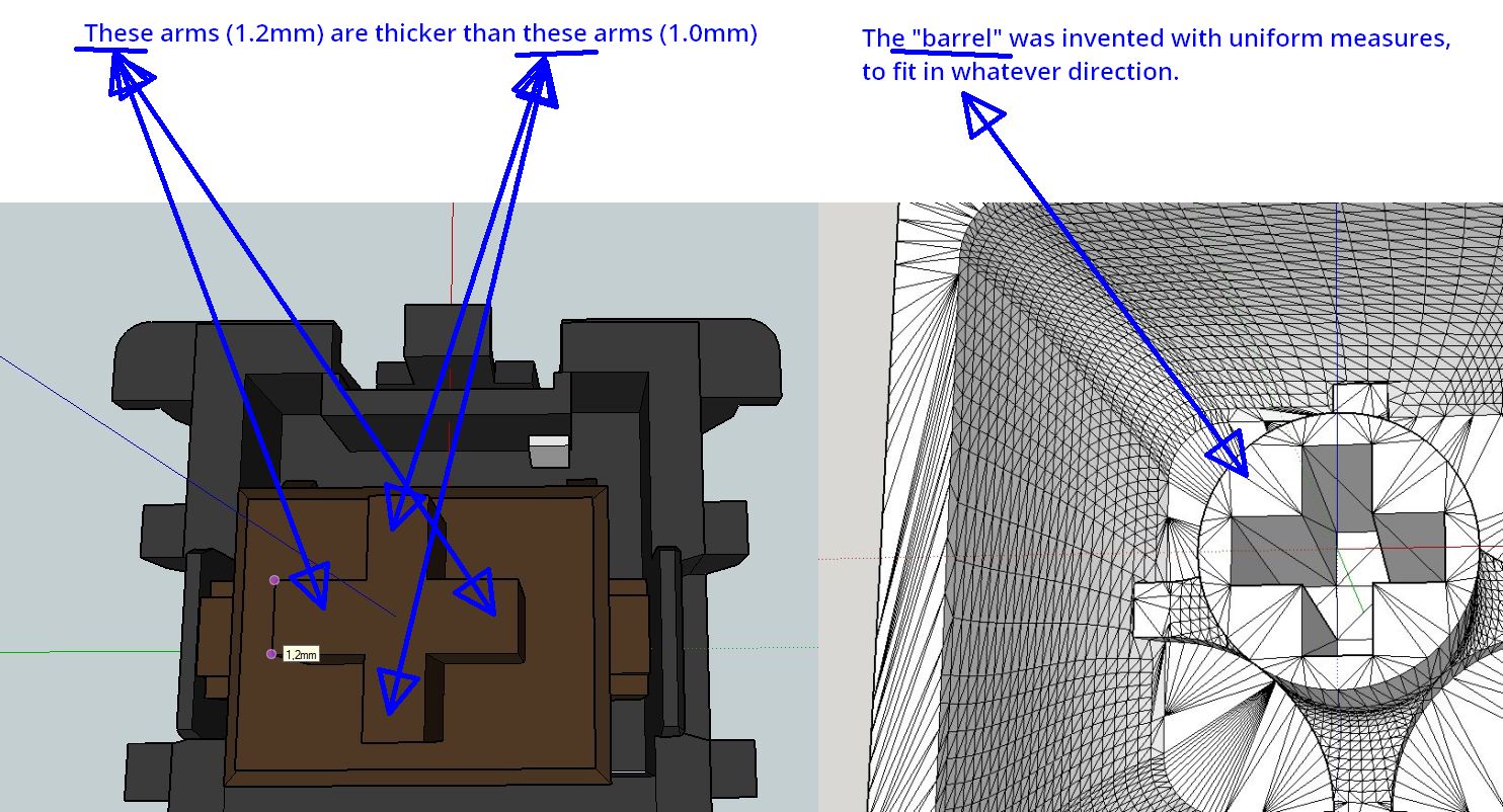

Alright, Muirium. Update: My neighbour lent me his digital calipers. What I measured is abit uncertain:
about 1.03 mm to 1.09 mm (?) for the stem arm width
about 3.93 mm to 3.98 mm (?) for the stem cross width
The problem is, I can only measure the stem. I can't measure the keycap slot with the calipers I use, they won't dip into this tiny slot. Especially important is the offset between stem and slot. Maybe 0.05mm for each contact?
Since pictures tell more than words:

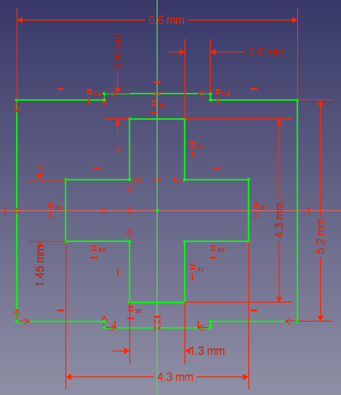

But it is not hard. The cap I posted is probably about 4. iteration. I guess it took me about 4 hours to get it right on my printer. If you have a 3d printer and the IBM cap does not have too thin wall or too thin pillars then you can do it ... in the worst case in about a day. If you do not have a 3d printer but have a lot of money then you can get it right through Shapeways after a few iterations too.
Here is the picture of the cap in the FreeCAD document:

@vvp Hi! What are your measurements? I can't open FreeCAD files, but I may install FreeCAD later just for the sake ... Yes, the resulting measurements also depend on production process, material. However, I'd like to avoid going trial and error, with 3dprinting alot of keycaps, just to realize, that they don't work and throw them into garbage. I prefer to design on exact specifications to avoid as much mistakes to reduce prototyping to the minimum. BTW, would you like to help me with prototyping, ie. 3dprinting some caps?
vvp
21 Jul 2015, 18:07
Sorry, no time, nor interest in keycaps. You can get them for 10-20 ¢ a piece from 7bit (that is if you do not want something fancy but the most simple ones). I did it only as a test whether it can be done at all. FFF printers are not very reliable for small features. Especially the ones which use bowden extruder (like the one next to me :) ). If you need reliable small features then you need an SLS or an SLA 3d Printer. These printers will need the dimensions tweaked differently.
The dimensions are attached. These are suitable for RepRap 3d Printer (i.e. simple FFF/FDM) with Ø 0.5 mm nozzle.

@vvp I will order printing from a 3d printing service, so I don't know much about different printer models. The dimensions you give differ abit from the other ones I've heard so far. Maybe due to the 3dprinter you use, which adds a little more plastic, than designed?
Signature Plastics says: 4mm * 4mm * 1mm (for the female "cross")
BlueNalgene says: 4.1mm * 4.1mm * 1.35mm (for the female "cross")
You say: 4.3mm * 4.3mm * 1.3mm (for the female "cross")

Little update. I still don't know what measures of the keycap will work for me, but what I got to know so far is the measures of the Cherry MX switch stems (the male cross): 4mm x 4mm, and the "arms" from left to right are 1.2mm thick, and the armes from front to back are 1mm thick. Note: you can't mount a keycap which fits precisely to this cross in any other direction than designated, because the arms from left to right are thicker than those from front to back. That's probably the reason why "the barrel" was invented, which is a stem counterpart (female cross) with uniform measures in all directions. My Filco ABS keycaps have this round barrel which holds the female cross. DSA keycaps from SP have it too. Here a illustration of what I want to say:
vvp
28 Jul 2015, 02:30
My guess would be that the "barrel" is used more to save the plastics than to allow mounting of the cap rotated by 90°.
Some keycaps do not even have a barrel, only a thin shell around the cross. This way they save even more plastics.
My model uses as much material as will fit there because it is hard to 3D print too thin structures using FFF/FDM method. If you want to design for FFF/FDM then use as much material as you can fit around the cross.

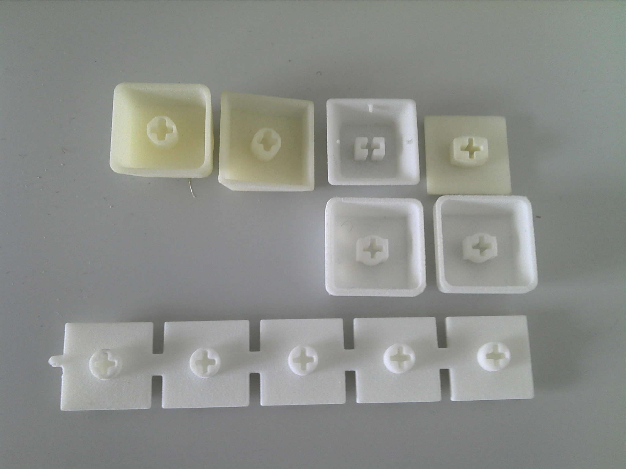

My first FDM-3dprinting test run turned out to be total crap. Unuseable. The female stem became much too small (~3mm) and inaccurate like a amorphic hole. I guess I have to scale the 3d models female stem up by 1mm (e.g. 5.3mm wide), just that it turns out right (4.3mm). Could be still unuseable because the FDM printing technology seems to be too inaccurate for such tiny items. (?)

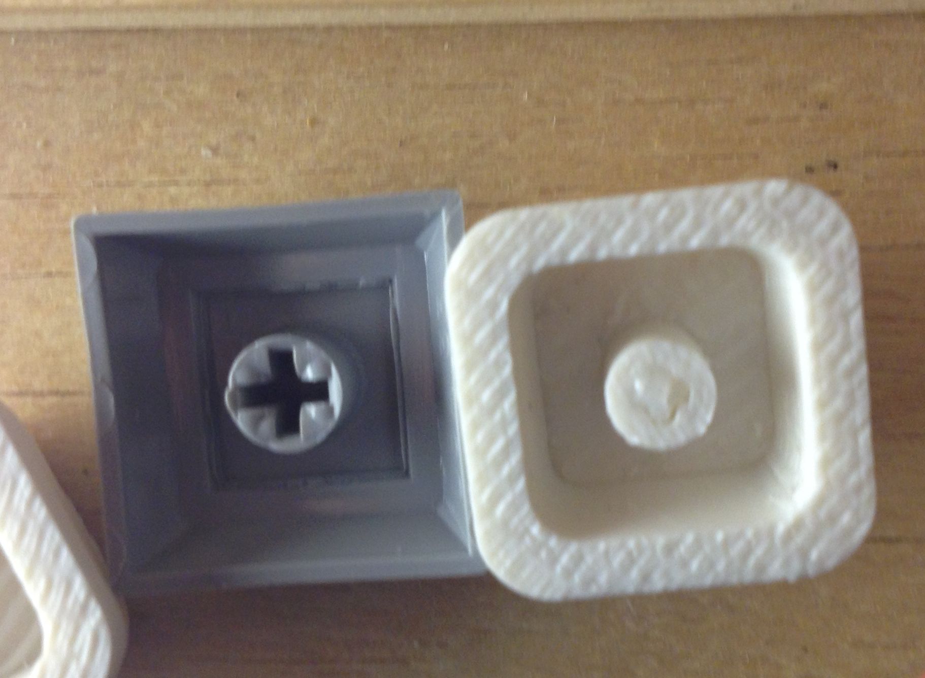

Eszett
29 Jul 2015, 19:47
Hi vvp! Here is a photo. "1mm" shrinkage was just my guess, but the keycap stem (female cross) turned out way too small. In my 3d model the female cross has the measure 4.15mm wide and each arm 1.25mm thick. See on the photo how small it is! The other issue is that the female cross is filled with supporting substance, and I can't remove it. The keycaps were printed upside up. Maybe I should try to print them upside down to resolve this issue?

The printer looks like it produces a good result for such a thin stem. Looks like the extruder is not using bowden (or it is very well calibrated).
Check with the producer whether the support material can be dissolved in something which would not dissolve the keycap material itself. E.g. there are materials for FFF/FDM printers which can be dissolved in water; these are often selected for support. It is possible that the bottom layer is over-extruded so that it sticks to the bed better. If so then this would close the bottom of the cross more, but the rest (higher up the stem) may be fine.
If possible then dissolve the support material from the stem and try to cut out the proper cross from the bottom layer. See if the rest of them are OK.
Ask them to print the keycap without support material. It should go fine. The bridges will be short. The printer should not have a problem making them. From the picture, it looks like even the outer stem diameter is smaller than it should be. That is not good. I do not know why it is so. Such a thing never happened to me. You may be forced to make the stem shape as I did it in my model (i.e. you would not be able to rotate the keycap by 90°).
You can try to print it upside down but I doubt it helps much.

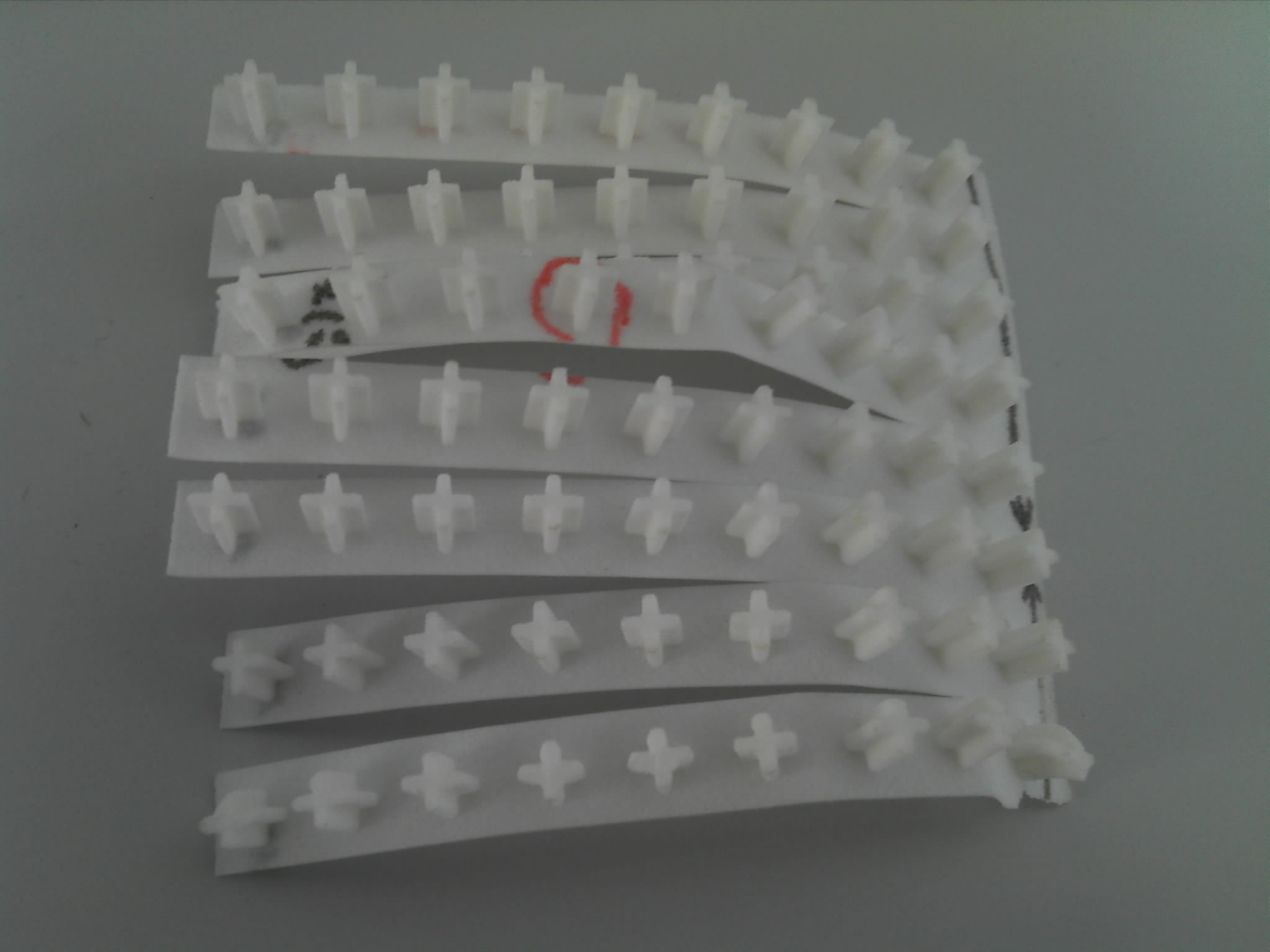

Just for reference here are some crappy shots of several MX mount designs I employed in the past, printed with SLS:
Various MX caps
Various MX caps

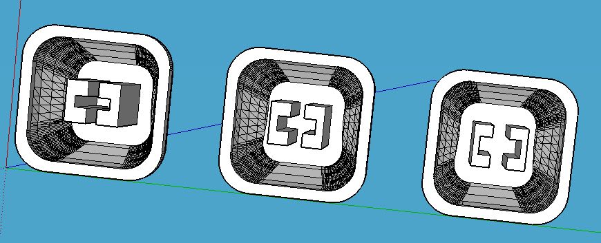

Maybe one of the simpler or open geometries that could be more easily reworked afterwards would allow to also print them on less exact machines?
But even with SLS one does benefit from some scaling experiments prior to finalizing production :D :
Empirical size for the stems

@vvp Yes, I will ask them for printing without supporting material. And print upside down. I would like to change over to SLS/SLA, but it is more expensive, and I don't like 50+€ costs just for prototyping :-(
@suka Good idea to print a series of differently sized stems. And I like this "open geometry cross",
since I see some advantages: 1) it makes it easy to scratch supporting material out 2) it gets rid of the thin walls (more stable) 3) and it is easier to rework. I doubt that I can rework ABS though(?)

Note that open geometry means smaller islands (separated 2D areas) in the horizontal cut of the keycap. Something which was one island with a hole will become two separate islands. This means there will be a retraction when moving form one island to the other one. Though one can suppress the retract in the slicer and clean up strings later on - but this will lead to errors in the filament amount deposition.
Retractions mean errors in the amount of the material deposited especially with the bowden extruders. This problem is about 8x smaller with direct extruders. From your picture, I would tell that your service uses a direct extruder.
Thinner pillars (smaller islands) also mean that they will bend more easily due to friction with the moving print head. So if the pillars will have wavely surface then they are too thin for the printer used.
Try it out and you will see whether the printer can handle it. This is just to get you prepared if the result from an FDM/FFF printer will be bad.
