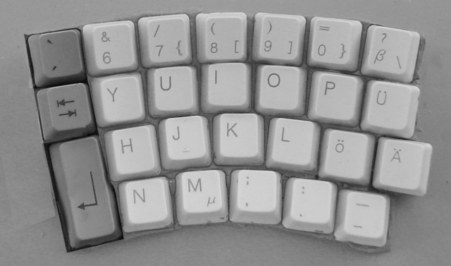

First iteration:
This design has been scrapped, but I have learned some things.
I had made this mockup by pushing ALPS key caps into modelling clay. I have posted this picture in the ergo thread.
I had intended to use a flat PCB -- identical for both the left and the right hand, to save costs.
The offsets between columns on the PCB was based on a 1/sqrt(2) of the offsets in the Burboa layout and then evened out
I intended to sculpt and cast key caps of different heights myself. (placed on top of low flat Tipro key caps).

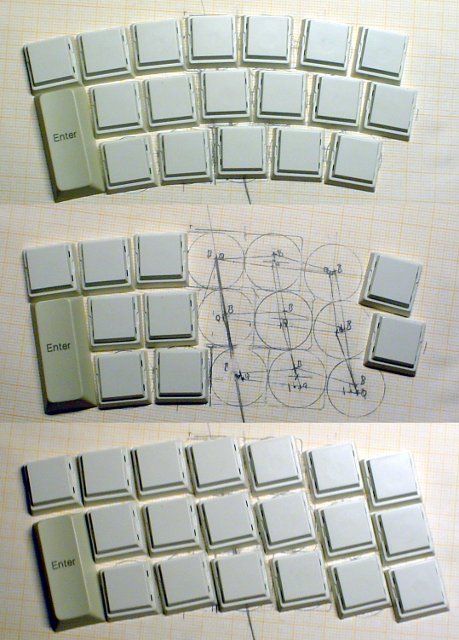

Second iteration:

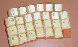

My muscle memory is much too used to the QWERTY keyboard to use the Burboa layout completely. I think it feels weird, especially if you press on the other index column.
I have noticed that if you compare the QWERTY and Burboa layouts, you can see that the columns for the middle finger and little finger have practically the same offset from one-another in both layouts The biggest difference is that the (square) key caps are rotated differently. I have therefore opted to use a middle-ground between QWERTY and Burboa for the X/Y layout. I am also varying the height.
I would have preferred the keys to be staggered for familiarity with older keyboards, but (of course) staggered in a uniform and symmetrically between the hands.
I made this model (again) from pressing key caps into clay, and then I edited the image:
However, sculpting and making my own key caps is not easy. Not only would they be slanted inwards, they would also have to be smaller, or wider apart than normal so as to not rub against one-another.
I think that I could use stock Cherry-compatible key caps if I just rotated the keys a bit so that they are all in the same angle ...

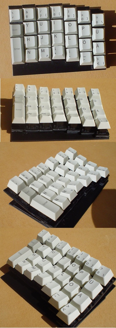

Next: Prototype made from MY switches
21 Aug 2011, 18:56
Again, I made this key well prototype using Cherry MY switches. The heights and angles, I got by cutting up and measuring the clay model. The MY switches are just glued onto pieces of plastic -- there is no electronics. I wanted to test the feel. It would have been even better to test with clicky or highly tactile switches, but it is just one step on the way.
I am not entirely satisfied with it... A few minor tweaks are needed, but I think that I am headed in the right direction.
This is not a matrix layout. It is staggered!
I have a silly idea that I am going to check next... Would it be feasible it to mount the switches on multiple layers of PCB instead?
sordna
29 Aug 2011, 00:53
It's not staggered, there's no zig zag, just a healthy curve/wave to help the shorter pinky finger.
I like what you did a lot! It's sort of a flatter Kinesis keywell with a wave added, seems like an improvement to me, I'd love to try something like that in practice. Looks very promising!

29 Aug 2011, 14:17
I am absolutely making a keyboard for myself. I'm not trying to make a "perfect" layout -- because I don't think that a perfect layout is even possible. I am trying to improve on QWERTY, but without straying too much away from what is familiar.
I have tested only with my own hands, and I do think that my hands are quite average male hands. Once I have got a clicky prototype, I would like to get as many people as possible to test it.
The layout of the keys in the plane were plotted as mathematically right in-between flat "Sholes" (row-staggering) and "Burboa" (column staggering) layouts.
The keys on the home row to the right of the middle finger are inclined by 5 degrees, because Maltron mentions in their documentation that they adjust for pronation by 15 degrees and I found 7.5 degrees to be a little bit too much with the curved rows. The bottom row has only a very gentle height-curve and heights of the keys on the rows above the home row are adjusted accordingly in the other direction.
