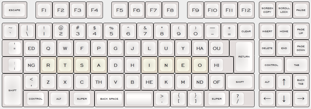

Ortholinear (mostly) with digraphs!
This layout has a number of intentional properties:
1) Most of the top digraphs can be typed with the eight home keys, but they have been re-arranged from the Colemak standard so that when they are on the same side, such as "IN" and "AS" they are accomplished with an outward finger roll.
-but-
2) Of course, all those keys would normally have the same profile, so they can be swapped around to accommodate all of you inward rolling muggles.
3) Dedicated keys for the top 9 digraphs that don't fall on the eight home keys. I attempted to place them where they would most likely be used following or before an opposite hand keystroke. In all, the top 28 digraphs can be typed with either the eight home keys or a dedicated key.
4) "THE" can be typed in two keystrokes two different ways.
5) Lots of things for the thumbs to do.
6) Large Escape key.
7) Amongst all of this, found room for Back Tab and Clear.
I'm really considering ordering a plate for this. Thoughts?

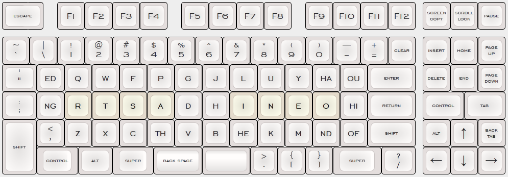

Revision update:
04 Jul 2015, 12:36

Very cool, I jump between different writing systems a lot and digraphs would be super helpful.
@Muirium, is the conlang for your space opera? I've read most of your site and it looks interesting. Also where did you get the Access-IS boards?
@jpatters, I really like the revision, as much as I like hat keys, they seem to be better used as solid ones. (this board would look glorious in SA even if it was just all R3) do you have a specific language (or conlang) this board is meant to be used with? (besides english thats is)

If you’re going to add digraphs, you’ll have to do some serious analysis to figure out how to correctly place them (my snap judgment of your proposed layout is pretty lukewarm, but it would take trying it to really judge), and there will be a noticeably steeper learning curve than a standard new logical layout.
Why not just go all the way and switch to a chorded stenography keyboard?
Or if the goal is improving efficiency while mostly preserving the way the keyboard works, I’d recommend moving both shift keys, return, escape, etc. to easier to hit spots, moving the arrows and F keys onto layers near the home row, and so forth.
On the other hand, experimenting is always fun. Let us know if you actually build this thing, or some kind of prototype.
