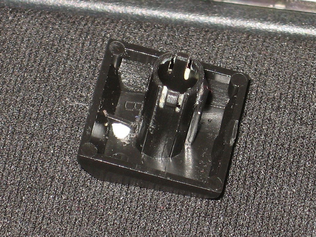

Second, insert your plastic toothpick into the hole. Assuming you used a drill bit and not a knife or something, you should have a nice cylindrical hole, which means the toothpick will wedge at the same point whether inserted from above or below. Take advantage of this fact, and insert it from above, then mark where it stops. You want to cut it a little bit longer than that, and have the extra diameter act like a screw or nail head. Then re-insert it from below. You'll have a pointy spike sticking out of the key. Carefully melt this, forming something like the plastic rivets that hold a Model M together. Once it cools, it will be too large to be pushed out from either the top or the bottom. Then file or shave it down to the size you want.

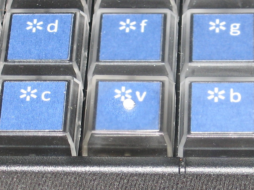

This particular lens was pretty heavily frosted to start with, which is why I chose it for this experiment. The direct application of flame caused the area of greater transparency. If I had to do it again, I'd do two things: first, I'd choose a slightly less sucky lens. Second, I'd put tape over the regions I didn't want affected. However, this effect is much more evident in a photograph than it is in person, and I am perfectly satisfied using this key lens. I can imagine it being a problem with ABS though, so you probably want to mask off the excess as well.

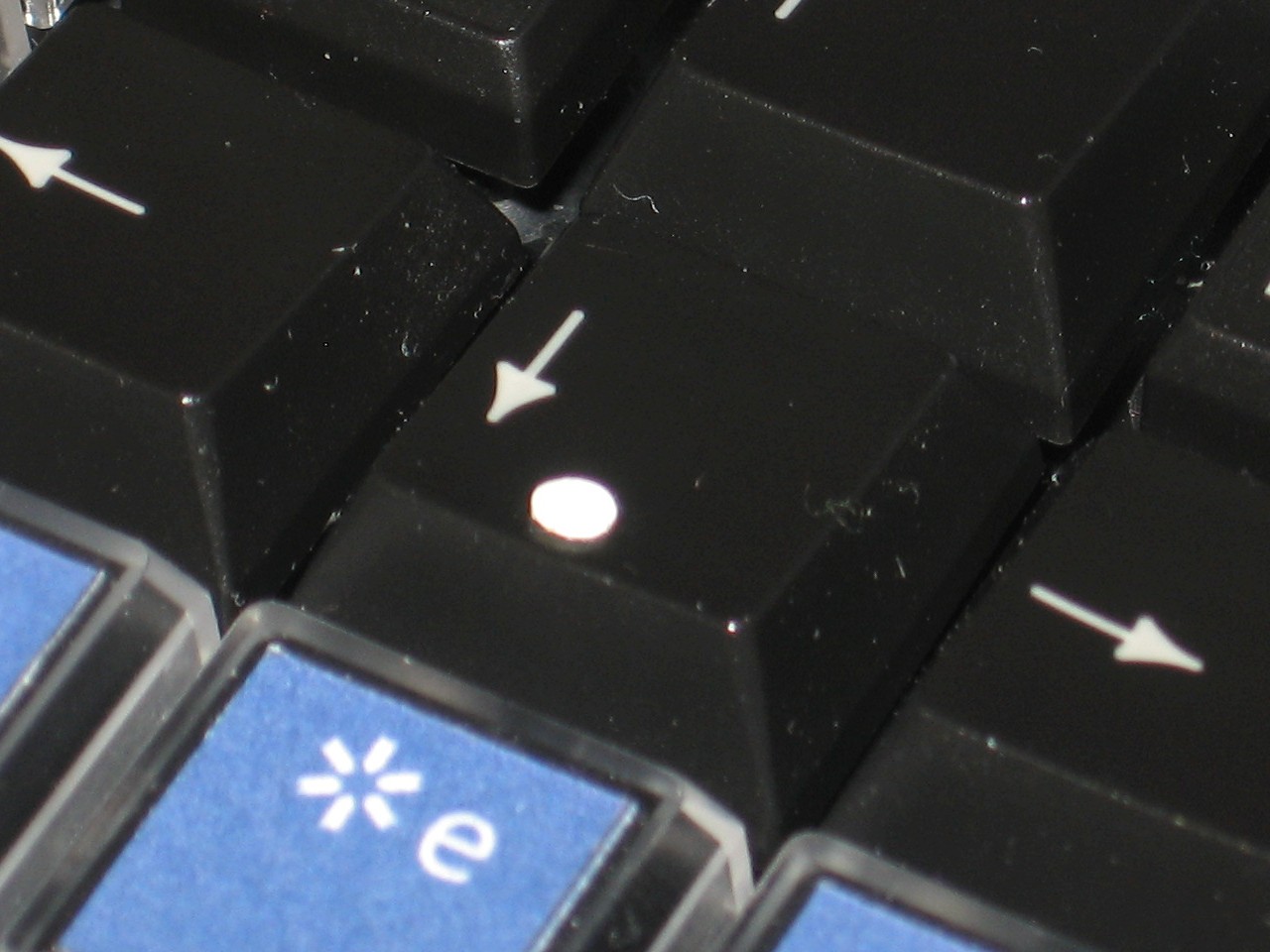

Here's what it looks like done on a normal key, for which I have no spares. It's slightly off-center because of the support beam underneath, but not enough to matter.
