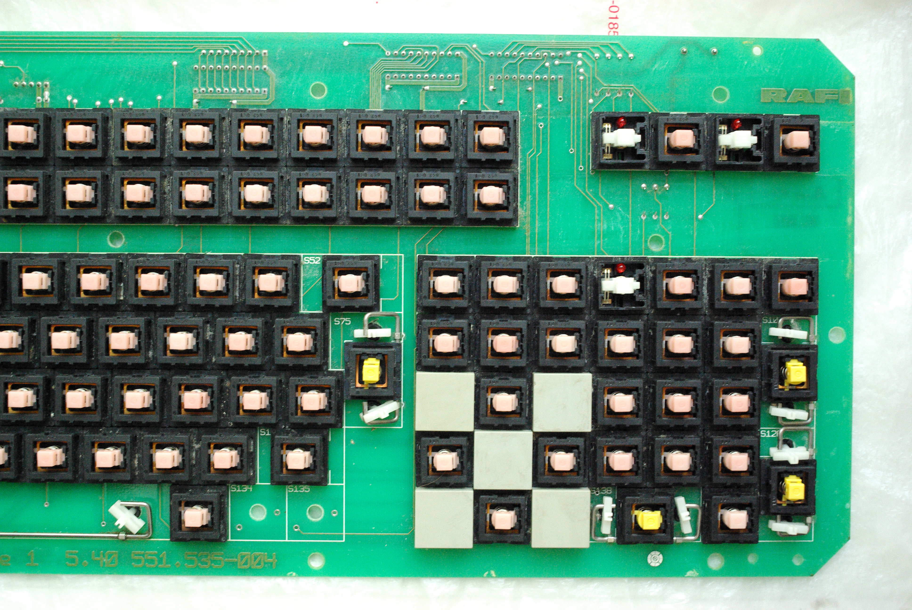

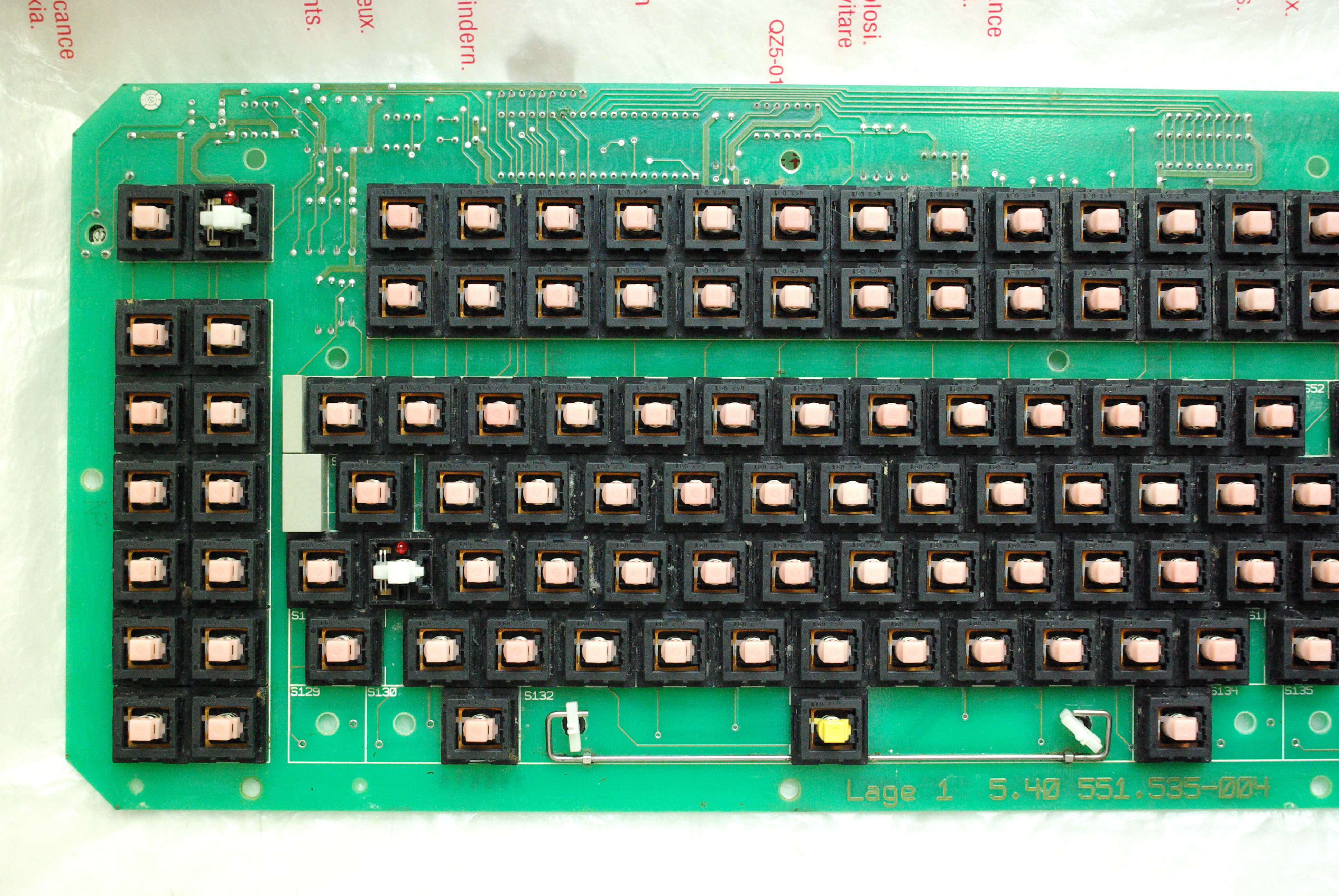

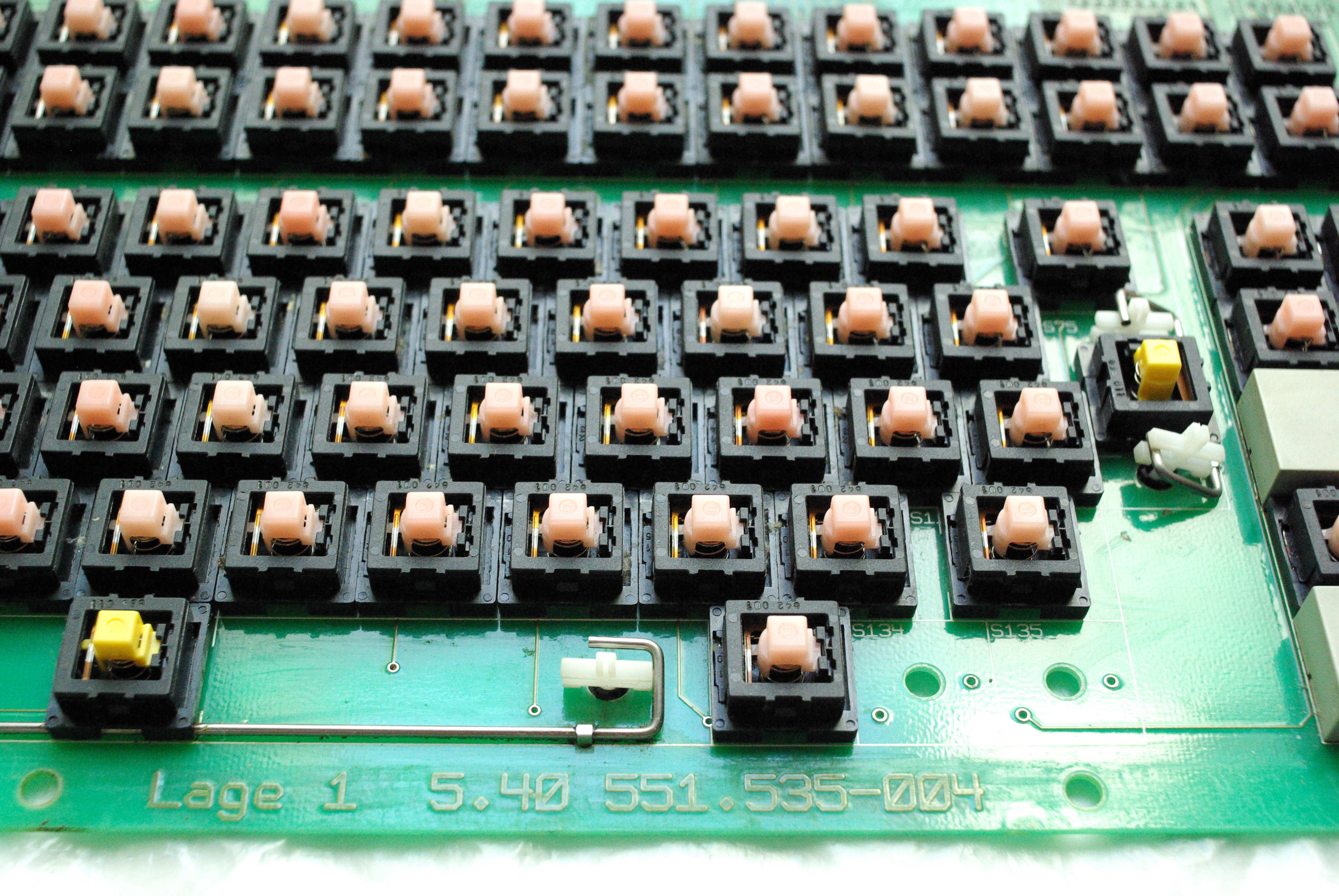

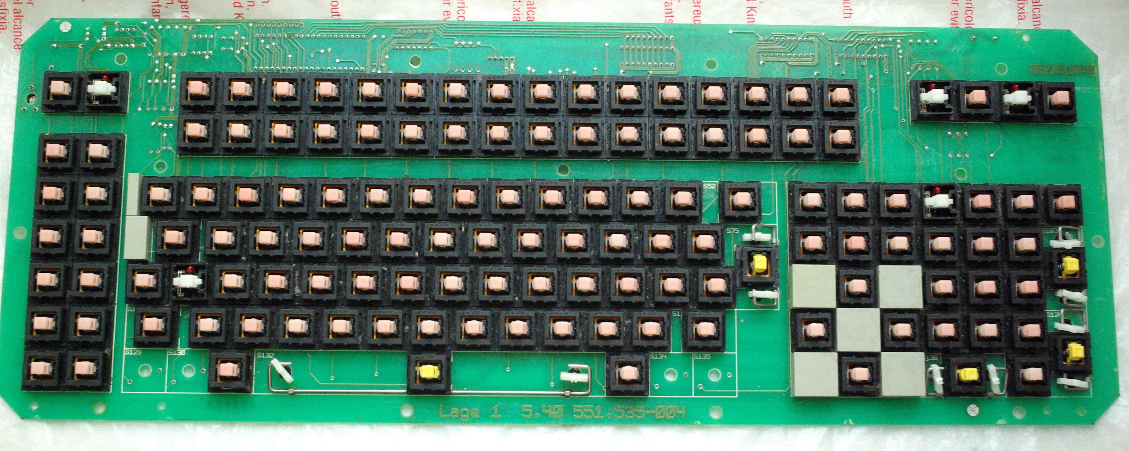

We are looking at RAFI RS 76 M switches.
Pink / salmon sliders. Linear long travel. Smooth as hell. PCB mount.
White and yellow sliders are also present.

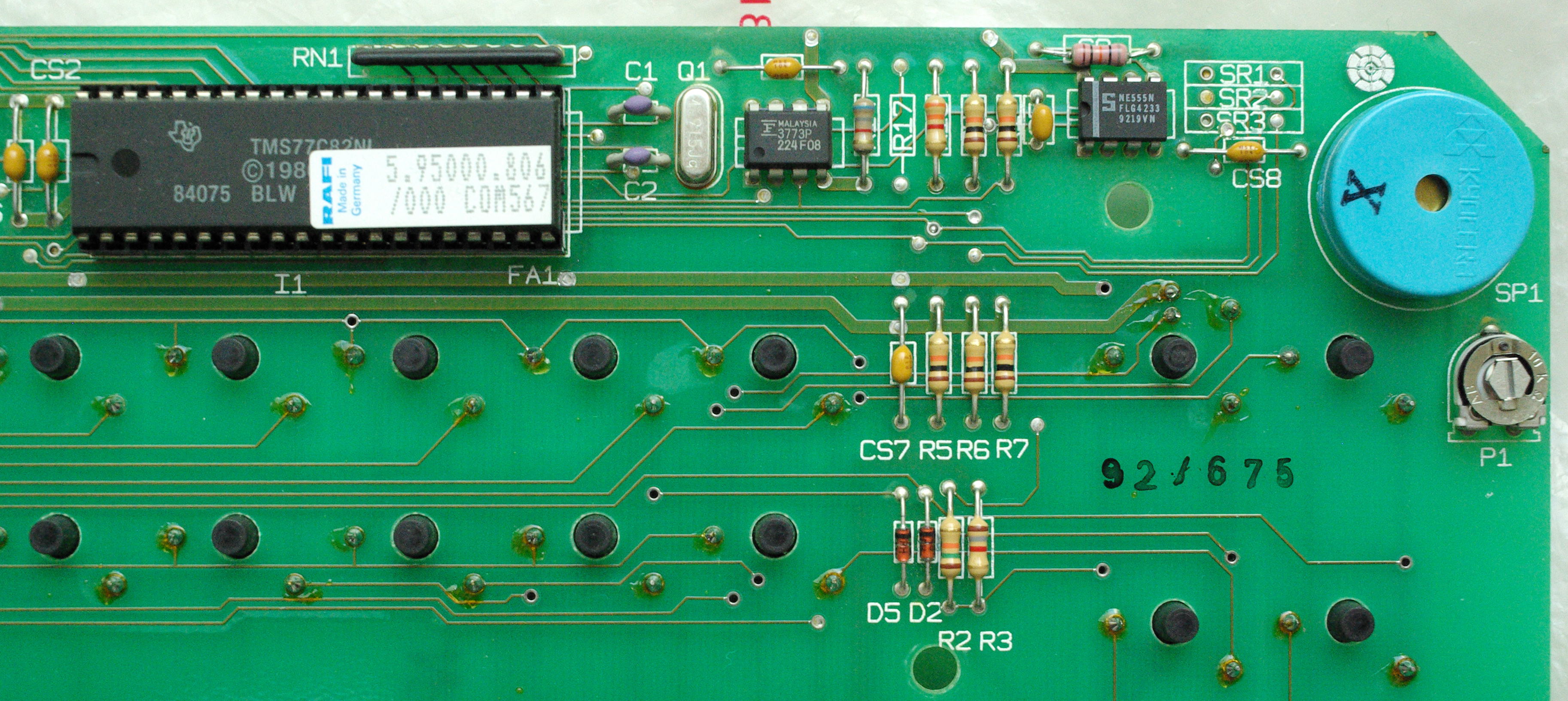

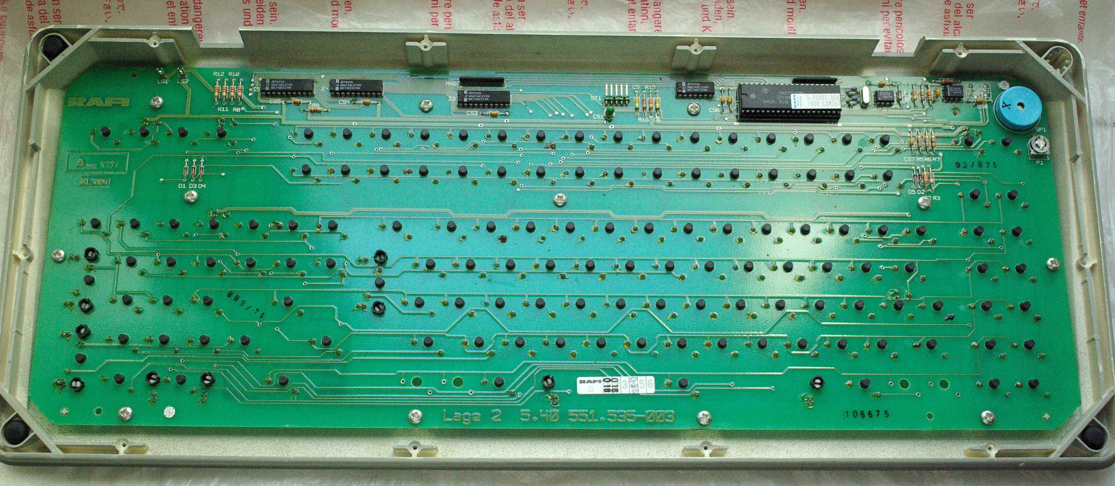

I fail to find a production date on the PCB or anywhere else.
Kyocera...

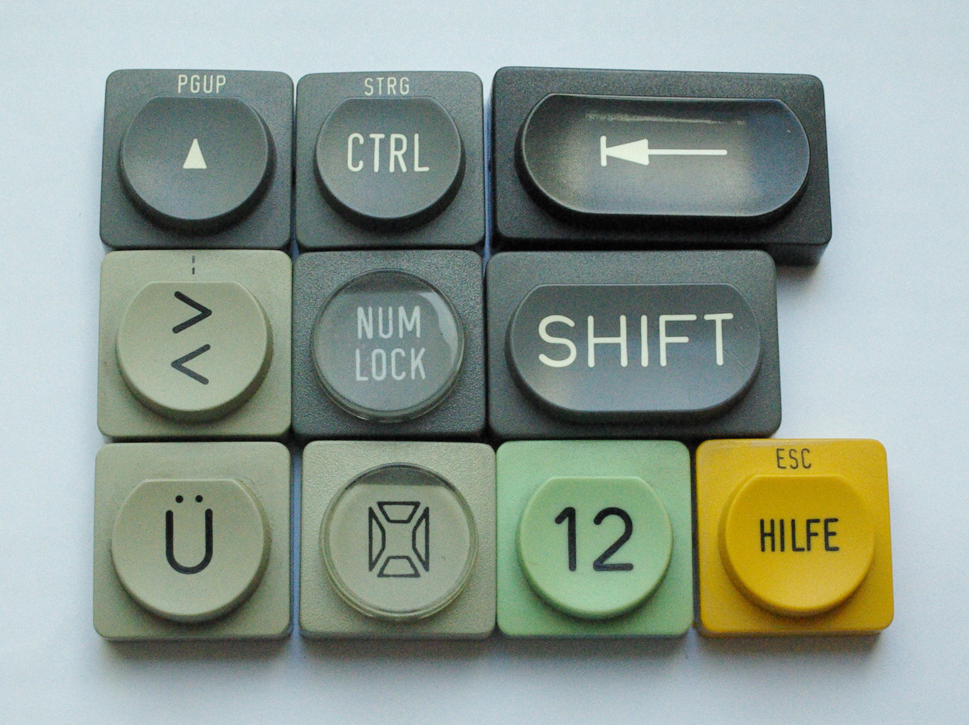

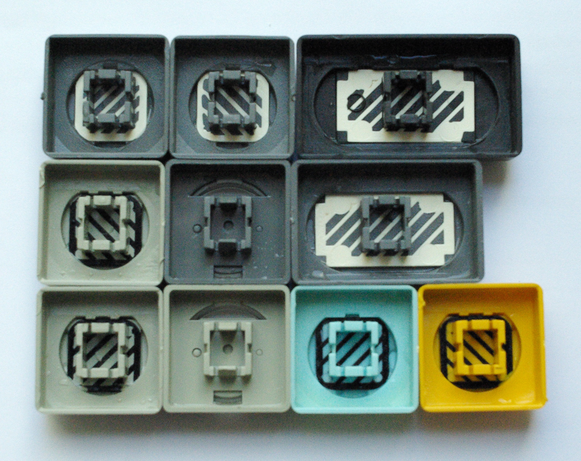

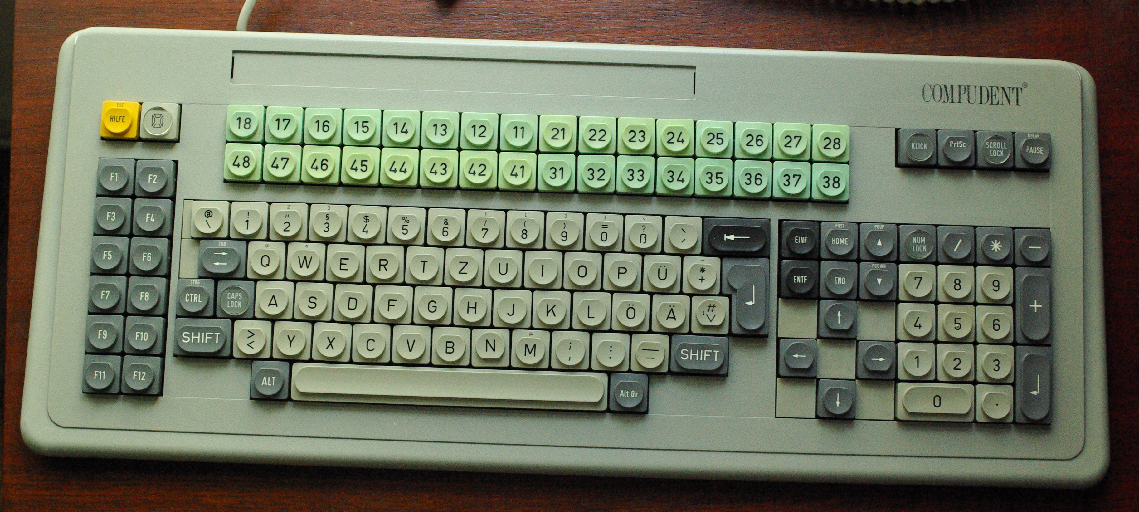

The function row caps were originally blue. Now greenish. The LED caps have a plastic top.
Low profile dental doubleshots. :lol:

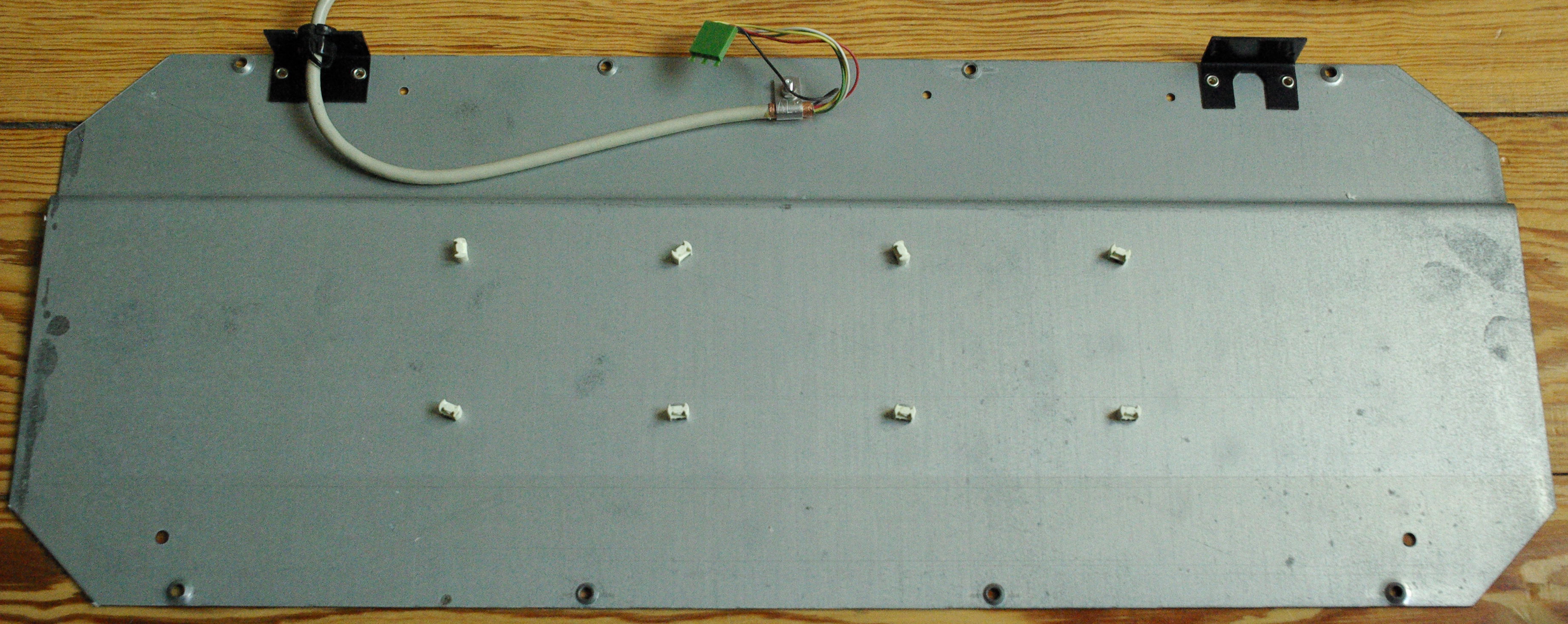

Metal backplate

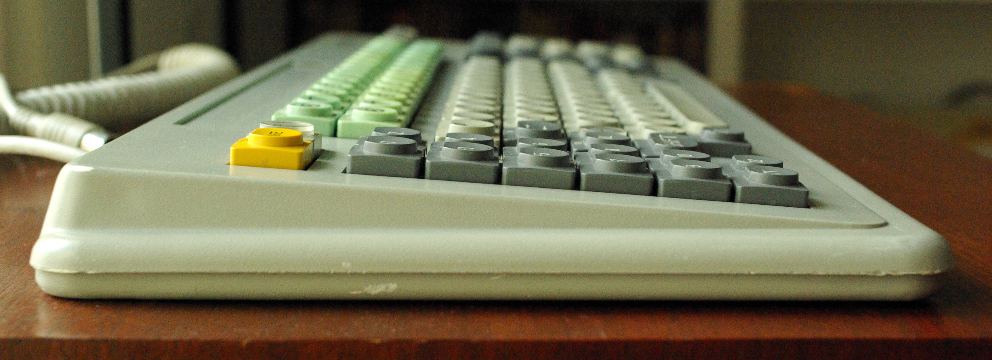

The whole keyobard is quite low profile. No feet.

seebart wrote: […] Notice this very special Mu keycap. The µ on the step. That`s dental style. :mrgreen: […]
The N cap is even more special :lol:
Anyway, that's a really impressive board. Muirium will want it :mrgreen:
04 Jun 2015, 17:54
Ah yes it's upside down in a special way! :D Of course I did that on purpose as a test!

These are mechanical switches (RS 76 M) - the metal leaves are clearly visible. IIRC, pink salmon sliders denote mechanical switches equipped with diodes. (Earlier versions of them had red, not rosy sliders.) The yellow ones also have diodes, but their springs are about 50% stronger.
04 Jun 2015, 20:15
Thank you for that info. Yes the yellow ones are "heavier".

I also reckon that's a 1992 production date inked on the PCB, along with 675: maybe a serial number or at least a model number you see several times.
