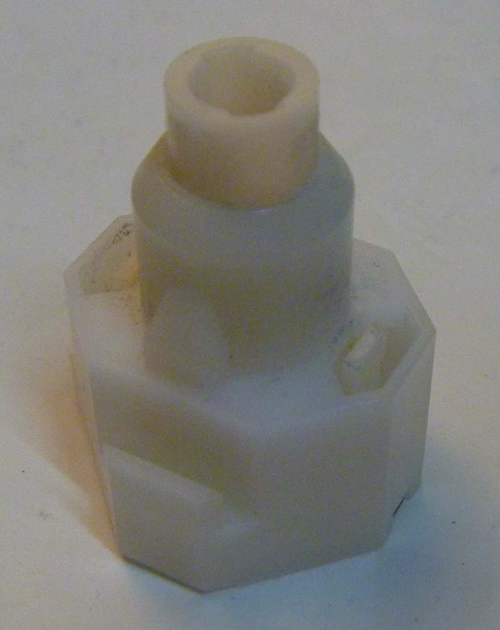

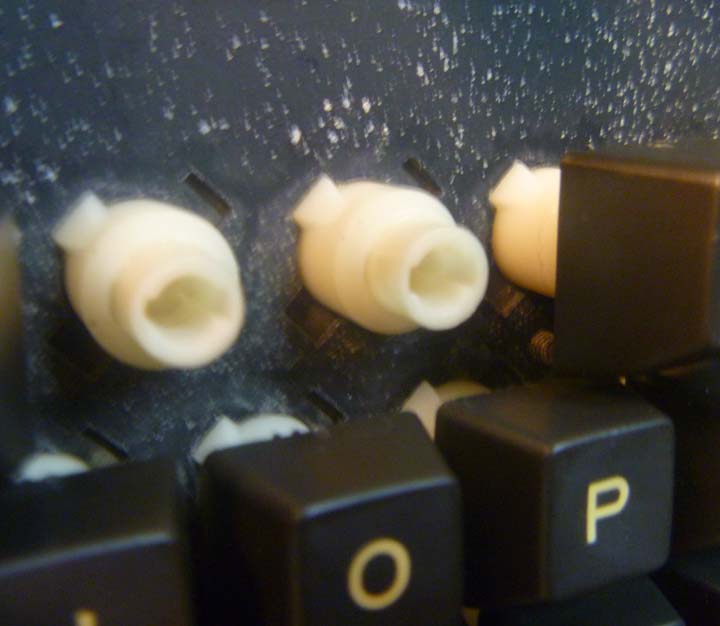

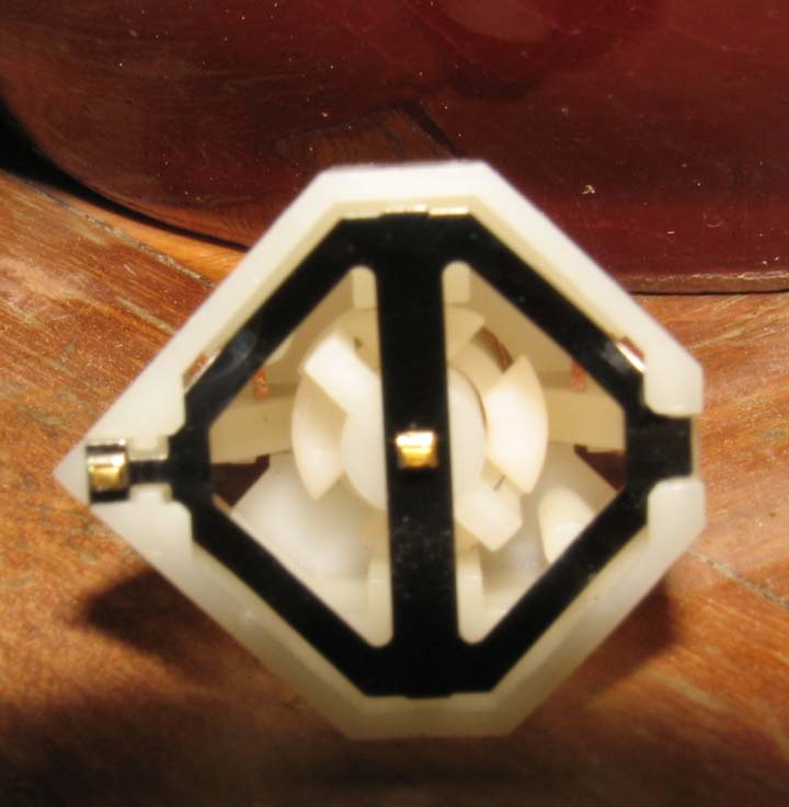

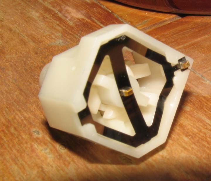

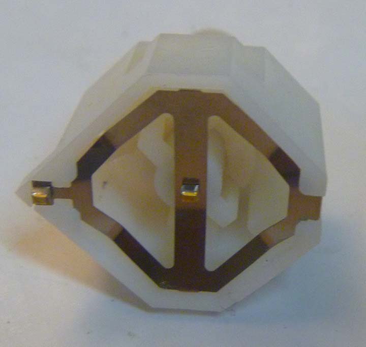

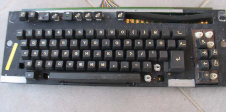

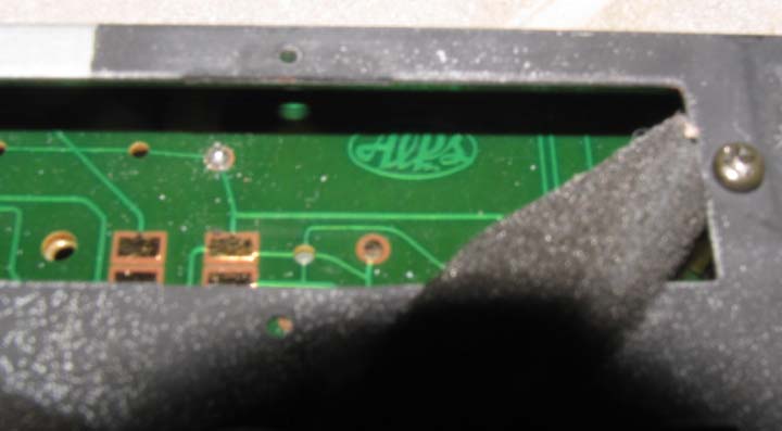

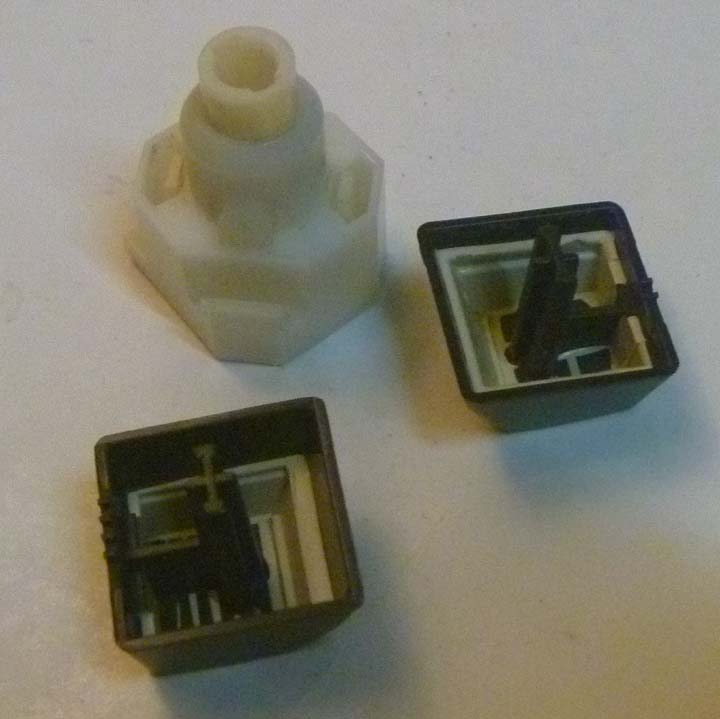

The keyboard circuit board is marked as ALPs with script logo.I really like the feel of the keys and have been searching online for reference but could not find another set.The keys are only held on by the metal bracket directly above the circuit board which appears to have gold plated terminals.Each key has 2 pins on the metal spring foil which short out the the terminals on the circuit board when depressed.The switch makes a click and then a clack.
- alps6.jpg (60.09 KiB) Viewed 4382 times
- alps5.jpg (63.66 KiB) Viewed 4382 times
- alps3.jpg (42.45 KiB) Viewed 4382 times
- alps9.jpg (38.7 KiB) Viewed 4382 times
- alps2.jpg (45.25 KiB) Viewed 4382 times

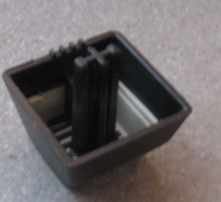

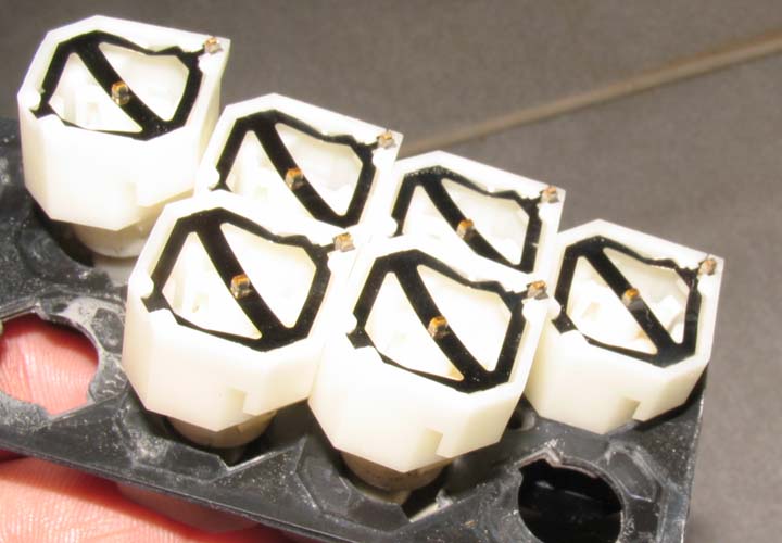

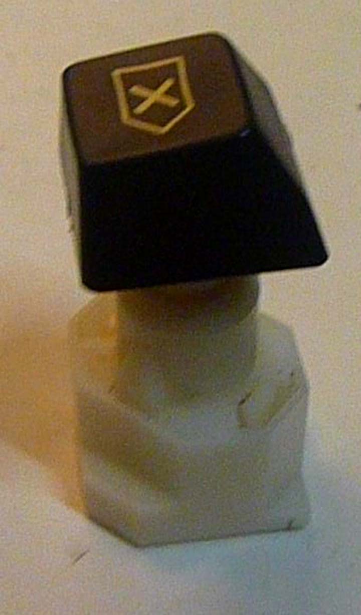

Here are photos of the keys
- 2alps4.jpg (40.64 KiB) Viewed 4368 times
- 2alps3.jpg (50.33 KiB) Viewed 4368 times
- 2alps2.jpg (52.73 KiB) Viewed 4368 times
- 2alps1.jpg (72.38 KiB) Viewed 4368 times

It is not a beamspring switch.It sounds and works more like a click clack toy Here is a link to a youtube video of the click clack toys I was referring to https://youtu.be/7hs2qioZUco

It's a sort of dome switch. And I've never seen this before

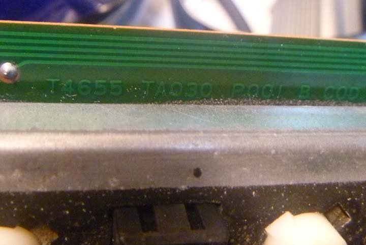

Are there any numbers on the pcb to identify it? Usually Alps has at least one or two.

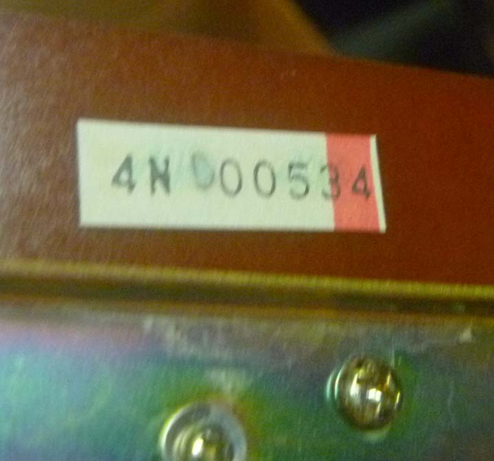

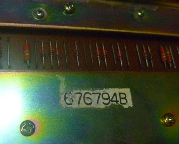

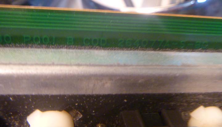

I have tried searching all the numbers but could not find any reference
TA655 TA030 P001 264077A-S-BO on board and 676794B 4N000535 stickers on metal pan
- 3alps5.jpg (52.44 KiB) Viewed 4336 times
- 3alps4.jpg (51.65 KiB) Viewed 4336 times
- 3alps3.jpg (39.75 KiB) Viewed 4336 times
- 3alps2.jpg (48.12 KiB) Viewed 4336 times
- 3alps1.jpg (53.19 KiB) Viewed 4336 times

Here is a link to a YouTube video of the switch.It is larger and quite different from the early Alps plate switch.It is a very simple switch that works unbelievably well.

That's a pretty neat switch. Likely has a nice sharp tactile point.
Alps probably stopped making them because of reliability issues with the contact mechanism (as it keeps striking the pcb contacts). And,

It strikes the pcb with quite a bit of force.There is no way to control the pressure as it builds up and snaps down .
