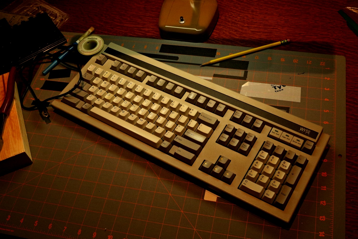

I recently acquired a Wyse keyboard from a vintage computing store. I really love the layout of this board, and I need to convert it to USB.

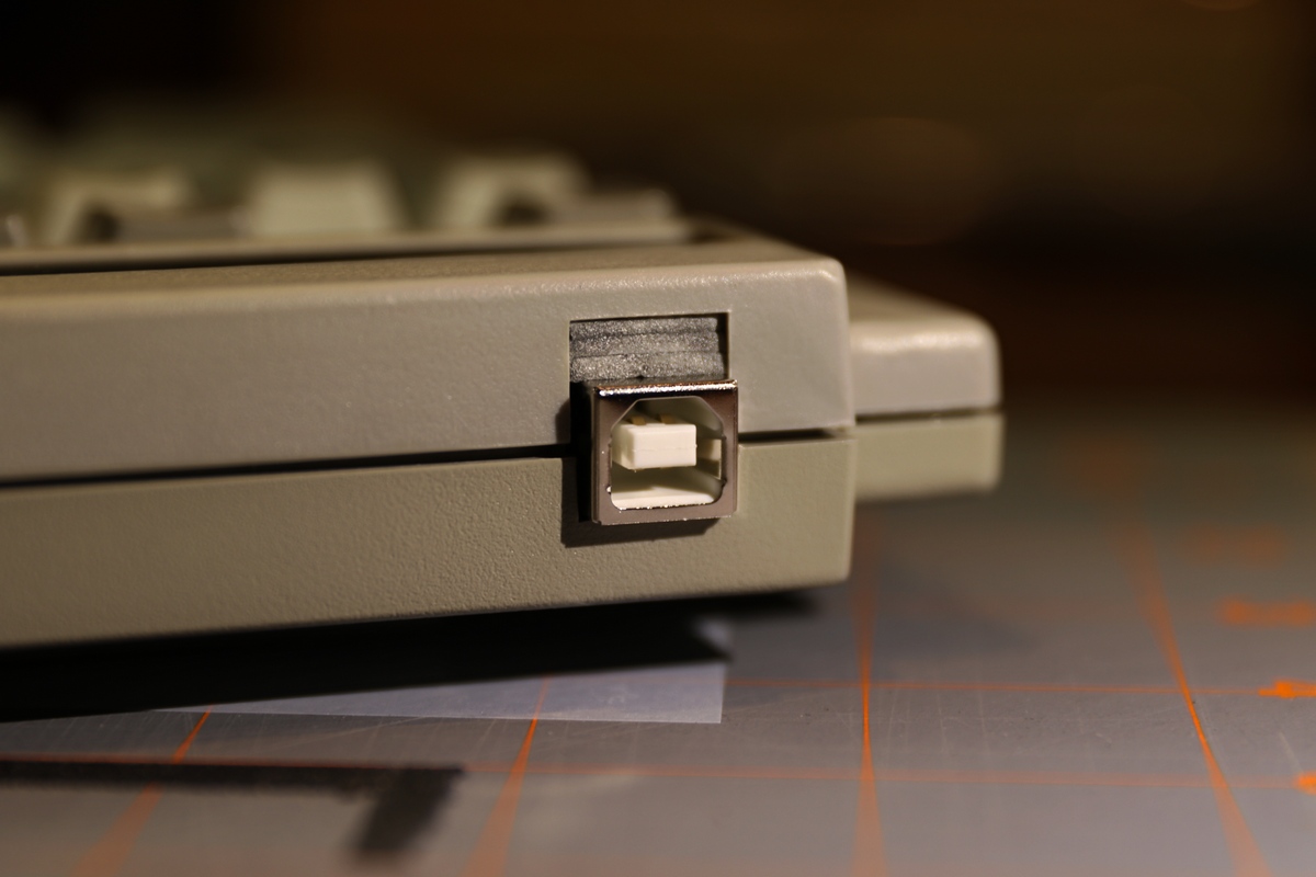

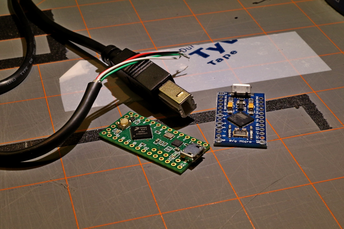

I have already converted a model M 122 key that I am selling and it was easy with a Teensy 2.0. But the Wyse conversion software is different from soarers I think and what I have now is a Teensy LC and a pro micro.(pictured) I have already replaced the 4p4c port with a USB connector.
I knew the board would not register presses but when I plugged it in to a computer like the way it is now the lock LED's come on. So I knew I didn't ruin the board when I soldered on the connector. I plan to use the cable pictured and make an outboard project box converter for it.
How can I do this with a Teensy LC or pro micro, I have already looked it up and got really really confused when it came to the pinouts and such.

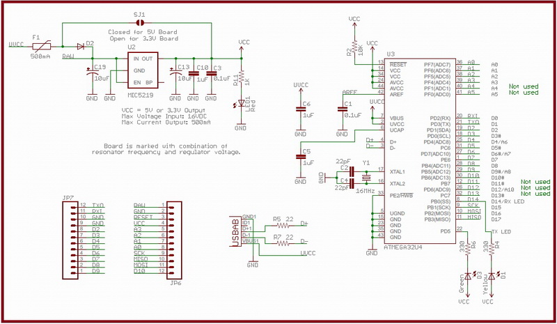

Redmaus wrote: How can I do this with a Teensy LC or pro micro, I have already looked it up and got really really confused when it came to the pinouts and such.
The Teensy LC has a 32-bit ARM Cortex M0 while the Teensy 2.0 and Arduino Pro Micro have 8-bit AVR ATmega32u4.
Hasu's adapter firmware is for the AVR and will not work with the ARM.
The pin-out for the Arduino board can indeed be a bit confusing. Arduino uses a different system for numbering pins than AVR does, for some inexplicable reason ... :roll:
Here is a schematic for the Arduino Pro Micro where you can see the pin assignments:

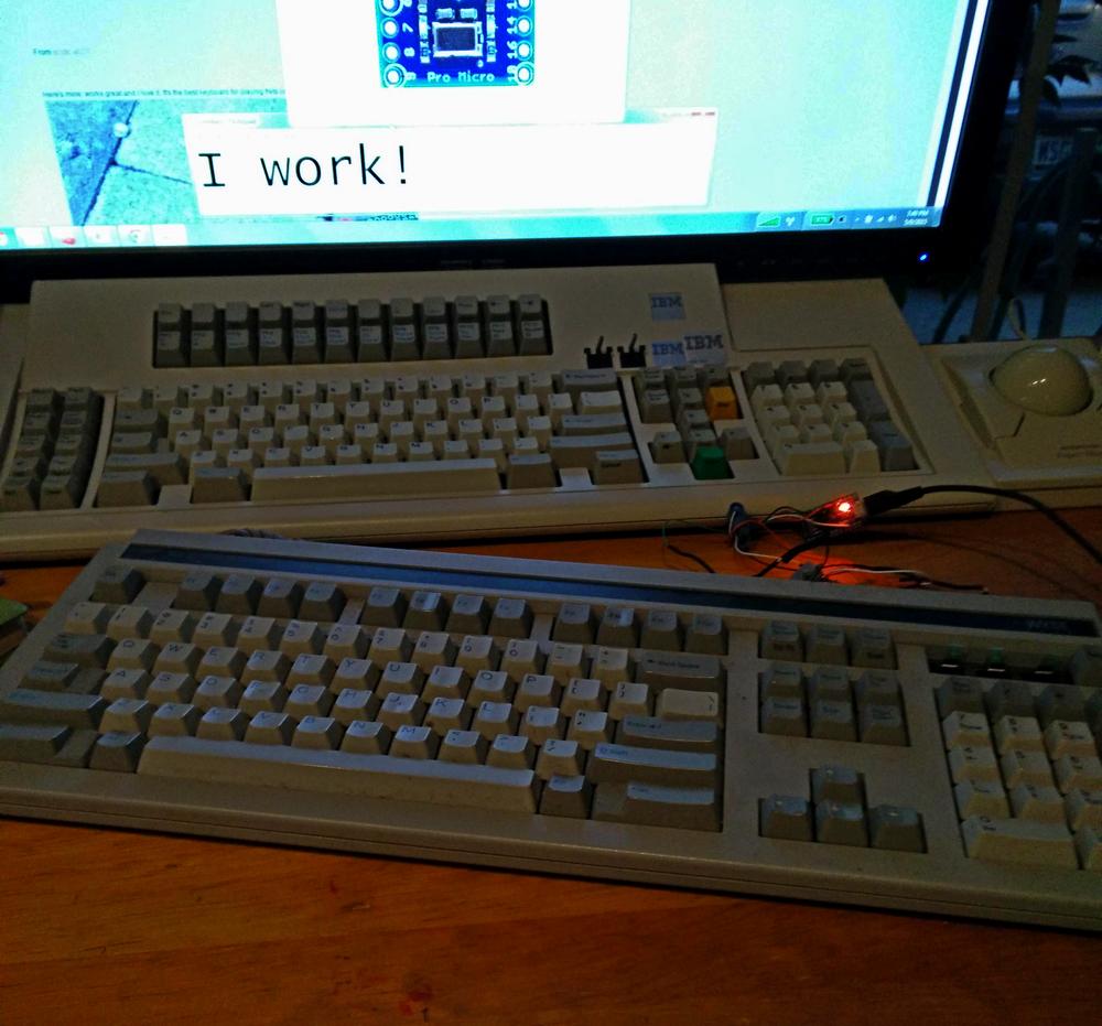

Successfully converted! :D
Thanks for all your help dorkvader!
