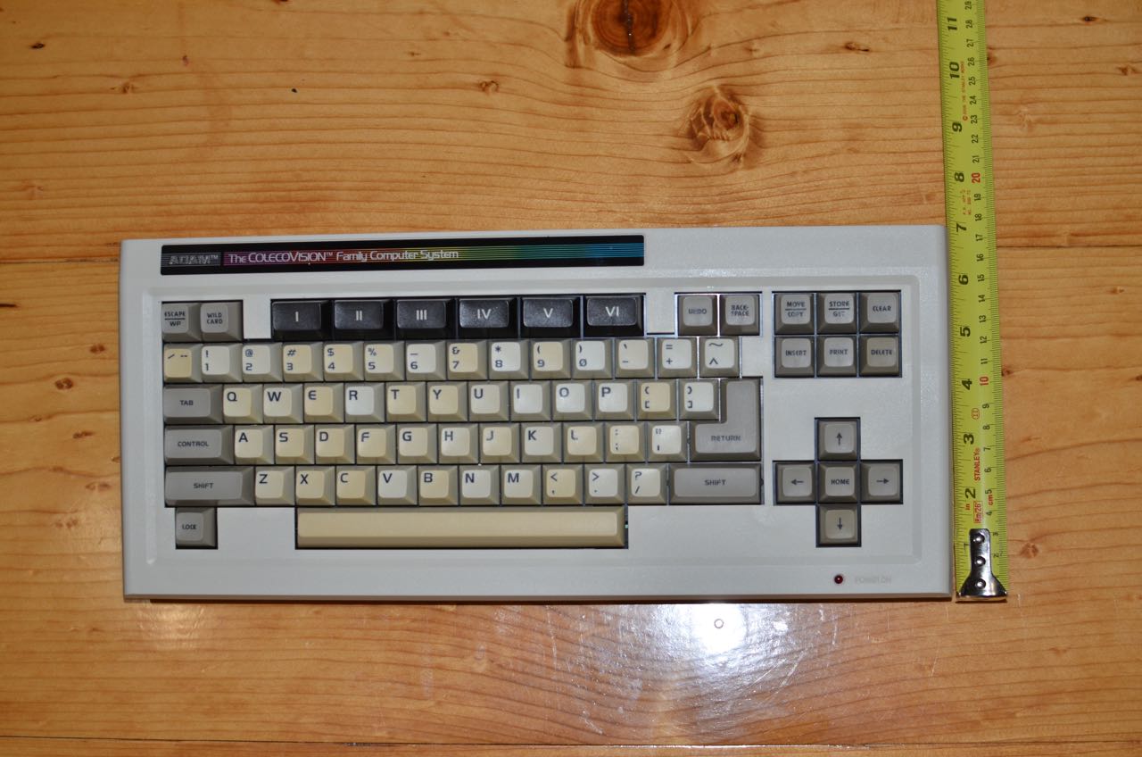

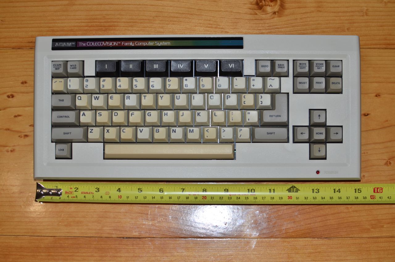

At last the box is open:
The keyboard looks to be in good condition. The seller said it was tested working. I may Retr0bright some of the keys - carefully!

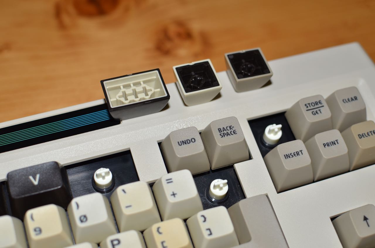

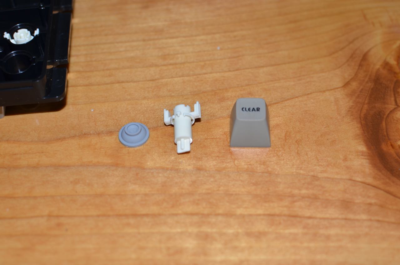

Double shot spherical key caps, and an unrecognized slider. What is this?

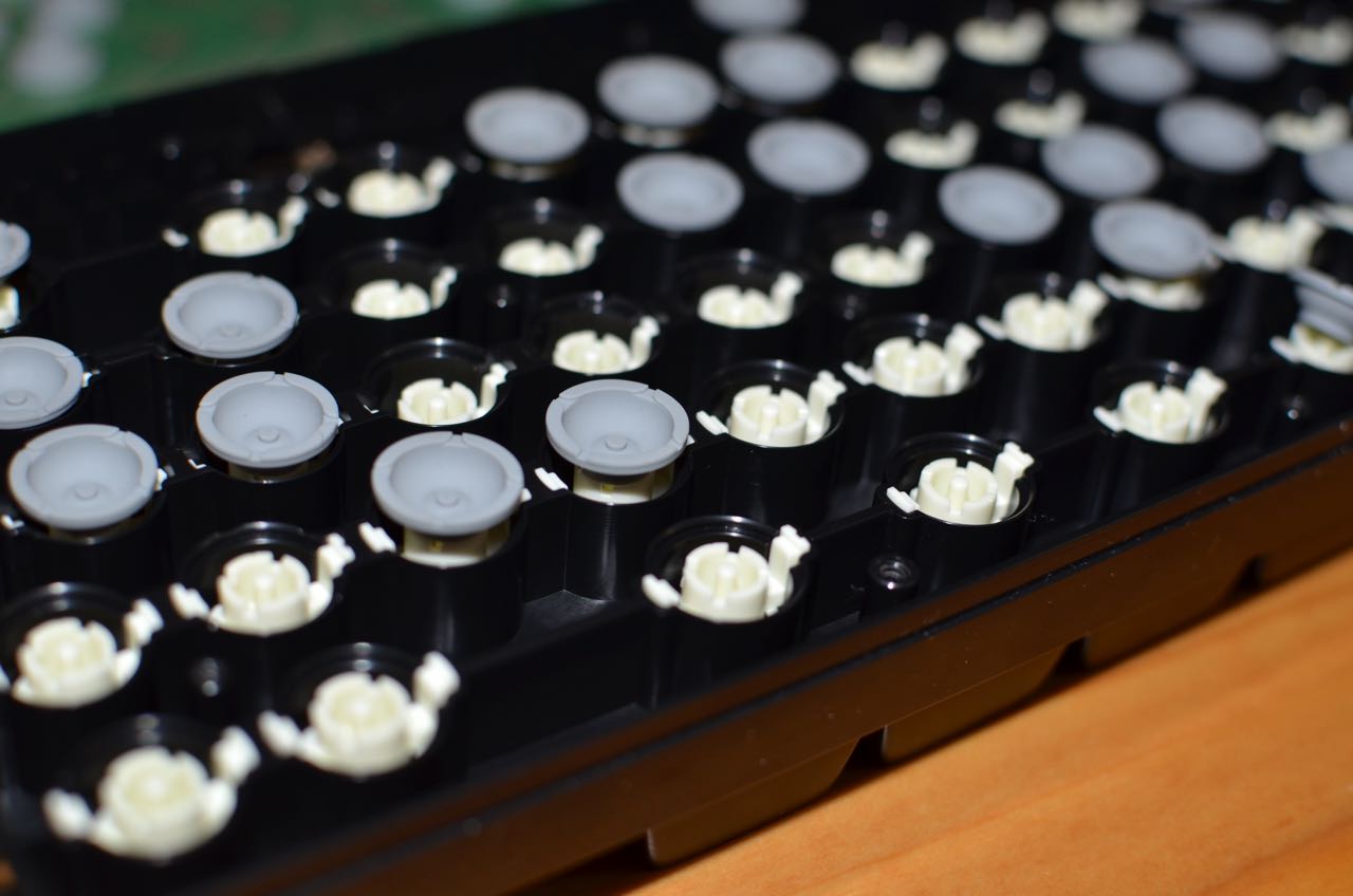

Well, I had to know. 30 screws and an hour later...

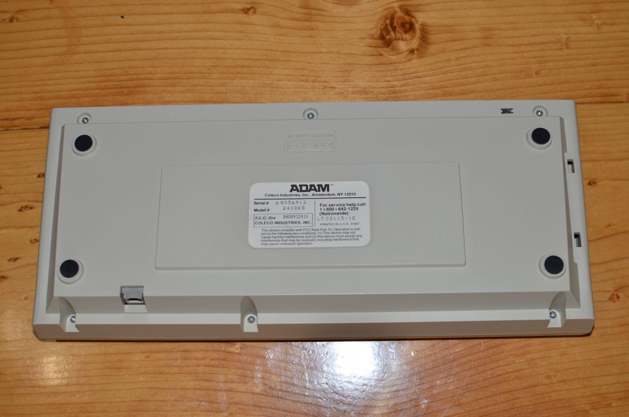

The keyboard does say "Made in Japan" and is from 1983. I wonder if these are Brother or Topre domes?

How far away are those keycaps from being Cherry MX compatible?
10 Mar 2015, 10:44

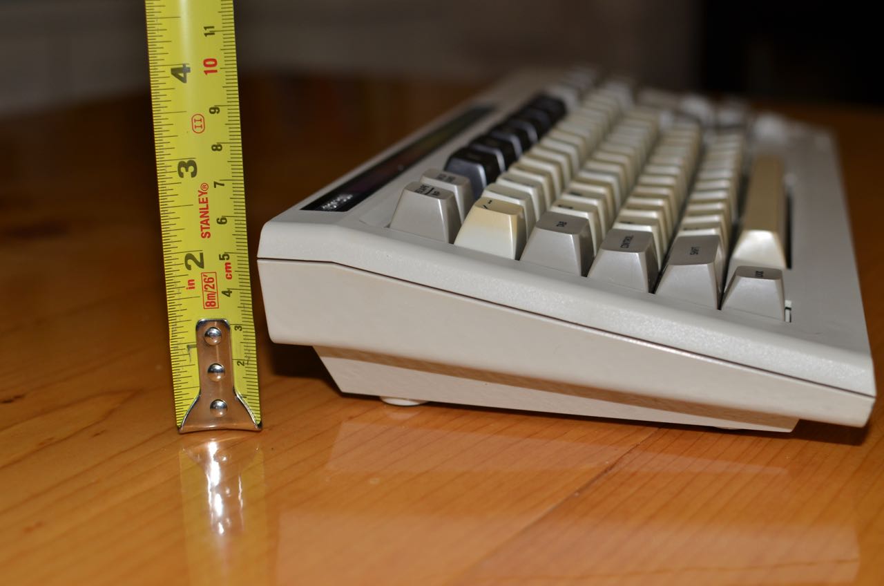

Cruciform looks bigger and is more into the keycap, where there are also strut that would be in the way. Maybe they would work with the adapters used for the MeC64 keyboard.

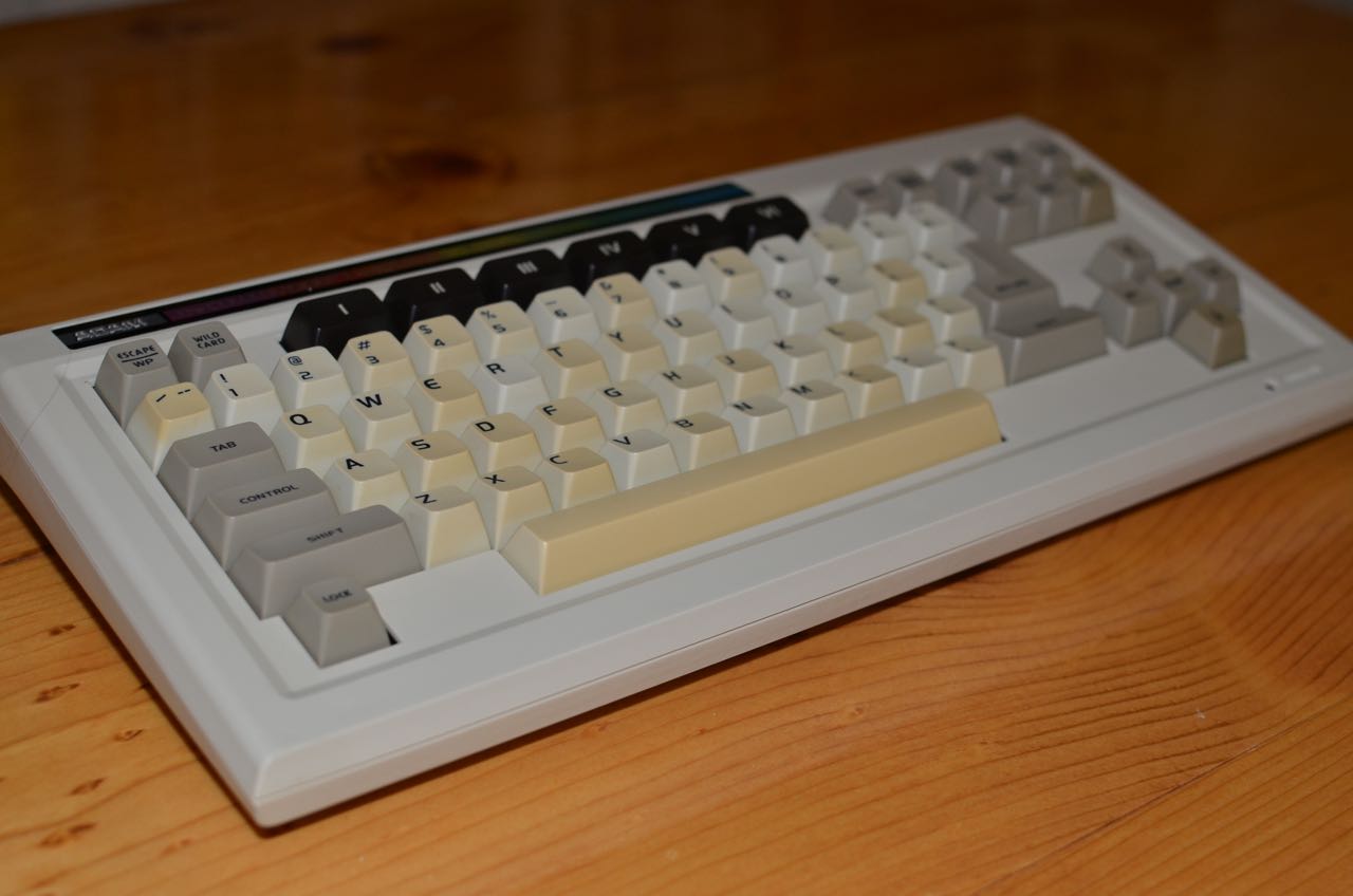

I still think the keyboard looks a bit unnecessarily high, though. How does it look next to a Commodore C64C ?

jacobolus wrote: How far away are those keycaps from being Cherry MX compatible?
Quite. The Coleco key caps have a cruciform recess that is too large for Cherry MX switches, and buried too deeply into the key cap itself to press the switch mechanism at all without bottoming out. The Coleco sliders are too large to accept Cherry MX keys. I tried!

Much better than I thought it would. These are a high quality rubber dome. They are not quite as nice as Topre rubber domes but they are nicer than Model M Quiet Touch rubber domes. They are Made in Japan after all. The sliders seriously need some lubrication though, the same as a Cherry slider. I've heard some variant of Krytox works well - any suggestions?

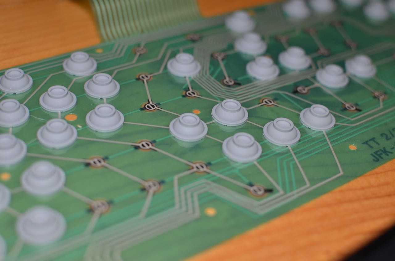

But of course, this is always my goal. The keyboard uses a weird signaling protocol that is documented elsewhere online. The Google album photos show that this is just a single membrane. Very interesting construction: it is one membrane, folded in half. This one seems like an ideal candidate for a controller replacement.

I did some looking into this (including buying one of the bare, Archer-branded ADAM keyboard mechanisms that show up on eBay from time to time), and it looks like whoever made the ADAM keyboard also made the TRS-80 Color Computer I keyboard c. 1980. It has the same domes, but uses a dome-over-leaf-spring construction I've never seen before, and seems to be design number FK-5302. (The CoCo keyboards really deserve their own threads, but I don't have one handy and the computers themselves are increasingly rare these days, so imagine what finding just the keyboard is like). Also, the slider on the ADAM keyboard looks like it might fit Futaba MD keycaps, though on the ADAM, the mount is turned 90 degrees. Unfortunately, I don't have any other MD-compatible caps to check with.
Anyway, what I'm getting at is that I'm pretty sure these keyboards weren't made by Brother or Topre or even Mitsumi like a lot of cheap home-computer keyboards were; I'm thinking they're Futaba-Sejin designs (which would explain the "FK" and "JFK" nomenclature).

Anyone looking to implement a converter instead of a controller should be aware that the keyboard just sends ASCII: all the shift processing is inside the 6801. There are no shift states or up transitions.
