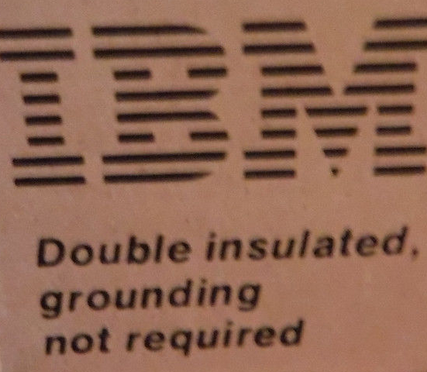

Posted: 13 Jun 2014, 00:15
by Hypersphere
Muirium wrote:This is where the foolish habit of calling earth "ground" instead leads to confusion! They are separate things: like neutral and earth on a mains plug. Or ground and ground as I guess you could say!
Ground goes to Teensy. Earth goes to the plate. Some IBM keyboards even have an earthed space bar (I don't know why, as the space bar is still plastic, but maybe it helps prevent static shocks somehow) which is wired to the plate. My 122 key Model M is like that, so I earthed its plate with the appropriate shield on the cable, and my Soarer box uses its conductive metal shell to do the same and hook earth all the way back to the host computer.
I thought you might enjoy this inscription on a metal badge affixed to an IBM Selectric typewriter:
The Selectric will be a keycap donor for my IBM Displaywriter. The Selectric has beautiful spherical double-shots -- white legends on a black background that looks almost like a dark olive green.
If this typewriter were in the UK, I suppose the badge should say, "earthing not required" (?)
Posted: 13 Jun 2014, 02:21
by Muirium
Everything mains powered, at least computer wise and I expect electric typewriters too, is double earthed by convention over here. So I heard in "tech" class back at school. No, not high tech, it was what you guys call "shop", I think. We were usually playing with saws and sanders!
