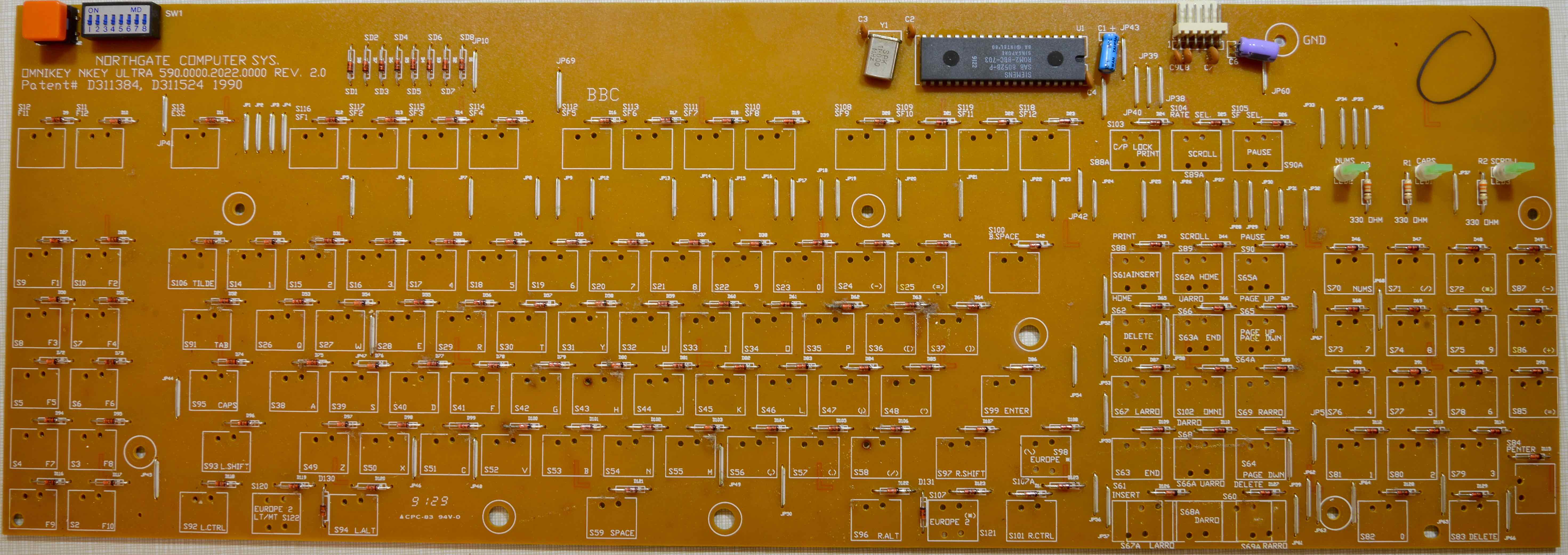

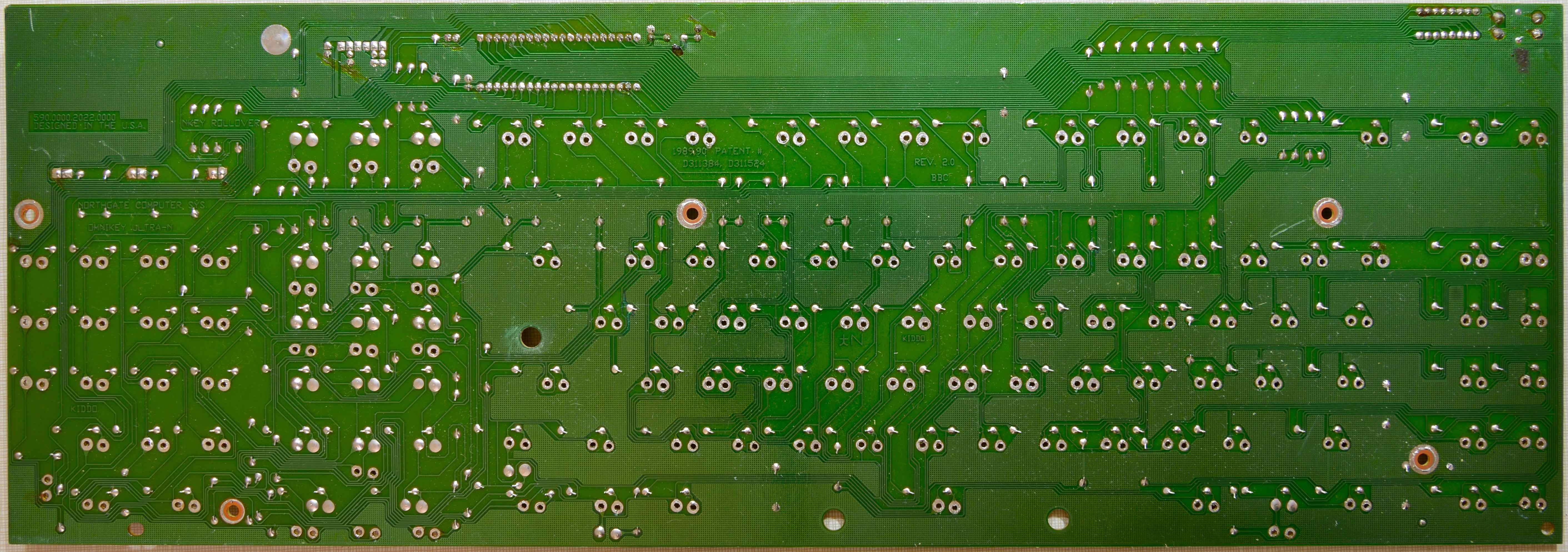

05 Dec 2016, 03:36
I'll just leave these hard earned photos of the Omnikey Ultra's PCB here if that's alright with everyone. :ugeek:
Northgate Omnikey Ultra PCB - front.
Northgate Omnikey Ultra PCB - rear.
This board looks like a hacker's dream. One sided - easy to read the traces. Very few jumpers - a sane layout. Multiple switch options. A diode for every switch - even the unused ones. Small switch pads that are not connected to the ground plane - easy to solder. A single MCU that looks like it is super simple to replace with a new controller.
It is everything I hoped and more. If I were to design a PCB, it would be exactly like this.
If someone wants a high quality JPG or RAW (Nikon NEF) file here shoot me a PM.
Darkshado
05 Dec 2016, 07:08
There's a signature (?) on the PCB: one instance of "KIDDO" on the numpad, what I assume to be an Asian glyph, a large "N" and another "KIDDO" near keys K,L; also the words "N-KEY ROLLOVER" above the numpad.
alh84001
v.001
05 Dec 2016, 10:20
Yeah, the Omnikey PCBs are gorgeous. On ultra's even the Caps Lock switch position could easily be moved. On 101, as it is near the edge of the board, I think some traces are in the way.
And I love the "Europe" switch positions :lol: I wonder what that big "BBC" letters stand for.
