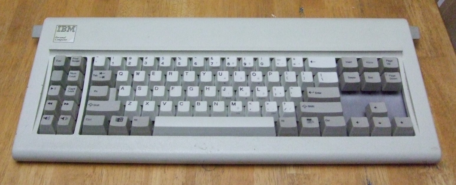

I'm not sold on the 1.25 wide cursor keys.

I wasn't sold on the arrowkeys either, but I just thought about it by putting my fingers out a little on a normal one, and it wasn't bad at all. The only trouble would be getting enough keys for it. I think we sholud ask unicomp about bulk pricing on the "XTant" set.

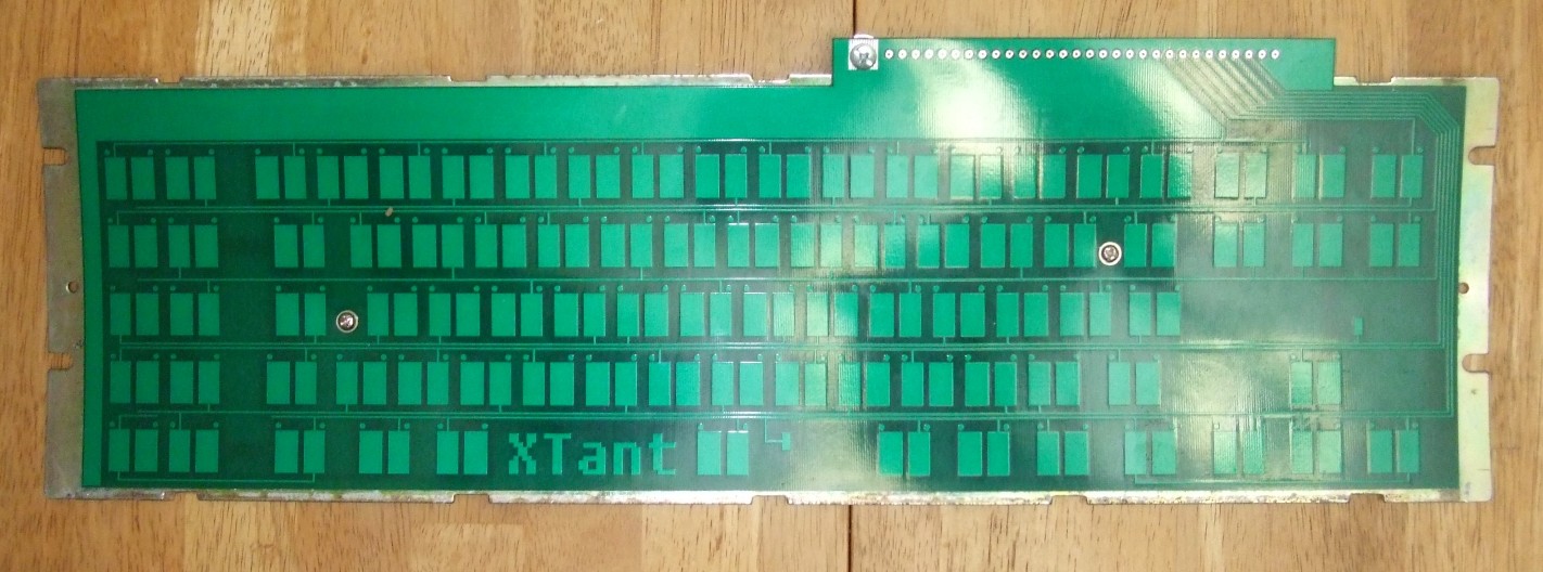

I now have a custom capacitive matrix PCB, barrel frame, foam pad, and a xwhatsit controller is in the mail. I had to remove the PCB retention rivets from the back plate; they would have been under new keys. These are replaced with two bolts - one to the left of A, and one to the right of right brace. The one on the right side might need to be moved again. There is only .20" between the barrels at this spot, but a #4 nut is .25" wide. For now, I'll just file 1/20" off of the nut. The controller mounts with rows on the right/columns on the left, or in other words, component side down.

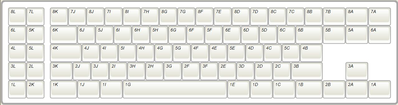

If you assign rows from 1 to 8 and columns from A to L, the matrix works out to this:
Matrix Layout.jpg (66.8 KiB) Viewed 11313 times

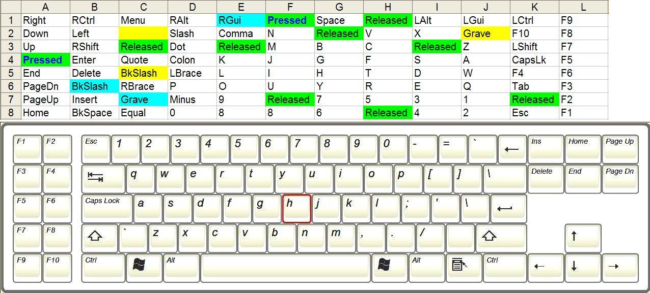

Some matrix positions are used as calibration pads (4A, 1F) or have no pads at all (3C, 3E, 7F, 2G, 1H, 8H, 4I, 7K). Also, remember that some key caps cover other switches often using them as stabilizers.
  • ISO Enter key uses 4B, but covers 6B
    ANSI Enter key also uses 4B, but covers 5C
    ANSI right shift uses 3K, but covers 2J
    Standard (2x) Backspace uses 8B, but covers 7C
    Standard (2.75x) right shift uses 3B, but covers 2C
    Long space bar uses 1G, but covers 1E
You would be free to assign keys any way you like, but a default key assignments might look like this:
