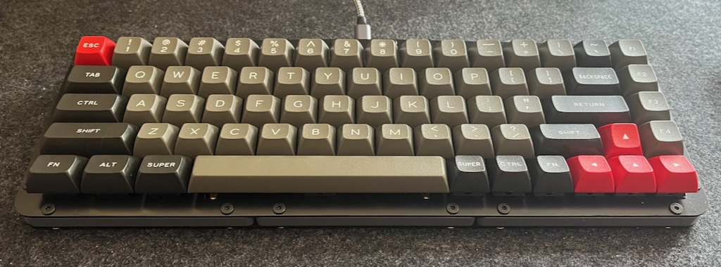

I recently finished my second keyboard build. I call it "Keybird69" because it is a keyboard for a Finch, and it has 69 keys.
* sandwich case made from LEGO Technic beams and FR-4 plates
* unix69 layout
* PCB designed by me
* Waveshare RP2040-Tiny controller
* Cherry MX Clear switches, Durock screw-in stabilizers
* SP DSS Dolch keycaps
I am pleased with the result :-) tho I fear that perfection has not yet been achieved, and I am doomed to build another.
