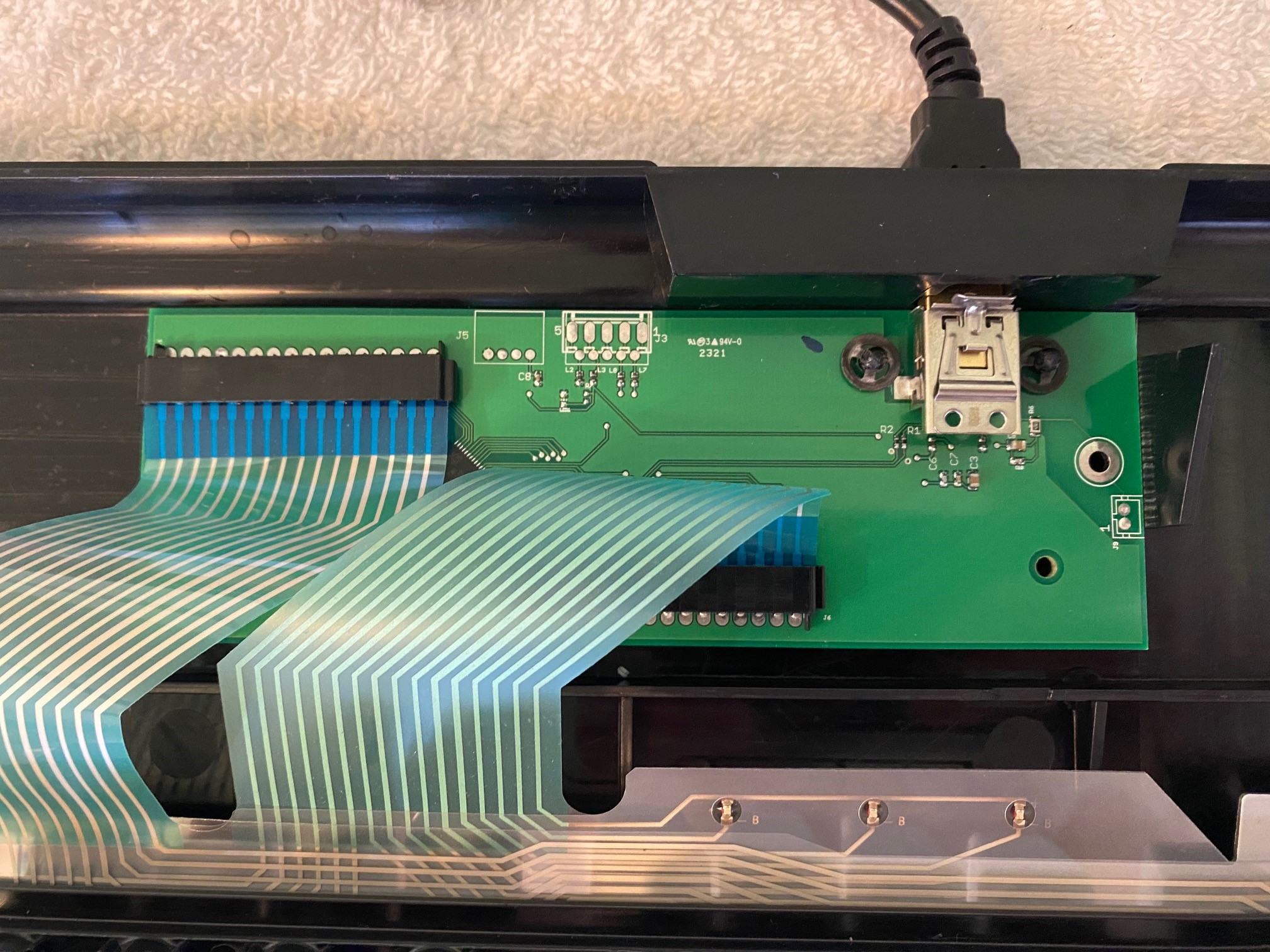

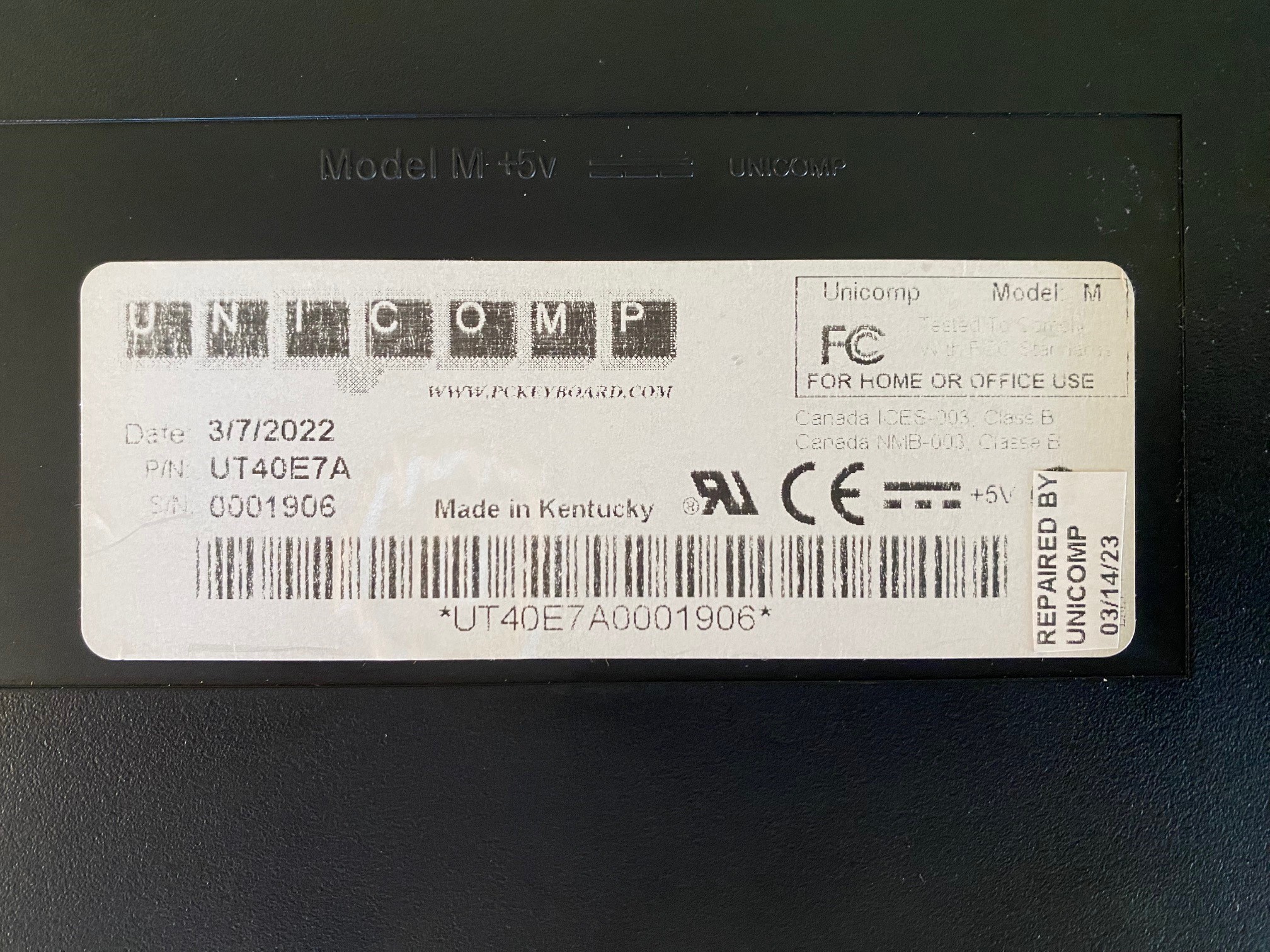

Interesting. I just took delivery of a New Model M last week. It took them 3 months to get me one. Also just got back my Mini Model M I sent to them to flash or repair the disconnect problem it would suffer from. Now I have a small label on my back sticker that it was serviced by Unicomp with a date. Probably to keep track of repaired Mini Ms. I'm sure they're slowly going through all of them.pandrew wrote: 26 Mar 2023, 13:14 Unicomp very recently started shipping Raspberry Pi Pico based controllers with their New Model Ms.

pandrew
- Location: Romania
Interesting! Any chance I could ask you to post a picture of the Mini M's controller? The Mini M's controller is different shape from the one that I mentioned in the previous reply, but we believe they have been working on a pico based replacement for that too, so maybe we can write open source firmware for Mini M too.Falkenroth wrote: 26 Mar 2023, 17:03 Interesting. I just took delivery of a New Model M last week. It took them 3 months to get me one. Also just got back my Mini Model M I sent to them to flash or repair the disconnect problem it would suffer from. Now I have a small label on my back sticker that it was serviced by Unicomp with a date. Probably to keep track of repaired Mini Ms. I'm sure they're slowly going through all of them.

My Mini M isn't new. I got it when it was released a few years ago. Or do you think they installed a new controller?pandrew wrote: 26 Mar 2023, 18:51Interesting! Any chance I could ask you to post a picture of the Mini M's controller? The Mini M's controller is different shape from the one that I mentioned in the previous reply, but we believe they have been working on a pico based replacement for that too, so maybe we can write open source firmware for Mini M too.Falkenroth wrote: 26 Mar 2023, 17:03 Interesting. I just took delivery of a New Model M last week. It took them 3 months to get me one. Also just got back my Mini Model M I sent to them to flash or repair the disconnect problem it would suffer from. Now I have a small label on my back sticker that it was serviced by Unicomp with a date. Probably to keep track of repaired Mini Ms. I'm sure they're slowly going through all of them.

Yes, it's possible, that's why I'd like to see the picture. It doesn't matter that the mechanics of the keyboard is older. You're the freshest Mini M repair recipient I know of, and they don't even currently have the Mini M listed for sale on Unicomp's website. If it had a disconnect problem, then it's possible it just had a USB port soldering problem that they fixed, or maybe you got lucky and they found a spare old controller in their factory. But it's also possible that you could have gotten a new controller.Falkenroth wrote: 26 Mar 2023, 19:23 My Mini M isn't new. I got it when it was released a few years ago. Or do you think they installed a new controller?

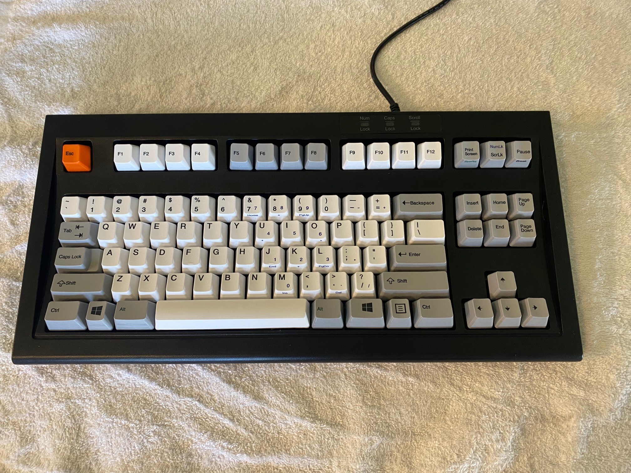

I don't think the controller was replaced. Here's some photos.pandrew wrote: 26 Mar 2023, 19:32Yes, it's possible, that's why I'd like to see the picture. It doesn't matter that the mechanics of the keyboard is older. You're the freshest Mini M repair recipient I know of, and they don't even currently have the Mini M listed for sale on Unicomp's website. If it had a disconnect problem, then it's possible it just had a USB port soldering problem that they fixed, or maybe you got lucky and they found a spare old controller in their factory. But it's also possible that you could have gotten a new controller.Falkenroth wrote: 26 Mar 2023, 19:23 My Mini M isn't new. I got it when it was released a few years ago. Or do you think they installed a new controller?

pandrew
- Location: Romania
You're right, this is the original controller, sorry for the bother!

It was worth looking. They didn't tell me what they did so might as well open it up.pandrew wrote: 26 Mar 2023, 19:51You're right, this is the original controller, sorry for the bother!
