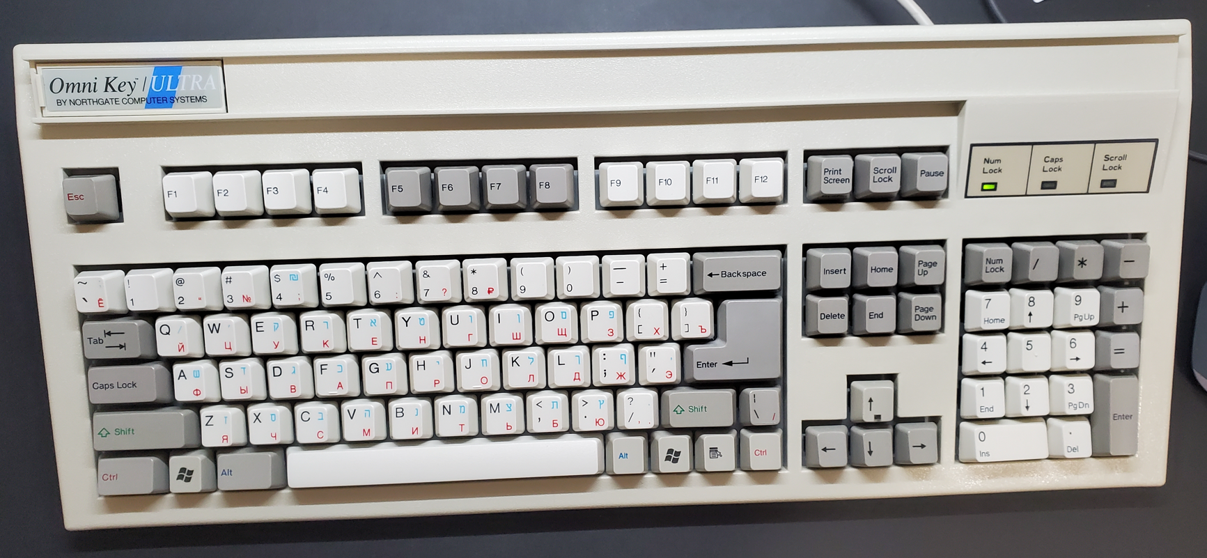

I went through all this process (trying to find places that offer custom legends for an affordable price) myself several times. I am trilingual (Russian, Hebrew, English) and my touch-typing skills aren't great, so I need all three legends on my keyboards. And did I mention that most of my boards use Alps-mount keys? Alps keysets with Hebrew and Russian sublegends are few and far between, and the Russian sublegends on the sets I have seen are super hhhhhhhhhhhhhhhhiiiiiideous and are made for an old typewriter layout.
Custom dye-subbed, pad printed, or double-shot sets have a very high cost per set unless you don't mind ordering several dozens of them (one exception is dye-subbed keys for Model M or F - see below). WASD can make you a single set for a reasonable price but, from what I heard, the durability is low.
At one point, I found a small engraving business that made me one keyset with engraved and color-infilled legends, but that was years ago and that person has since retired (and the color infilling on that engraved keyset does not like cleaning, so at some point I will have to refill the grooves with paint). Other engravers I have contacted use lasers. Trying to laser ABS plastic releases toxic gases, and I was unable to find definite info on whether it is OK to laser PBT caps, so lasering keycaps in home/small shop conditions is not really an option.
So, aside from that engraved keyset, and the custom dye-sub Model F/M keysets that Ellipse made for me, all my keyboards have custom made stickers from this vendor. They charge a one-time design fee and then a small price per set (minimum order quantity is 20 sets). The stickers are not as durable as traditional printing methods, but are still pretty OK, just be careful when you clean the keycaps - see attached picture, I think they look good.
You can also contact these guys and ask them to make custom MX-mount keys with UV-cured acrylic printing. I think they mainly work with their uniprofile sets but maybe they will print you a traditional profile set if you ask? Their pricing seems OK and they say it's very durable but I don't have any experience with them.
19 Jan 2023, 19:07
Dashing set! Love those triple coloured legends. Keep one set untouched in the cupboard for retirement and shine the others to oblivion in the meantime. Problem solved.

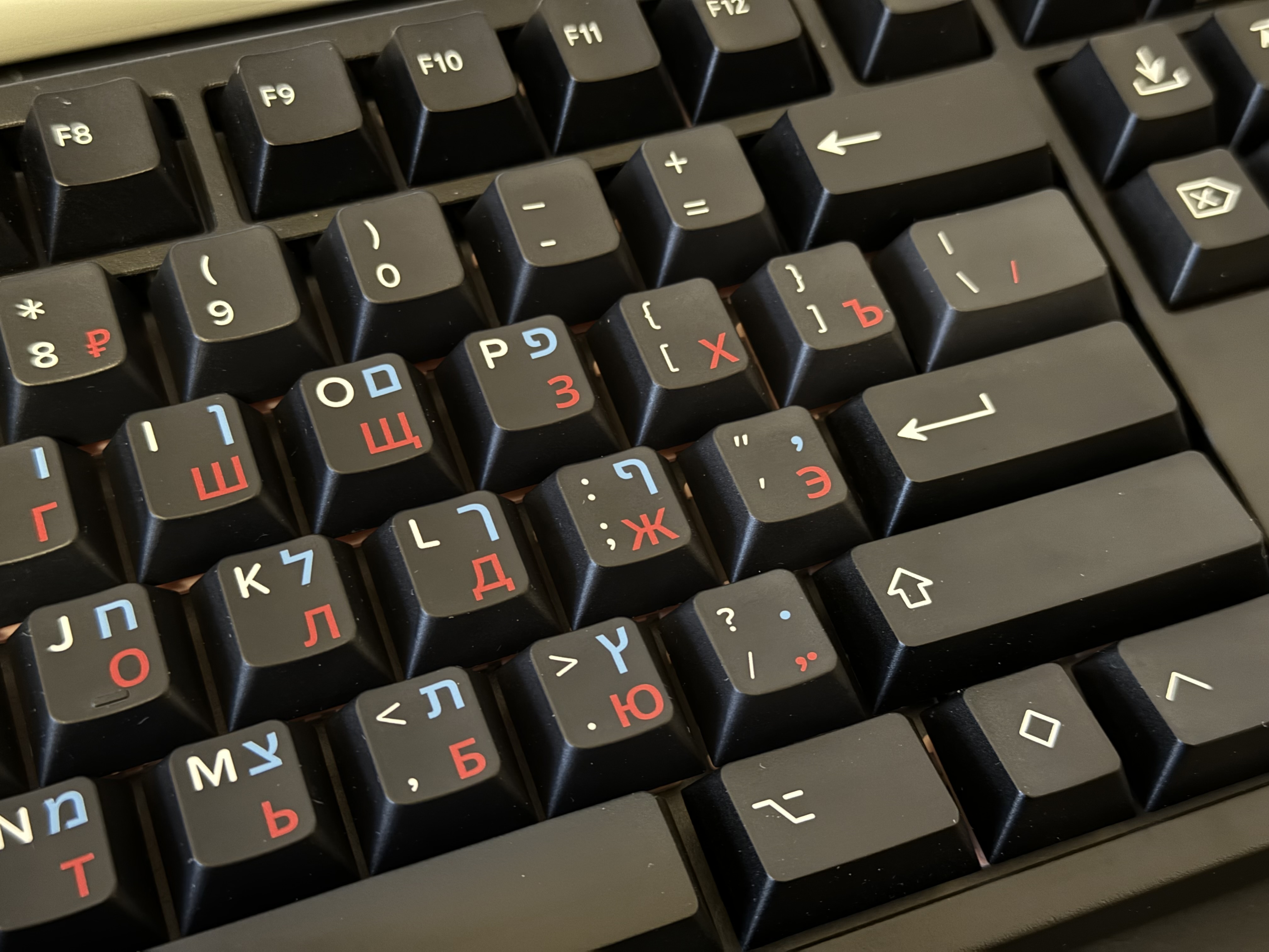

So, I designed and ordered a custom dye sublimated PBT keyset through Yuzukeycaps.com, and so far I have been impressed. They have a fairly intuitive online editor that allows you to design and fine-tune your own keycap set (background color, legend language, color, sign, alignment, etc.). The printing process is reverse dye sublimation, and the OEM is Keyreative.
I have heard mixed things on GH and r/mk about keyreative’s quality, but so far (in the week or so I have used these keycaps) I have no complaints. Legends are sharp and well-aligned, black background isn’t quite as dark as on your typical double-shot black keycaps (unsurprising for reverse dye sub process) but still pretty dark - you can see the difference in the video below: alphas are the keycaps I ordered, and mods are double-shot PBT from PBTfans.
Limitations: right now they only offer Cherry profile MX mount keycaps; color, font, and language choices are rather limited, but they keep adding different options, and their customer service has been very responsive to my requests for customization.
So, (dye sub) color me impressed.

Interesting! Do you have any pictures you can post here, or is there just the youtube thing?
engr
07 Jul 2024, 04:03
AndyJ wrote: 05 Jul 2024, 20:18 Interesting! Do you have any pictures you can post here, or is there just the youtube thing?
Sure, here's a close up photo.
