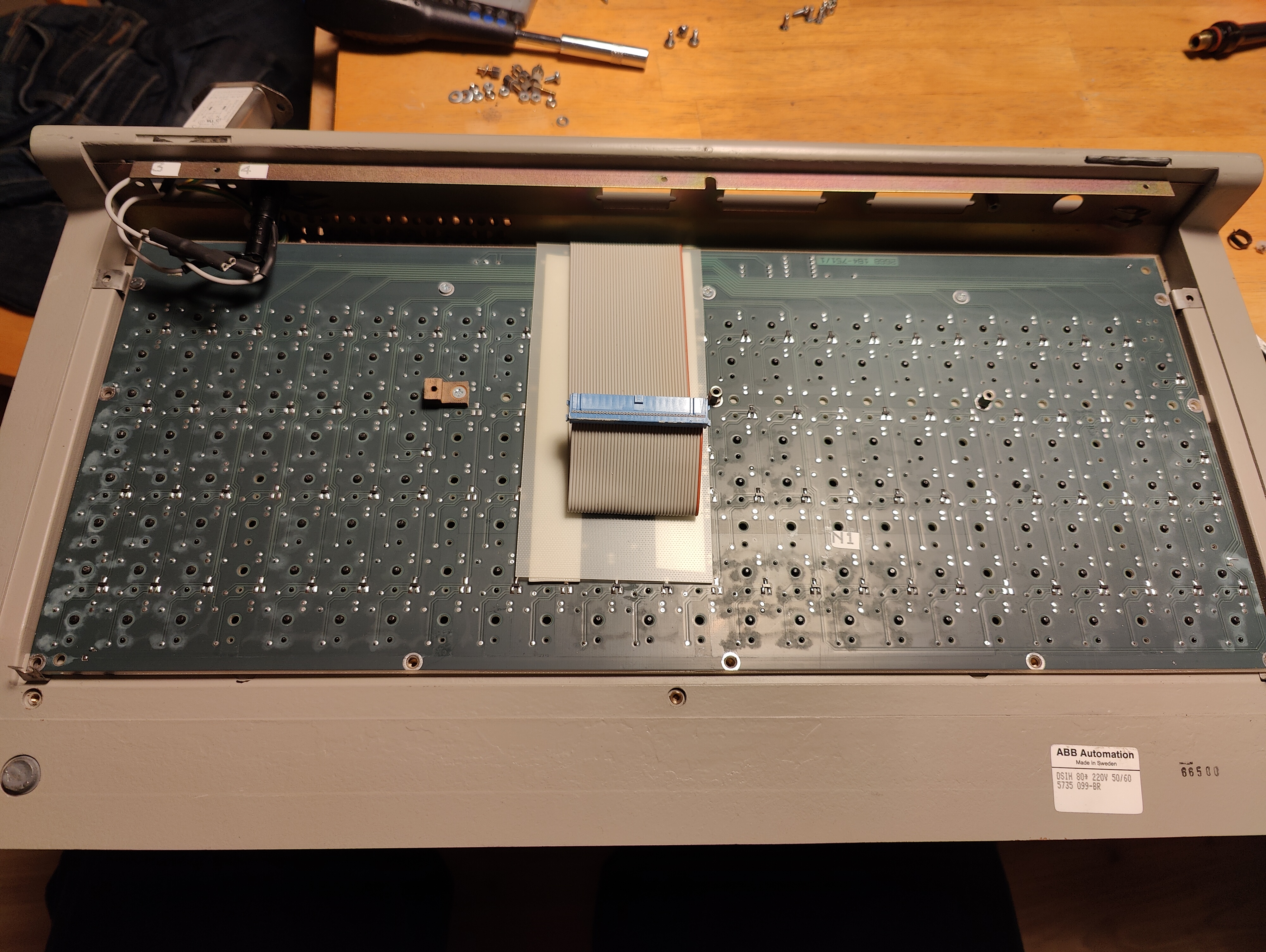

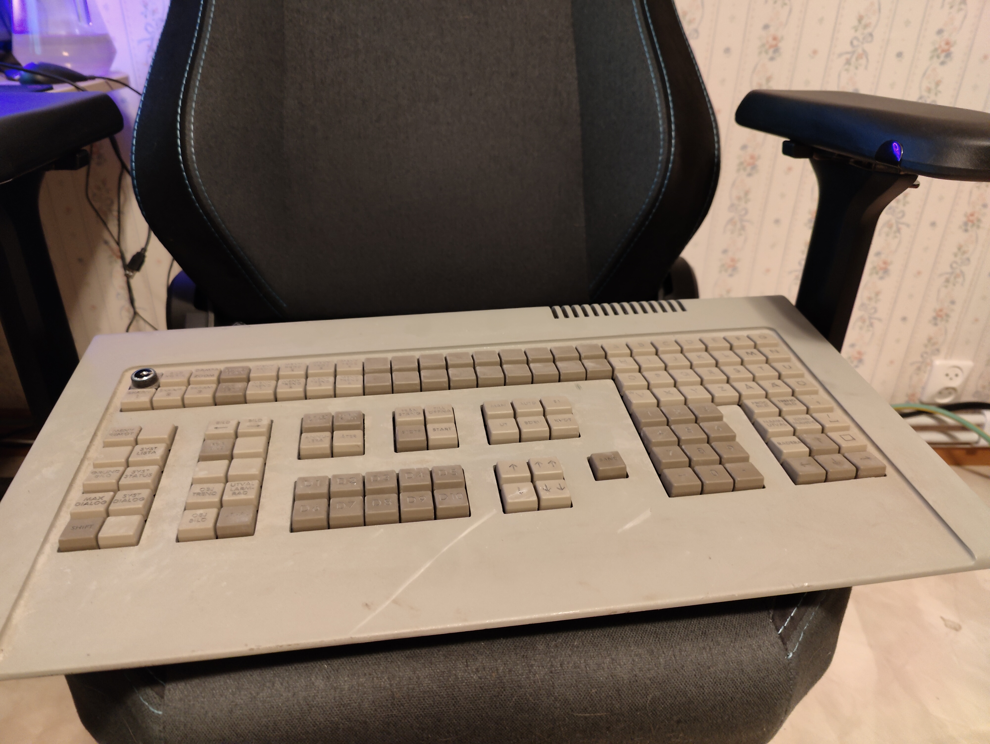

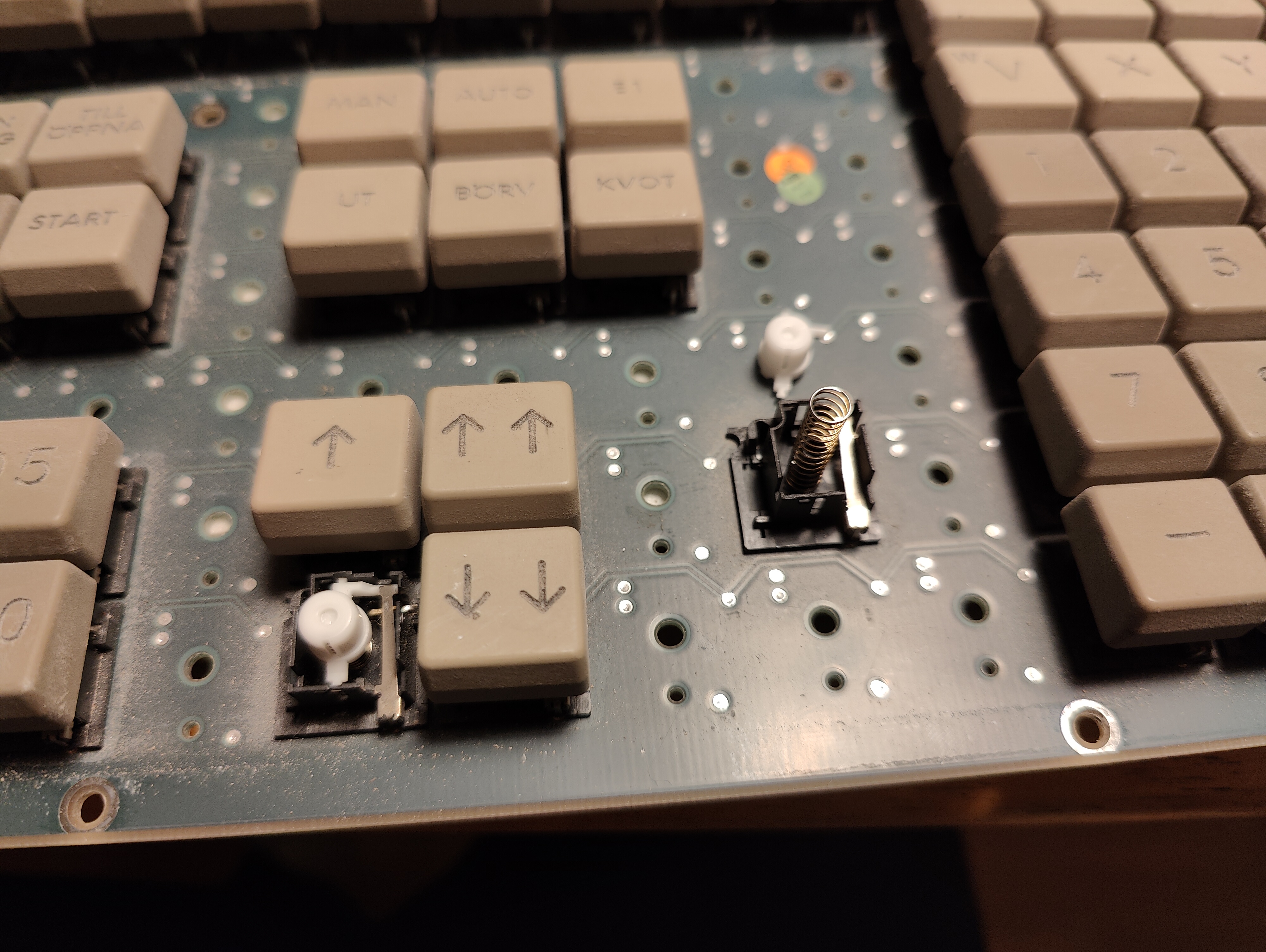

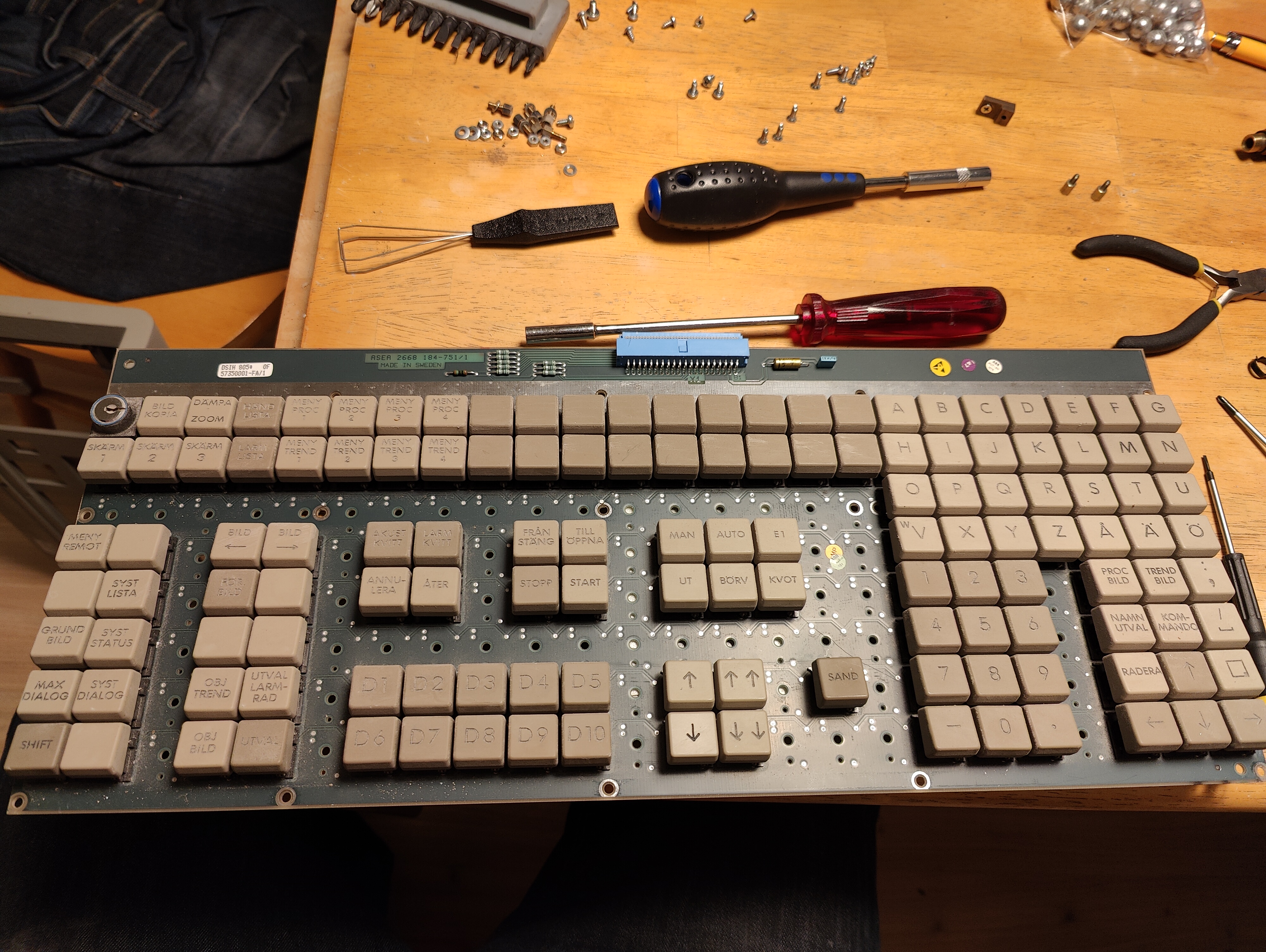

Ended up finding this old mechanical ABB keyboard from the 80's and it was really dirty from sitting abandoned for more than 20 years in a factory.
The layout is really strange(alphabetical order) plus all the extra keys for that process system.

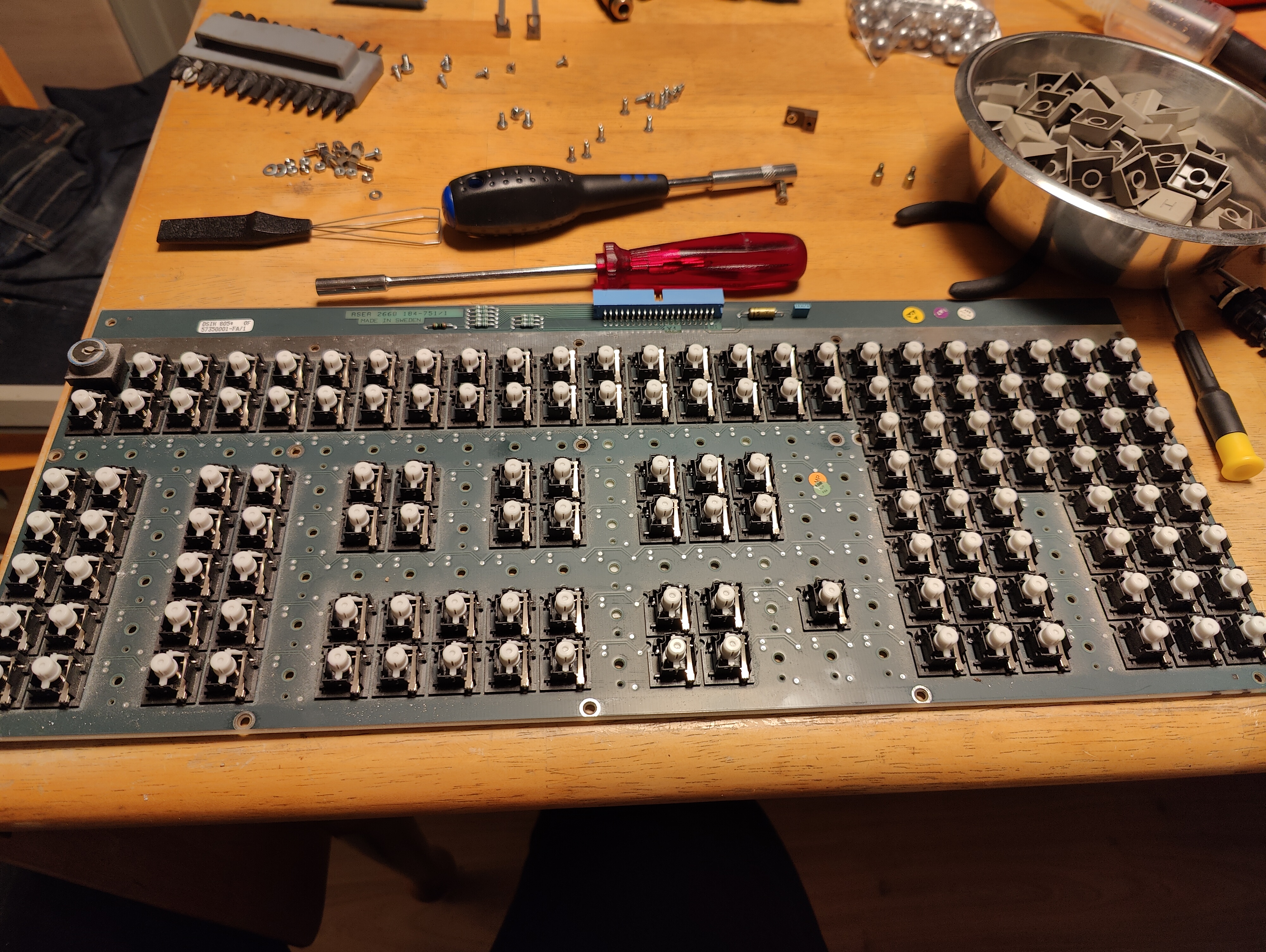

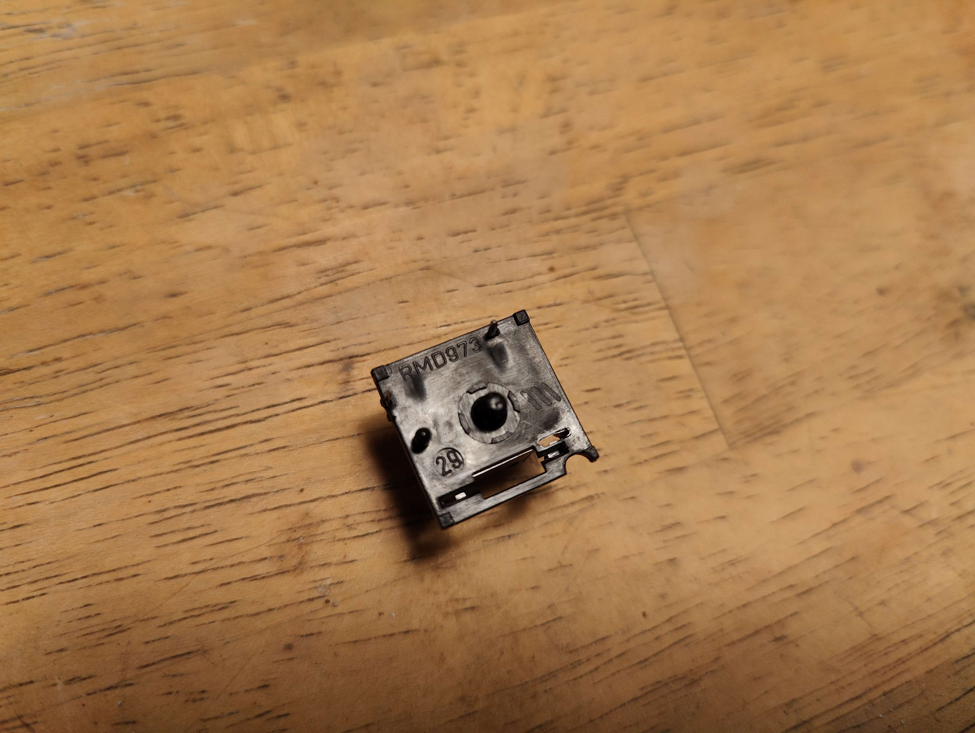

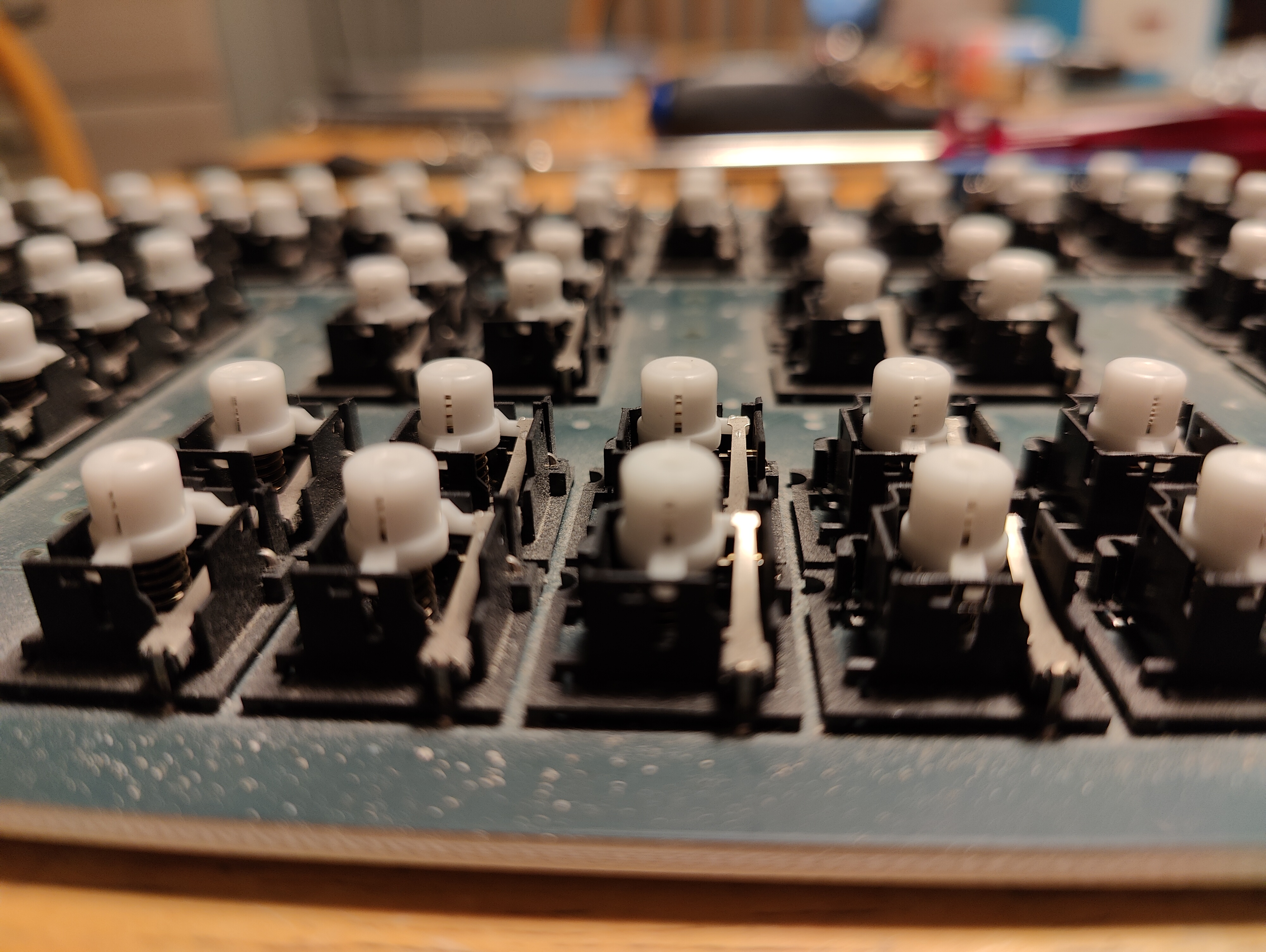

The switches are some I have never seen before and they are linear leaf spring contact and coiled spring actuation.
ABB DSIH80* cleaning

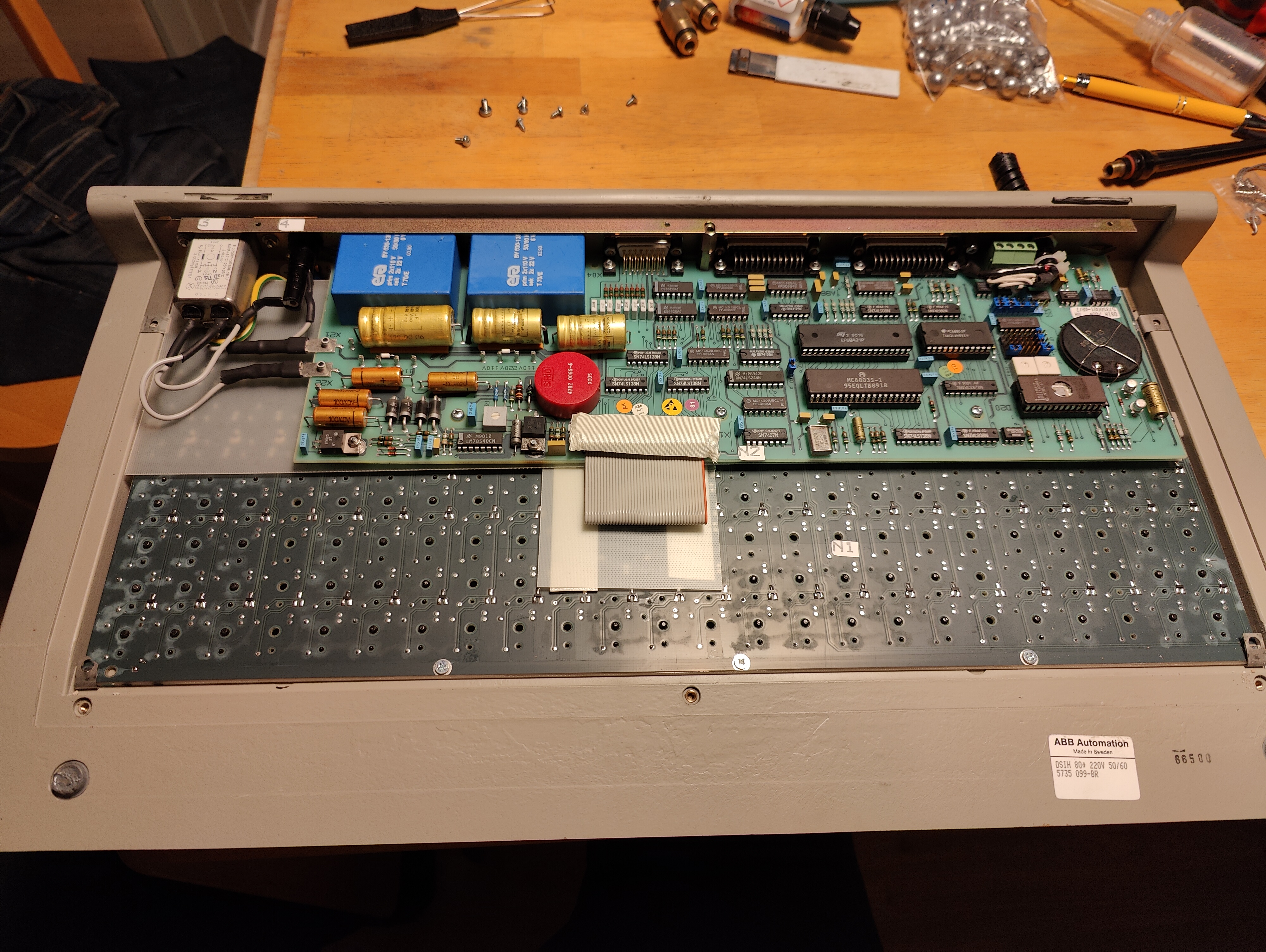

so far i have cleaned the case with soapy water and will blow all the dust off with compressed air from the boards inside. I am puzzled why it would need 220V power but i guess it would be because the mainframe would be far from the operator room.

I know thoseArto wrote: 22 Oct 2022, 00:42 The switches are some I have never seen before and they are linear leaf spring contact and coiled spring actuation.
wiki/Ericsson_RMD_973_series
Mine came in an Ericsson produced Telekom board.

Looks like one large switch grid. Would make one hell of an ortho-linear keyboard.
ABB made/makes industrial equipment, such as robots. The PCB is marked ASEA ("A"): which merged with "BB" in Aug 1987 to form ABB. So the design must be pre-merger but it was sold after.
Both ASEA and Ericsson Data were Swedish, so it does not surprise me that it is made from Swedish components.

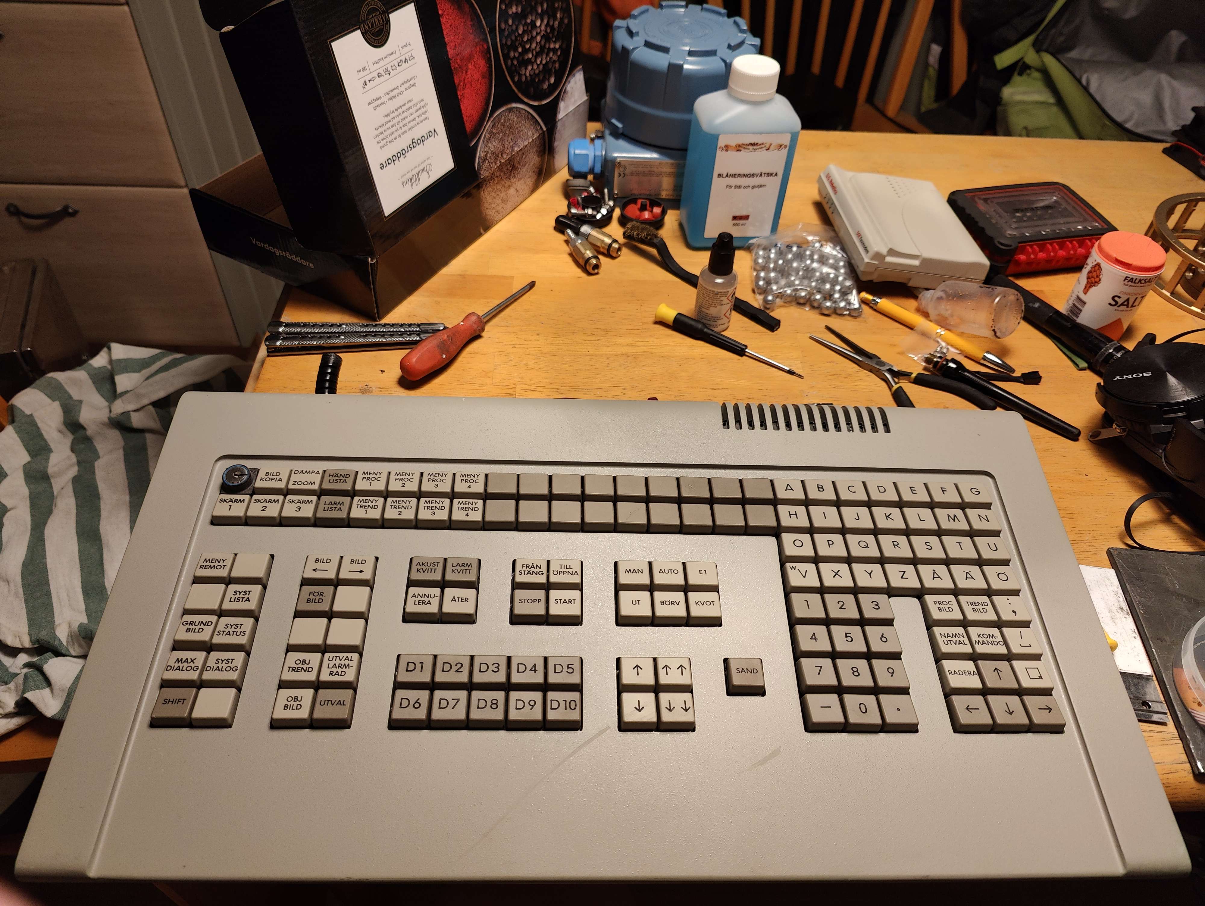

The keyboard is now cleaned and fully assembled. The switch is an Ericsson RMD973 linear switch, scratchiness varies from switch to switch and might be due to wear.
now it is time to put the board in storage or sell it.

I found a lot of the switches in my ericsson board pretty scratchy. Didnt really like the typing feeling , but the board was super solid.Arto wrote: 05 Nov 2022, 00:10 The switch is an Ericsson RMD973 linear switch, scratchiness varies from switch to switch and might be due to wear.
