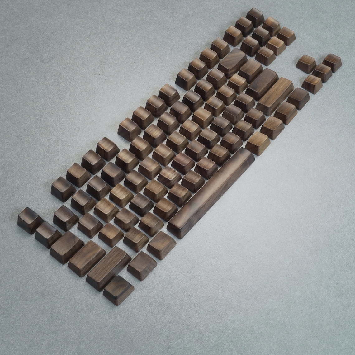

i have never seen a high quality wooden keycap set, that looks good. the issue are the wood grains. you would need to make a whole set out of a single wood sheet. and it seems noone is really caring about this littel detail which makes all the difference. other then that just using a cnc mashine might not be enough, so there might be a lot of labor work to do to get a really nice flat surface and nice finish. Also it would be crucial to not use high quality hard wood, which is not cheap.
here an example from etsy https://i.etsystatic.com/20592325/r/il/ ... 0_izoy.jpg
you might think, uhh nice dark brown hard wood. but thats nothing i would purchase just becasue the singel keys dont harmonize together.

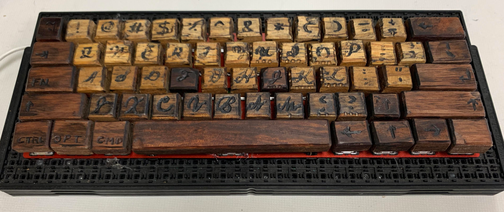

bleh - Copy.png (2.21 MiB) Viewed 10355 times
From the ugliest keyboard thread.

Kidding aside, I rather like the Etsy set that inozenz links to. It's not for me, tho. I'd need legends.
