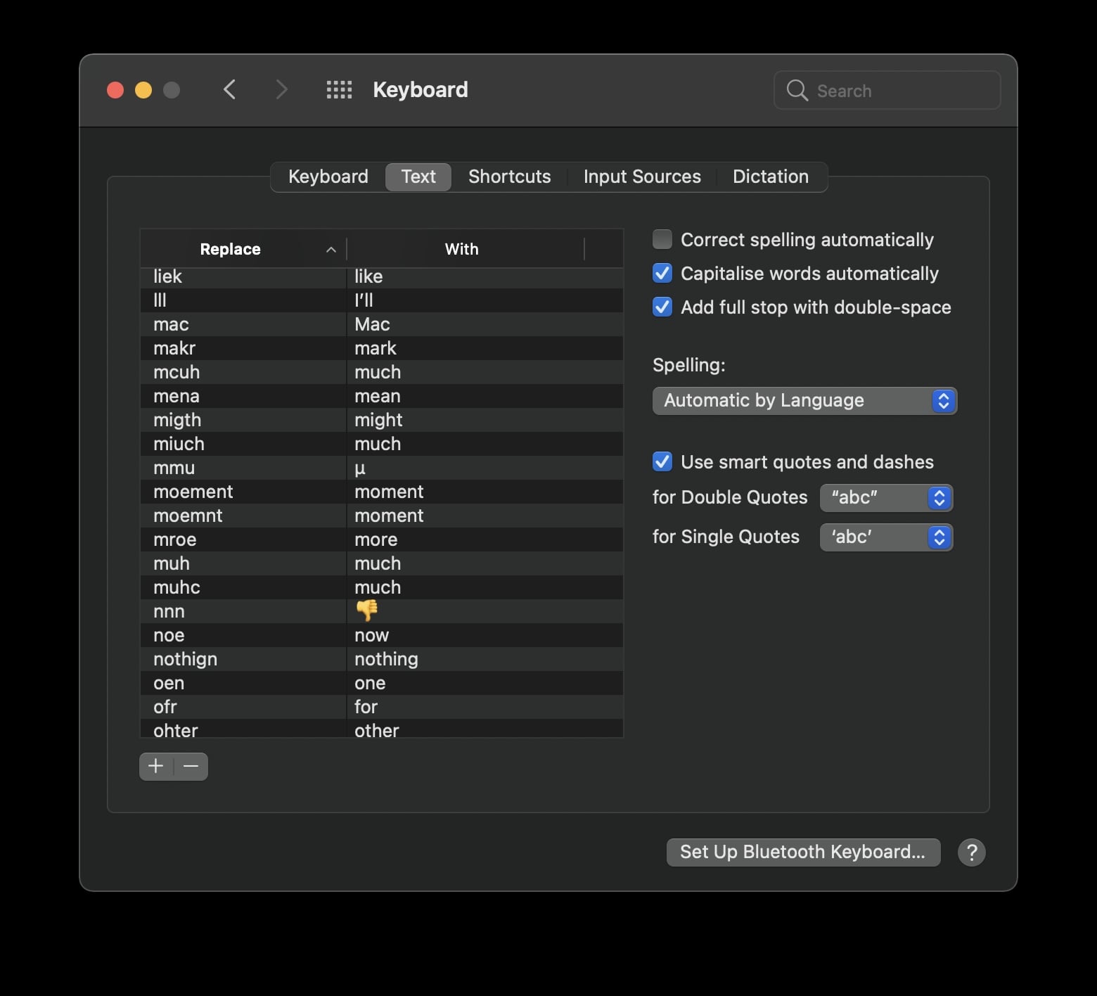

Screenshot 2021-04-18 at 2.06.25 pm.jpg (87.53 KiB) Viewed 7141 times
These are synced to my phone as well, which excuses some but not all of them!
Dynamic force curves can be altered as you type, for a really dynamic, downright haptic keyboard. We have the processing at our disposal to do this stuff. But the actuators are, indeed, a power hog. Is magnetism the right path, I wonder? Anyone know much about piezoelectrics?
raoulduke-esq
18 Apr 2021, 15:20
Your substitution list could also be used to translate Scottish pronunciation to written English!
