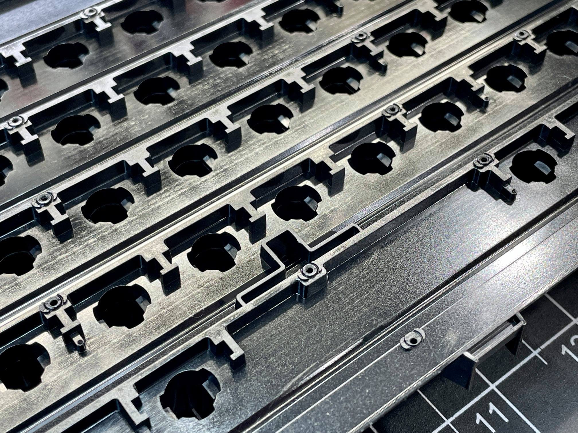

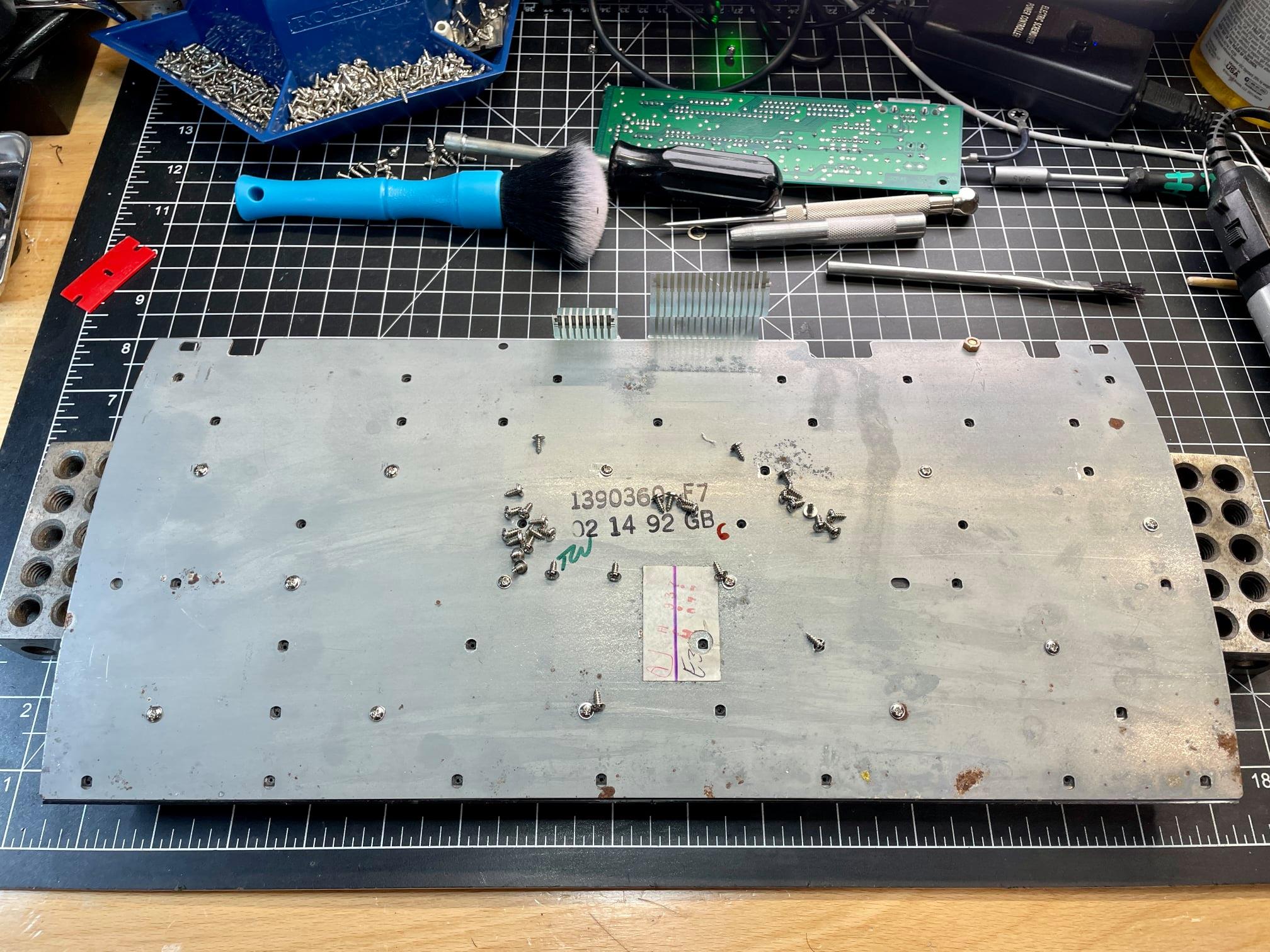

Why do you think you need to replace the original 84-key frame/whole barrel assembly?
If there are no pre-existing lateral cracks in the plastic frame, it sounds like your IBM model M SSK just needs to have the plastic rivets carefully removed, drilled out, and replaced with M2 metal screws.
On February 27, we just did an SSK for another model M fan last week and we photographed the work and he was happy with the new feel after the repairs.
ClickyKeyboards SSK repair-1
ClickyKeyboards SSK repair-2
(For multiphoto library of our SSK rebuild).
