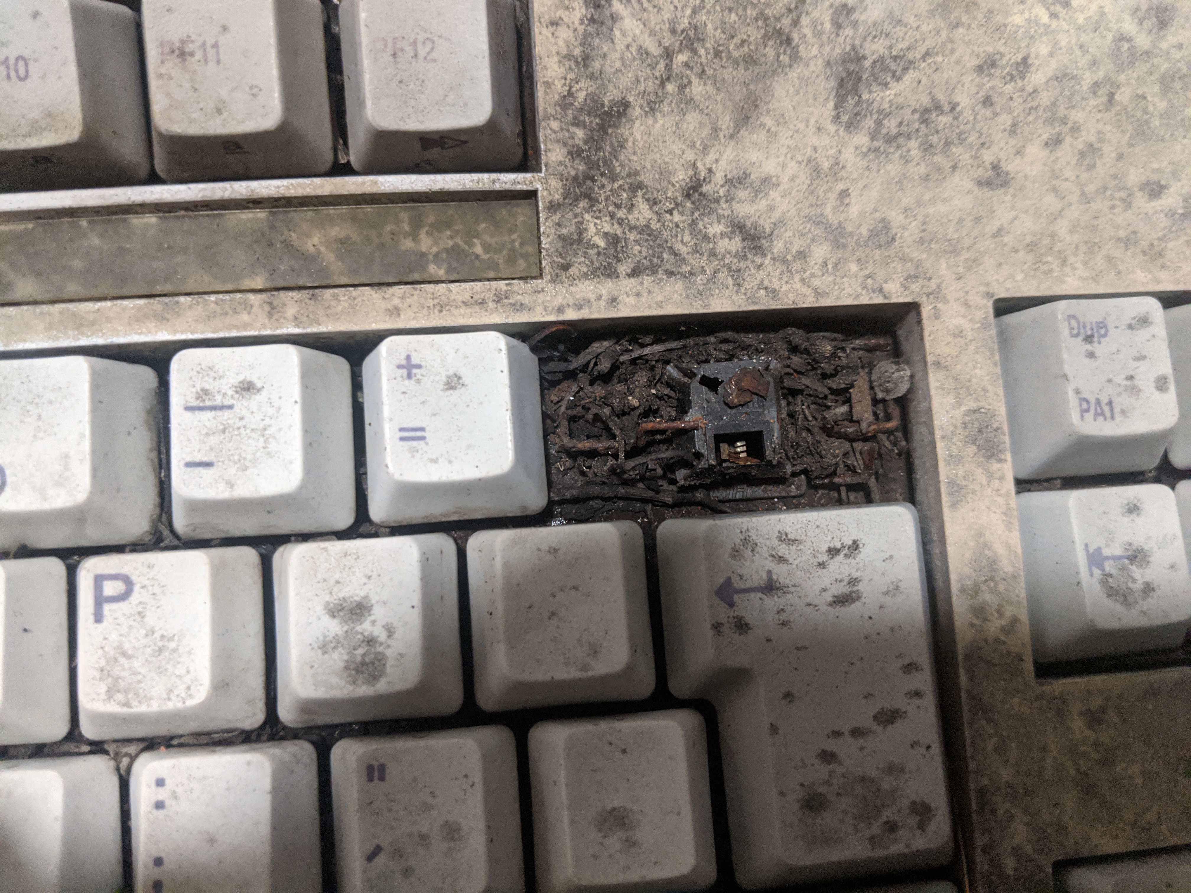

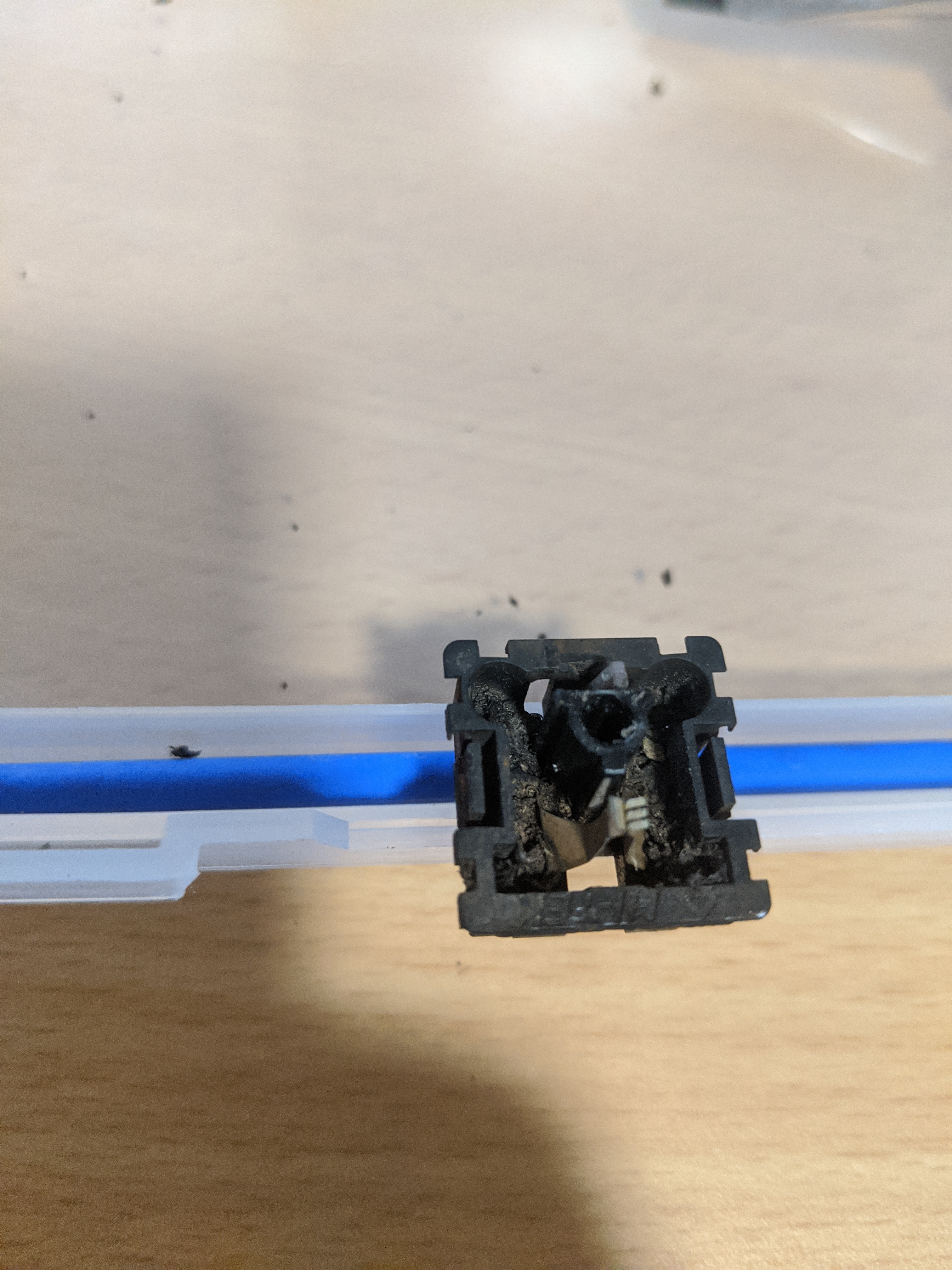

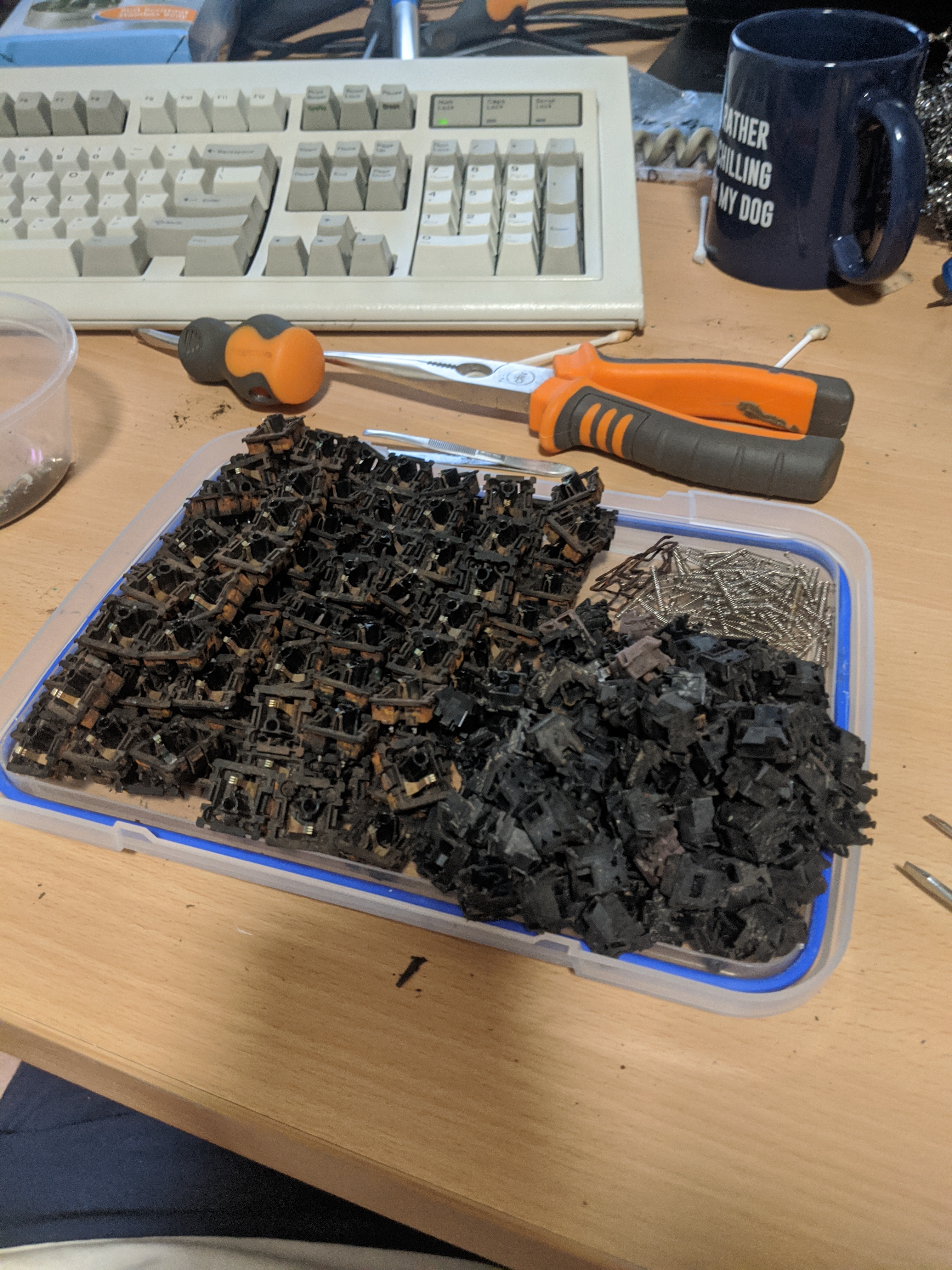

I had some terrible condition clicky black space invaders (full of dirt and organic detritus, see pics).
IMG_20200430_204735 (1).jpg (4.72 MiB) Viewed 1471 times
I was able to clean them to a very usable condition by desoldering, disassembling, and running them through an ultrasonic cleaner for a long time. This got them to the point of functioning (originally none of them returned when pressed) but most were still pretty scratchy.
I ended up lubing them with 2303, and the results were pleasently surprising. I lubed the three 'rails' on the centre post, the matching parts on slider and the bottom sides of the contact arms, and the spring (as well as the track for the click follower arm on my clicky switches). I never really worked out where most of the friction came from, and I did a bunch of experiments lubing various parts of the switch, but the above method was the best feeling. The board now feels great, although due to my lack of understanding of the click machanism in these switches, I seem to have dampened the click a lot, so they sound and feel fairly different from my stock clicky board. Still, very much usable, and very happy with how it ended up.
