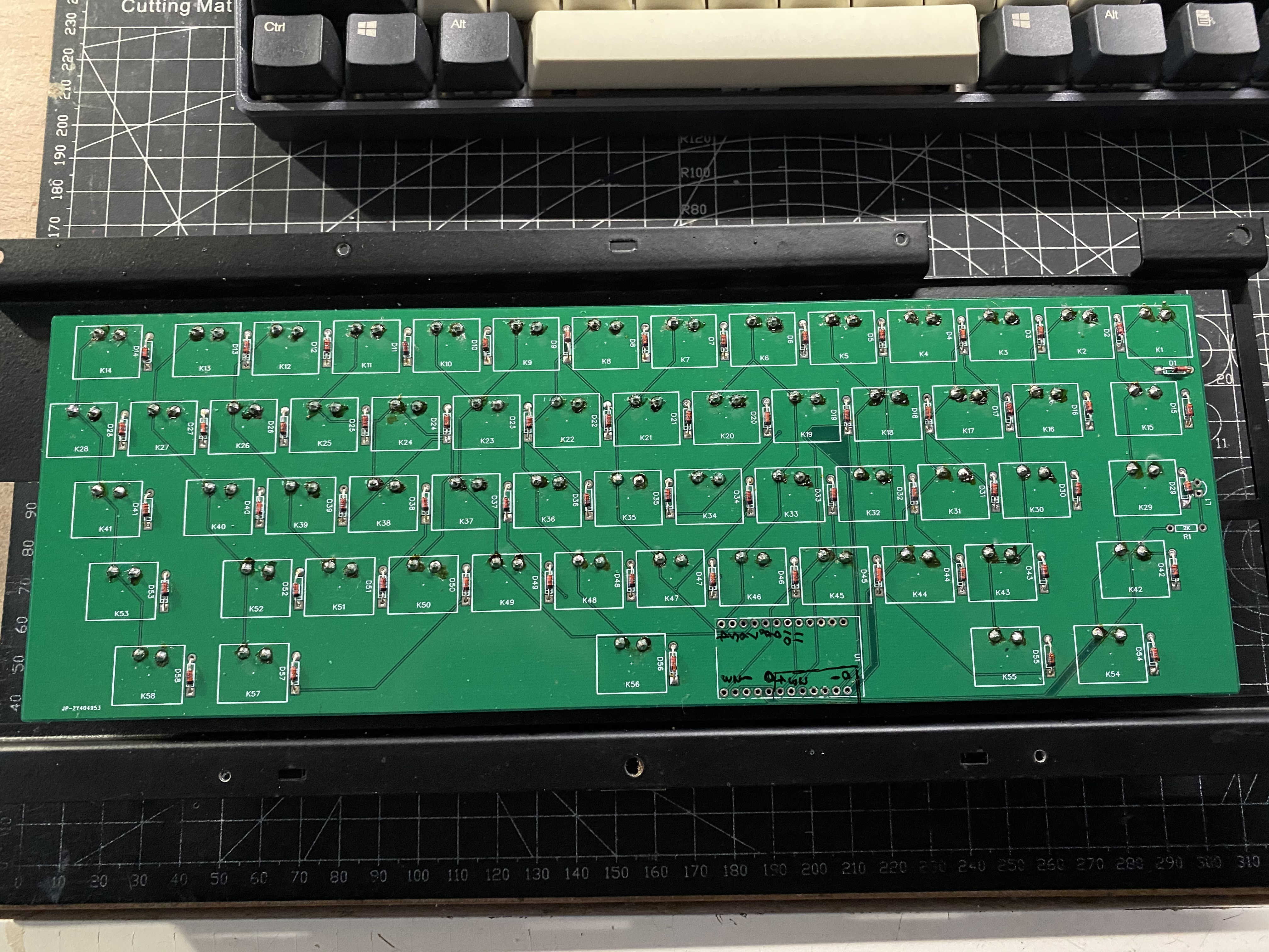

nice work, I use a new pcb for my m0110, the pcb uses a pro micro as controller but I am going to remap the pcb with a 32u4 feather. and is now waiting for wire and plugs to do the remap.

I've got the pcb file from a guy "cerement".
anthonymak wrote: 28 Dec 2020, 12:19 nice work, I use a new pcb for my m0110, the pcb uses a pro micro as controller but I am going to remap the pcb with a 32u4 feather. and is now waiting for wire and plugs to do the remap.

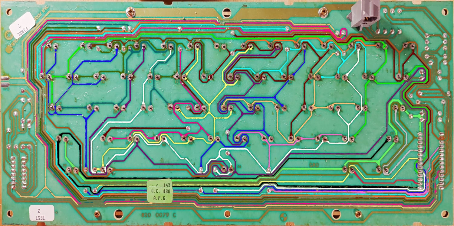

Nice work! Cool to see how it was laid out originally.

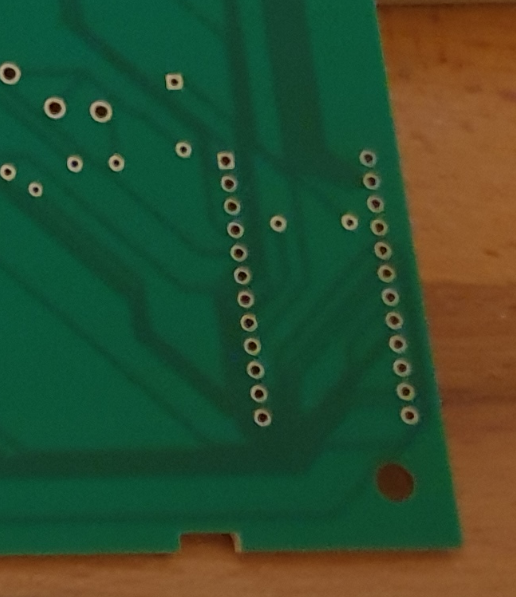

The PCB soyuz made is so close to being perfect. If only there was a socket for a Feather or even a ProMicro/nice!nano. Although with the nice!nano you'd need to mess with ZMK since it runs an interesting chip.
Hopefully soyuz releases PCB files under some license that allows forking or does a v2 at some point. It would be simple enough to clone from scratch but I feel like I'd be stepping on his toes.
Edit: The two pins in the middle threw me off, I thought the soyuz PCB was for a Teensy 2.0. If it supports a ProMicro then I'd just throw in a nice!nano with ZMK and call it a day.
