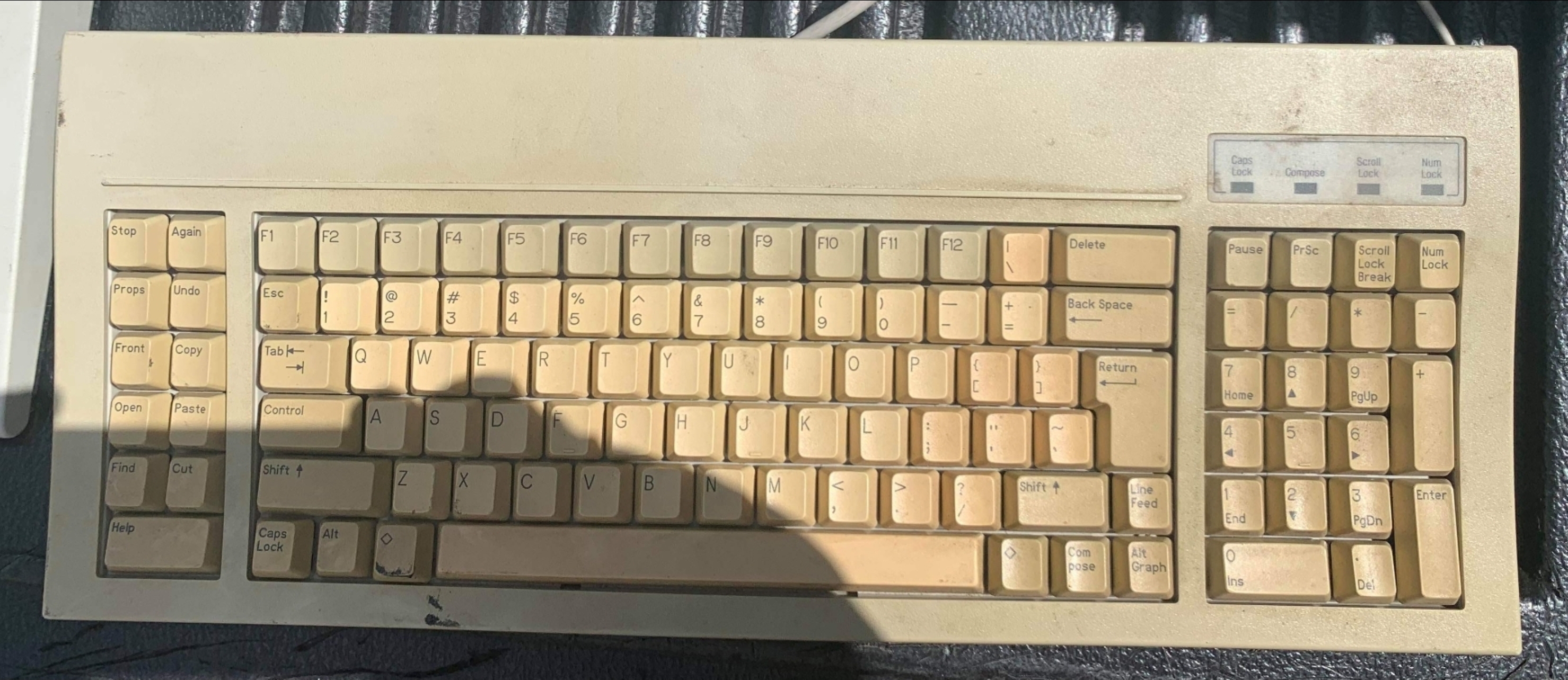

Does anybody know what switches this keyboard uses?
https://www.ebay.ca/itm/ACK-700-POS-Ter ... Swp6Reob8t
Their website says it is rubber dome, but why does it have removable caps and sliders then?

Are you after the Victor that the link goes to, or the original item?
The Victor has Peerless.

The ACK-700, which should be the original item.

Could the ACK-700 be a slider over dome switch? the slider doesn't look similar to anything i've ever seen.

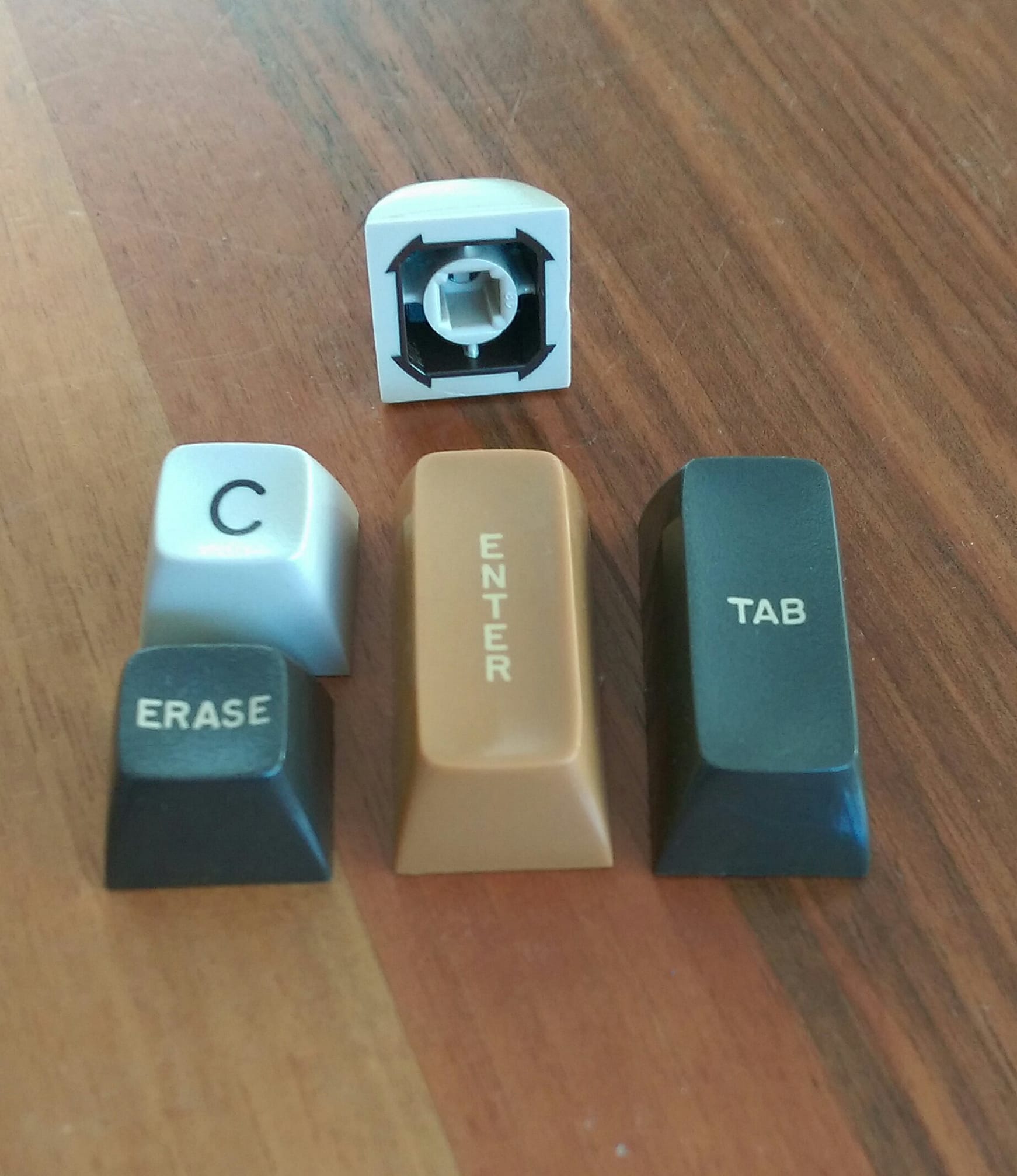

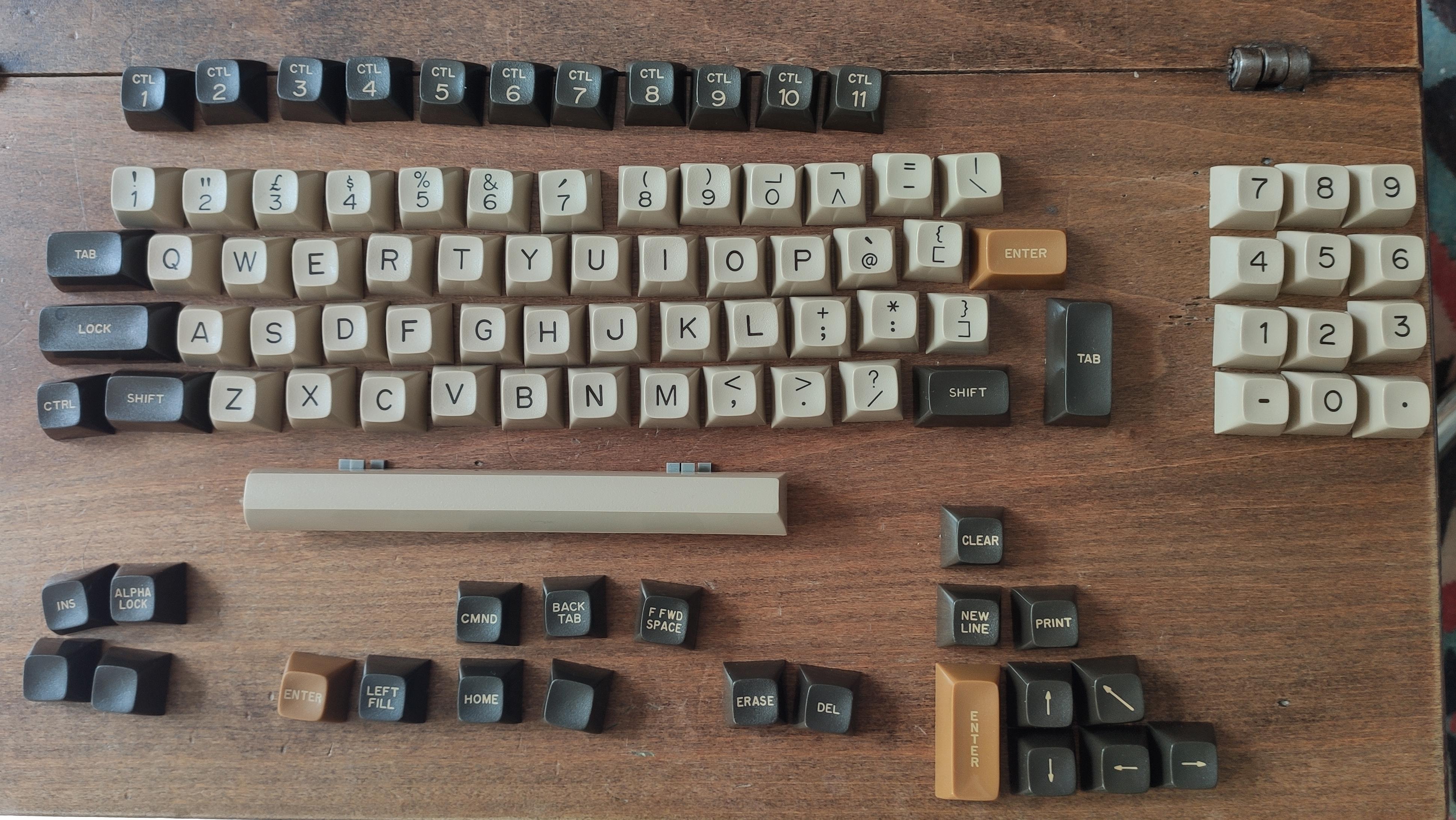

I bought these keycaps about a year ago on ebay. Does anybody by any chance know which keyboard they originally belonged to? It's obviously Micro Switch, but that's as far as I got.

The System 10 had CTL for the F keys. https://archive.org/details/bitsavers_s ... 2/mode/1upmhinsch wrote: 06 May 2020, 23:50 I bought these keycaps about a year ago on ebay. Does anybody by any chance know which keyboard they originally belonged to? It's obviously Micro Switch, but that's as far as I got.
The DRS20 had the same shifted number legends and colorway. https://collection.sciencemuseumgroup.o ... splay-unit
So perhaps something in that Singer / ICL lineage, like a System 25?

Suspect it's a keycap variation of the same keyboard. Here is a close-up of another version and a clearly matching LOCK light spot.MMcM wrote: 08 May 2020, 18:00 The DRS20 had the same shifted number legends and colorway. https://collection.sciencemuseumgroup.o ... splay-unit

kps wrote: 08 May 2020, 20:04Suspect it's a keycap variation of the same keyboard. Here is a close-up of another version and a clearly matching LOCK light spot.MMcM wrote: 08 May 2020, 18:00 The DRS20 had the same shifted number legends and colorway. https://collection.sciencemuseumgroup.o ... splay-unit
Yes that looks indeed very similar. Thanks!
Edit: And the second one is actually from Bracknell, which is where I currently live. That's a weird coincidence...

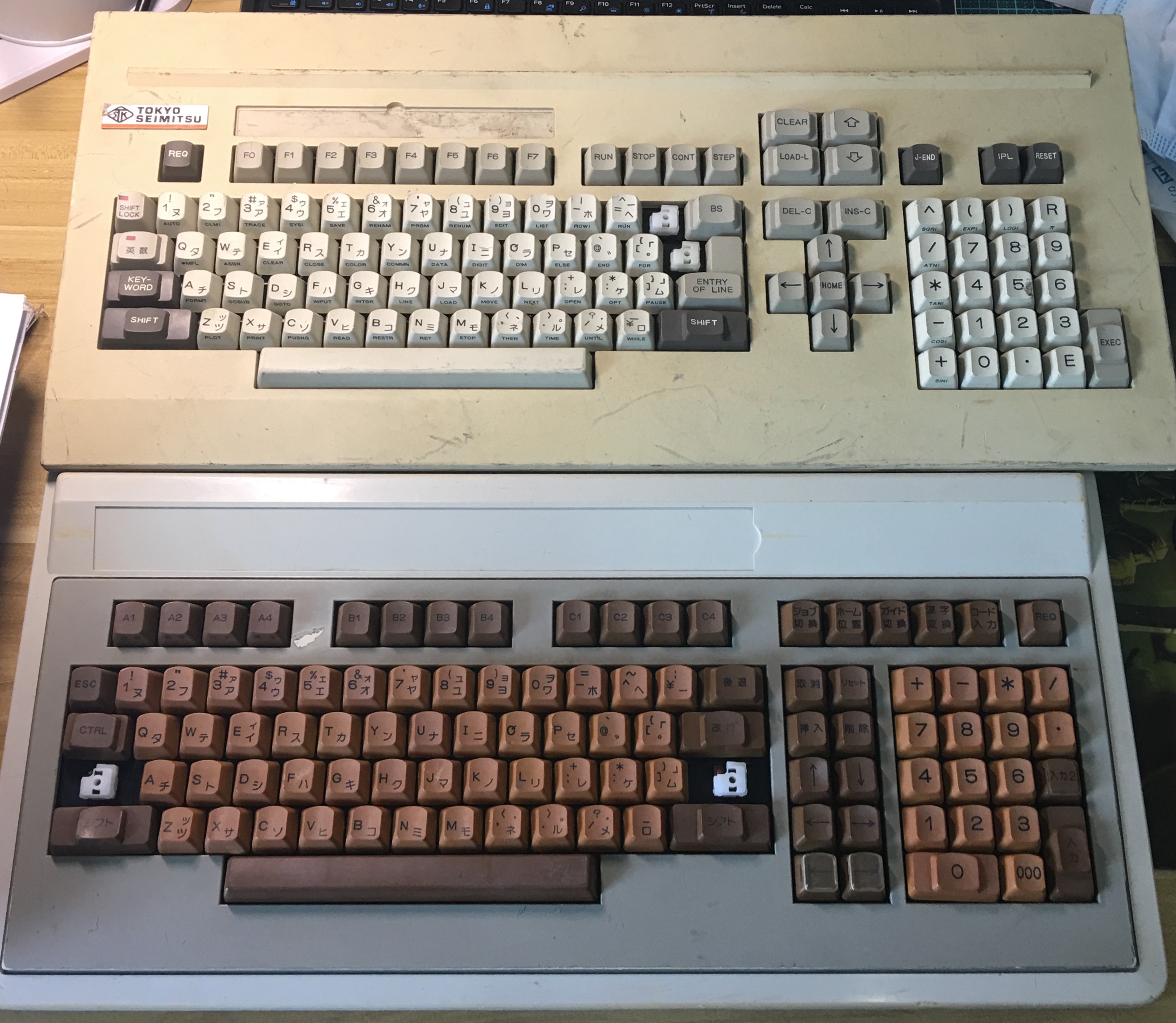

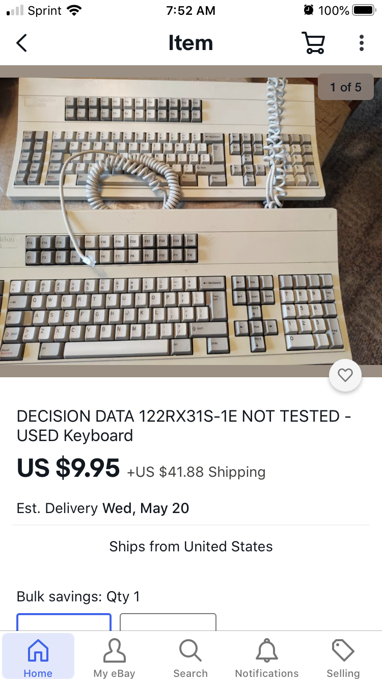

Anyone know what switches this thing uses and if it can talk to a pc? Couldn’t find on the wiki.
kelvinhall05
- Location: Canada
- Main mouse: MX Master 3
iirc decision data has rubber domes.

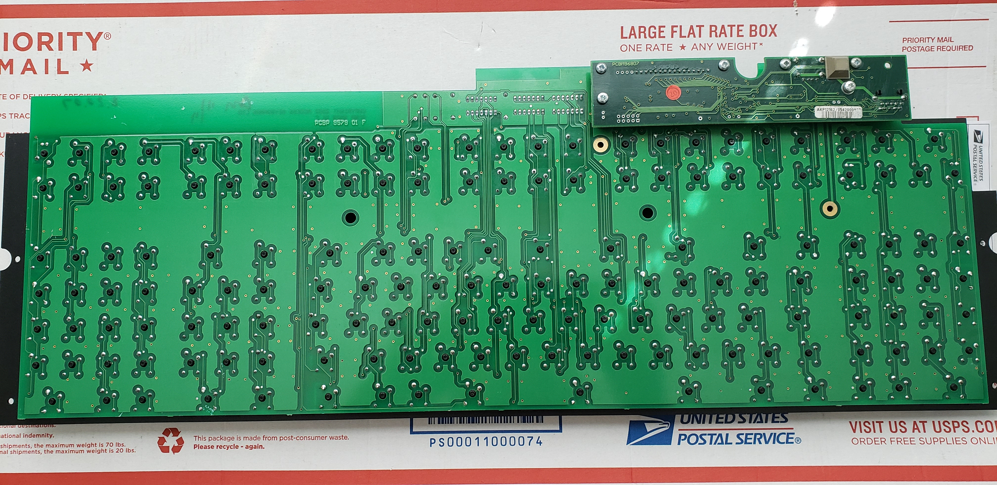

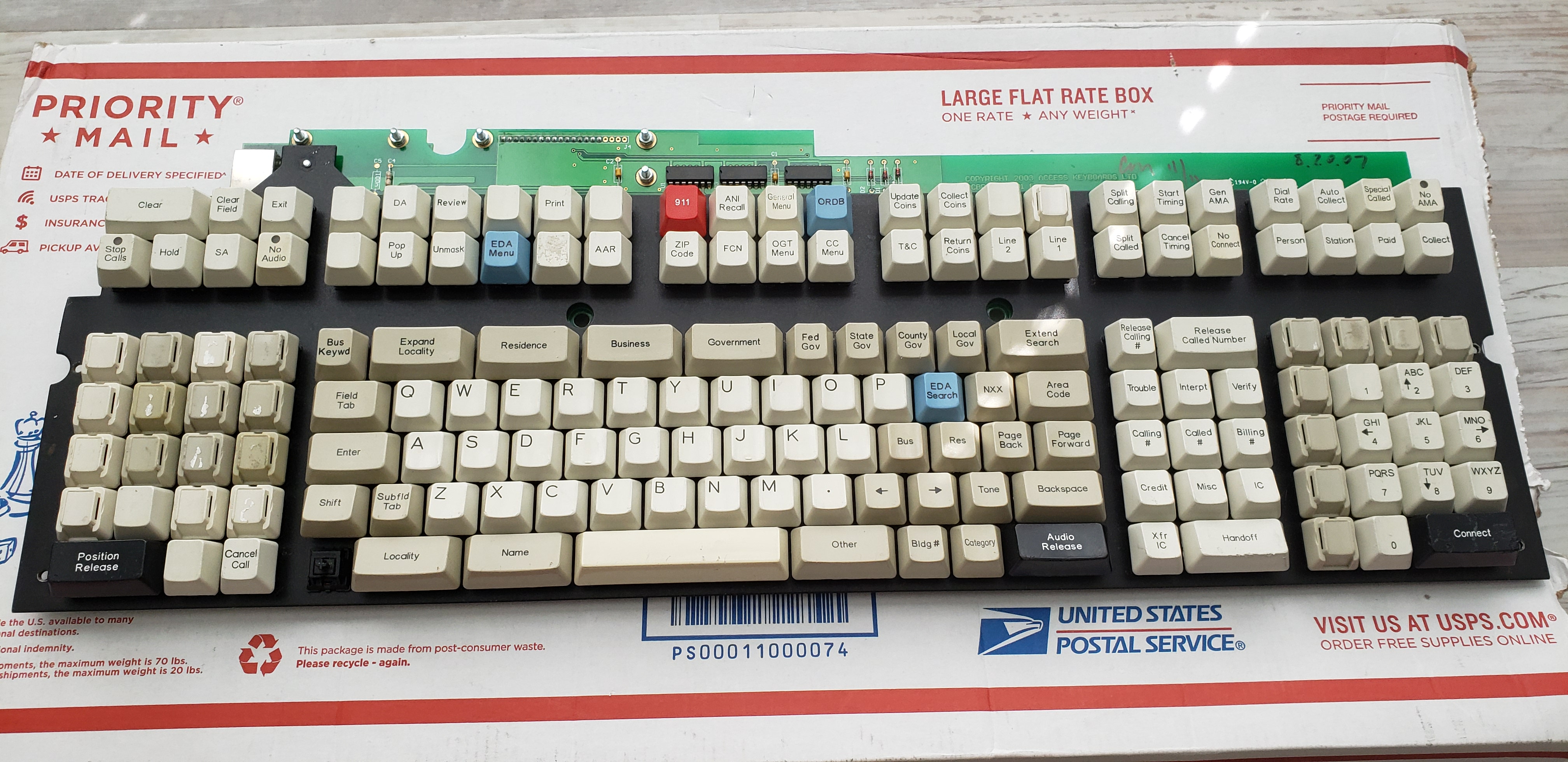

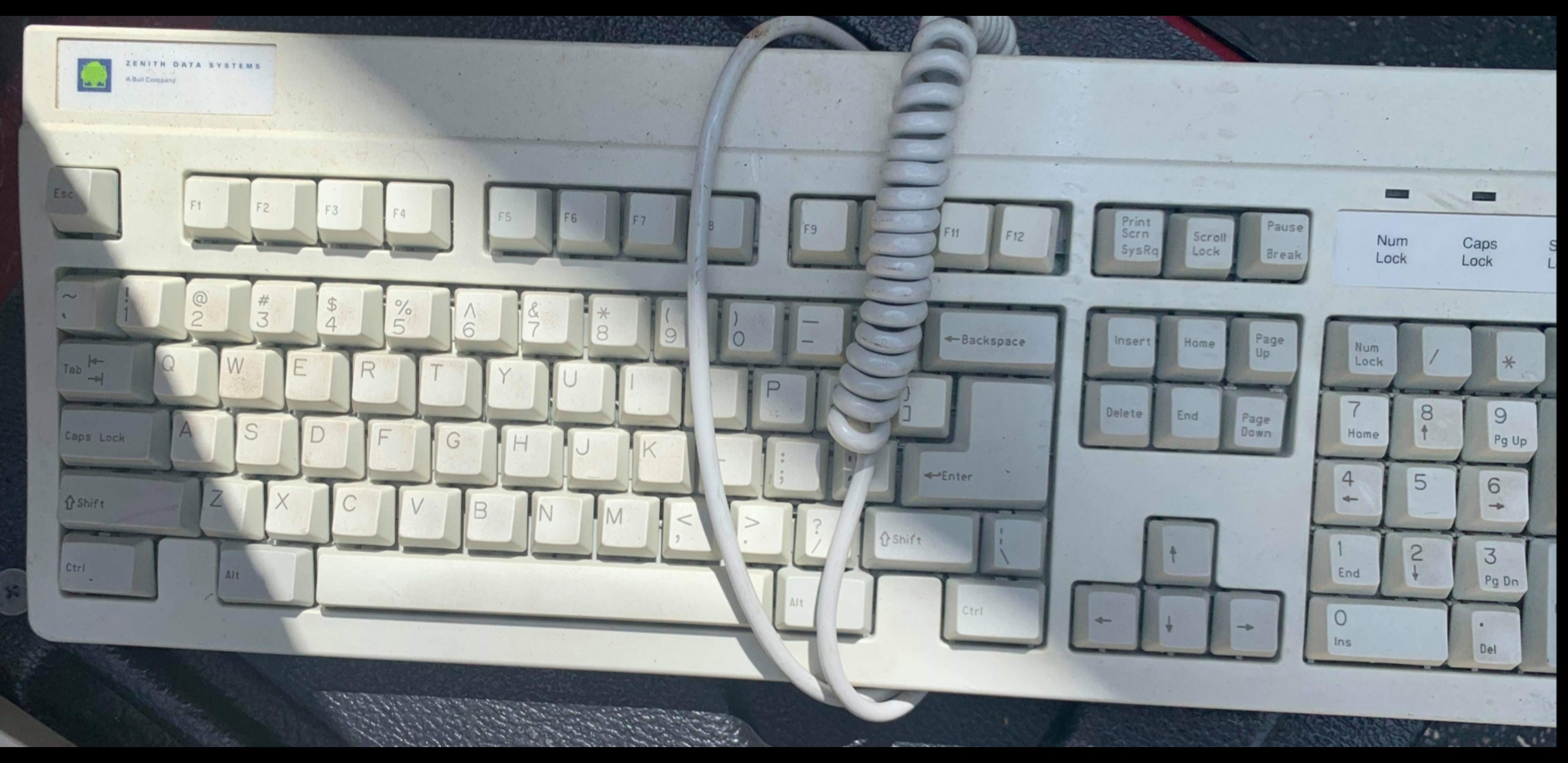

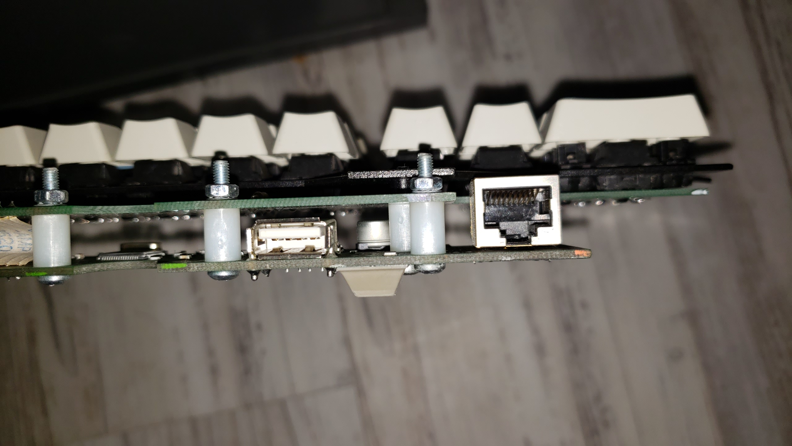

Hello everyone, just looking for some info if anyone has it for this board bought a while ago. I know who makes it, just can't find anything on it. I can take more pics if anyone needs them but this was made by Access Keyboards.
- 20200513_162901.jpg (744 KiB) Viewed 10968 times
- 20190917_112019.jpg (2.24 MiB) Viewed 10968 times
- 20190917_111945.jpg (1.75 MiB) Viewed 10968 times

Welcome on DT.Omegasupreme33 wrote: 13 May 2020, 23:52 Hello everyone, just looking for some info if anyone has it for this board bought a while ago. I know who makes it, just can't find anything on it. I can take more pics if anyone needs them but this was made by Access Keyboards.
As you know the manufacturer, perhaps you should simply ask them whether they still have any info and/or material:
https://www.access-is.com/
And please do contact me if you ever consider getting rid of it - or at least of the "Trouble" keycap
- shine
- Location: EU - Spain
- Main keyboard: F122
- Main mouse: Deathadder Elite
- Favorite switch: Beamspring

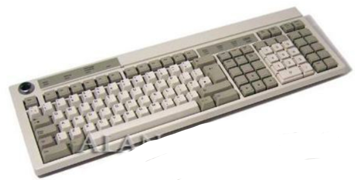

you should open them, look at the model number written in the pcb and update the wiki. Switches on the top one are Fujitsu Leaf spring 2nd generation and bottom are 3rd gen.John Doe wrote: 14 May 2020, 06:13 Got these two fujitsu boards these days, top one is clicky and bottom is linear. Totally no idea whats this, anyone could help? Thanks.
If I get Access to give me ANY information on this and the Trouble key is yours. Never figured to ask them directly because it's not a retail board. I'll keep you updated!kbdfr wrote: 14 May 2020, 07:40Welcome on DT.Omegasupreme33 wrote: 13 May 2020, 23:52 Hello everyone, just looking for some info if anyone has it for this board bought a while ago. I know who makes it, just can't find anything on it. I can take more pics if anyone needs them but this was made by Access Keyboards.

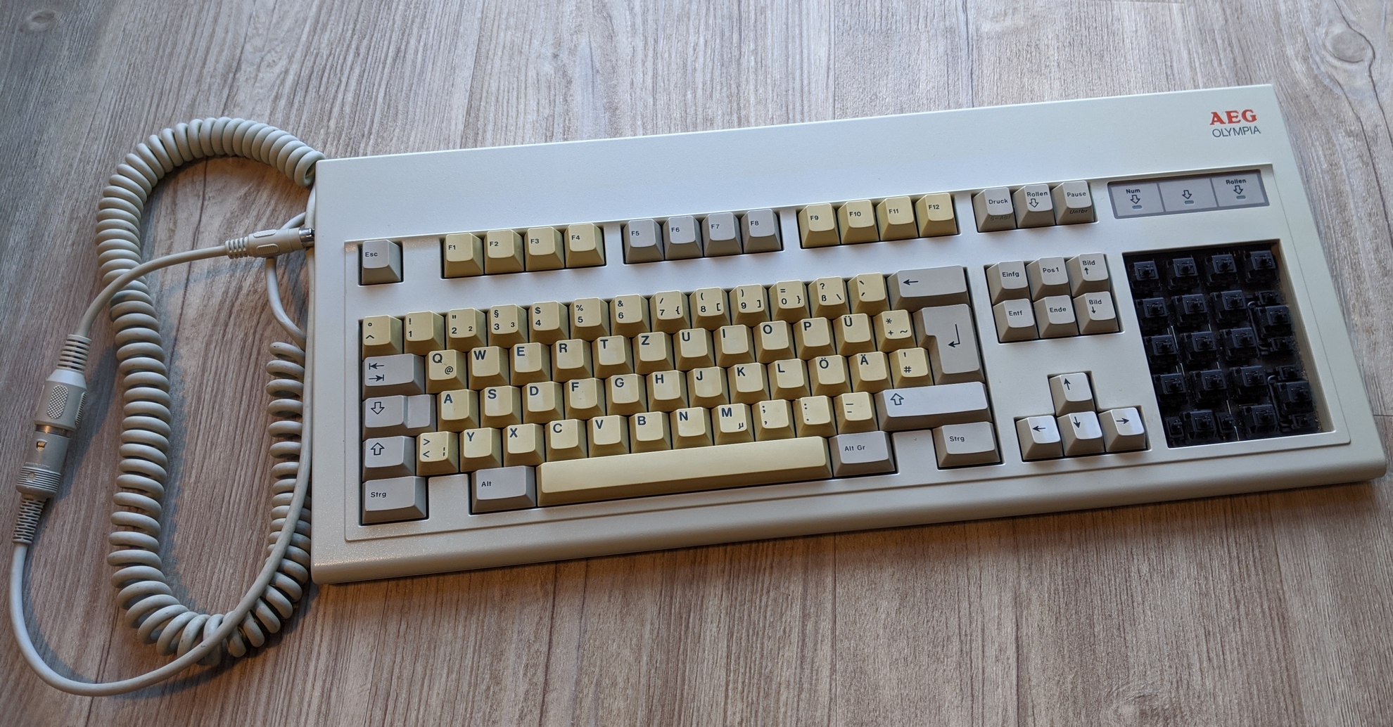

Hello folks,
this keyboard is the reason I registered, i just wanna know more about it, its merits and how to do it justice.
I recently got into thrifting for old hardware and build myself a windows 98 PC, so i can tinker a bit with old hardware and games. Ofc the PC is turning into a exibit piece, and thats where this keyboard comes in.
Its not just any keyboard but a suprising find in my parents house. Its a tool of my late father, who was some sort of earned journalist in Würzburg, Germany. I recall him as always stressed, this keyboard still reaks of his overboarding smoking habits. It works fine, I cant find any flaws. I assume he just put it aside at some point, deemed it outdated.
Its not at all from the age that i am familiar with, the one that has windows key. I understand its an AT keyboard with nice mechanical cherry switches. The keys are easy to remove and clean (which i did with the numpad) i dont really plan to open the case for further cleaning. AEG is a well respected company but not for computer hardware, so the label is an eyecatcher. Im lucky there is still the 5Pin adapter attached.
So is this the quality keyboard it seems to be, or more an average product of its time? What was its time?
Can its worth be put into numbers?
The yellow keys are itching me to dip my feet into retrobright adventures, do you guys think thats a terrible idea?
The case and the greyer keys seem to have no signs of yellowing.
There is some black stains close to the AEG logo i would like to rub off, i did so on other parts of the case. Is the aeg print prone to damage?

Robauke wrote: 14 May 2020, 20:15 IMG_20200514_193701.jpg
Hello folks,

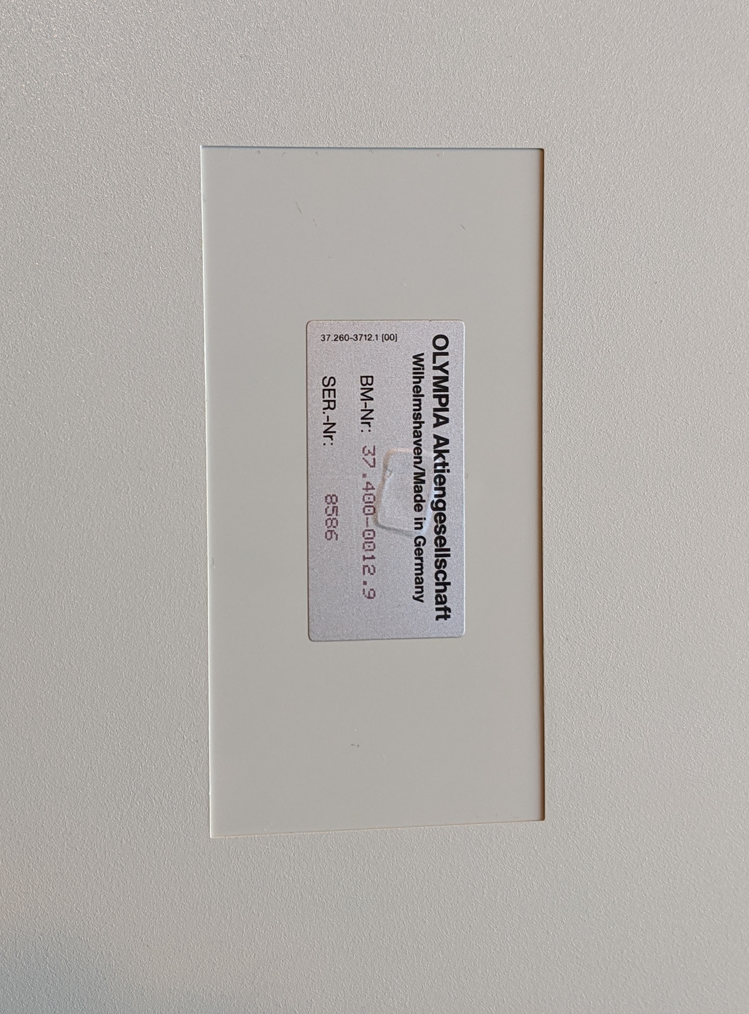

- Your keyboard is obviously a straightforward Cherry G80-1000 with an AEG Olympia branding, the real giveaway being the Cherry-label size of the recess on the back.
- I don’t think i is worth very much, but there are certainly people who would buy it just in order to desolder the swithches, as vintage black switches are some sort of (in my eyes undeserved) hype. It would be a pity to destroy such a nice collector’s item.
- I wouldn't attempt retrobrighting without having first acquired some retrobrighting experience with completely worthless stuff.
Alternatively, you can simply replace the badly yellowed caps with less yellowed ones, which are quite easy to find. - To eliminate the black stains near the logo, you can use a Q-tip moistened with (not soaked in) ispropanol* - gently rub without touching the logo and wipe dry with a kitchen tissue
*not the 70% solution sold under the Hetterich brand in German pharmacies (which by the way is a perfect disinfectant against Covid-19), but pure stuff, which your pharmacy will sell you for a few Euros, perhaps asking first what you need it for because of other possible usages
