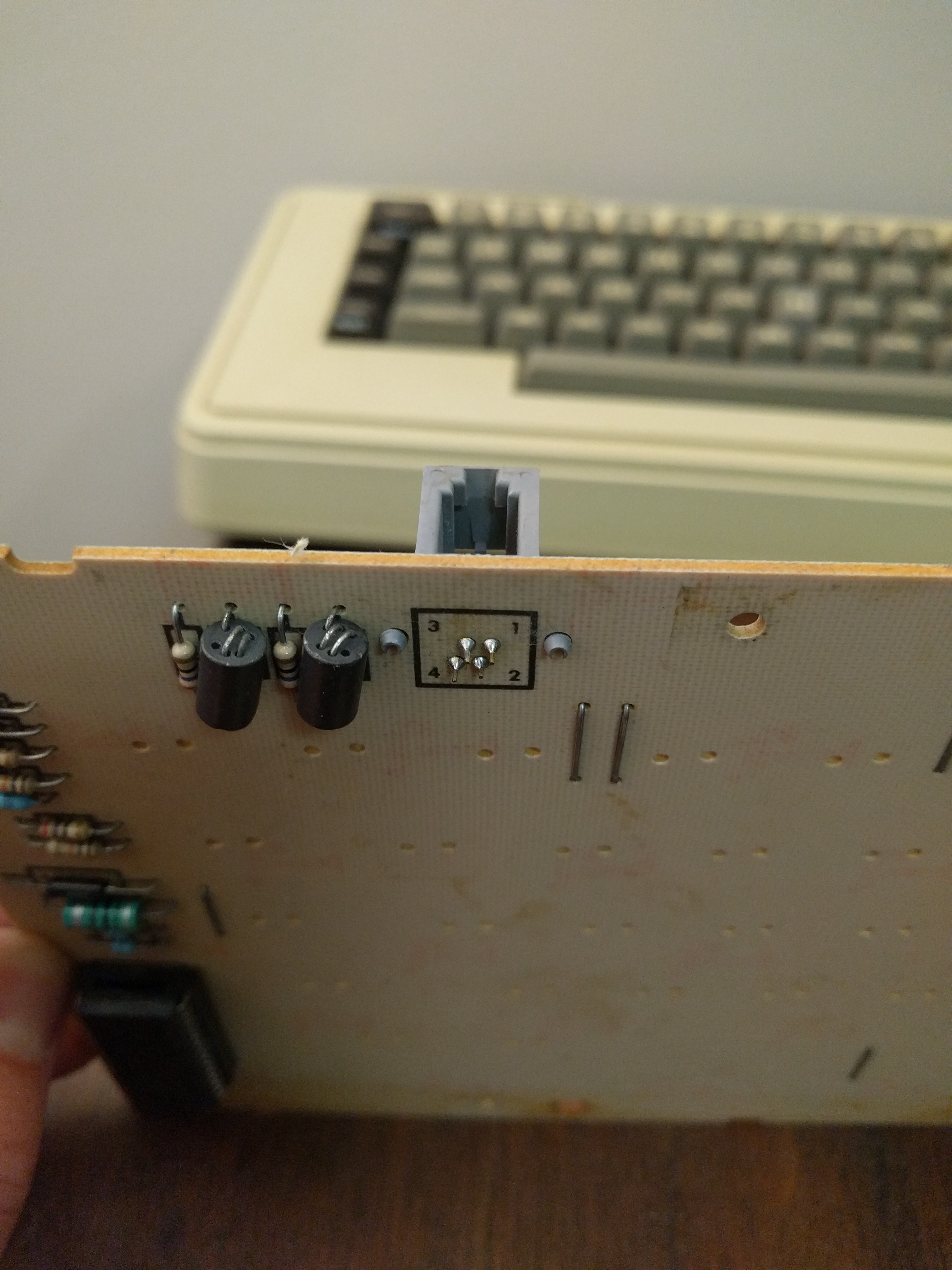

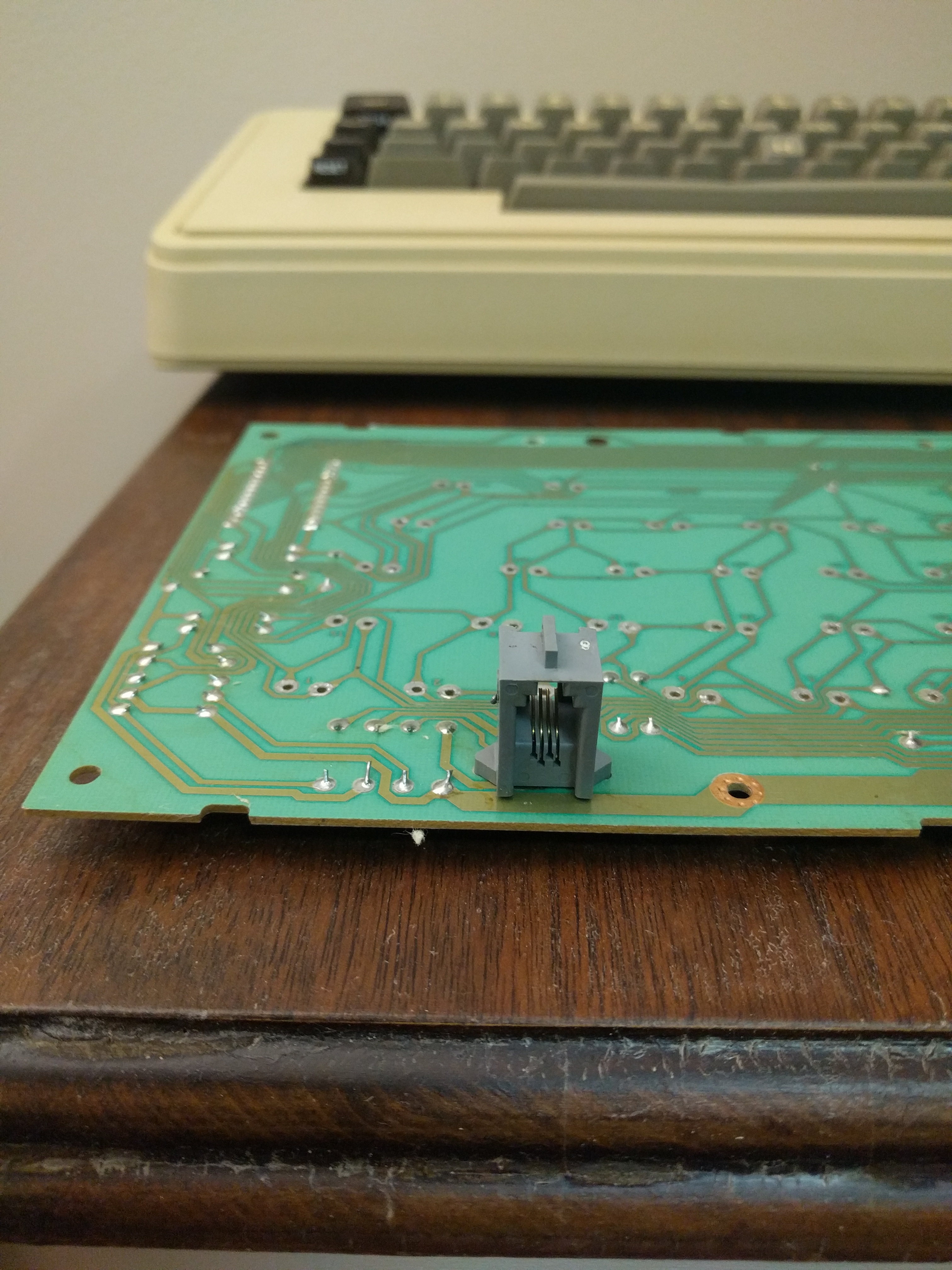

Hi everyone. I recently received Hasu's converter and I am planning to place it within the M0110 case. To do this, I need to rotate the existing connector 90 degrees. I'm guessing I need to keep the 4 pins in the original 1,2,3,4 configuration; to keep them in the same order while rotating the connector, I believe I would need to extend each wire by soldering in an "extension". Does anyone know or can recommend the type of wire I should use? Any other ideas on how to rotate this connector would be appreciated.
- IMG_20190605_211118.jpg (2.55 MiB) Viewed 4437 times
- IMG_20190605_211106.jpg (2.9 MiB) Viewed 4437 times

Isn't there a slot right beside the connector where you could install a discreet micro/mini/C USB connector?

Yes, but then I would have to take my Hasu adapter cable and run it from the back through the second slot and back out again. I'm trying to avoid snaking the cable from outside/inside/outside. Instead, I should be able to rotate this connector, plug in my adapter, and expose the mini USB connector through the second opening in the case.

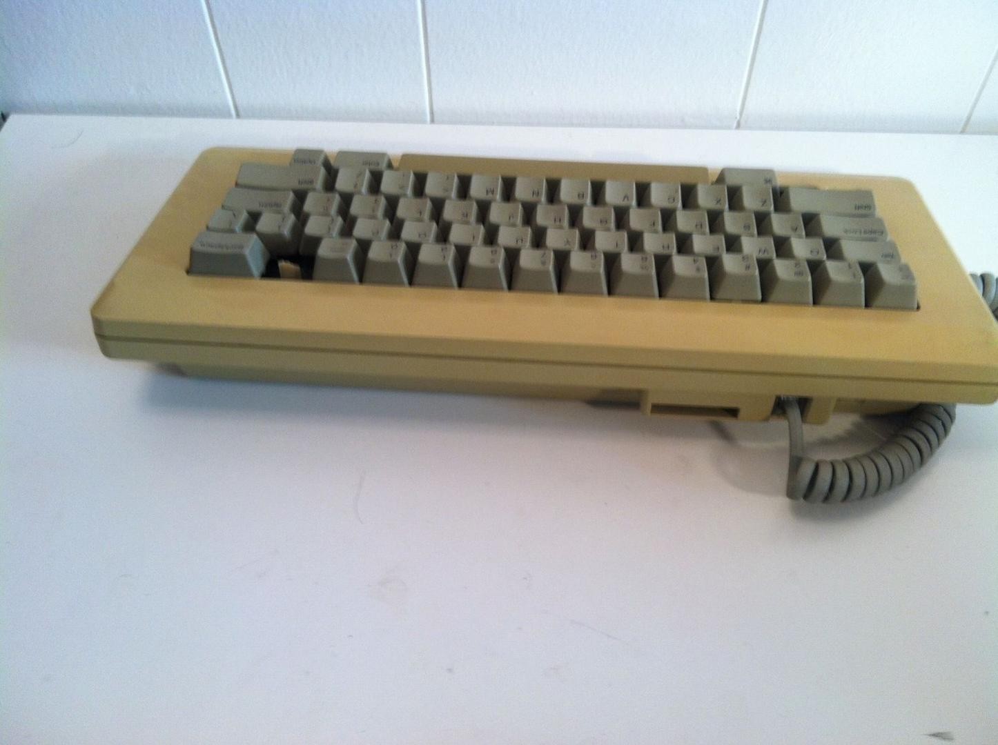

Attached is an example of my board; I would ideally rotate the "telephone" like connector and use Hasu's adapter inside the case. The slot has enough room to slide Hasu's converter in between where I would then connect the mini usb cable.
- apple-keyboard-m0110-macintosh-mac_1_8c3c17a30e3e4b95535cd7e0af07fcd6.jpg (165.14 KiB) Viewed 4406 times

If you're going to desolder the connector to rotate it, why not just solder new wires straight from the (1, 2, 3, 4) holes on the pcb to your converter? (obviously keep the original connector somewhere safe)pumasocks wrote: 06 Jun 2019, 03:16I believe I would need to extend each wire by soldering in an "extension". Does anyone know or can recommend the type of wire I should use? Any other ideas on how to rotate this connector would be appreciated.
