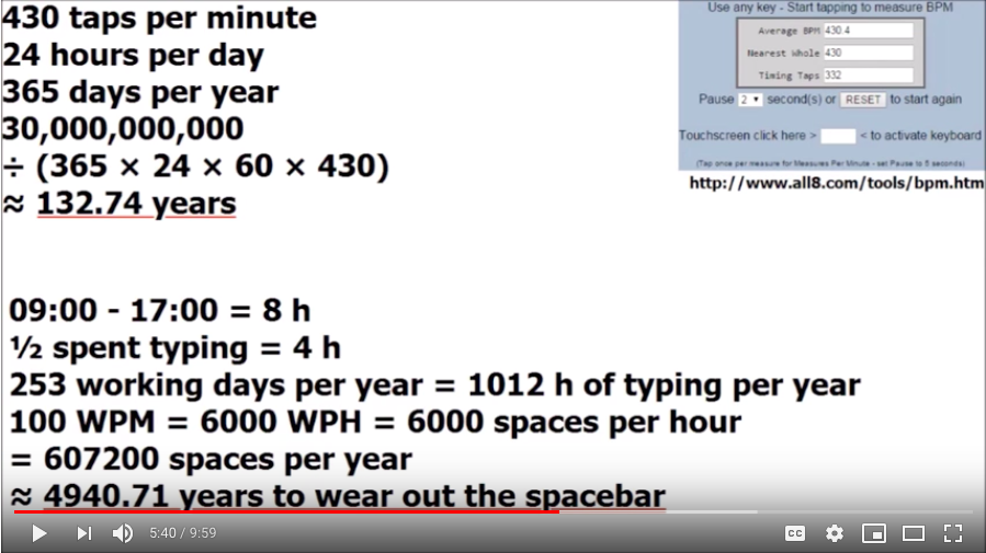

By the numbers, the most reliable in terms of continuing to work (though feel will definitely be impacted if there's industrial dust present) would be Honeywell Hall Effect. They even work underwater! Most aren't super easy to convert to USB if you are working with vintage hardware, but a lot of progress is being made to be sure. Manufacturer spec is apparently 30 Billion presses. There are other "contactless" switches such as optical ones, but I doubt the optical light source will last nearly that long.
See Chyros' video at the bottom where he discusses rated switch life and screenshot taken from it below which describes how it would take almost 5000 working years to wear out just the spacebar (as that's the most commonly used key) and assuming half the time working is spent typing and that the spacebar is being pressed 6,000 times per hour while typing:
Hall Effect Switch LIfe.png (325.55 KiB) Viewed 12234 times
Chyros' full video Here:
https://www.youtube.com/watch?v=37tdDoC7rGA
