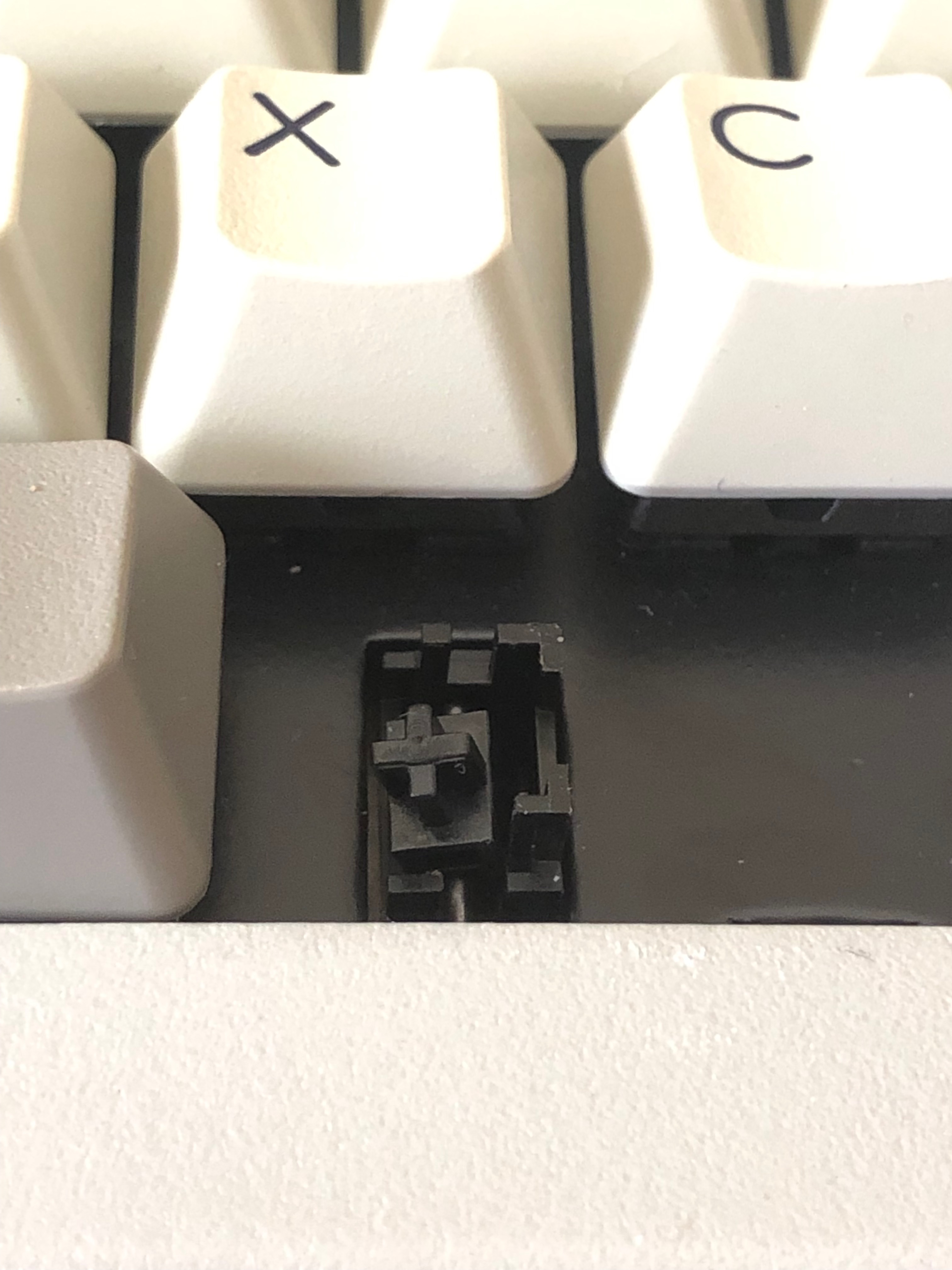

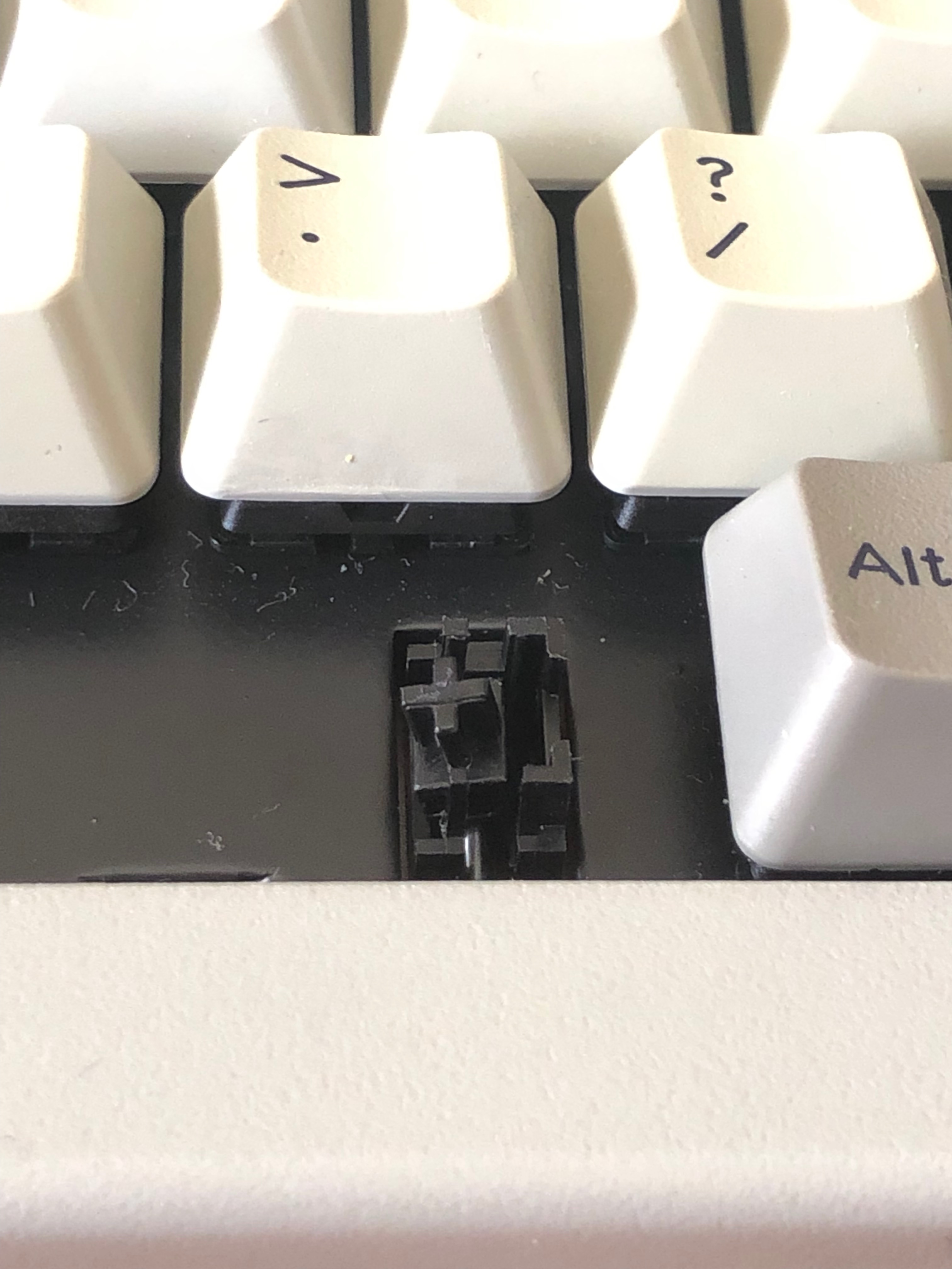

It does feel a little bit wobbly. I didn't notice any obvious cracks, but they do seem to roll quite a bit to the left. This is my first board with these PCB mount stabilisers, so wasn't sure if that was normal. Here are a couple of shots of the stabilisers.

abrahamstechnology
21 Nov 2018, 23:27
njm wrote:
abrahamstechnology wrote: Does the spacebar feel wobbly? If so, it may be the stabilizer mounts are cracked. If not, the stabilizer may just need a bit of lubricant.
lucar wrote: The spacebar stabs are pcb mounted , I did Superlube them as I lubed the stabs at the spacebar joints.
Great video Luca! Really interesting to see your restoration process. Hopefully my Wyse won't need quite as much work :) Thanks for the tip about Superlube, sounds like I should try that first.
Check the keycap itself.
njm
21 Nov 2018, 23:46
abrahamstechnology wrote: Check the keycap itself.
Ah, right. The keycap looks fine, no cracks there.
abrahamstechnology
22 Nov 2018, 00:01
Good, a bit of lubricant on the spacebar stabilizer mechanism and you'll be good to go.
