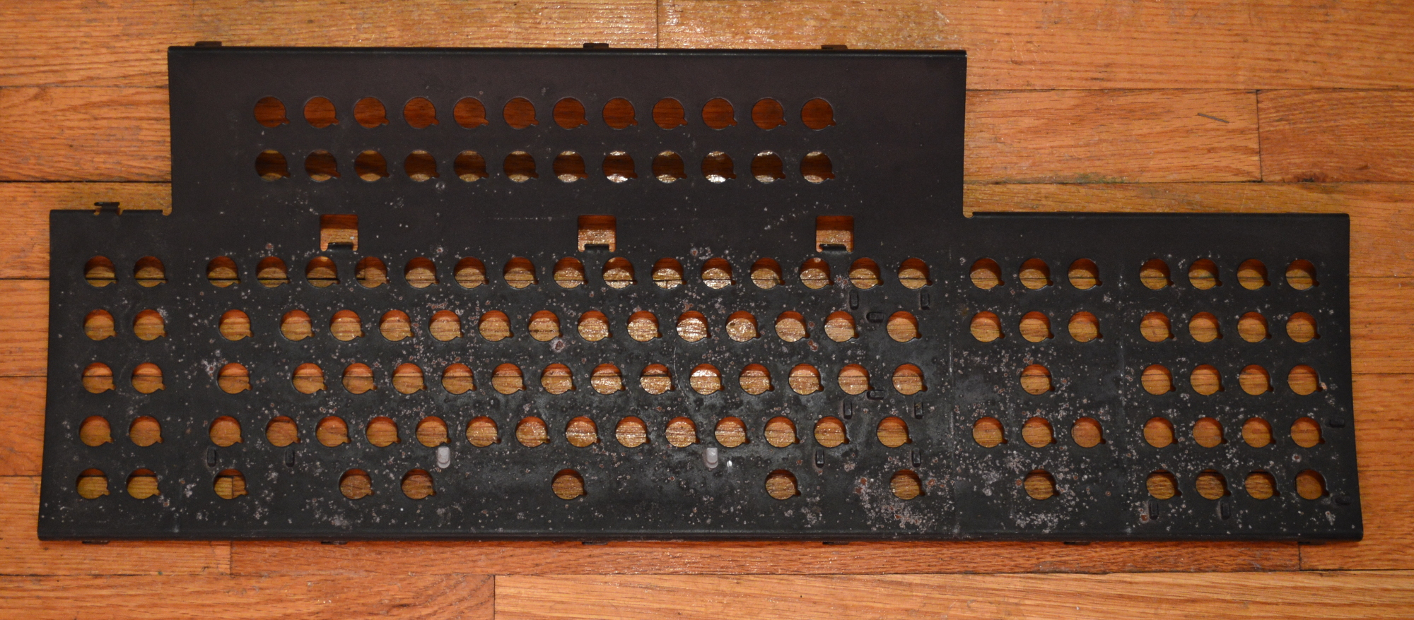

Rusted barrel plate

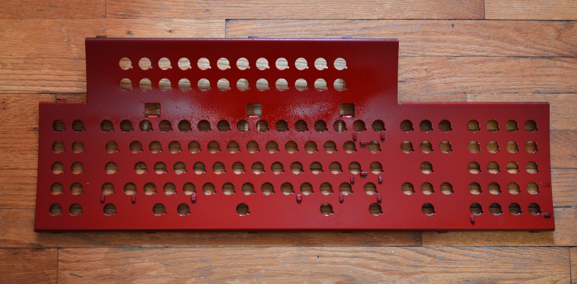

De-rusted and painted the barrel plate
Same job as the back plate but this time I applied 3 layers of Tremclad regal red rust paint. I wanted to give it a little red selectric vibe but as you will see, it doesn't matter, you can barely see the barrel plate with the top cover on.

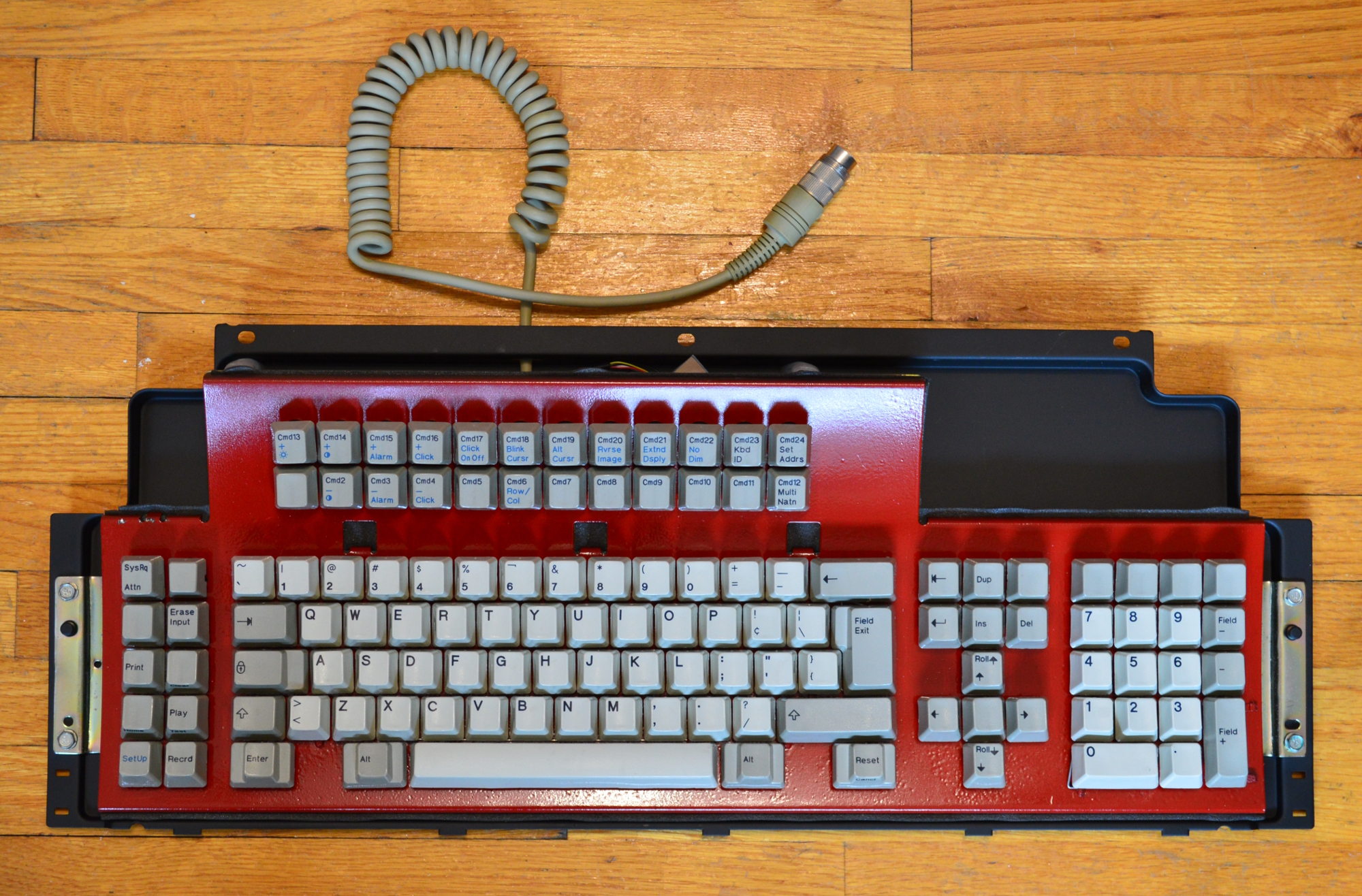

Mostly assembled
Again, I lost most of the pictures but I cleaned every layer of this thing and I kept the original foam for now because it was in good condition. I chipped a little bit of the red paint along the way.

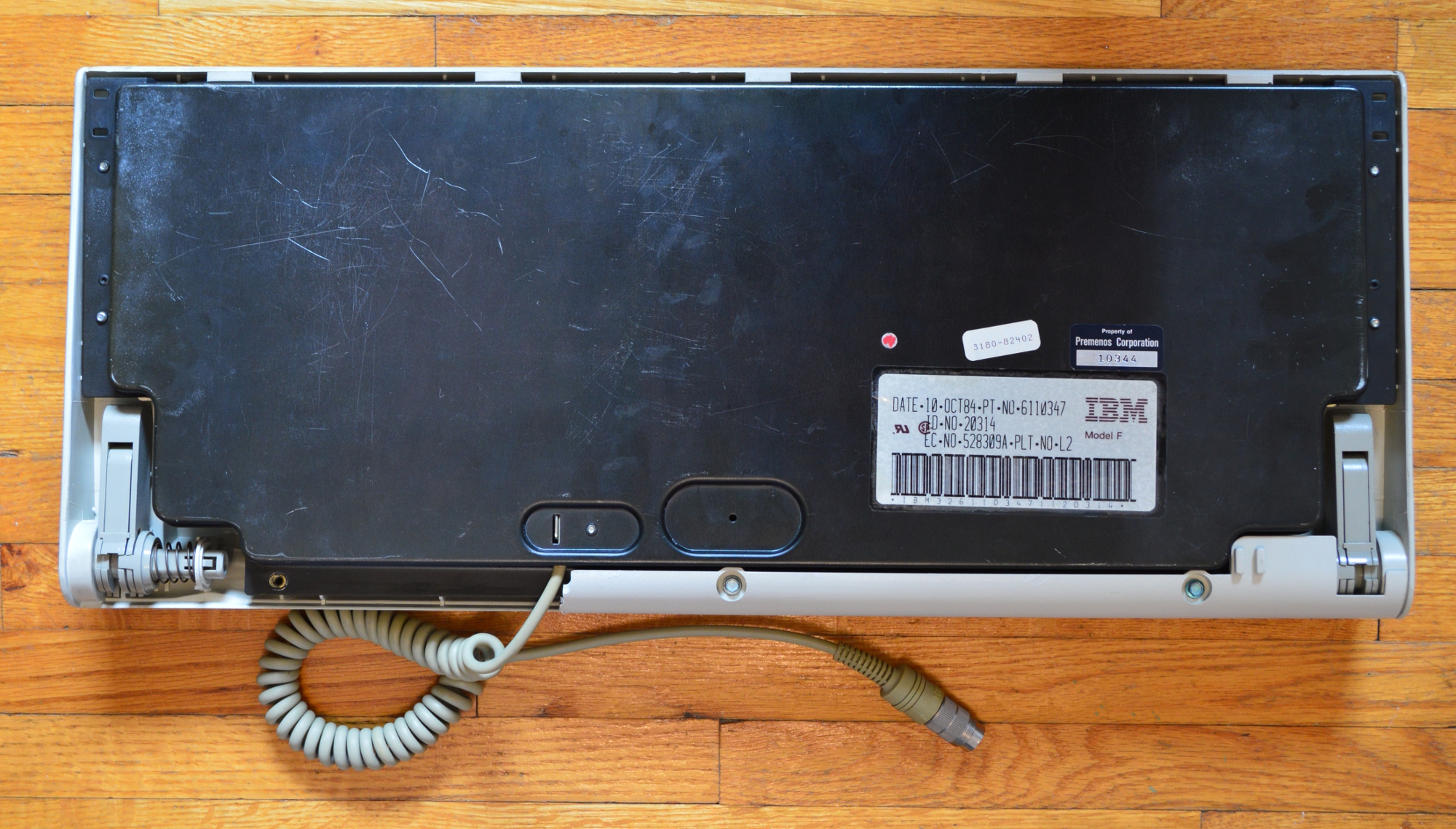

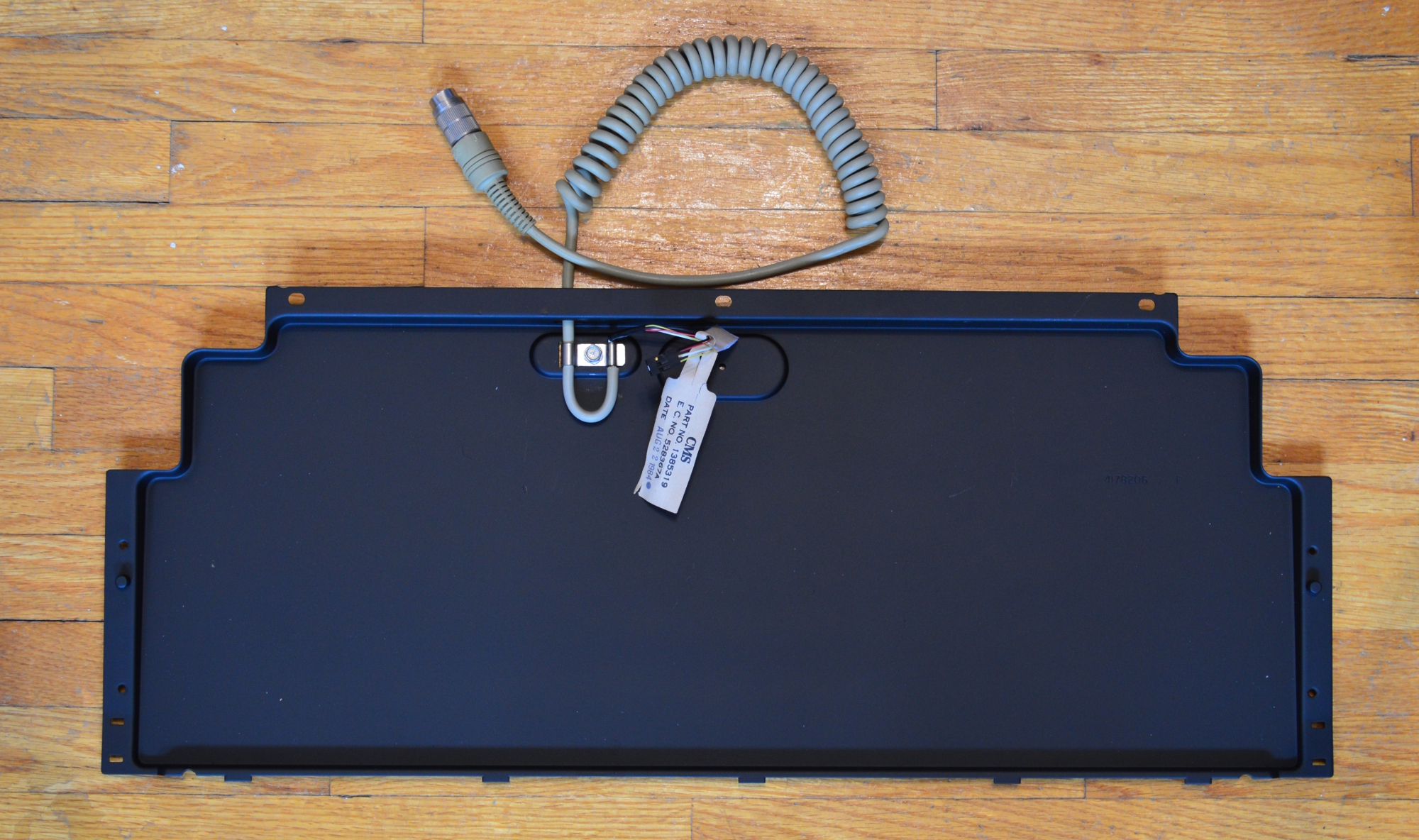

View of the back with the case on
I did not paint the exterior of the back plate but I feel like I should. However, I don't want to risk painting over the label.
Also, as you can see, there is a broken plastic part and a screw is missing.

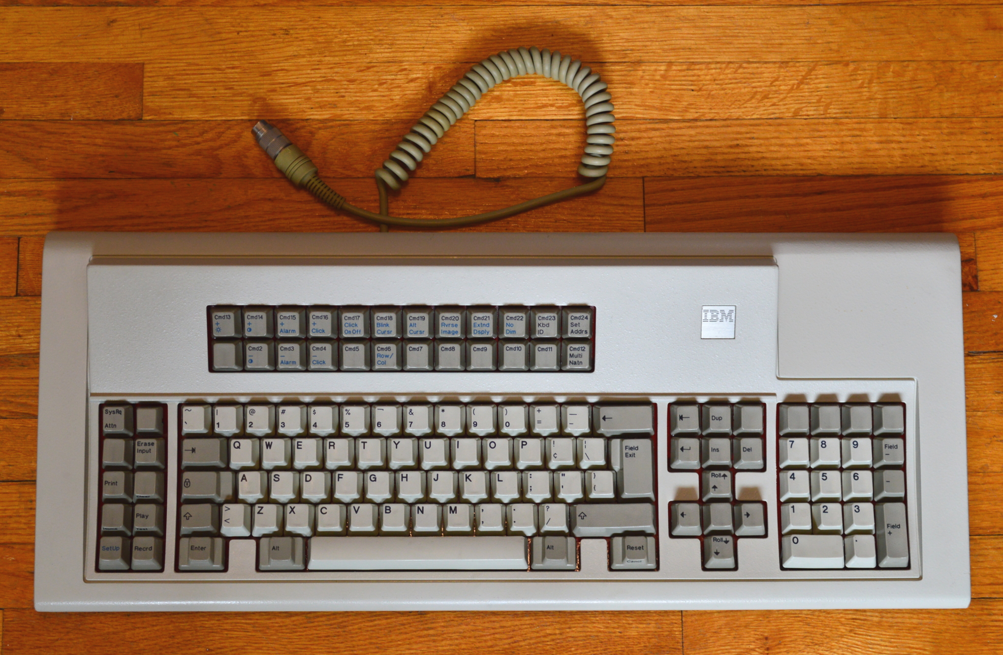

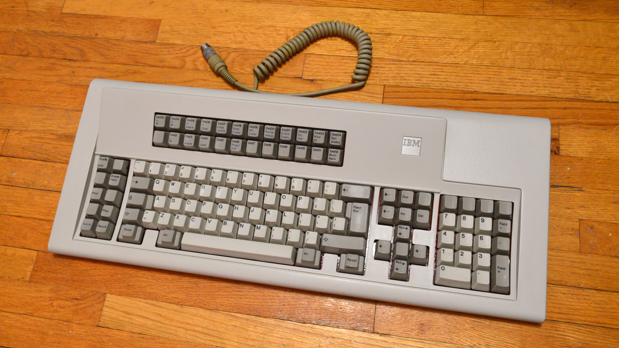

Glamour shot #1
Glamour shot #2
That's it! I am done with the keyboard for now but the restoration is not completed yet.

For the label, if you are set on removing it to paint the back, I'd suggest trying and remove it with some heat and a lot of careful efforts, but I'd practice on a Model M first since you only get one chance. The other option is just taking a lot of care to mask over it and spray in very thin coats so it doesn't wick under the masking tape. Or not painting it at all and leaving it stock.
I can't remember if the early M122's have the separate plastic bar there or not, but I'd suspect that that is specific to the F122 and it's going to be hens teeth to find. Kind of like back when F122s were nearly worthless if they didn't have spacebar because the only other spacebar that would fit was from another F122.
IIRC, those screws are different from a Model M as well, but it's been years since I opened my last remaining F122.
[Edit: yep. the M122's got a complete plastic bottom. You might be able to dremel out the plastic bit in the back, though]

Cindy may well have one of those back splines. You can replace screws but the heads will probably be different, Philips-head is easiest. Fs have metal sleeve inserts and use machine screws, while Ms have screws that are more like wood screws with aggressive threads.
I have painted the backs using a mask made of clear plastic and clear plastic tape so that I could get it as small as possible and position it exactly.

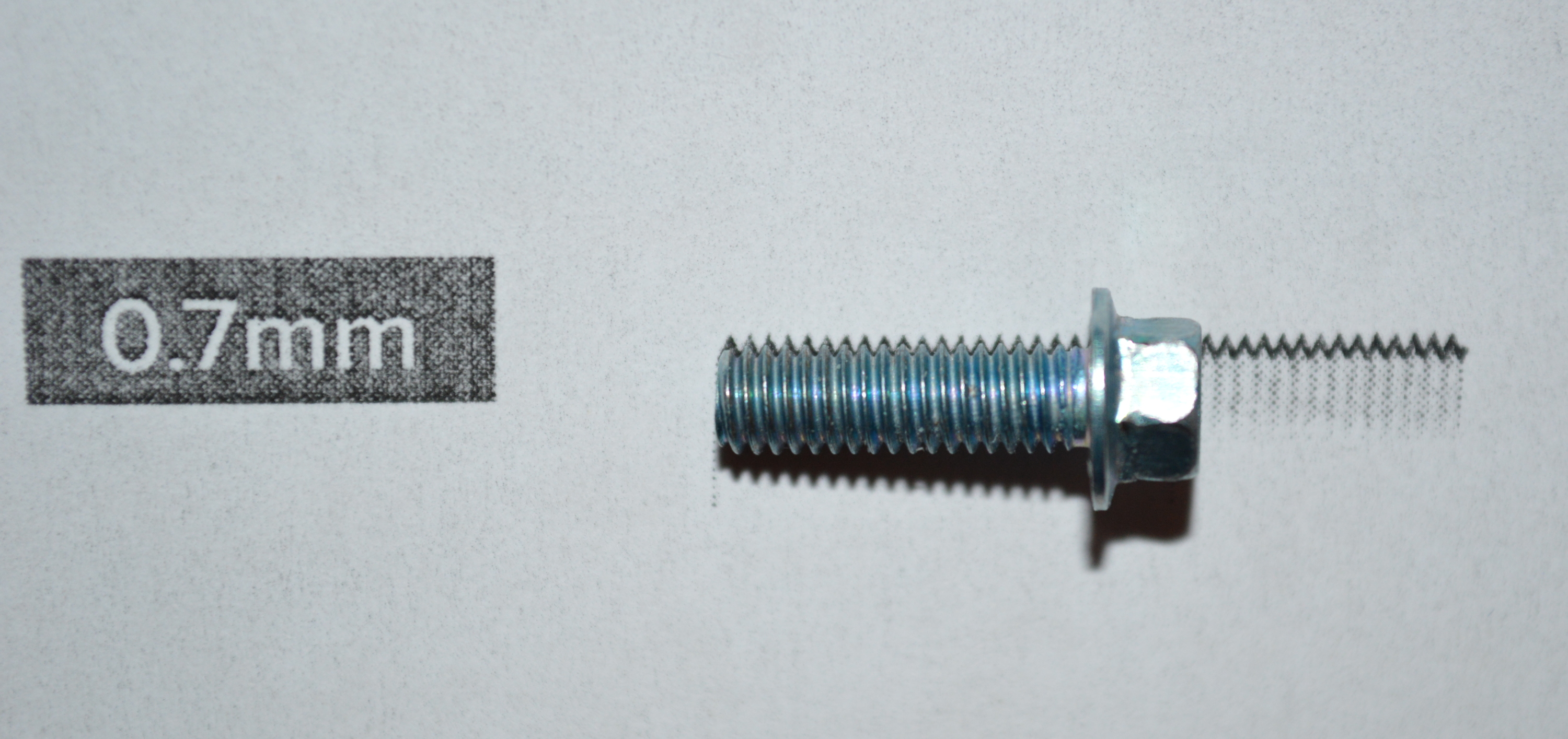

fohat wrote:You can replace screws but the heads will probably be different, Philips-head is easiest. Fs have metal sleeve inserts and use machine screws, while Ms have screws that are more like wood screws with aggressive threads.
I will try to find a perfect match for the screws:
  • Machine screw
  • 5.5 mm (7/32 inches) hex head
  • 17 mm long (including the head)
  • 7 mm pitch
Here is a picture I took to validate the pitch of the screw.
