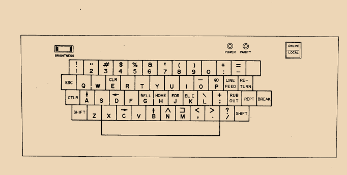

I think this is related to the Beehive MiniBee, look at page 13 in this pdf:
http://bitsavers.org/pdf/beehive/MiniBee_Svc_Mar74.pdf

Awesome for finding the manual. This keyboard actually has no controller, but instead there are logic gates up above the switches. I had reverse-engineered the entire thing but then lost my work. It is 1KRO I believe.
