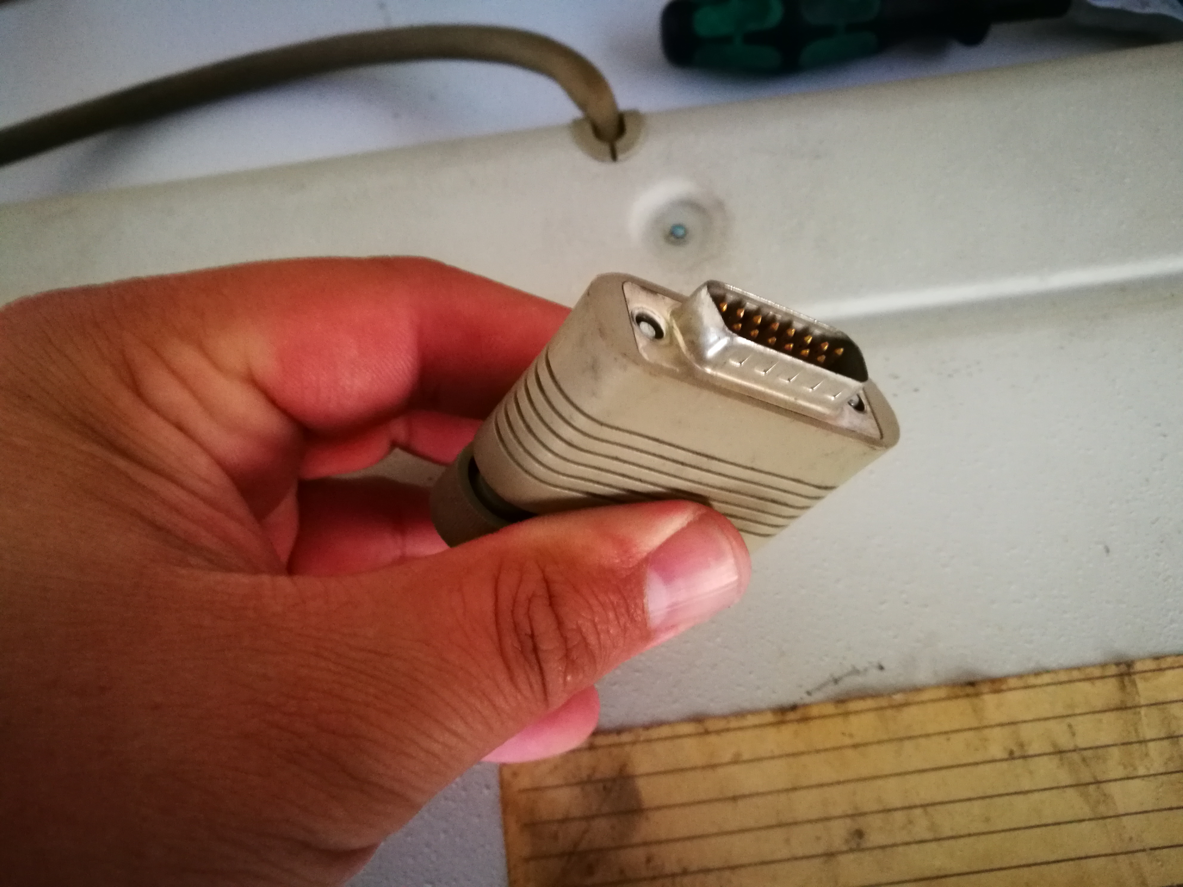

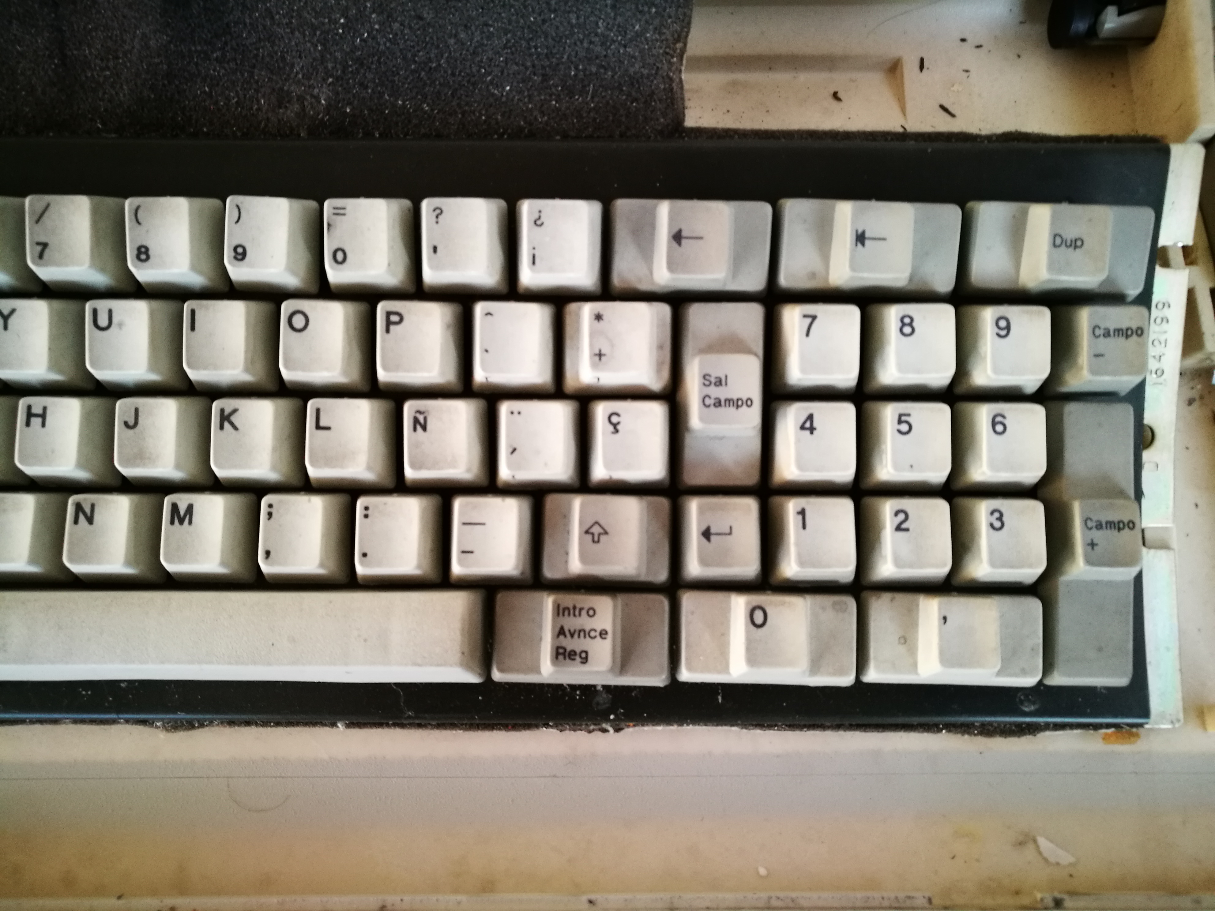

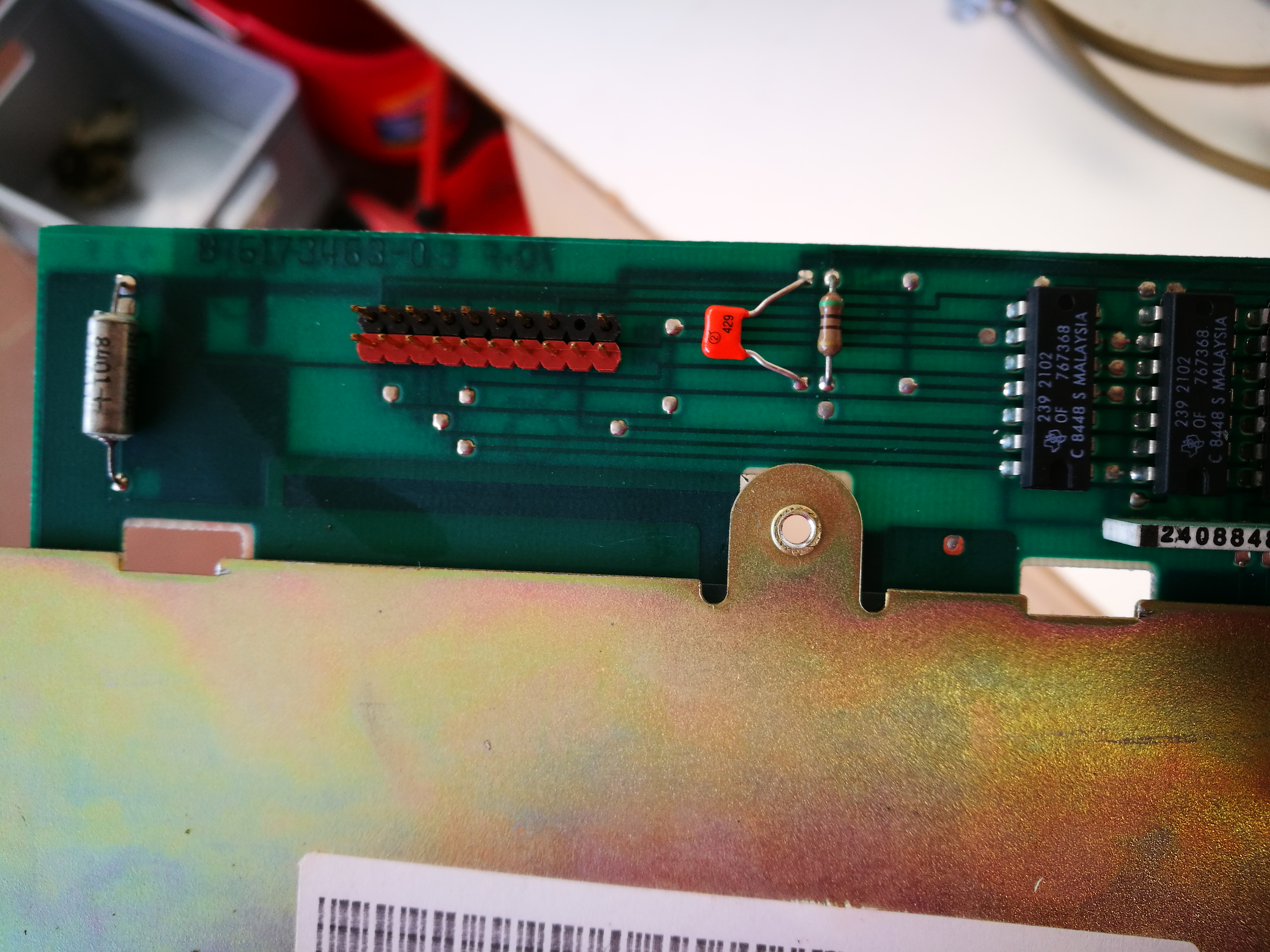

I am restoring an ibm model F keyboard and I do not know how to connect the motherboard pins with teensy 2.0. There is some scheme The keyboard output is 15-pin or game port

Hello mpereiro,

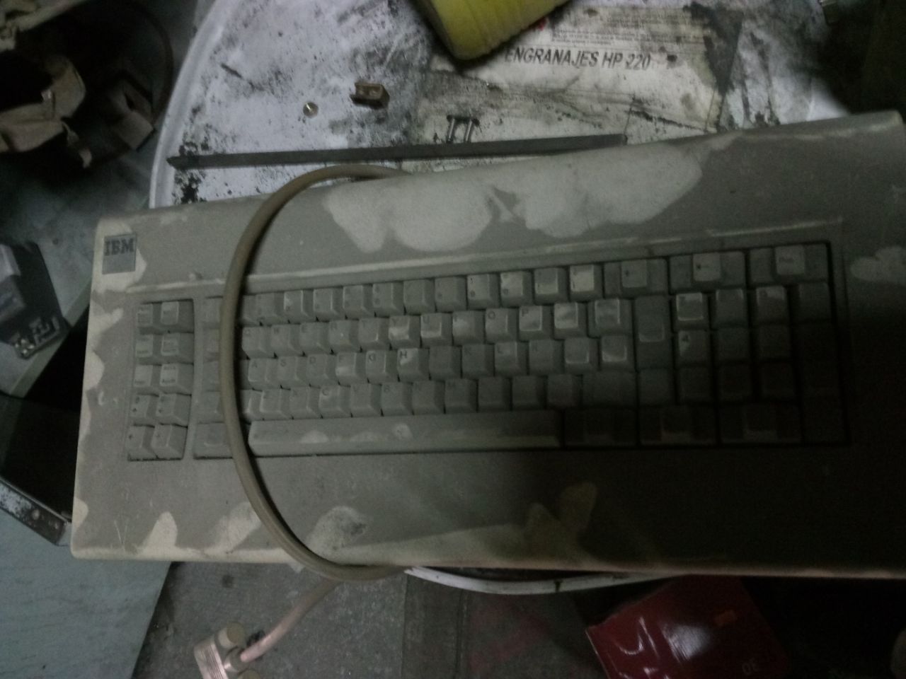

what kind of IBM Model F is that exactly you have? Is there a sticker on the back? That connector looks like the one on my bigfoot. Show us a picture of the keyboard if you're not sure.

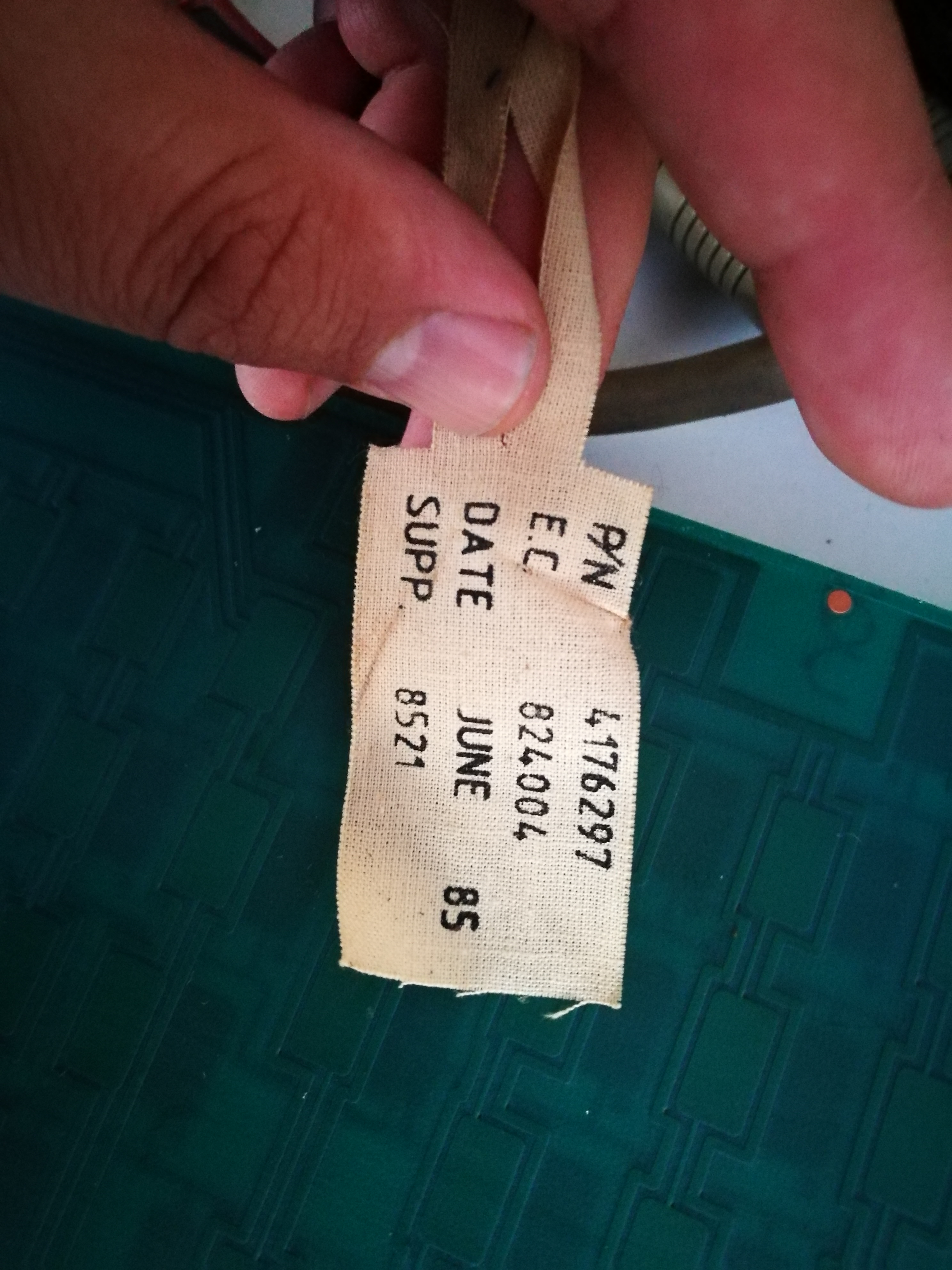

I think it's a bigfoot.

Wow that's dirty.
Can't find the exact pinout, but I know I have seen the board pinouts for where the connector goes into the controller board. Regardless of connector, you have ground, data, +5 and clock pins on that connector on the inside. If you want the easy route, remove the old cable, put in a USB and hook up the Teensy inside, soldiering the pads to the board-end of the original cable.
Someone have the pinout?
Yeah, going to be doing just this for a Model M.
If you have a meter, you can do a continuity test for the individual pins on the original cable to clock, ground, 5v and data and build a box for the connector end (if you want to keep it 100% stock). But that requires a meter. And receiving connector. And a box to put all the jazz in. And that all assumes the cable is in good enough shape.

Here you go mpereiro:
workshop-f7/ibm-model-f-bigfoot-with-ar ... t9418.html
If you use our search function you will find more information useful to you.
