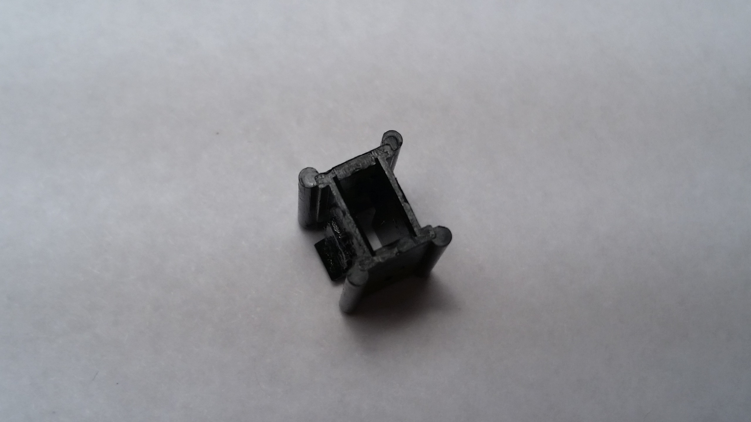

I always thought there was only one variant of BTC dome with sliders. Apparently I was wrong :P
I've noticed that many of the newer BTC keyboards use these rectangular sliders on the stabilized keys, likely to simplify the chassis construction and cut manufacturing costs.
I've only ever seen these sliders on BTC keyboards. The earliest example is from 1999, whereas the newest example is as new as 2005.

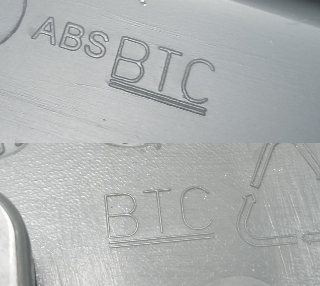

I wasn't entirely sure that these were from BTC until I opened up the keyboard, where I found BTC printed on both the top and bottom casing. The example also had a very BTC-like FCC ID, starting with E5X. One of them even has the iconic 1.25u Esc key that BTC is fairly well-known for.

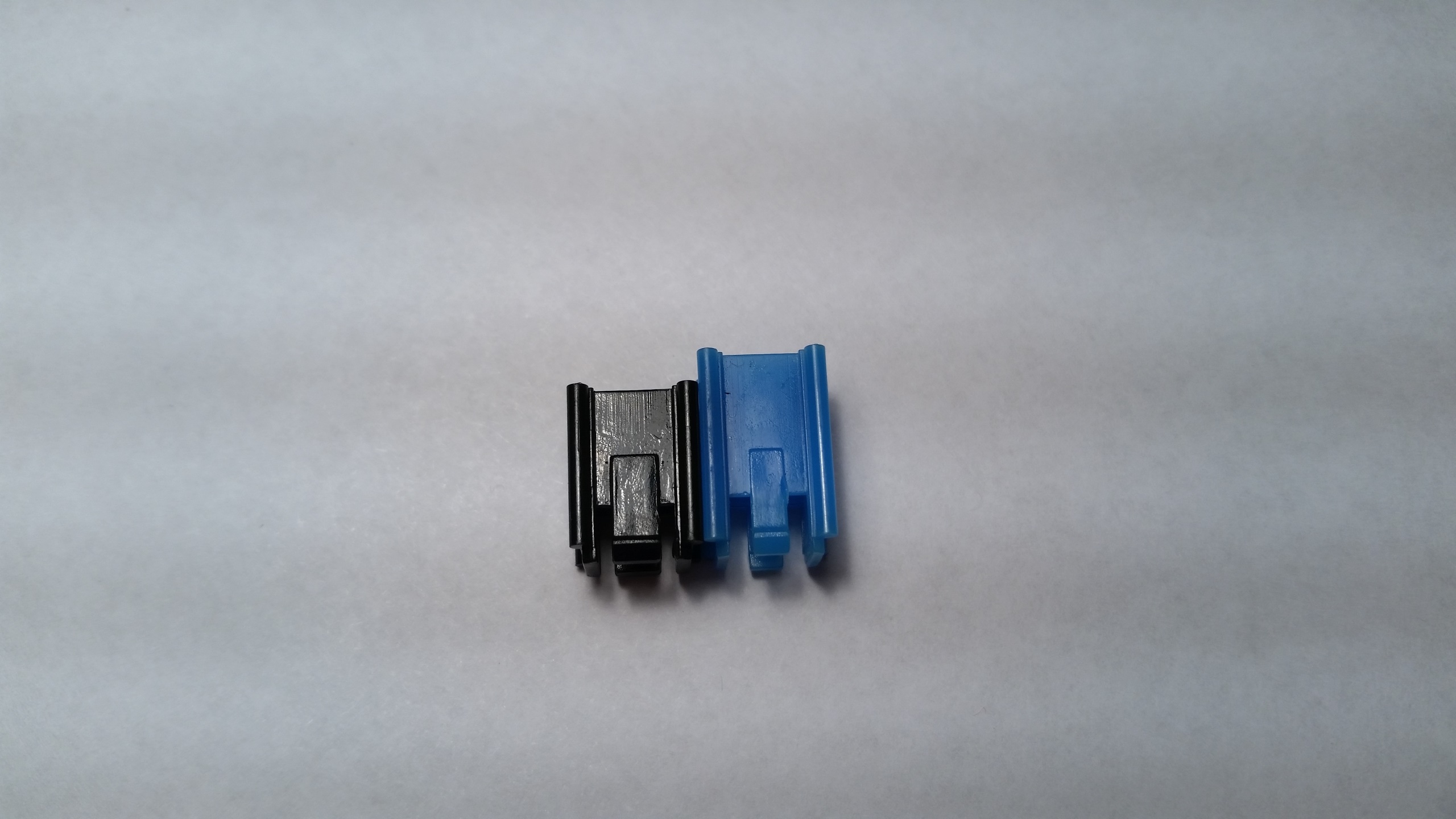

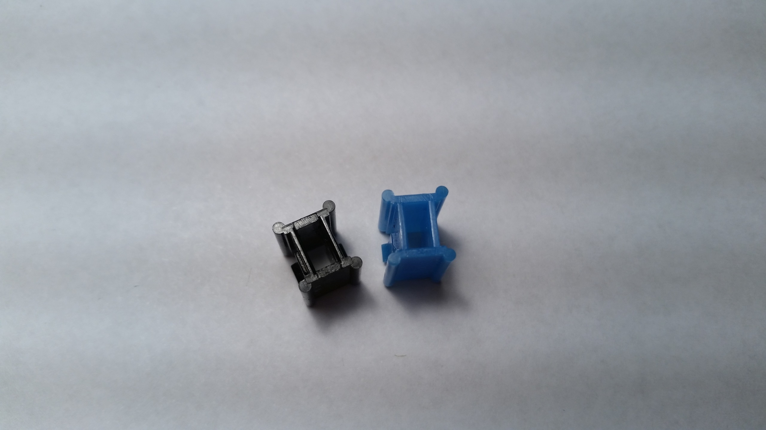

I also found these blue sliders in a much older BTC eKB-5190, which appear to be significantly longer than the newer black sliders:

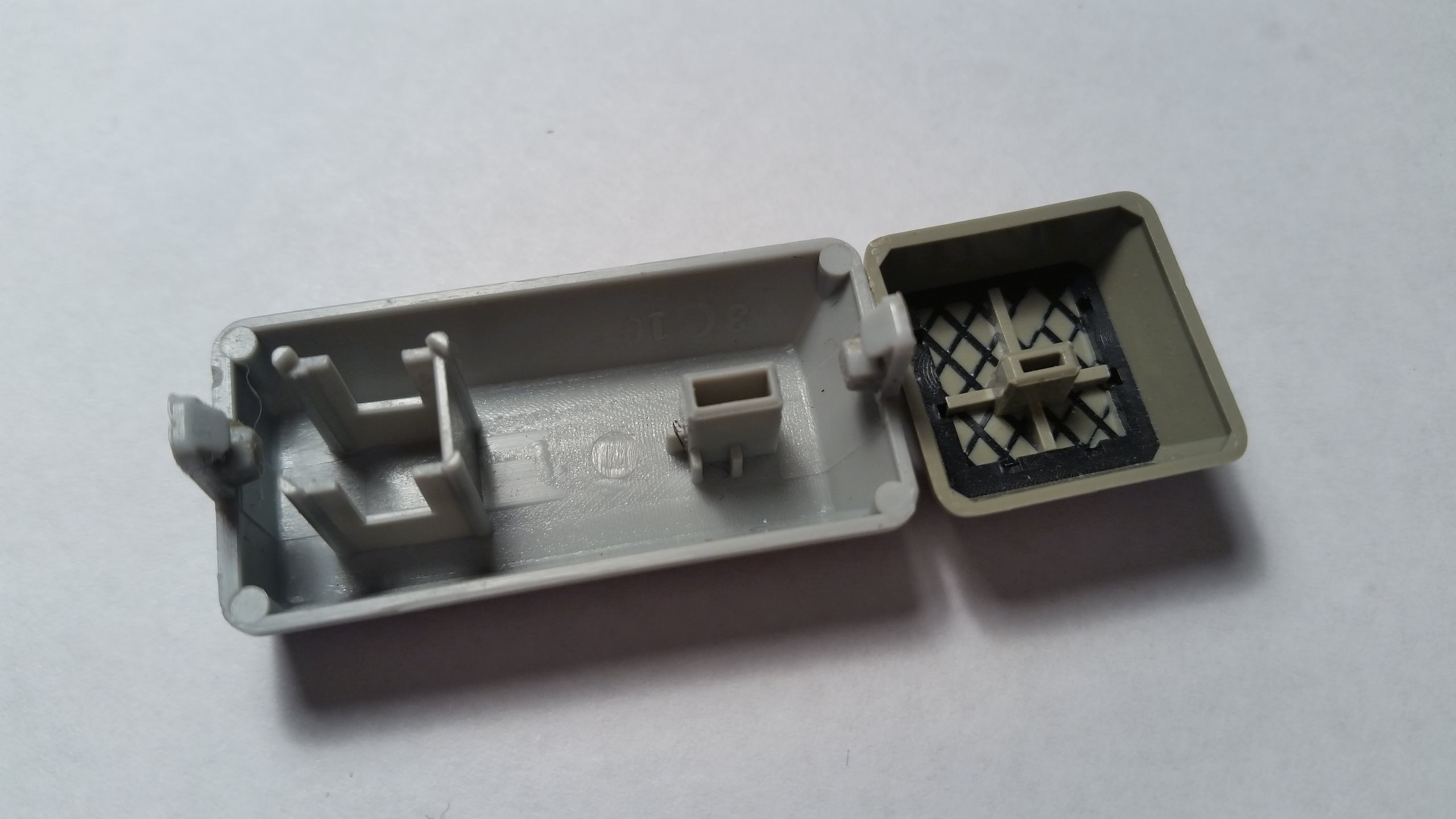

As for the keycap mount, it looks as if it might support Alps keycaps, but unfortunately it won't. :( It's a different size altogether, and the slider is rotated 90 degrees, so even if it did support Alps caps, you'd have quite a hard time typing on sideways keycaps. Unless that's your kind of thing, of course.
Overall, this is something quite new to me. Are there any examples of these switches being used in an entire keyboard? Is BTC the only manufacturer that is known to use these switches?

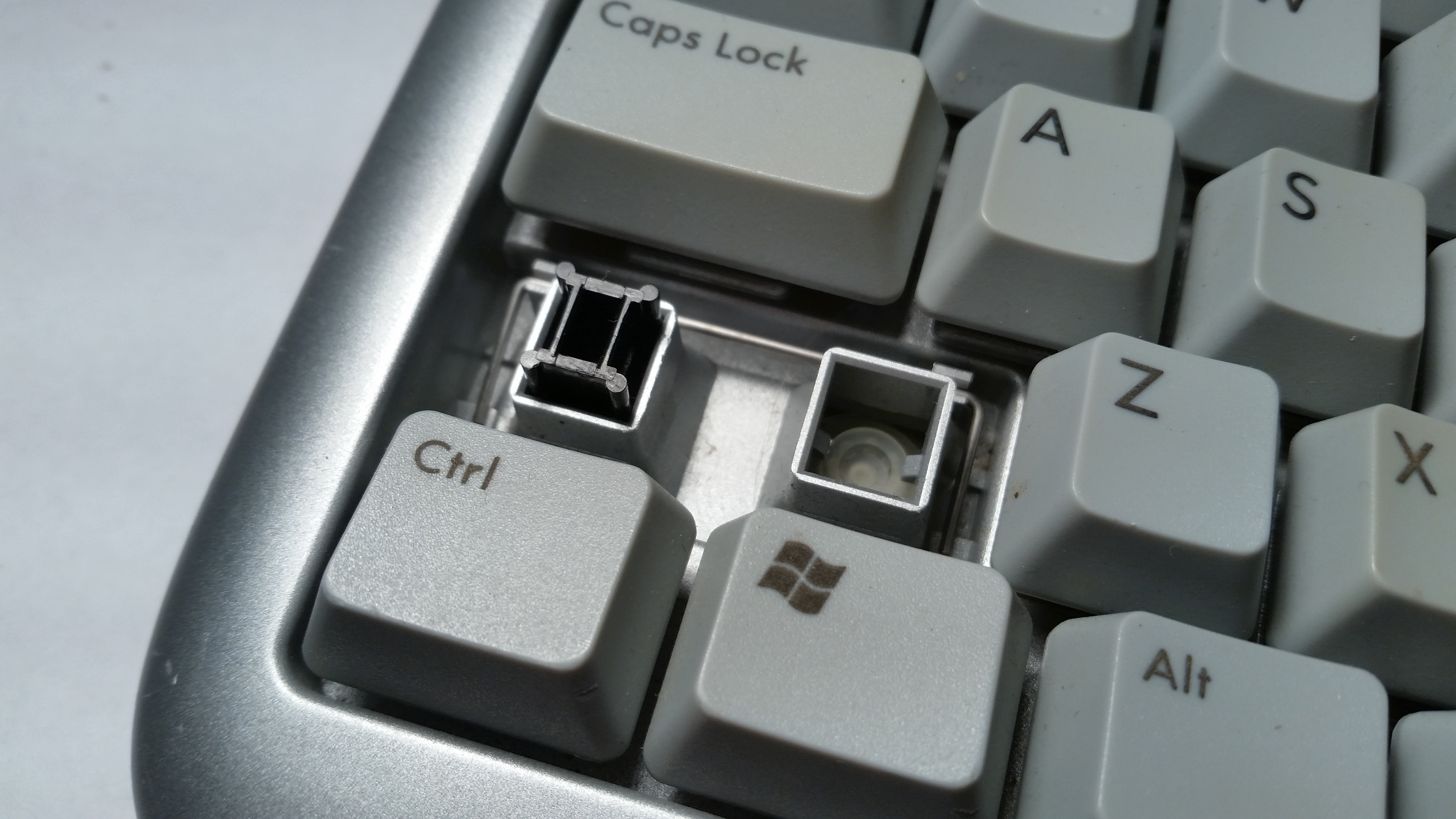

That's just the stabiliser, isn't it?
keycap
11 Jan 2017, 03:03
Not really, the key otherwise doesn't work without the slider in place, and there is already a stabilizer bar present on the first picture.
emdude
Model M Apologist
11 Jan 2017, 03:18
It looks like a stabilizer insert to me as well. Isn't that left shift key in your first photo actuated by the dome to the right of the slider?
This stabilizer setup looks pretty reminiscent of the one the Model F AT BAE used.
keycap
11 Jan 2017, 03:56
Nope, that other dome acts as the > or \ key that you'd see next to the left shift key on an ISO layout. It's actually the opposite; the slider integrated into the keycap (not the rectangular Alps-like peg) acts to stabilize the keycap and does not register a keypress without the black slider. It looks like it might be able to press down on the dome, but it can't.
