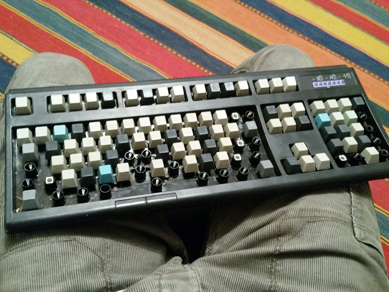

I've a couple of questions about the unicomp model m with trackpoint if somebody has experience with this keyboard:
1) I noticed that the caps under the covers have strange and different colors: is that common/normal and maybe why? :)
unicomp undercaps

Yes, that's normal. And normal for younger IBM/Lexmark Model Ms as well, from what I can tell from my Model Ms of various years. IBM seemed to start doing this in the early 90's before handing things off to Lexmark. I'm guessing it's a cost-cutting thing.
At least when IBM and Lexmark started to do this, they used plastic of various shades of gray for the stems; Unicomp looks like it uses whatever scrap plastic it has. :P

15 Mar 2016, 23:50
I see.. well hope it's still better than chinese reused plastics.. ;)

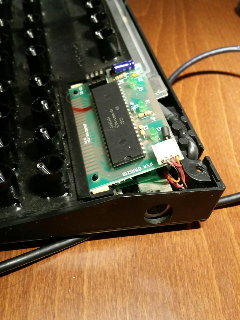

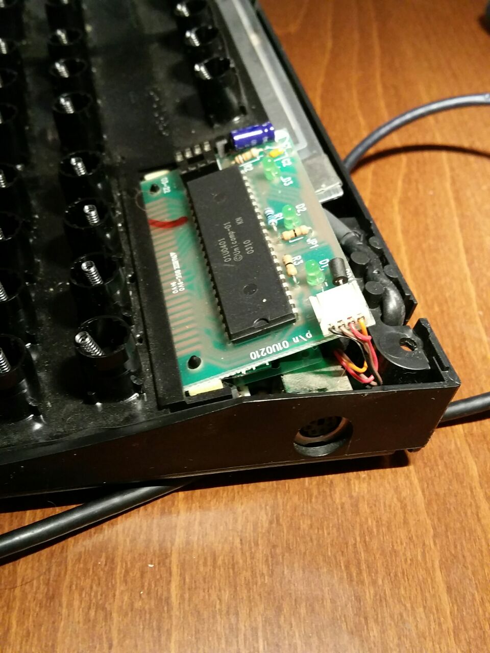

the ps2 socket is this one btw (not sure M13 has this as well..):
and I'm in the process of opening it at the moment.. I'm not sure about how to unmount the metal plate.. do not see any obvious screw halting it together with the case..

I believe that the PS/2 port is indeed intended for a mouse if you so desire.
Although it would be nice (and I don't expect it to happen) if Unicomp bothered to swap it out for a USB port. :P

Yeah the M13 doesn't have one of those.
emdude
Model M Apologist
16 Mar 2016, 08:08
It looks like the original Japanese "Endurapro" had the PS/2 port, so it's not a Unicomp innovation. Would have been really neat if the original boards were sold here back then though.

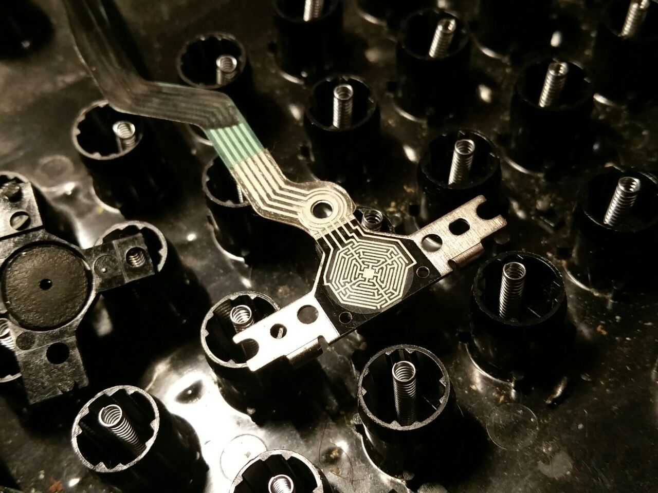

tentator
18 Mar 2016, 23:28
now I'm sure why I was feeling that trackpoint was so shitty.. ;)
Check this pics of it:
I think I will do one of the following two things:
a) reuse a laptop trackpoint to adapt instead of this one
b) do a mod on my other real model m in order to add a laptop trackpoint directly there and since I'm at it finally transform it to ansi (I understood the capacitive part is anyways always present under the holes even if unpopulated..)
lot of work anyways..
trackpoint of an unicomp endurapro

i did forget the attachment before sorry.. ;)
and by the way to separate the whole plate there is just some glue-plate near each foot on the inside..
