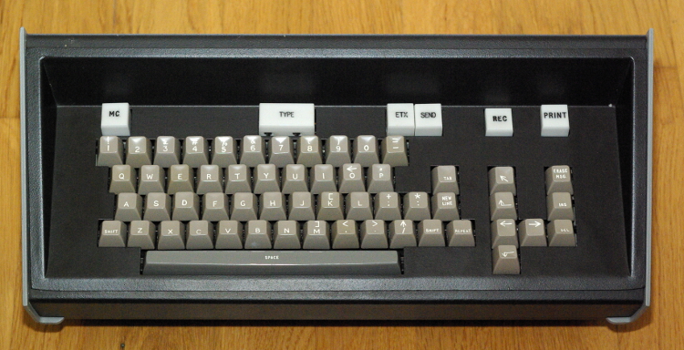

31 Dec 2015, 18:49
Sure there is. This one:
I'm less "advocating hard" for old Alps switches as I am criticising Matias modern clones. The switches in the Ergo Pro are really quite painfully bad. At that price, they are a real letdown and ruin the keyboard. Matias could do so much better.
