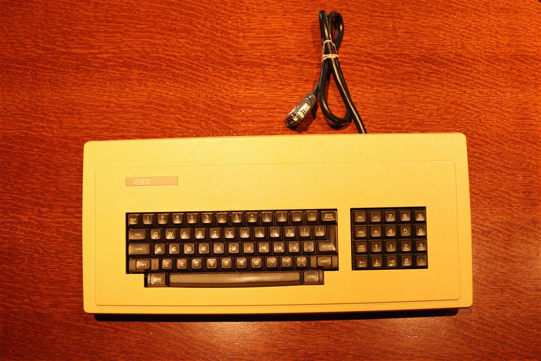

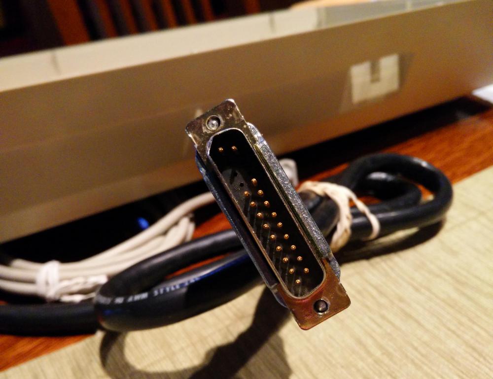

I recently acquired a xerox 820 keyboard from a vintage electronics store. I have looked online and cannot find this type of connector. All I found was that it is from a xerox 820 system from the 70's. I have no idea if it is even possible to convert this board at the moment.

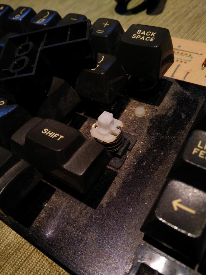

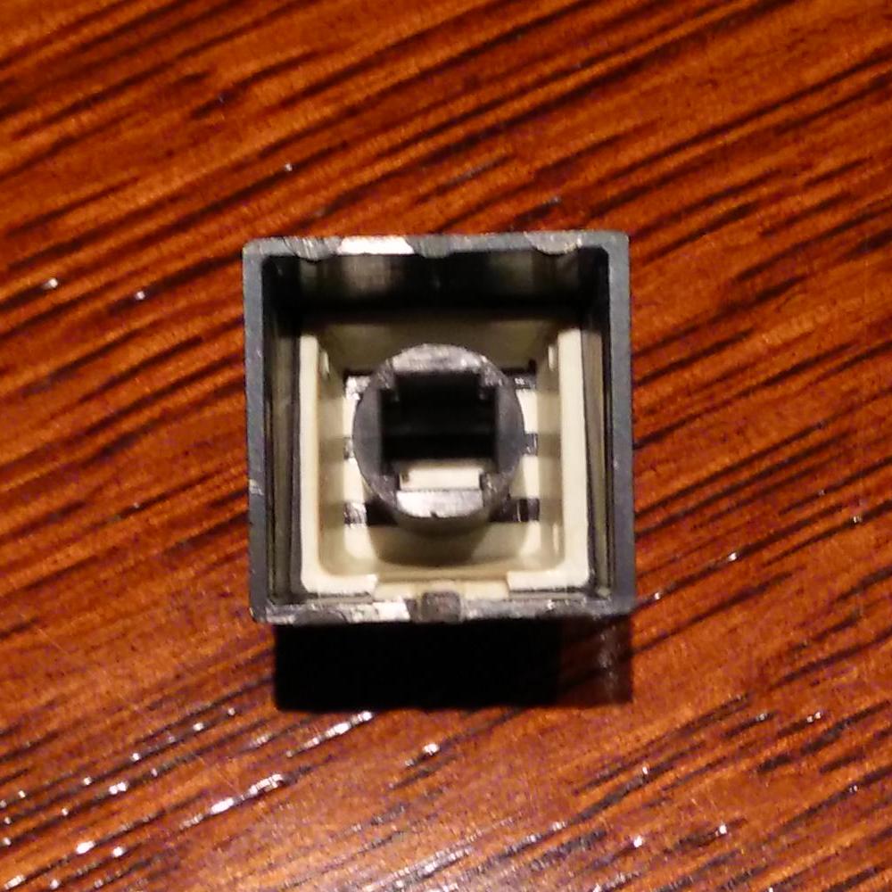

Light Switch
Light Switch
Heavy Switch
Heavy Switch

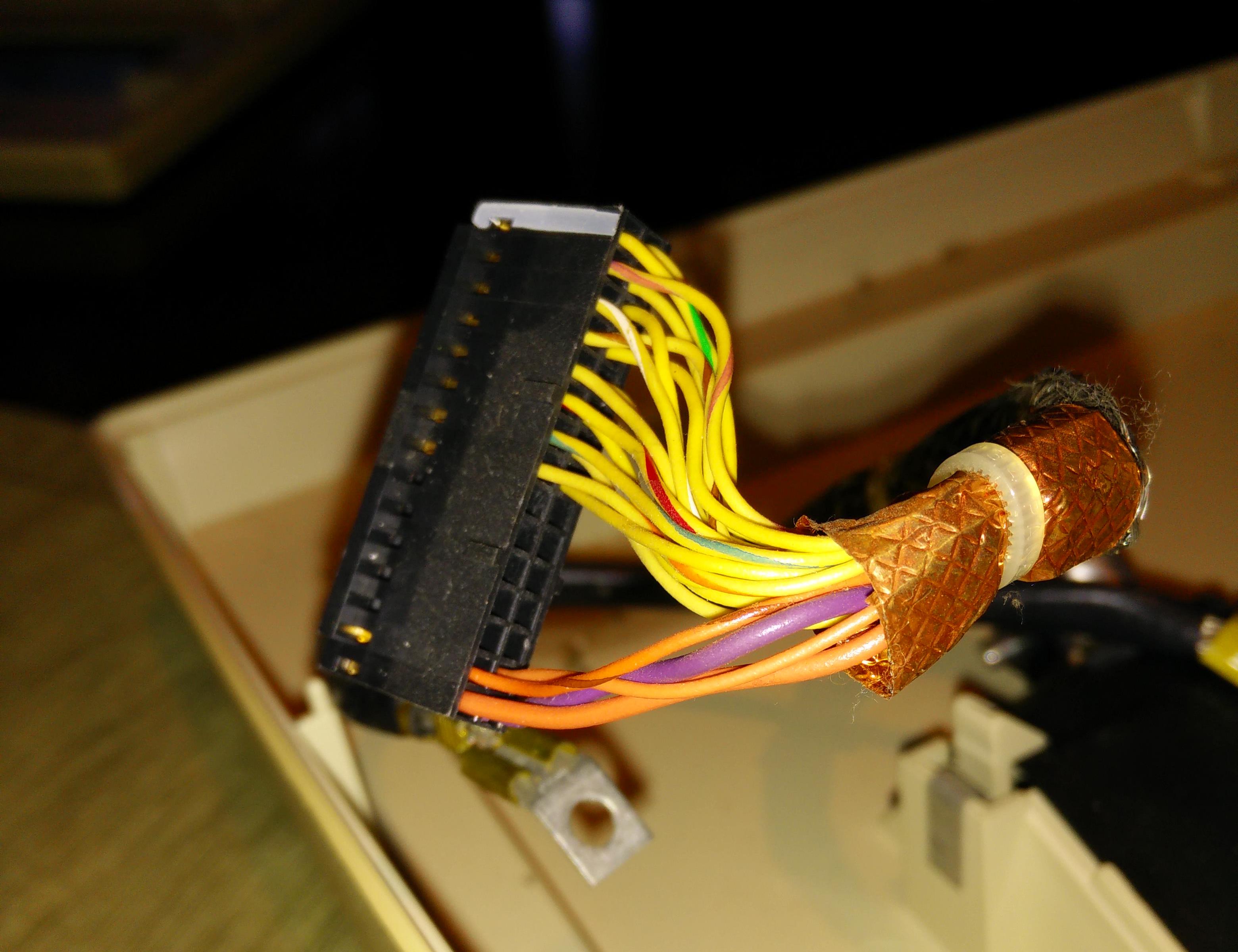

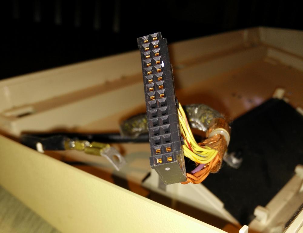

Connector Detail:
Really looking to figure out which switch type, since I can't find the kb details on the wiki. I also would love to convert it to USB, if possible. I have a leonardo pro micro and a Teensy LC on hand.

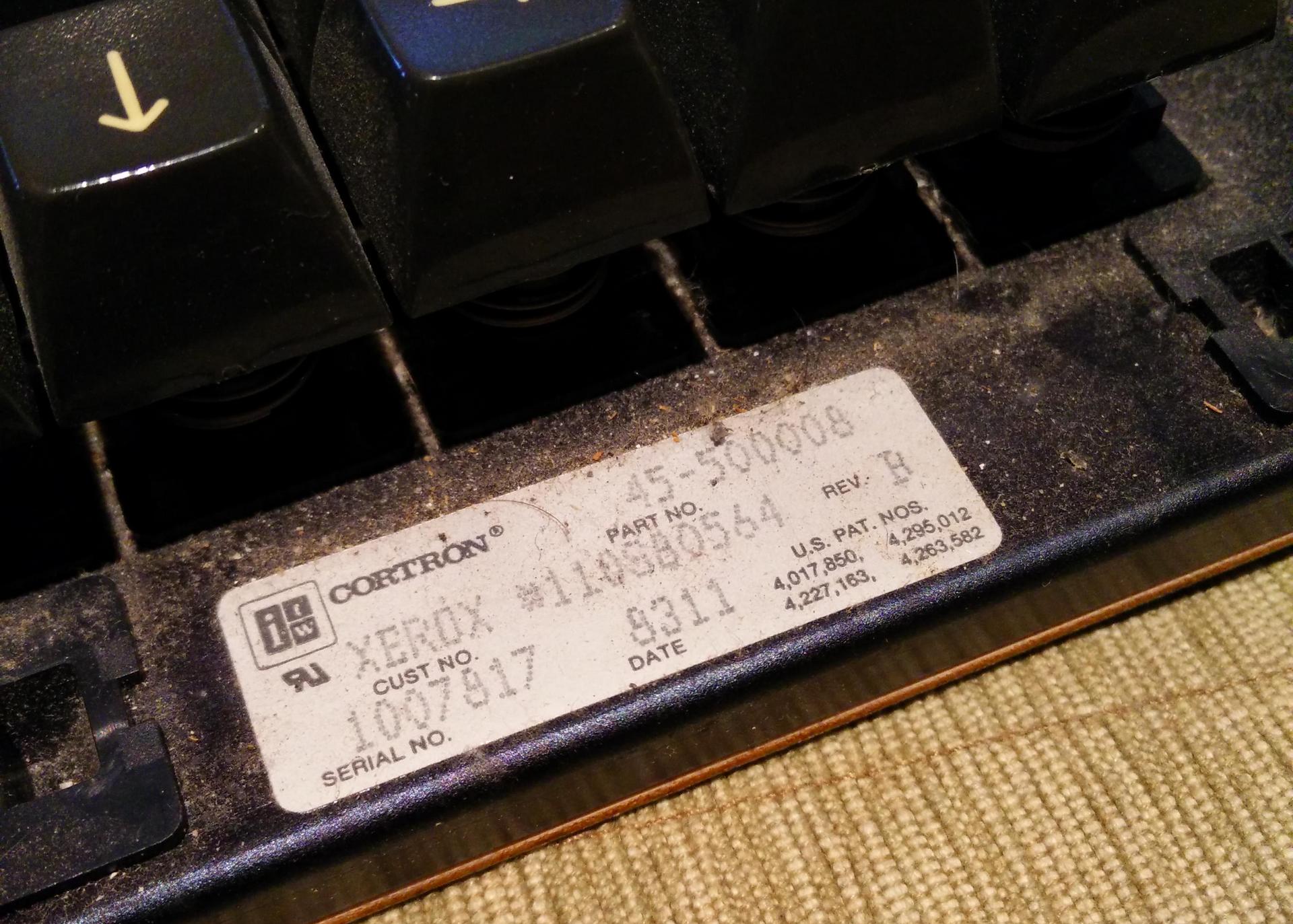

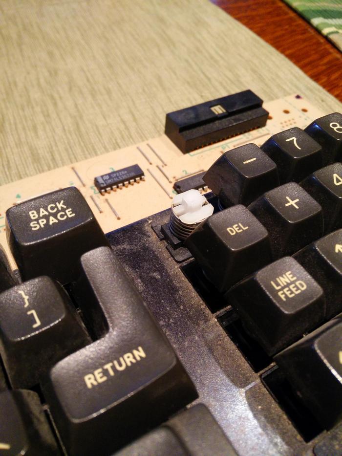

Ooh, ITW/Cortron magnetic valve. Very nice. Can you post a photo of the compete keyboard for us to see? It looks similar to a couple of the ones that I will be selling.
This has a November 1983 date code.

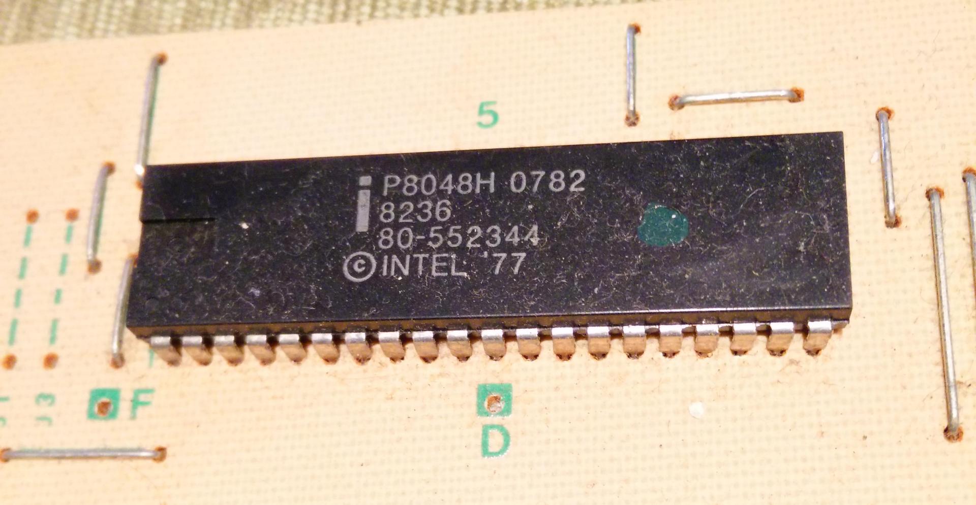

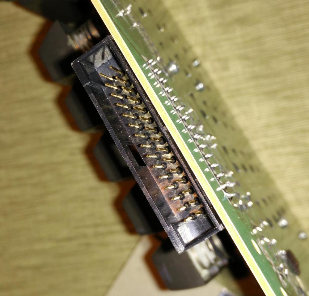

The IC in the second photo is an Intel 8048 microcontroller. It is an extremely common keyboard controller for keyboards of this era.
Are you familiar with magnetic valve switches? Look up the four patents on the label for more information. The idea is that two loops of wire are inductively coupled with a ferrite loop. When you send a pulse down one wire, you can see it on the other wire. That is, unless there is a magnet in the way (which happens when a key is pressed), in which case you don't see the pulse and you know the key is being pressed. These should support a really high scan rate but exactly how high depends on the strength of the magnet and some other factors. It's a really neat, clever contactless design that is like Hall Effect but cheaper and simpler, and like reed switches but more durable.
The takeaway is that these switches are active low.
If you *really* want to know exactly what it is doing you could attempt to dump the 8048's internal ROM and disassemble it. That is some work but understanding that would be authoritative. It would tell you the polling sequence, the timings, and the protocol. It may or may not be easier than using something like Soarer's Analyzer.
As for a USB conversion I think your best bet is to pull out the 8048, wire in a Teensy++ and work on replacing the controller.
The first step is to figure out how polling works. Presumably the switches are on a matrix. The question is whether the 8048 sees raw matrix pins, or sees pin muxes first. A lab notebook and a multimeter with continuity tester would help to figure that out. Each switch has four pins. Pins 1-2 are the first loop (pulse) and pins 3-4 are the second loop (detect).

One easy thing to check for: what do the pins on the main connector actually go to inside the board? What pins are those on the 8048? Consult an 8048 data sheet for pin names and numbers, something like:
http://pdf1.alldatasheet.com/datasheet- ... 048AH.html
Redmaus
Gotta start somewhere
07 May 2015, 03:56
What exactly do you mean by that? Do you mean where do they go? Are you talking about the outer connector or the one on the PCB?
I found this: http://html.alldatasheet.com/html-pdf/6 ... 048AH.html
So could I use the info on this sheet for wiring up the teensy? Still a little confused on which exactly.
I have a full pic of the board below:
Or do you want a pic of the whole PCB?

These switches have four pins, let's call them 1-2-3-4. You would connect pins 1 and 3 to a microcontroller and pins 2 and 4 to ground. Then, you send a pulse down pin 1, and see if you can detect a pulse on pin 3. If you can, the switch is not pressed. Otherwise, the switch is pressed.
It may be important to get the size of the pulse just right. For that you would ideally use an analog function generator and a two channel oscilloscope to get a "feel" for what the response of the key switch is. In this case, you would drive pins 1 and 2 with a square wave, and see what comes up on pins 3 and 4.

Just FYI, these switches are very scratchy and hard to press. I am more focusing on my Fujitsu leaf spring board now.

Those are ITW/Cortron Magnetic Valve switches. They are a kind of switch that I understand quite well and of which I have several other examples here in the house. I am already working on converting a similar keyboard to USB. The switches are only scratchy because they are quite dirty. Much like Micro Switch Hall effect key switches, these have the potential to be completely smooth with some love.
